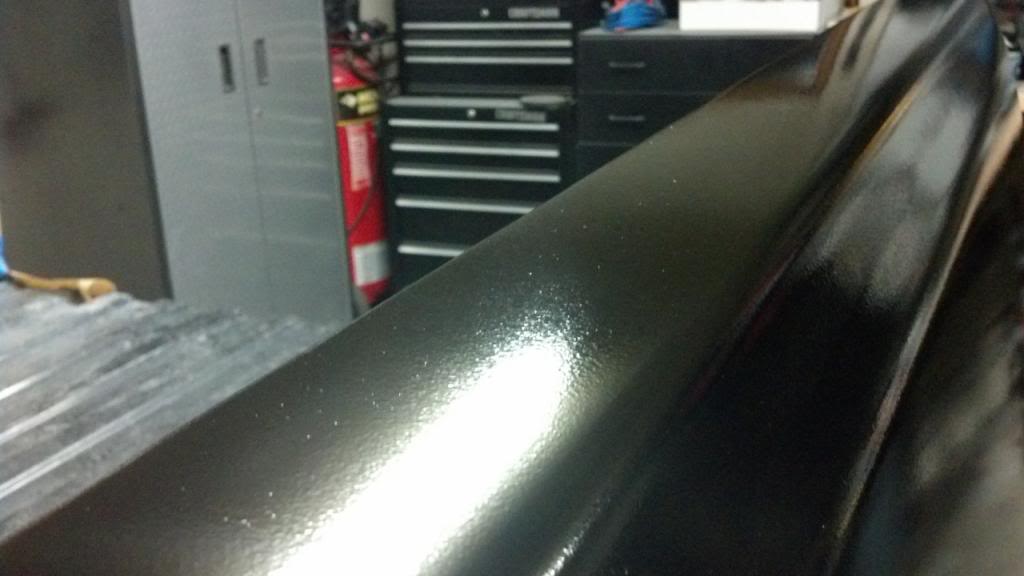

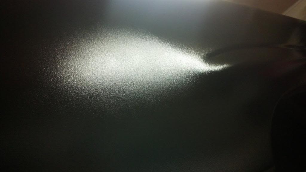

New pics after drying for an hour or so. Tons of orange peel and dust.

That is possible as well. Diff guns spray differently. Fan/spray width and such. Being that it is single stage if there is a area that you do not like, knock it down again with some 600 or so, then shoot it in color again. Make sure you lay a good bit of color down that way you can wet sand it, buff it to a mirror. I think you will be fine. I have often thought of doing my truck again in single stage black.

Looks like you may be working the gun to fast. Also being single stage if you run it, it isn't the end of the world, very forgiving and easy to recover. It can be sanded out easy with a flat edge.

I always wet sand the primer prior to shooting. If it is not smooth then the final paint will reflect it.. Also it appears you were dry spraying meaning you moved to fast or you were tooo far away or the air coming out of the compressor was too hot.

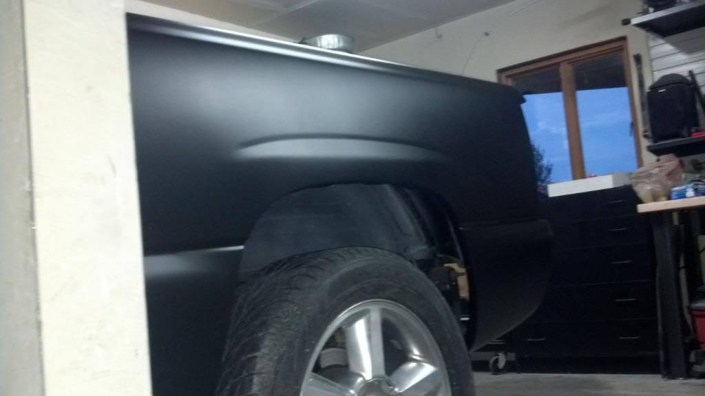

I bought some crap to build a makeshift paint booth in my garage. Taking tonight off from working on the truck but I'll be back at it tomorrow.
I'm going to try the tailgate next before I go back and redo the bedside. I'll try to shoot the primer a little slower and wetter, and be sure to sand it smooth before shooting color again. As the paint color dried it smoothed out quite a bit...still not acceptable to me, but I think if I get the substrate smooth and keep the dust off of it, it will look really nice. I'm digging the color so far.

I like the color man. Keep practicing you will get the hang of it.
I made a make shift paint booth once. Pretty simple i just bought a bunch of platic drop cloths and stapled them to the garage ceiling and then taped the bottom to the floor. Put a fan pointing outwards so it would suck air out.
