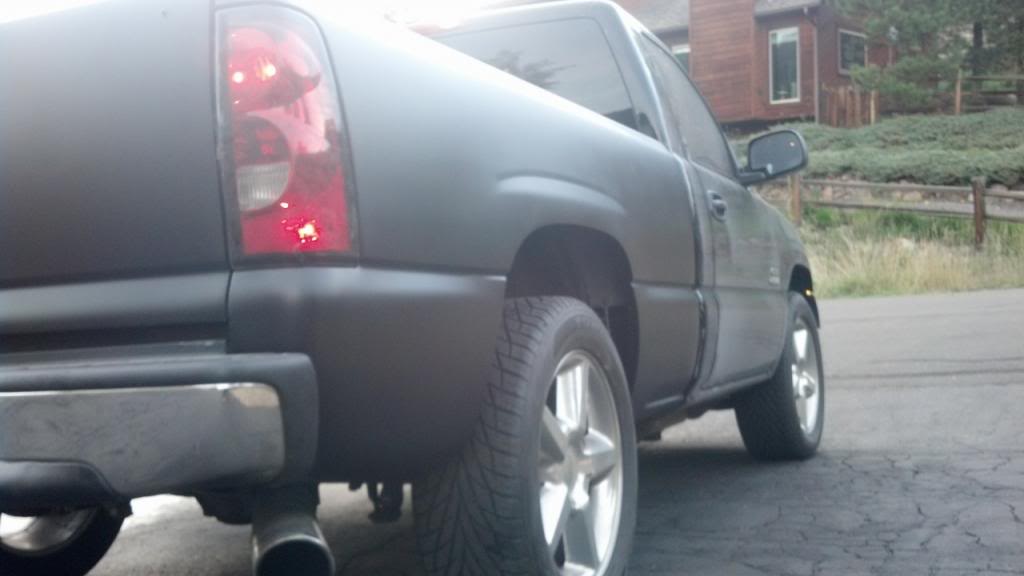

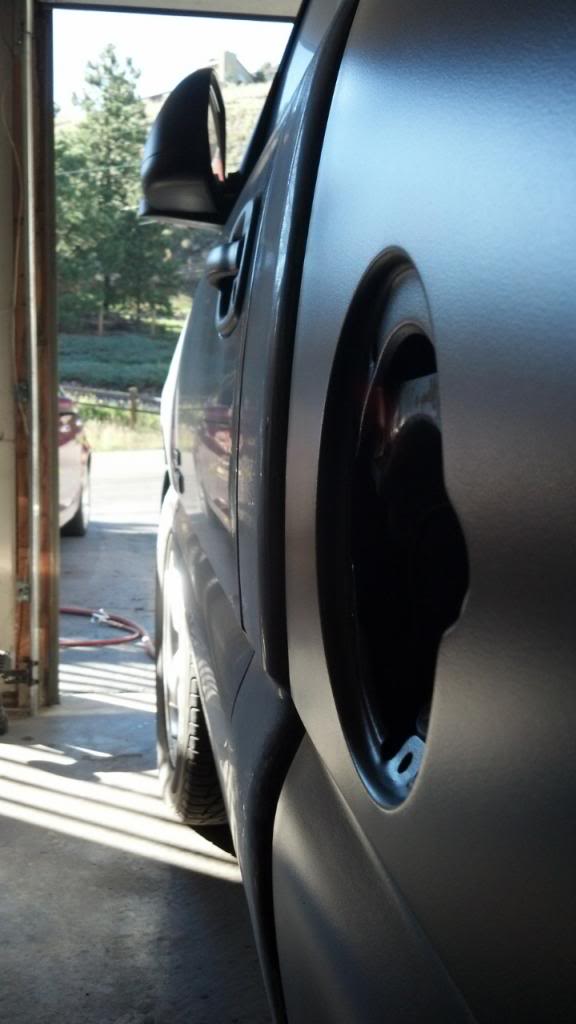

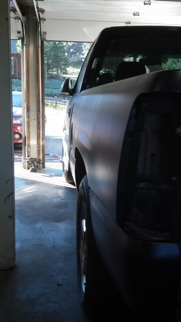

Left bedside is done, turned out pretty good I think! I'm not going to mind driving this thing around in primer either, doesn't look half bad. In the right light some of the feathered areas show, but I think the urethane surfacer primer will take care of those.
How long should I wait before I start putting this side of the truck back together?

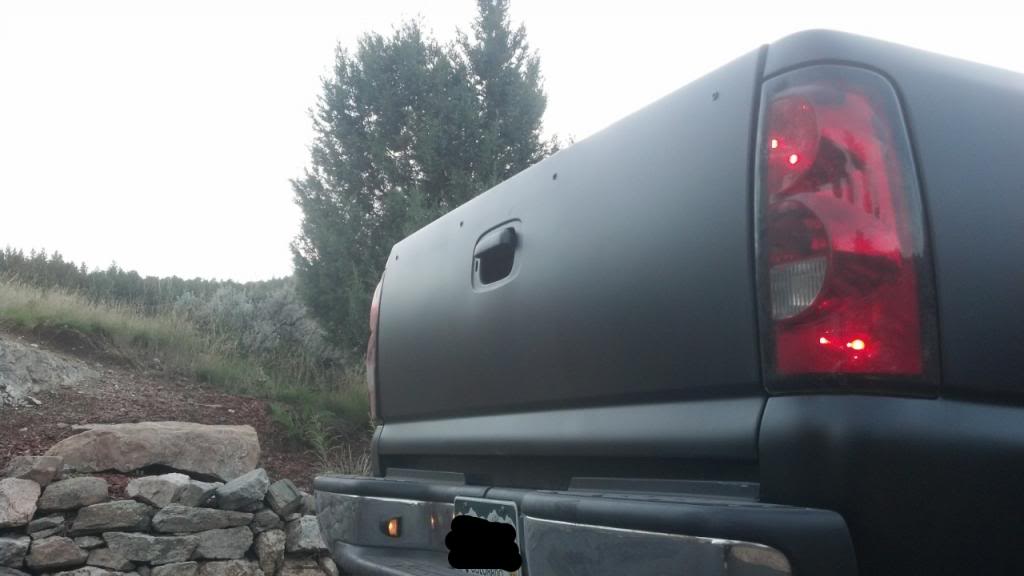

Tailgate and fuel door are ready to spray, I'm going to try to get the other bedside prepped and sprayed tomorrow too. I don't think it was in as bad of shape as the driver side.

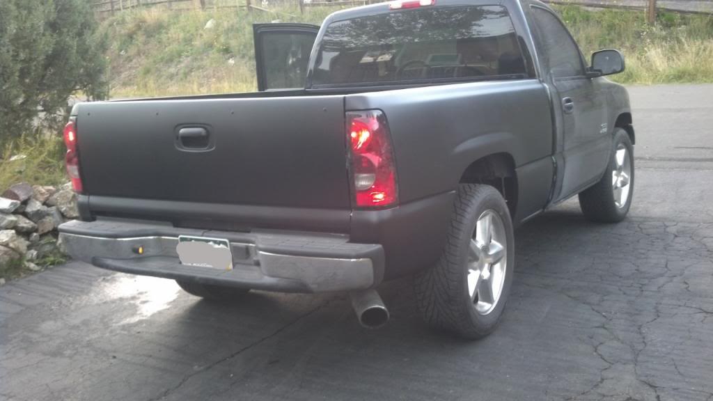

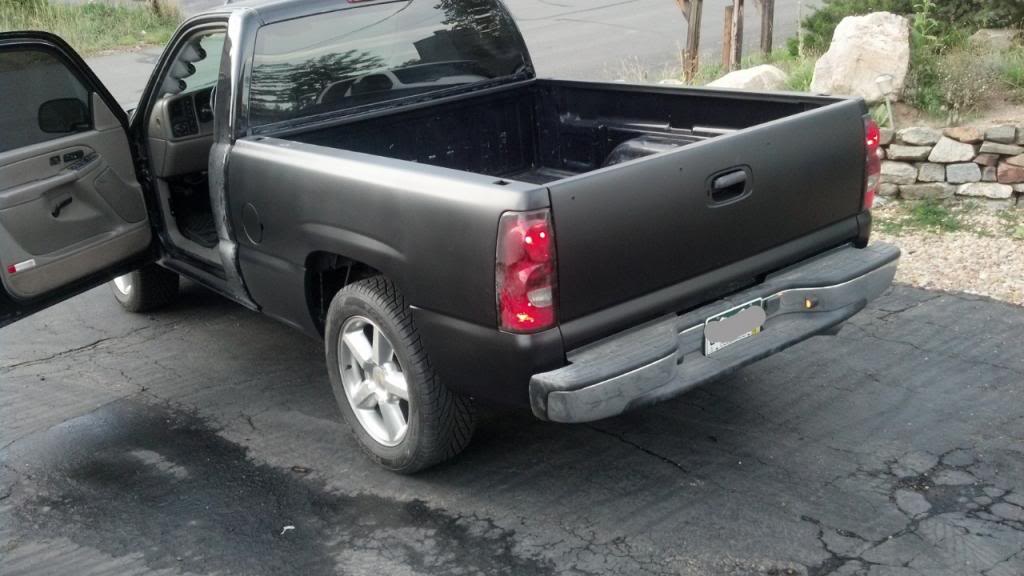

Got the passenger bed side and tailgate done today.

Lookin pretty good. Honestly it looks pretty badass flat like that
