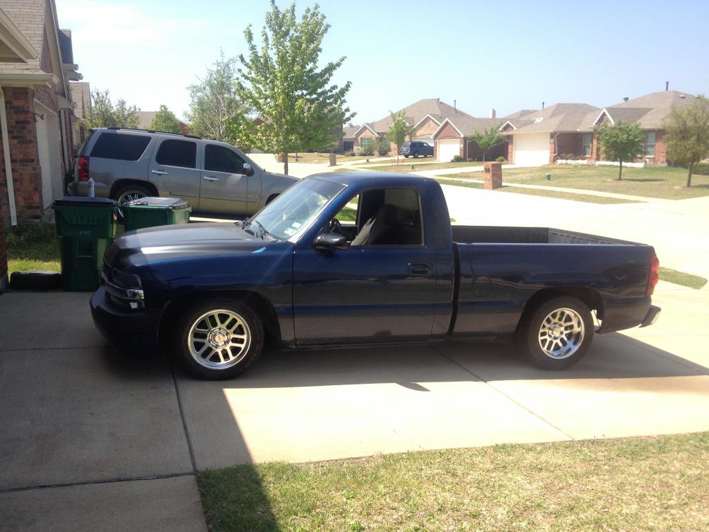

I didn't even think about the roll-up cover. I like that idea. I really want to swap to a stepside bed... These are all the pics I have right now. Haven't had a chance to get any yet!

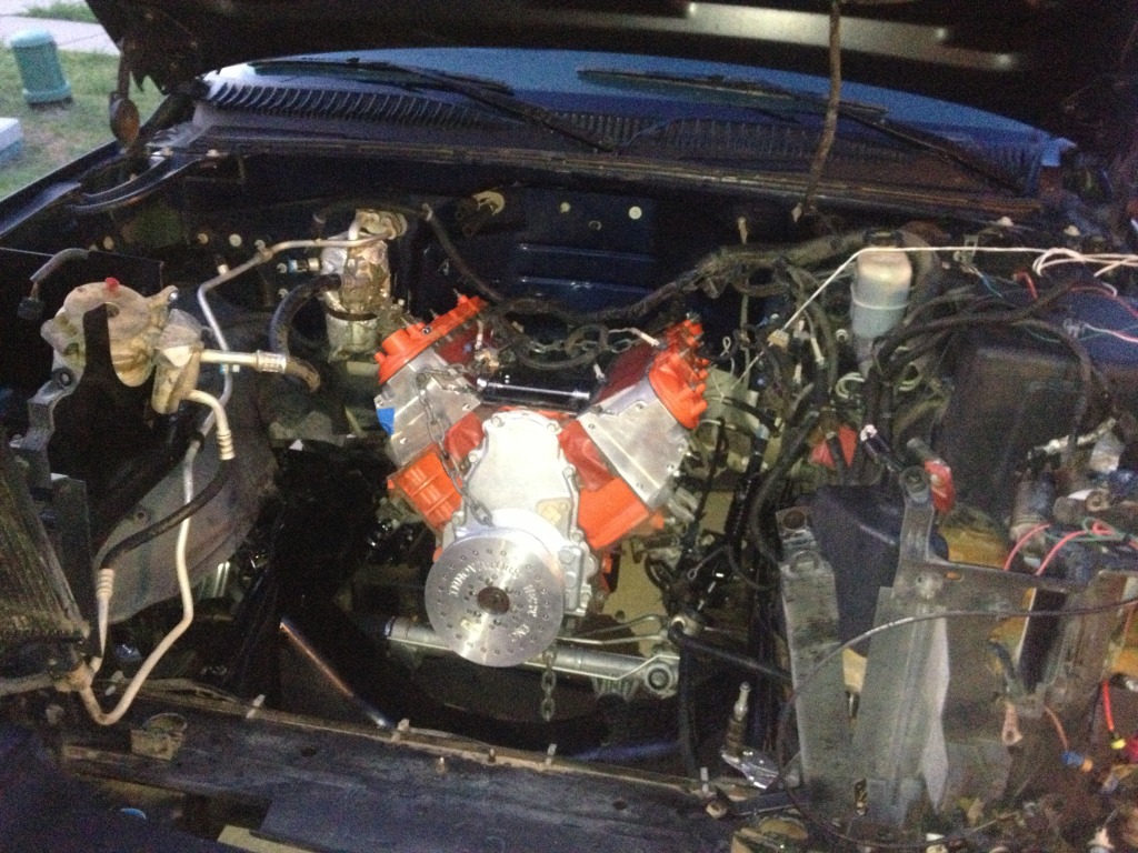

Well, the truck has escalated pretty quickly. I went from just keeping the 6.0 in it to get a 408 and 4L80 with an FTI 3600 stall. I have done quite a few things to it, so I will post a few pics up and show you the current status.
This is how the truck sits now. I need to get the hood and Z71 Tahoe valance painted.

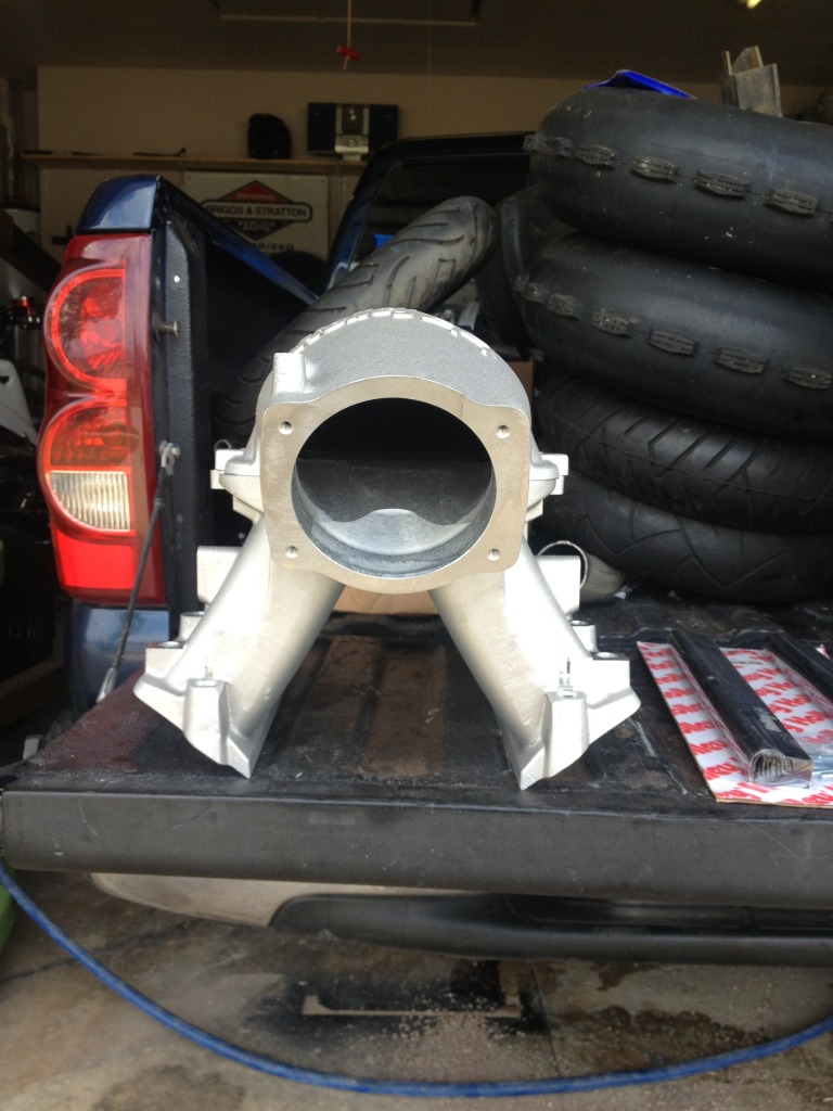

This is what intake I decided to go with.

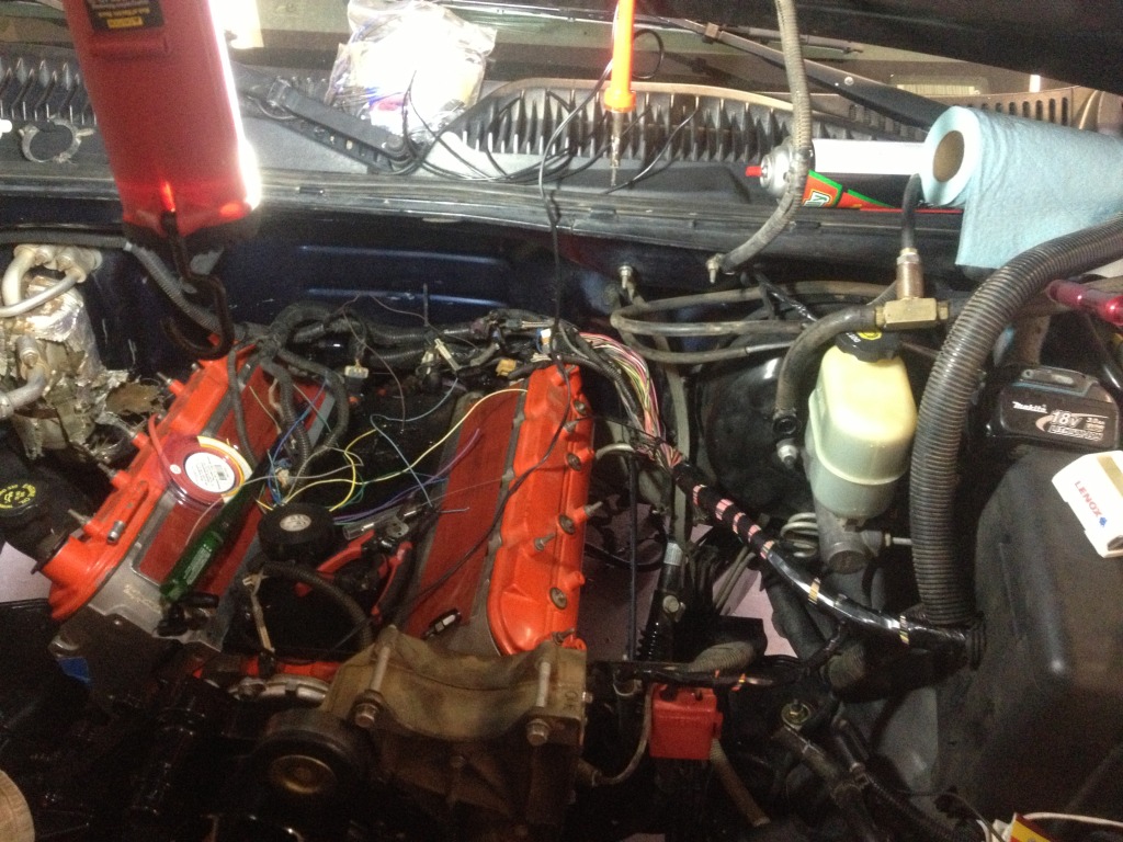

The 408 and 4L80 going in...

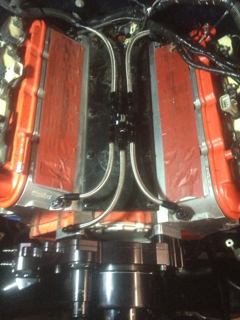

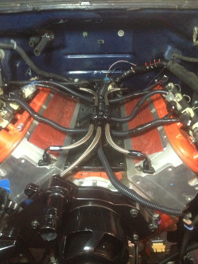

I just finished re-doing the harness to go behind the motor and up under the intake. Which was not very fun to say the least. Took me about 12 hours start to finish.

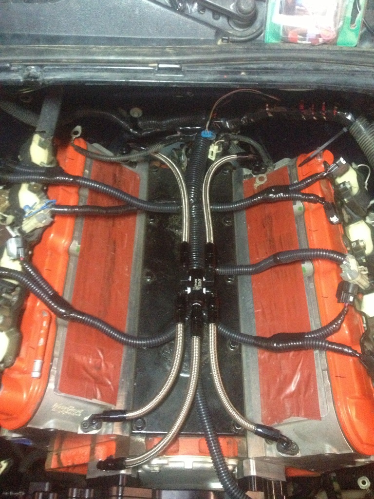

This is with the new steam ports ran and the harness finished.

I am missing some wire loom for the Firewall area, nobody around me carried 1 1/4" loom, so I had to order some. The intake and accessory brackets are all off at the powder coaters. Ordered the billet manual tensioner, billet power steering pulley, and billet idlers. Also, brand new power steering pump and a new 145 amp alternator for the E-fans.
