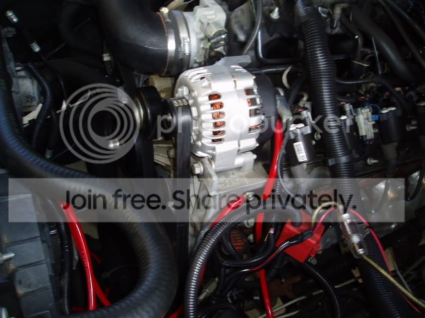

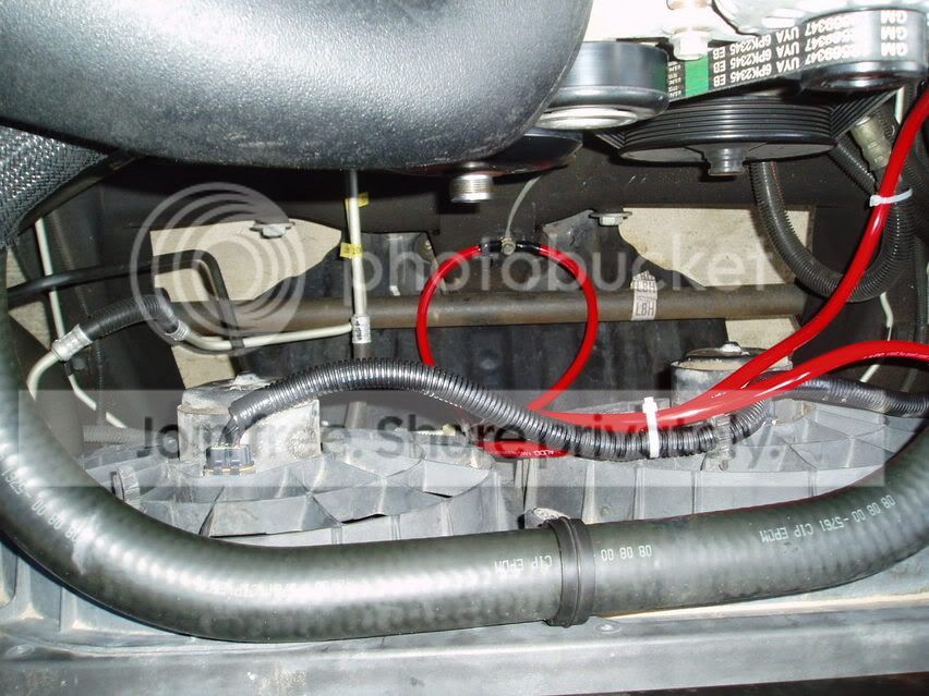

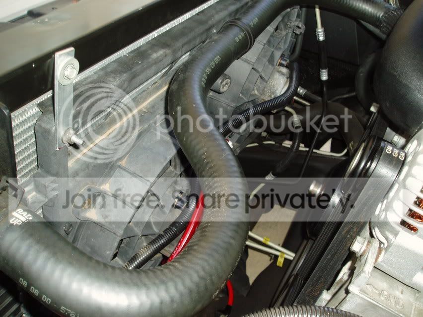

Here are my ls1 efans from amp performance with a nelson harness. Got the 160A alternator from motor city reman, and I upgraded the big 3 with 4 awg wire. Going on 2 weeks and I'm still waiting for my WFM tune, so as soon as thats in, this **** is a wrap.

Big three:
1. Alternator to Battery positive
2. Battery negative to ground
3. Engine block to ground
