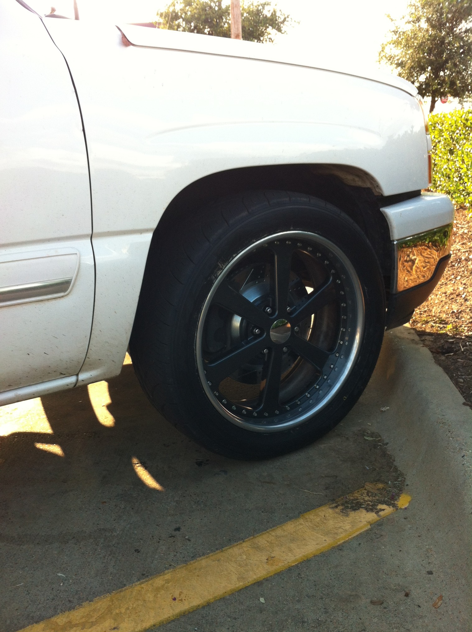

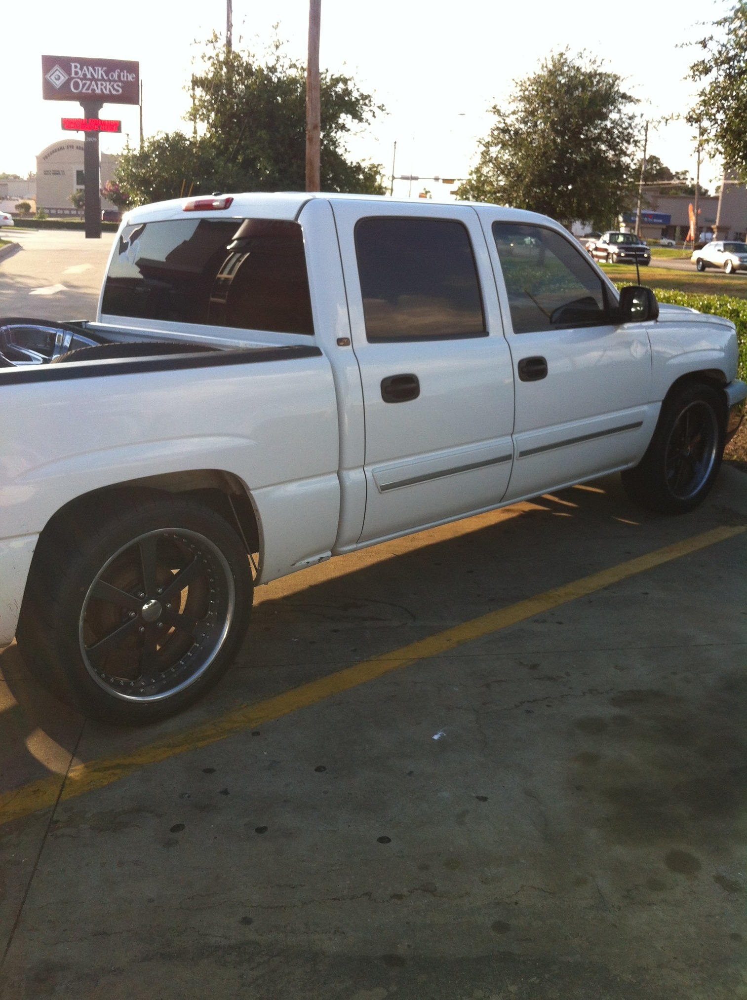

Just had to give a shout to superchargedss and post up the pics of the wheels mounted up. I went from 22x10 Akuza wheels to the 22x8.5 and 22x10 staggered set up.

Staggered has nothing do do with your tire wear. You need an alignment or shocks. Alignment includes anything that is loose in the front end because it can't be aligned until all ball joints, tie rods, and other components are fixed.
They don't look like a very helpfull track set up. I would assume you have sticky tires on the rear but they are still heavy as hell and the fronts are wider then a cooper mini. Weight is the main objective of a drag set up and saving 3 lbs. on a set of 22s isn't going to make a difference.
The second idea of track tires is skinny fronts for two reasons. The first is obvious that a skinnier tire will have less rolling resistance. The second is that skinnier tire has less rubber touching the insanely sticky track. I don't know how many people have walked on a well prepped track but it take some serious effort to pick up your feet. I would love to do some testing but I would guess that an 8" wide tire to a 3.5" tire of the same weight and everything on a prepped track would drop .1-.3 in the 1/4 mile. Again this is an educated guess but if any one has any info for or against it I would love to see it. I can't find that anyone has tested it.
The good news is the wheels look good, I just wouldn't call them a track set up.

Not a track setup, I want to lower the truck some more and with the old rims, the tires rubbed the fenders right at the edge of the tread. These tuck under much better, so hopefully I can come down without hitting. I race the truck, but it's not serious enough to get a dedicated drag setup. The rotor upgrade up front won't allow for a true drag wheel anyways.

hahahaha my bad thought the title said Track not Truck!! oops.
Like I said at the end they look great and are an upgrade in my eyes but it sure as hell didn't make any sense that they were for the track, good thing is they aren't! Nice upgrade.
