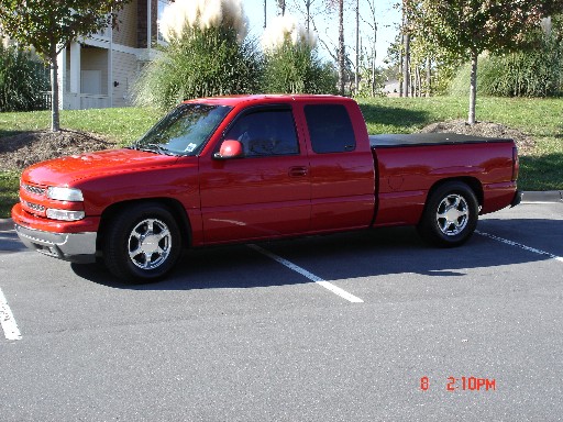

Just got done installing the BT 2/4 drop last week and put the new grille in too. I like it all. But does anyone know how to get rid of the gap between the grille and the bumber, i like the way the grille looks but wish it could fit better...any help would be great. Let me know what ya think about all of it. Rims on the way and headers going on soon.
That looks like as close as your gonna get it. Is the bumper hitting your corners??? If you have the room to move it up, your going to have to shim up the two top mounts and bend the two bottom mounts up to compensate. I'm talking about the bumper mounting brackets at the front of the frame.

I was thinkin about trying to shim up the bumper, but the way the brackets are it's gonna be kinda hard...i guess i just need to get the bumper off and see what i can do. It's not hittin the corners, i have the room to shim it up, I just want it to look right and clean, no one else really notices it, but it bothers me, i'm sure you guys know what i'm talkin about.

I'm having the same prob with my 01 Seirra, I'm, doing the Denali conversion and I have a big gap too. I think I'm gonna cut the brackets off and re-weld them higher. I havnt decided yet, you could try that if you think you can.

I's sure i could do that, but i would run the risk of discoloring the chorme on the bumber, and that would be bad, real real bad. I am sure there is a way that i can shim it up and fab something, I have just about all the tools i need and have friends that can pretty much do whatever...We kind of have our own little monster garage going on.
You cant discolor the chrome on the bumper if you take the bumper off of the brackets. If I'm not mistaken there are 4 bolts that hold the bumper to the brackets and 2 more bolts that attatch the ends of the bumper to the side brackets. Thats it!! The brackets are welded to the frame. Get under the truck and check out what I'm talking about. If you have the tools, the ability and an extra hand or two it can easily be done. Just remember to measure the gap before you take the bumper off and do any cuttin!!
