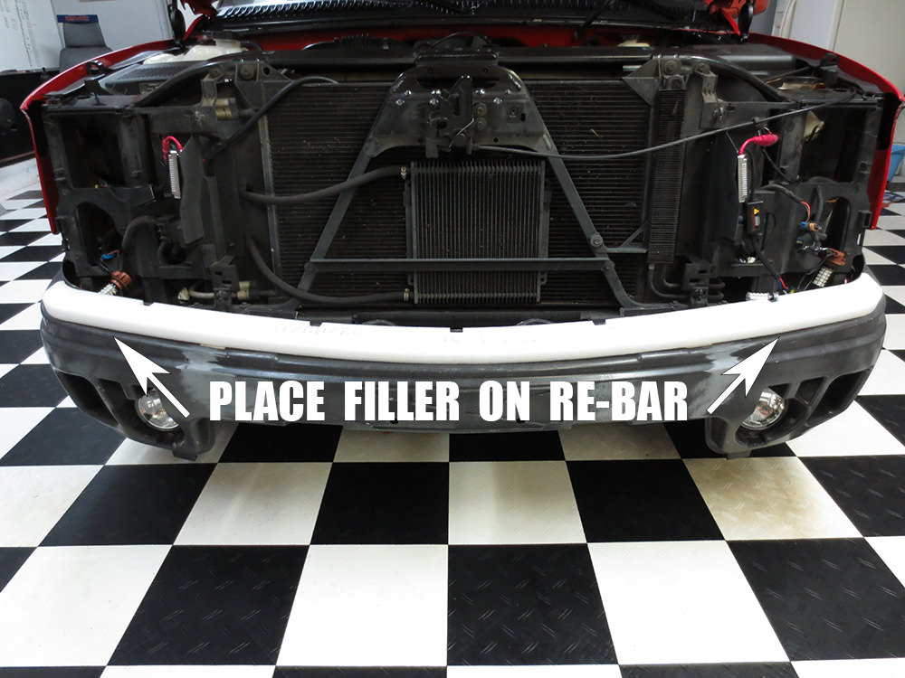

The Denali bumper cover would be impossible to use with out the re-bar. It would just flop around as it barely holds it's shape standing alone. Be sure to also buy the foam filler piece that goes between the re-bar and the bumper skin. The filler keeps the top of the bumper skin from showing waves. Doing this conversion on a Silverado you will need a Sierra hood, fenders, headlights, Denali park lenses, and a Denali grill. It's a much simpler conversion on a 99-02 Sierra.
That Denali bumper reinforcement (re-bar) is still available new under part numbers (GM1006414 and 15060470). Rock Auto has it for $168 + shipping. It's a petty simple conversion taking only a few hours excluding the painting.
I did a full write up on the conversion over on another truck forum HERE with all the part numbers, tools and bolt locations.

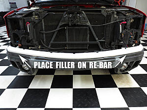

Here is the foam filler sitting in place on top of the re-bar.

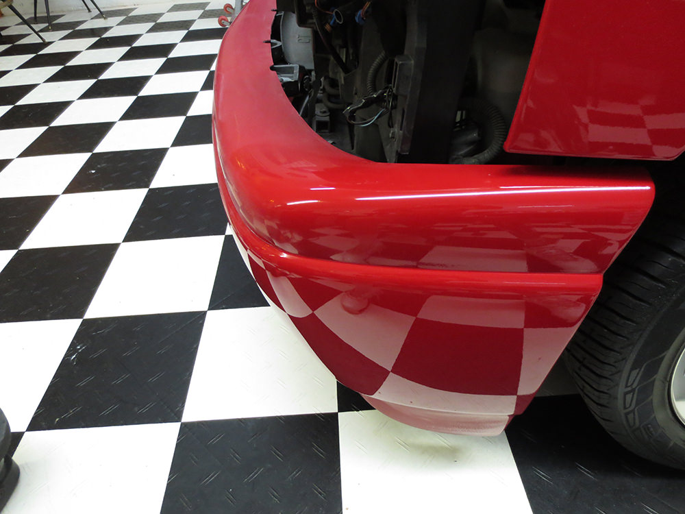

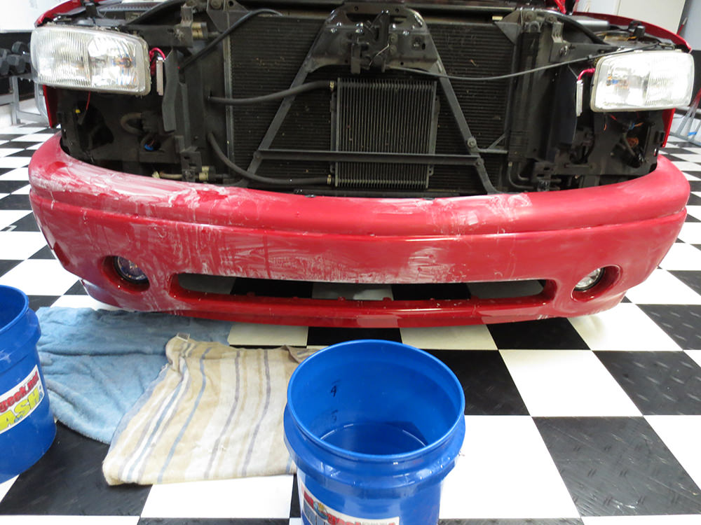

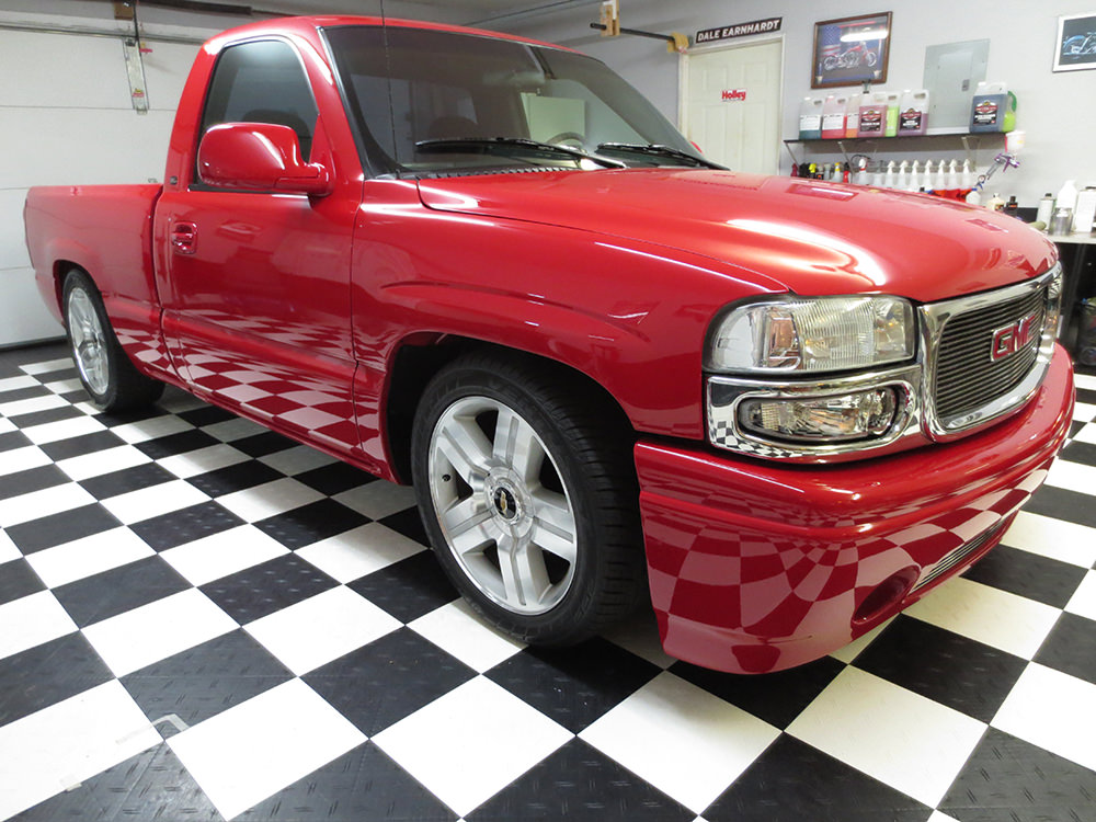

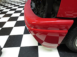

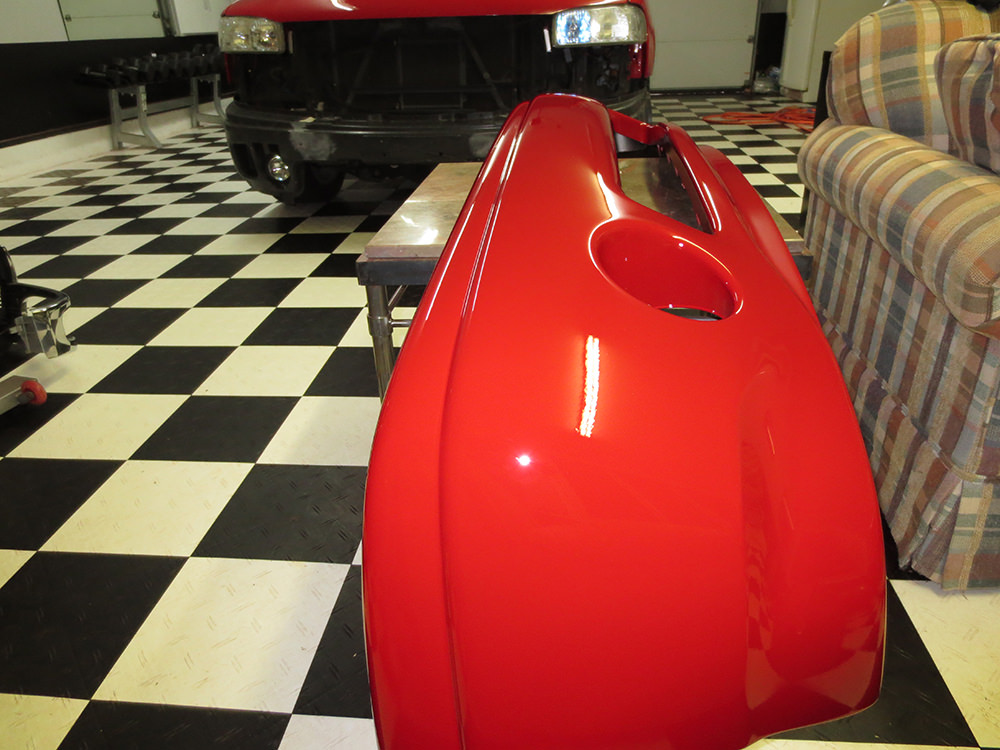

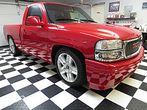

Painted Cover In my Driveway
Cutting
Buffing
Done
