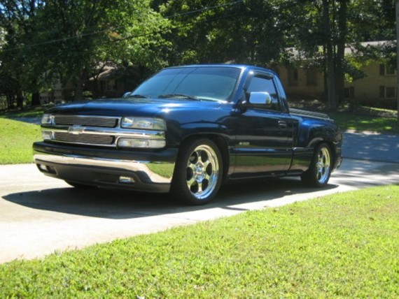

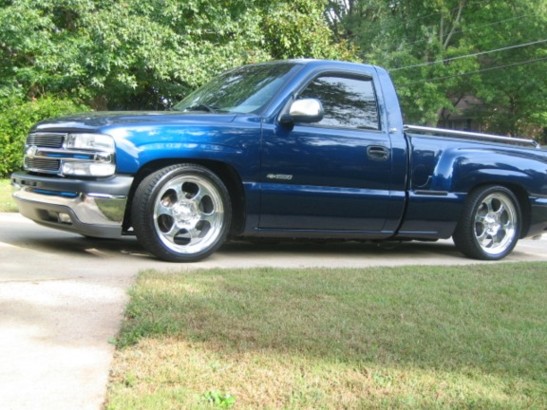

Do you have pics of your truck? I have a friend who is considering 275/35's. He doesn't like the ride of the 255/35's he has now.
Here are a few. The first would be nice if I didn't cut the back end off.
Attached Thumbnails Lowering kit for 02 GMC 5.3l-truck-002.jpg   Lowering kit for 02 GMC 5.3l-resized-truck-003.jpg
