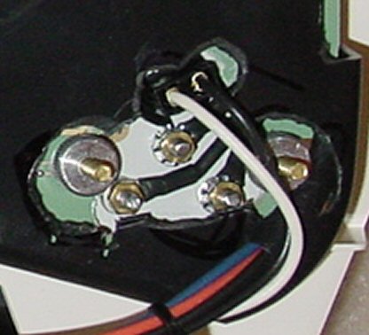

i drilled 2'' hole in the cluster fore an auto meter trans temp gauge,but in order to let the gauge go deep enough i have to drill though the electrical panel board and there is some wires there that will be cut off.i see some on this site have done the install ,any help would be great.i don't want to ruin my cluster.01 gmc ecsb 4x4.dash is out and i'd like to put it back together.

you've gotta cut everything in order to do that. Just the nature of the beast.
I cut enough to clear the connections and bulb socket, but left enough for the hold down nuts.
thanks snakeoiler.it looks like i might have to cut off two little connectors in order to clear the light connector hope it works,thanks again.

Originally Posted by trimmen
. . . it looks like i might have to cut off two little connectors in order to clear the light connector. . . .
Two little connectors? I'm at a loss of what you're speaking of?

snakeoiler i think they might be resisters .i'm also wondering if all 2&1/16 auto meter gauges are all the same depth.

This here tells you of the dimensions: 2 1/16 dimensions
Do you have a picture of the connectors (resistors) you are talking about?

i got it working without touching the resistors,it was very close though.thanks snakeoiler for your help & patience.
