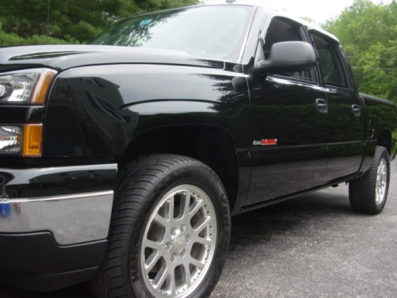

Wow! I've run Hankook Ventus' 295-50-20 for the past 3 summers and am completely impressed with their performance in the rain and overall ride quality, durability, handling and speed. I did have to finally go to a specialty wheel shop to get them balanced correctly but since then, I've buried the needle many times at 125+ and they don't shake at all. Their quiet, too.
Only two downsides to the Ventus has been that they're terrible in the snow, and they are directional, so you won't be rotating around the truck. That's it.
My 295-50-20 is on a GMPP wheel of 8.5" which is the minimum rim width for the 295. The push out just a 1/2 or 1 inch past the widest part of the body and look damn stout.
Dunno what your needs really are, but don't be afraid of the Hankooks. I'm not just talking out my *** here, either. I've owned plenty of Corvettes over the years right up to my 2001 Z06.
The Hankook Ventus doesn't suck!
EDIT: They're not good for the drags either. If you're going to run them on the track I suggest a set of slicks for the rear or running drag radials on the streets.
Also found a pic for you of a 295-50 20 on the 8.5" on the truck:
