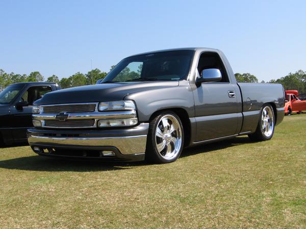

For daily driving, I would run a 3/5. But you may hit the bump stops in the rear a lot. I ran a 4/6 and had to notch the frame b/c it was sitting on the frame. I currently have a 5/8 drop with 255/35-20 and 295/40-20.
