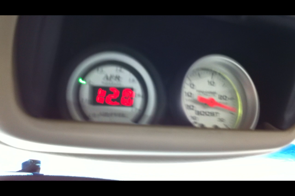

Yea S480 with race cover/ 1.25AR/92mm exhaust. It's a savage beast just lot's of lag up here at 7000'. Makes 24-25psi here where GT76 gave it up at 18. Bet it makes 26-27psi at sealevel ...:/
How the hell is your motor still together? Lol, is the motor still running strong?

Went 10.14/132mph in Colorado at 5000' elv. This was with GT76@20psi full weight one pass got thrown out, and blew turbo all in one...Could have prob nipped a 9.98 if I could have got a cpl runs to mess with it. This S480 Is making 24-25psi up here and burning same fuel as GT76 did at sealevel @20psi. Im confident It will go mid high 9's up here, and prob sub 9.50's at sealevel if engine holds. Times in sig were at 800' elevation GT76 on 20psi so you can imagine what 25psi is like lol
Originally Posted by Jake99
You are one crazy *** guy! Lol
Had to buy a new boost gauge, never thought Id need a 30psi gauge for a stock engine lol

^^^ looks photochopped to me...

Man that's awsome, I can't wait to take this little toy motor up to 25psi with a real turbo, this 15psi stuff is getting boring!
