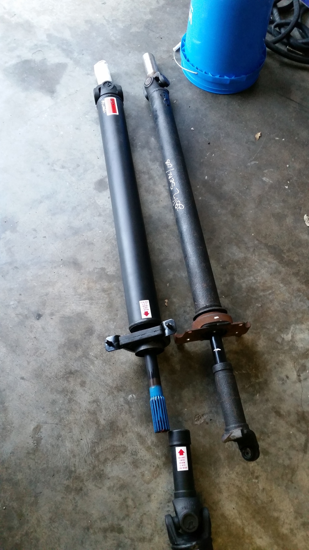

New vs. old driveshaft. 3.5" steel vs 2 5/8" steel (i believe)
All 1350 solid Spicer u joints with chromemoly Sonnax trans yoke and my chromemoly pinion yoke arrives tomorrow.

Nice! I Want to get a driveshaft built. I have a stock ds shortend and balanced.

I know that driveshaft setup. Works great for me.

Good ****. That shouldn't be an issue anymore
