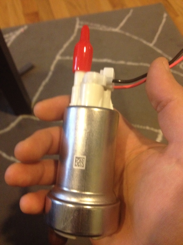

Walbro 450. Sucker is tiny but feels well built. I'm going to see how far this can take me at 17 volts. Hoping to get 700 rwhp through stock lines and regulator. If not, more changes will be in order. I considered the magnafuel 4303 but I could never find a straight answer as to how much it would support on E85. Also came across issues with it potentially overheating on long drives (stuck in Houston traffic in summer anyone?)

Looking forward to see how it works out for you! Does that pump have a 5/16" or 3/8" nipple on it?

5/16"

You gonna use a hotwire kit or stock wirimg with that?

Racetronix hotwire, which is en route now. Anyone who'd use stock wiring with an aftermarket pump is asking for problems.
