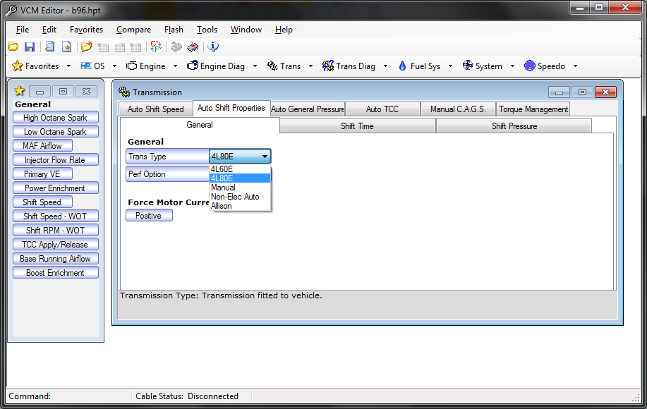

Since it is relatively easy, try using the segment method...the newest hpt beta allows you to do it without sending in your file to support. Just have to remove your relay and hook up the iss, which is useful for analyzing the converter anyway. As far as why the relay isnt working for you...are you sure you hooked it up right? This is with the original pcm and not the e38 right?

Still have to send the file to HPT support for a segment swap...

Negative ghost rider, the newest beta (at least, possibly less recent versions as well) have an option in the program to change the transmission type. Yes it does work, and yes it fixes that issue of the converter unlocking at 0% tps.
I changed from the relay method to this method when I swapped converters a few weeks ago.
What beta version are you using? Mine has the TCC tables for keeping the converter locked, but no way of swapping segments or identifying a trans swap. I haven't seen it on the HPT forum either.
I feel left out!

Im using 2.23.867
All there is!
I feel left out!
When I updated mine it has a bar that has like 4-6 different trannys on it to select
