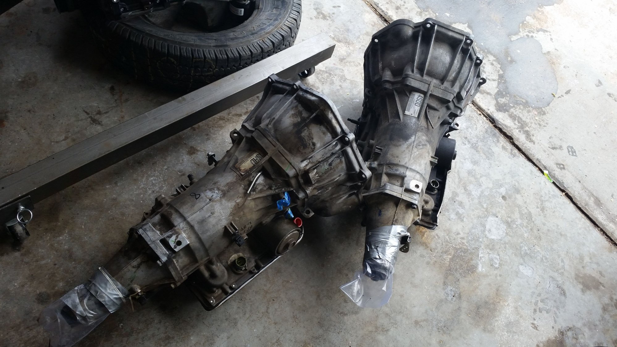

So i picked up these 2 transmission, the one on left i bought one on right was free.<br/><br/>One on the left the bolts to torque converter dont line up with the flywheel, and it has the weird input shaft, one on the right the converter lines up but the bell housing is weird and its got a smoked 23 clutches.<br/><br/>So im without a transmission good news is i slept in 2 days in a row, i definitely needed that didnt realize how worn down i was getting.

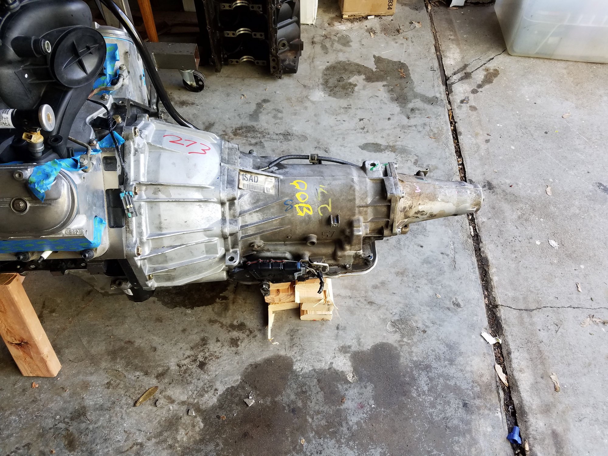

Guy I bought the tranny from says he has another one and he's almost positive it came from a 5.3 so here is hoping. If the third time fails to be the charm I'm just going to say screw it and buy a 4l80 didnt plan on spending that kind of money for a 400 horse motor but I know it will work, last , and be way more than I'll need for a few years

One on the left is from an older V8 or V6, not an LS series engine. 7SHD is for a 1997 2WD S10 Pickup
One on right looks like an inline 6 trans for a trailblazer. 4SSD code is for a 2004 2WD trailblazer with a 4.2L.
Google the 4 digit code on the next one and see if it's what you need. I would have him take those back if he told you otherwise on the fitment.
