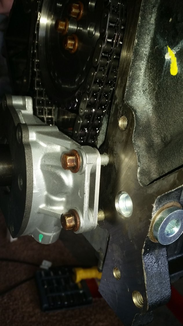

Posts: 193
Installing oil pump with spacers to clear the double chain

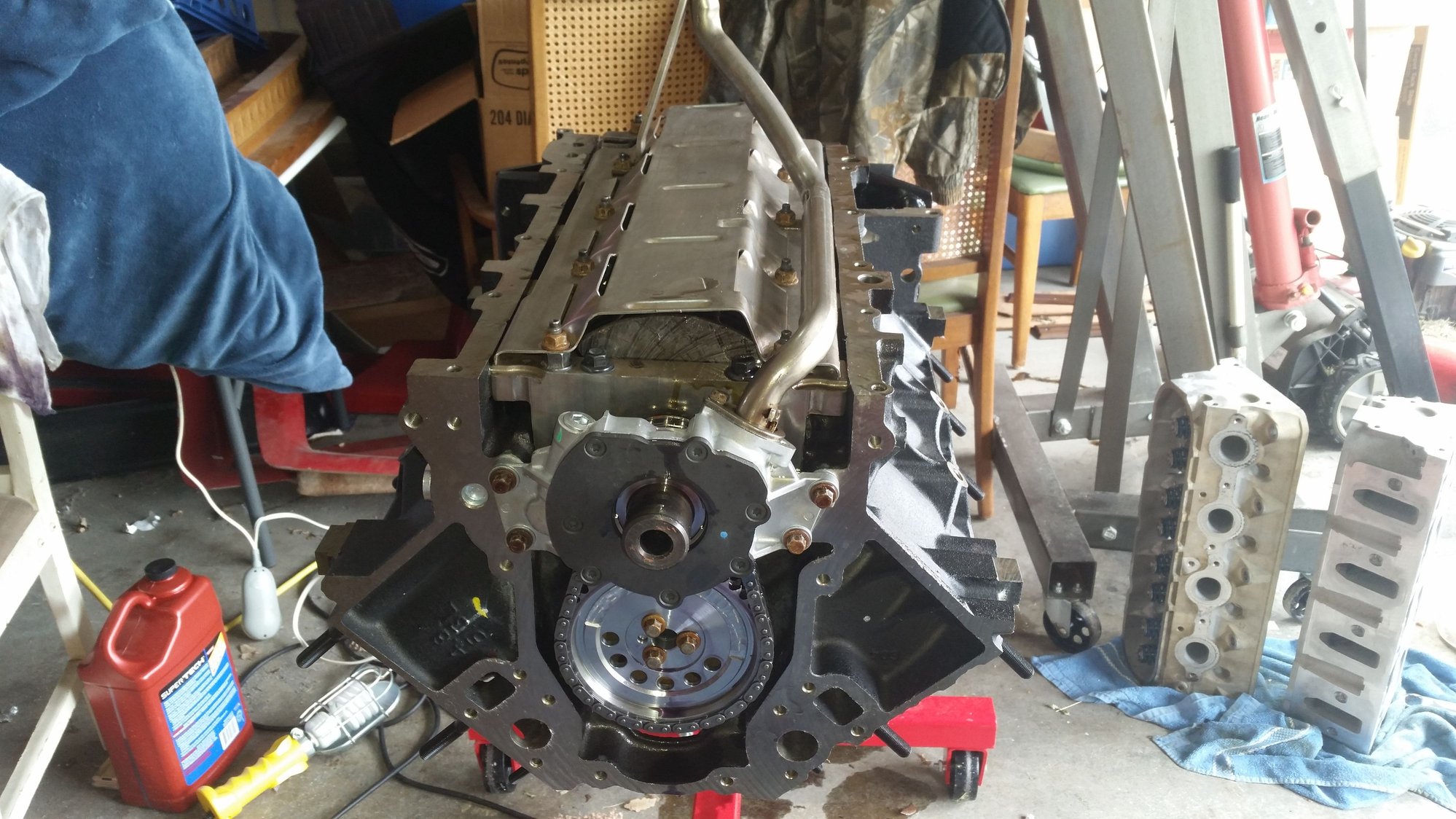

Posts: 193
Windage tray and pickup tube installed

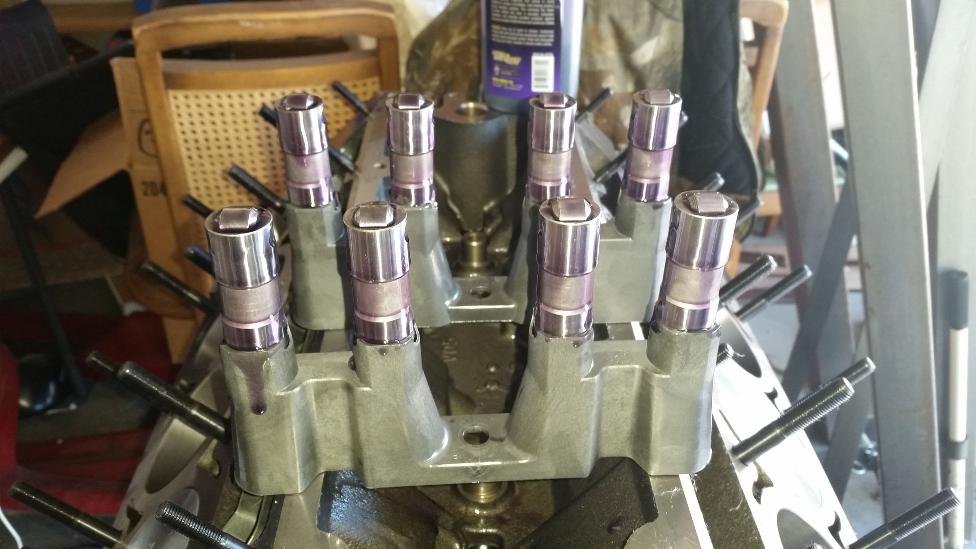

Posts: 193
Lufters going in

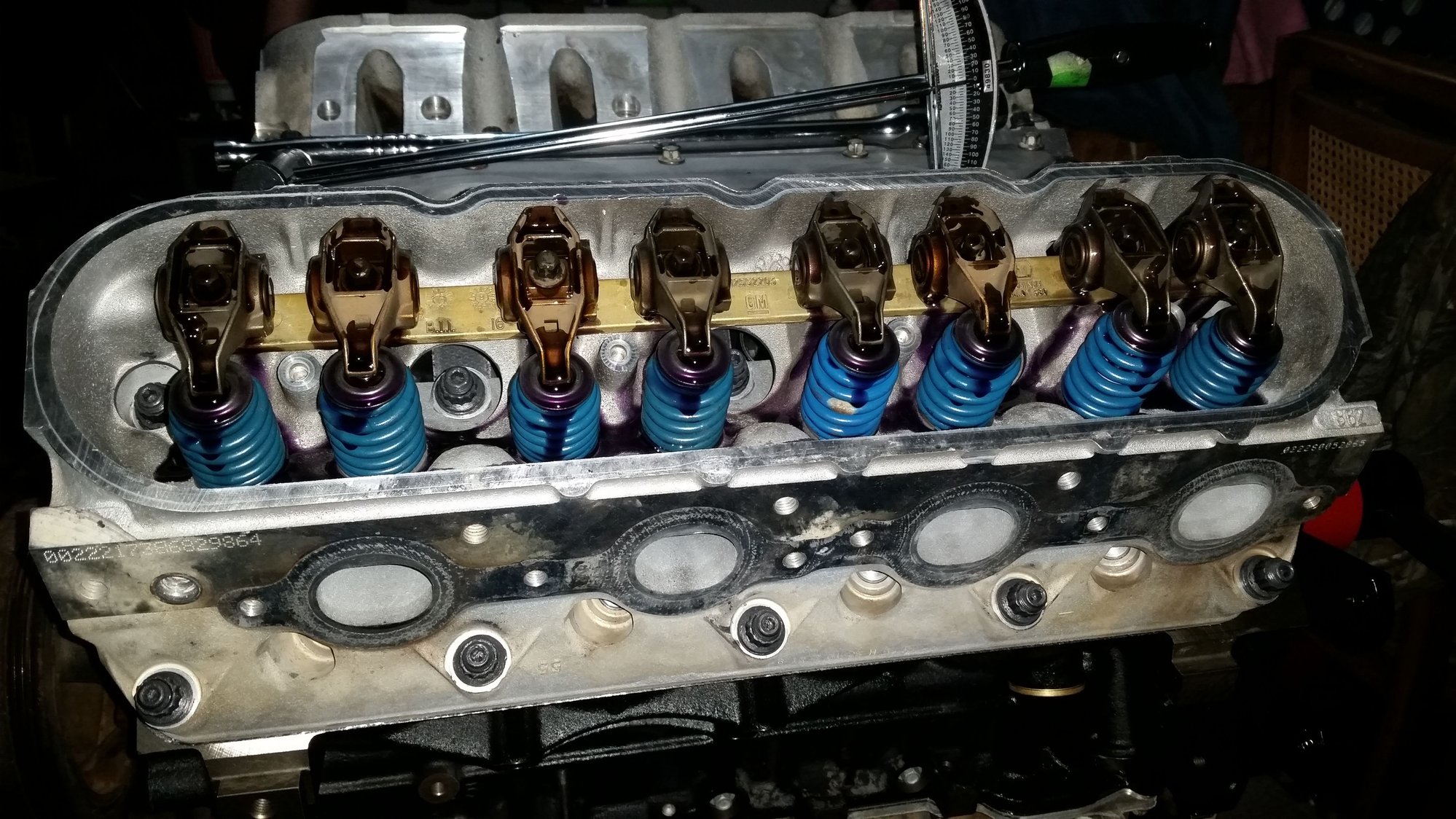

Old Mar 14, 2016 | 08:24 PM
  #98
TwistedBigRig's Avatar
Joined: Feb 2016
Posts: 193
Pushrods, and rockers installed

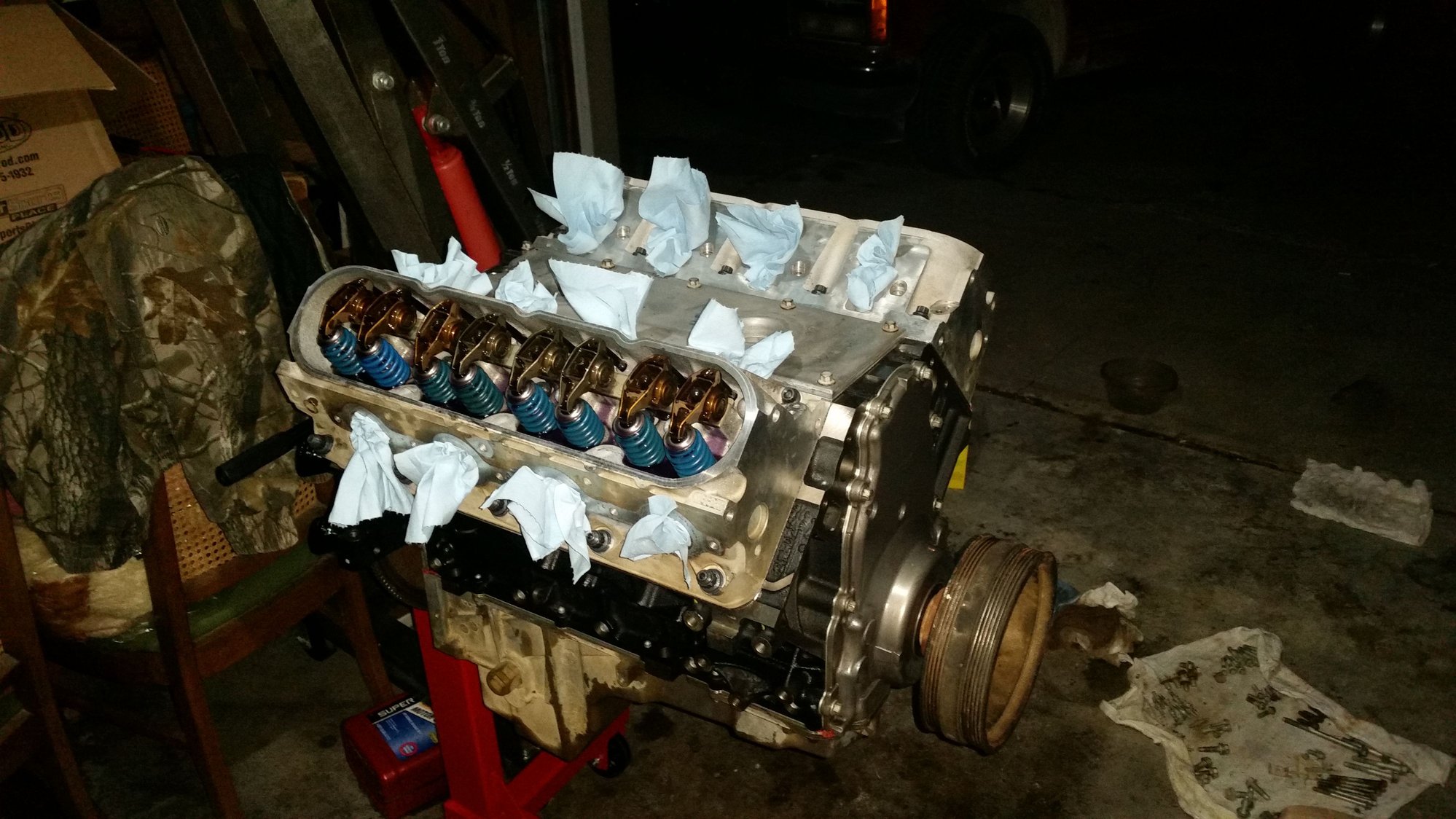

Old Mar 14, 2016 | 08:26 PM
  #99
Joined: Feb 2016
Posts: 193
Lufters adjusted, more assembly lube, spun her over about 10 times and she sang to me a little bit, have to get up at 3 am so had to call it a night
