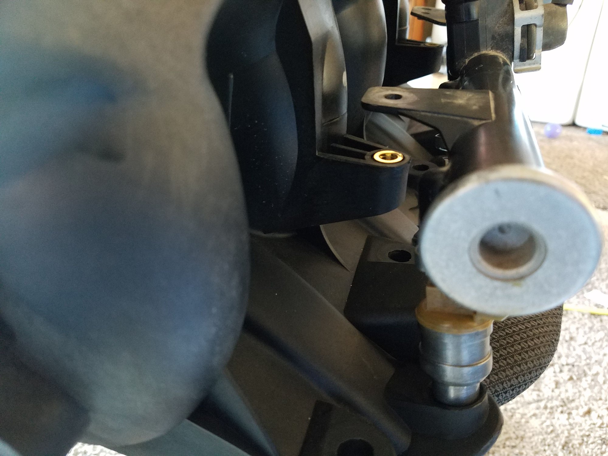

Could use some insight or help with these fuel rails the new Injectors are way taller than the old ones not sure how to secure the rail. Debating stacking washers but that's so ghetto. Anyone have an idea?

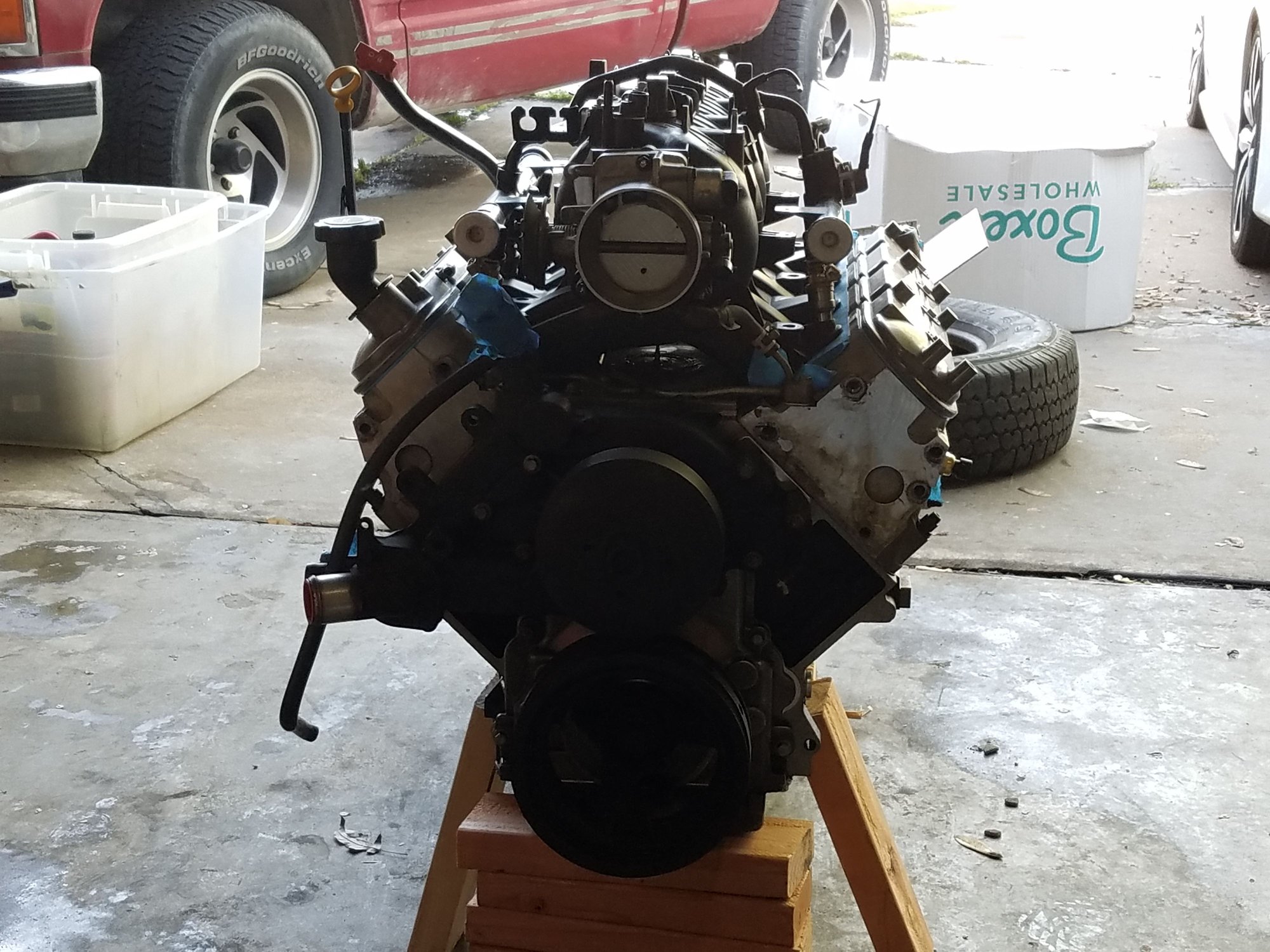

Dont try this at home lol. Long as we dont have an earthquake in the next week shes good. I pushed from all 4 sides and it didnt budge but id recommend leaving it on the stand. I needed it like this so i can reloom my harness the guy i paid did a horrible job and it lays out all weird

See if you can find some nylon rod or plastic rod, then cut them to the length you need and drill a hole in the middle to allow the bolt to go through.
It's a far better solution than stacking washers.
