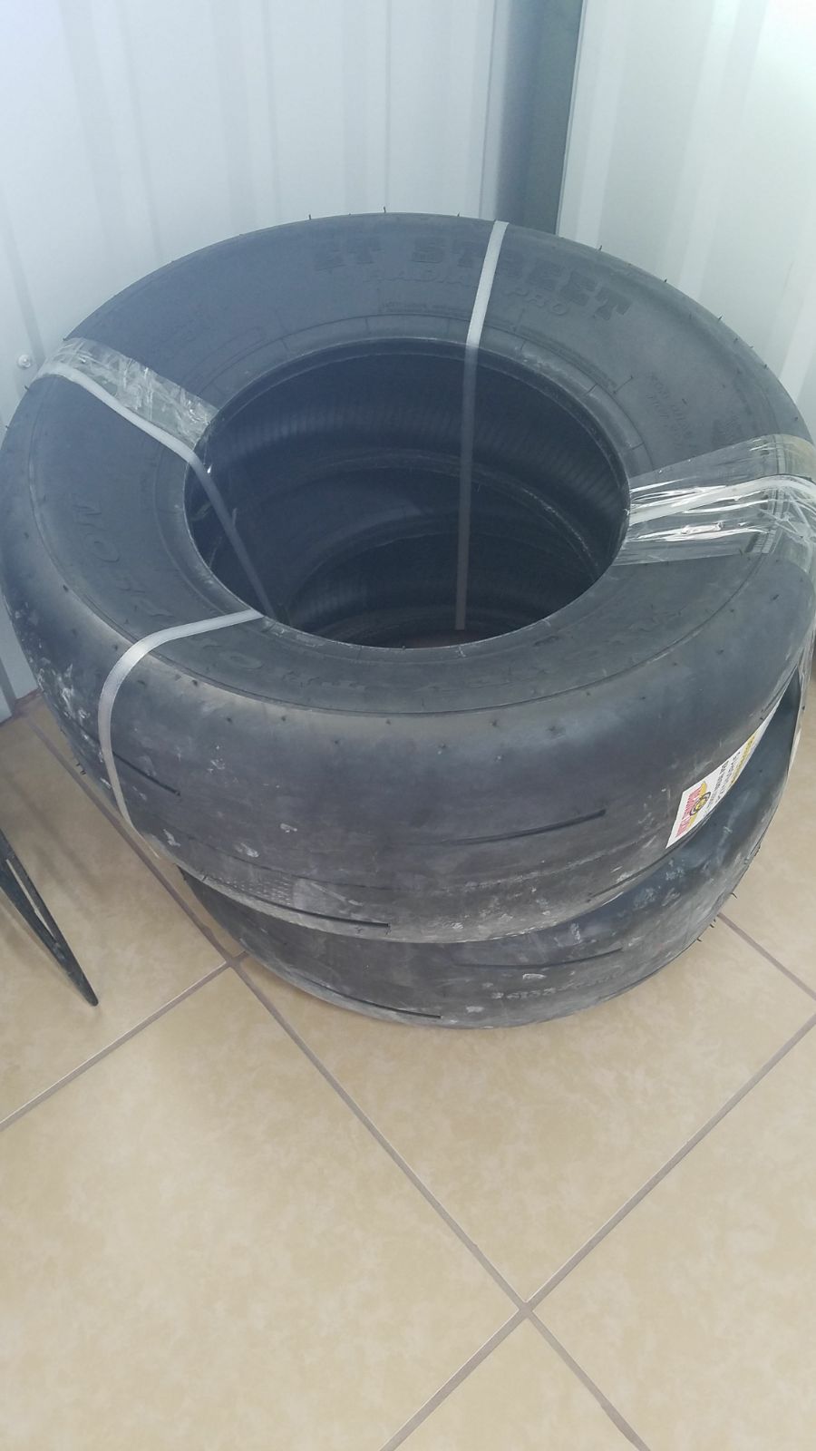

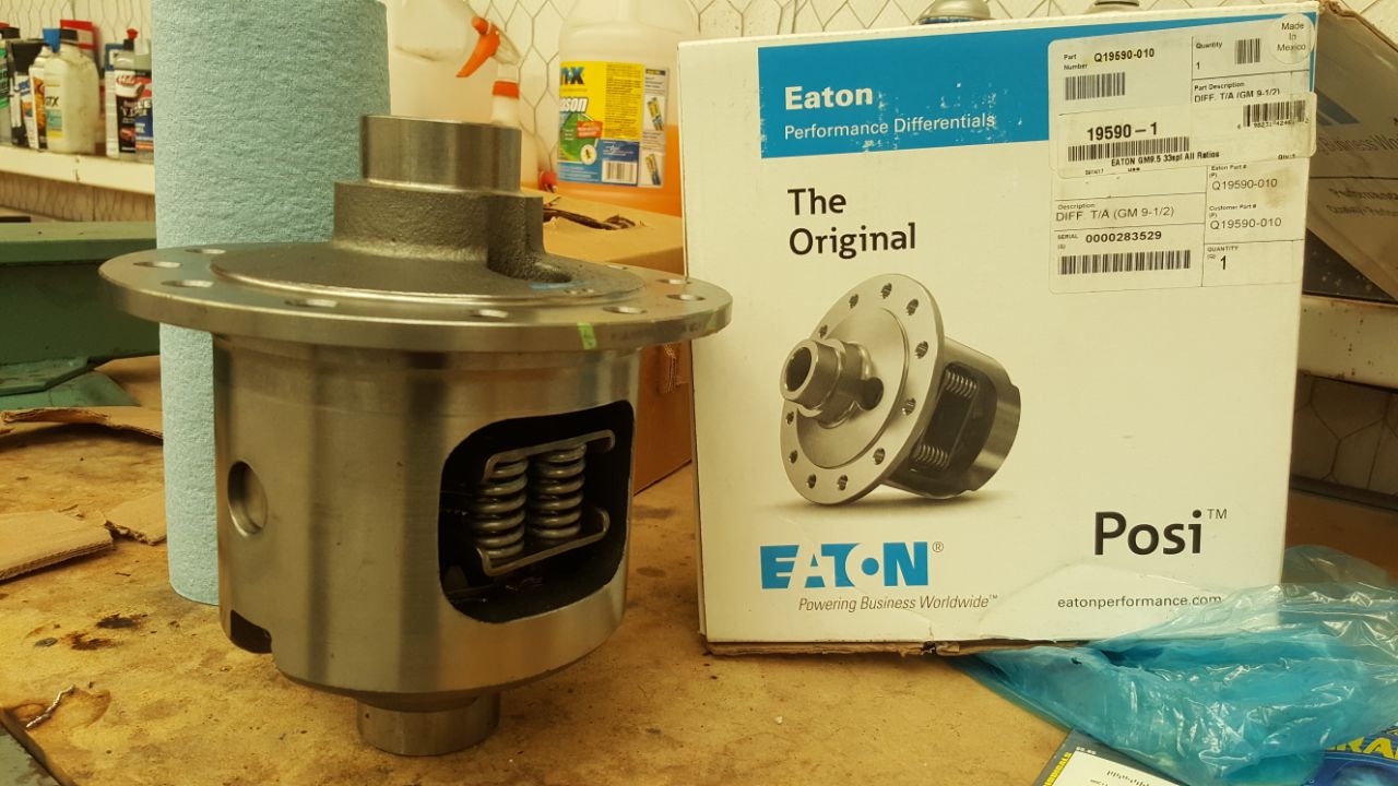

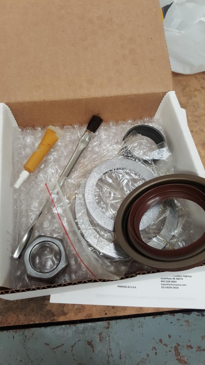

Got some new parts for the truck, its time to upgrade to something better then a stock g80 so i got a eaton limited slip 19590-010, basic install kit and new tires 275/60-15 MICKEY THOMPSON ET STREET PRO DRAG RADIAL
Install start tonight if u got any advise con changing the LSD its appreciated

The carrier preload shims won't be the same for the G80 vs the Eaton. Somewhere in my build thread I listed the exact shims I ended up with on my Eaton Trutrac. It was always 100% silent. Stock 3.42 gears with the original ring gear transferred over to the Trutrac. I didn't remove the pinion gear or change the pinion shims.

i was planning on using the same ones if they look good, im glad u bring this up, i will keep the pinion as it it aswell, i´ll look that up in your build thread, btw did u use new bearing or the ones from the stock g80?
thank you
