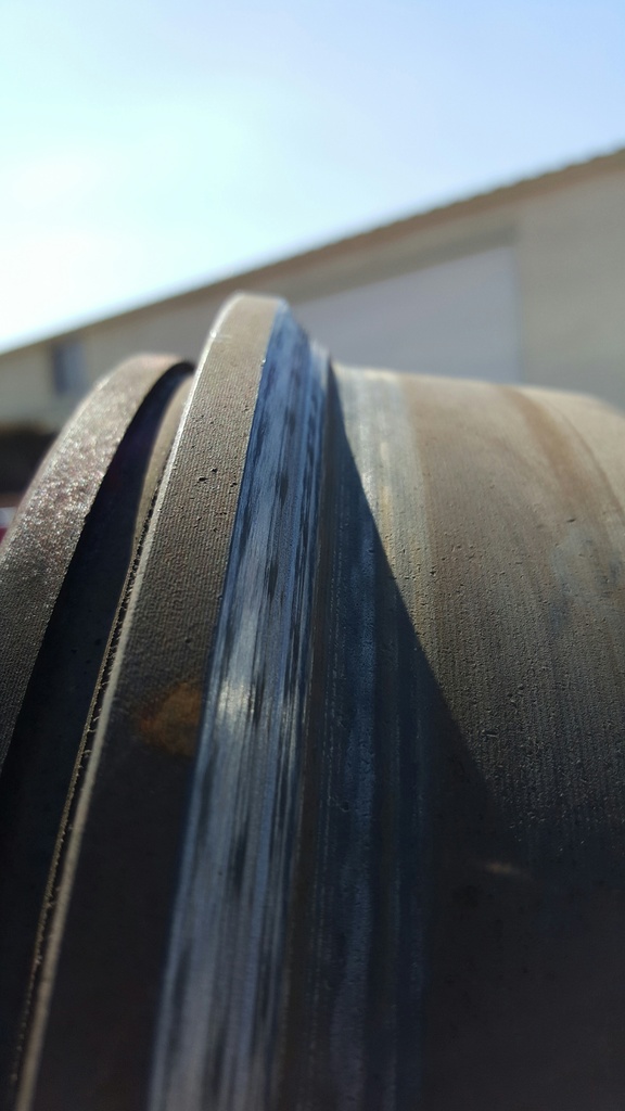

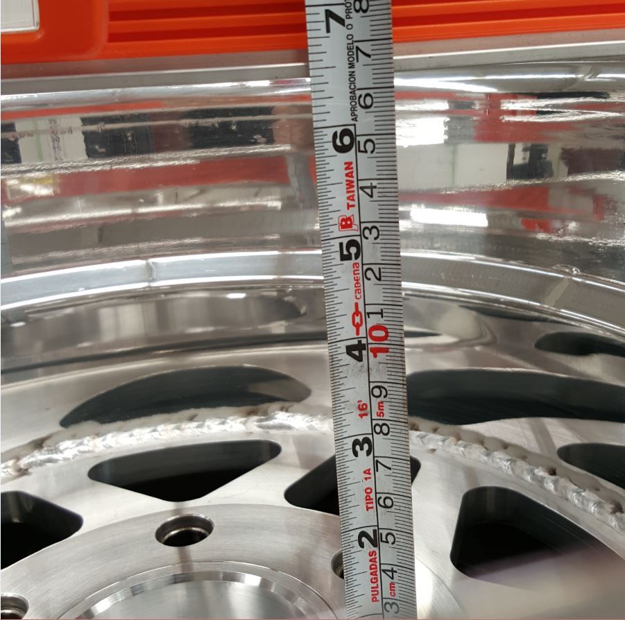

If u look closly its actually not 6.5" backspacing it 6 7/16"
Even like that my wheels didnt fit but it was a easy fix, Rich@bogarts said i was the first having that problem with drum brakes and was willing to have me a new set of wheels ready for the next day with a little less backspacing but i didnt think it was fair to make him spend money on a new set of wheels and shipping when i could easly fix it
I had the drums machined a little on the edge touching and now they fit like a glove

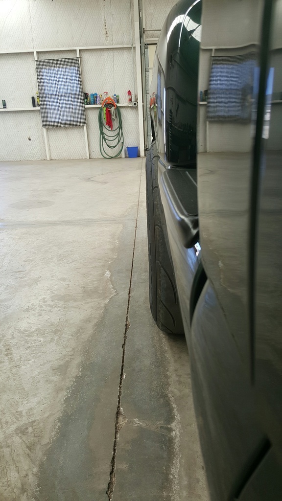

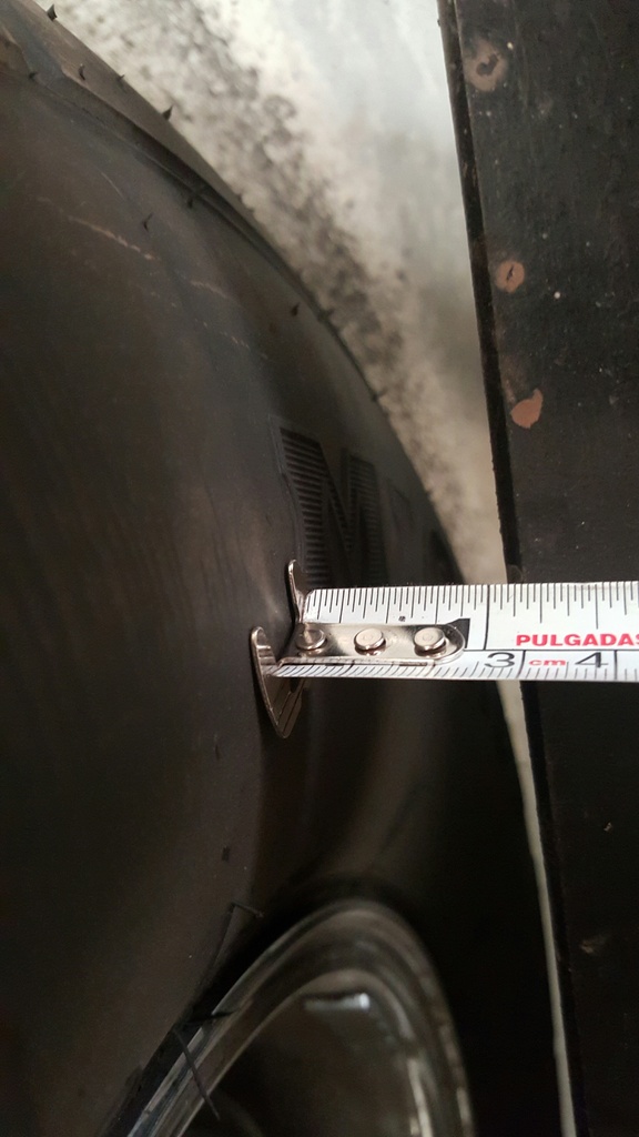

Now to the question from Byrdman11, this is the clearence i have with a 295/65 tire

If i would do this all over again i would ask for a little more then a 6.5" backspacing, i know many members here are happy with that backspacing and i know its not far off but IMO the tire sticks a little to far out, maybe it looks different because its a step side not sure, im just glad i didnt go with a 315 tire
It occured to me having the drums machined in the area im point to 1/4" or 1/8" havnt fisicly looked how tick the area is, if i did that on both sides maybe i would look a little better

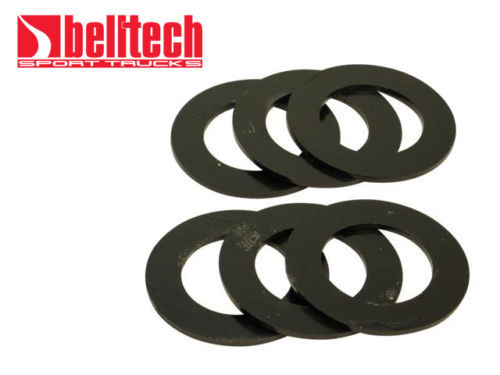

I dont think i had mentioned this before but after i put the truck together i saw right away passenger side was WAY higher then the driver side (13/16" difference in the front and 1-13/16" in the rear), since there had always been a little difference and i knew it was "chevy lean" problem i tried to forget about it but over the weeks it started to bug me everytime more, it was very noticable
Since i was pretty sure the difference hadnt been that big before i had everything apart it made me think if it could be the leaf springs so i changed the left to right and right to left, BIG difference now i still have the chevy lean problem but way less (12/16" difference in the front and 11/16" in the rear)
While im at it i´ll try and fix it as much as possible, i just ordered belltech 34931 3/4" front spring spacer wish i plan on installing on the driver side front
Im mentioning this in case u take off the leaf springs mark them and put them on like they came off

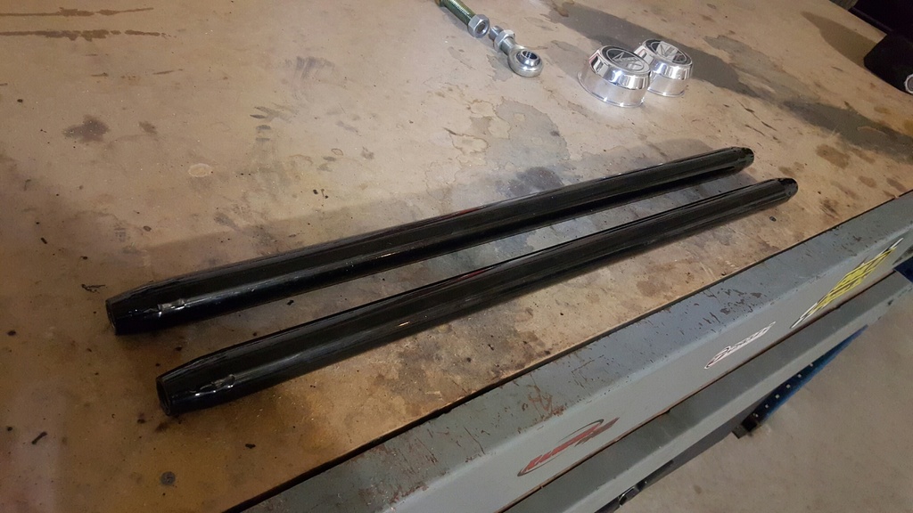

Hadnt posted finished pictures of the traccion bars i made, i bought the plans for them for 10 bucks and made them with the help of some local machine shops

I welded the new mounts on the stock leafspring mounts and had them powdercoated
As u can see i had to cut a peace out of my belltech lowering bracket wish i have seen more members have to do to use caltracks (also had that bracket powdercoated after cutting it)

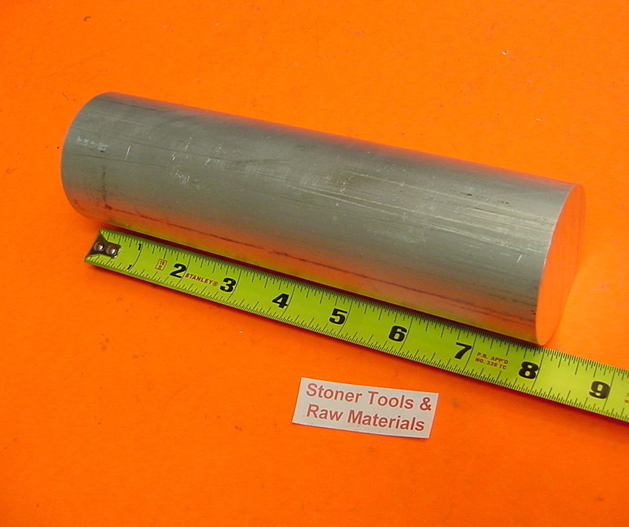

Had the aluminum bushings made from a aluminum bar

I welded heims into bars with a mig welder and found out its not easy to make a nice looking welding on that small round area with a mig welder so i grind the welding flush and had the bars powdercoated aswell
