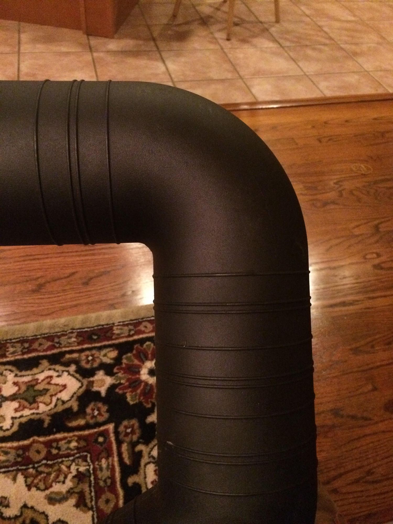

OK so I started to make a little progress with my intake already. I don't have any pics, but this is what I have to use. It's a 5" tube.
I'm bummed at how sharp the angle is, but I have no choice. There is no room for anything else. I will be looking into making a dual 4" into single 5" over the winter with both filters behind the headlights. I will have to relocate my battery to make it work.

Be a lot easier if you want to make it from metal. Start with a 90, trim one leg so it fits, then section out the inside of the turn and add a lot of material so its a big radius. Could probably do it with plastic but it would be harder.

Thats the problem... a big radius literally wont fit. I'm not using the tight bend by choice. There is no room for anything larger.

I know, right? One of the benefits of the jackshaft was the smoother inlet of air... so much for that.
I have the 5" close to fitting. I played with it last night a little late when I got home.
I may take richards advice and just drive it around without the intake tube on... but i dont feel like redoing my tune to run without meth and blah blah blah...

Take out 5 degrees on the bottom half of the map. Done. Like I said you are just testing airflow, and you don't care about power for this test.
