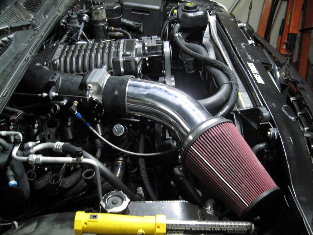

Try a 5incher

I have 5" tube waiting in the wings but its tough to get it to fit... I dont have as much room as you.
Here is the current elbow. its all 4".

So the meth is tapped into the aluminum tube I assume?

go pro under the hood would prove boot collapse theory

I doubt that small amount of tubing is collapsing. Especially with a bend in it. The ones that seem to have that issue is the long straight pieces.

Could it be that the 90* bend is too sharp? Need a smooter curve? U got lots of air turbulence going thru a sharp bend?!!?

Under vac one with a bend will collapse well before a straight. Not sure that your actually pulling a vac there or not. Break out a gauge.

Take hood off. Stick head out of window and take a peek WOT'ing down the highway
