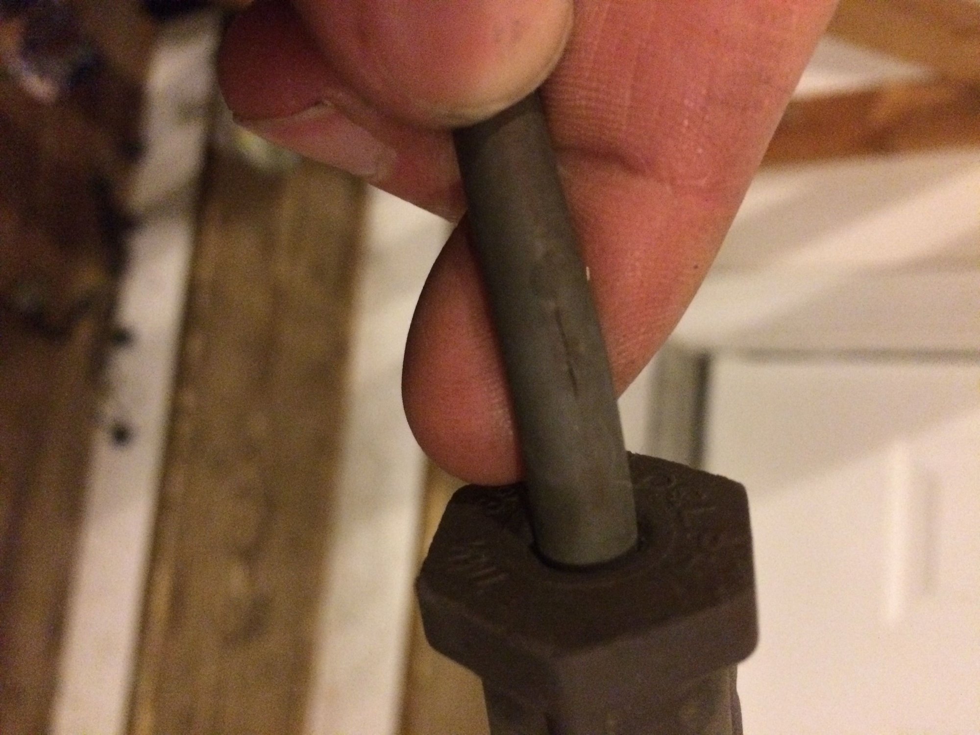

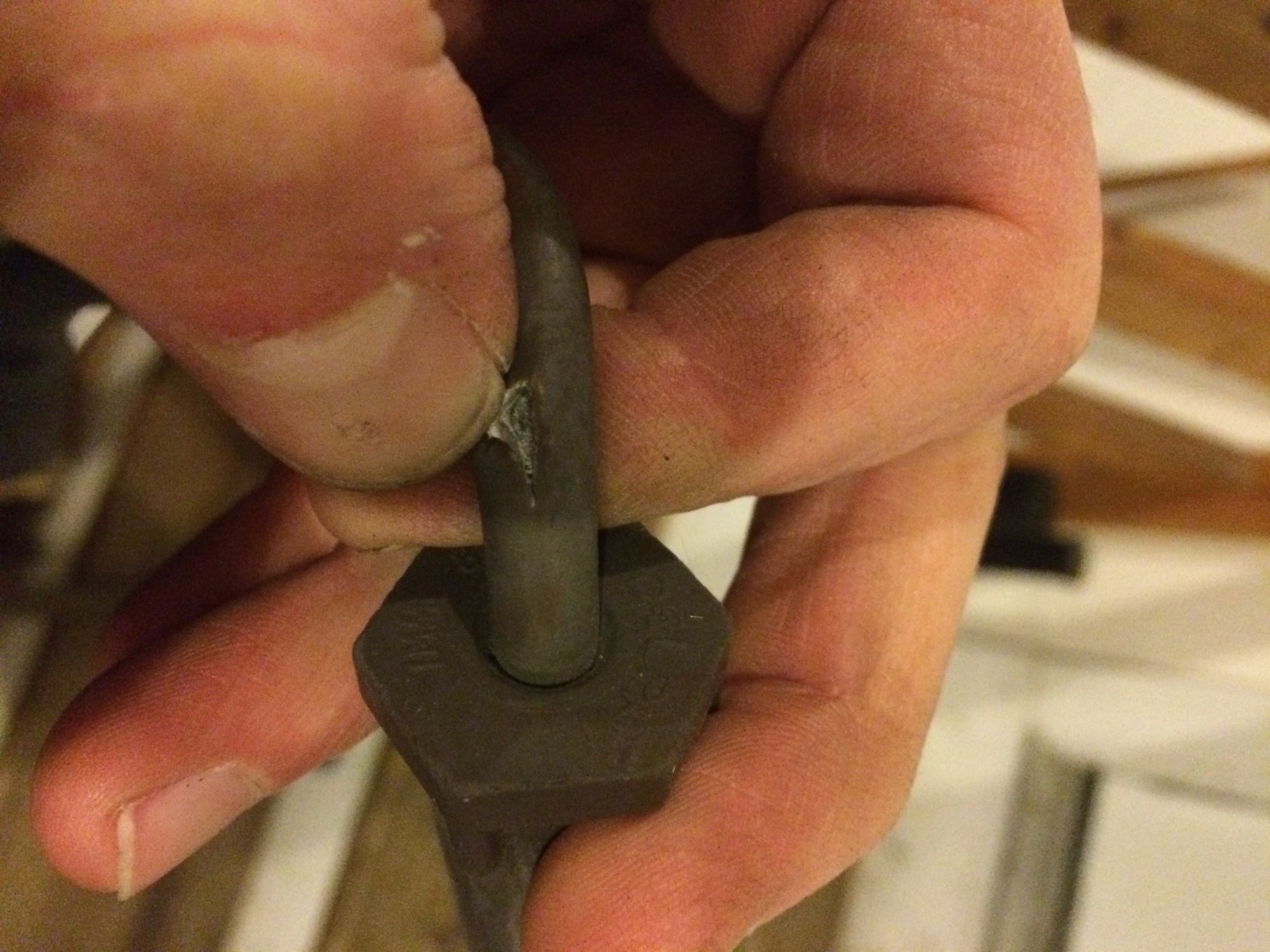

Finally have some new plug wires on order... I think I may have found my most recent issue.
Again cyl #4. I have wire boots on there... but this is right up against the dip stick tube.

  #499
Atomic's Avatar
I have a gauge for that
Posts: 16,282
Likes: 438
BOOM! Told ya!

1FastBrick's Avatar
Custm2500's Rude Friend
Posts: 14,593
Likes: 900
From: JunkYard
Even though your running those wire insulators, is there any thing around the dip stick area the wire could catch on or cause the damage your seeing?
Header Flange?
Is the Dip stick bracket sharp in that area?
