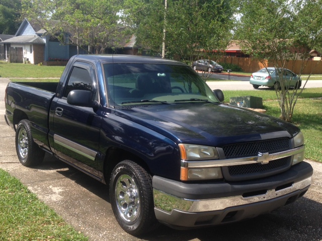

Looks familiar! I was lucky and got a V8 in mine though. Is it Auto or Manual?

Its an Auto - your truck looks great looks like a short bed?!?!??!

Yea its short bed, I would of preferred the long bed for hauling but its working great so far! Mine is also a 5 Spd. So its a pretty fun truck as it is!
