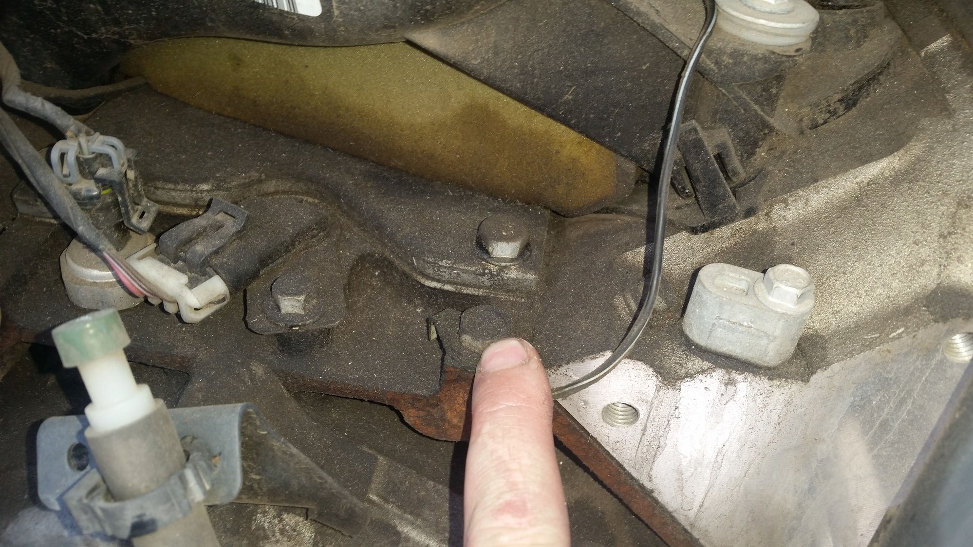

The gauges not functioning correctly sounds like a ground issue.
I had this happen recently. Found a mouse chewed through rear ground on passenger side rear of block. It had a No crank condition. No gas gauge on cluster. Some of the other parts of cluster not functional.
Pictures of the rear grounds for reference.
Passenger side rear of block engine harness ground.
Driver side rear of block engine harness ground.
