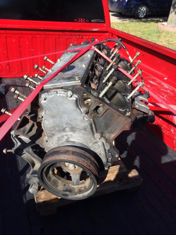

heres my motor

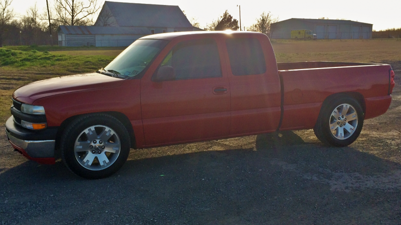

and heres my truck just got my 20's a couple weeks ago gonna get some 265/50-20's to bring it back down 1.5 inches where it used to sit on my 17's.
plans are to drop it more @ a 2/4 currently (springs/schakles,hangers) going to at spindles and do a flip, keeping the hangers and putting factory shackles back on which should put me @ 4/8???

Subscribed.... Good luck man good looking truck love those factory 20s

Nice Truck.. look somewhat like my 2000,
I did a engine swap on mine last week from a 5.3l to a LQ9 6.0l punched out to 6.2l w/ factory LS3 pistons & rods, anyway i also had the 862 heads but had them machined and installed factory LS1 valves & springs also ported and polished, Along with the other bolt on's & Tuning as you can see on my profile the truck ran pretty good, but not quite the cam your running, but after the swap and using the same cam in the 6.2l I see why people like the 6.0l so much, This thing runs like the 5.3l on spary.. I was just wondering why your going back with a 5.3l instead of a 6.0l..
