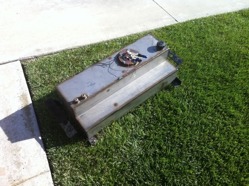

Fuel cell's doing great! Had to pull it out three times in one week while I was upgrading to bigger fuel pumps and it wasn't the easiest thing in the world but it was pretty damn easy considering what the alternative used to be.
Only thing I would of changed in our designs was to add taller baffles, much taller. When the tank is below a 1/4 tank and I take a hard corner the engine will cut-out from the pump pick-ups going dry.

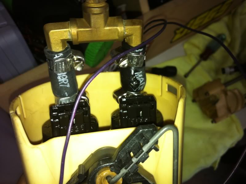

First time I pulled the tank was because fuel pressure was dropping under boost, soon as I pulled the bucket out I found some of the fuel hose had burst, also the joint feed line after the 'T' had a inch long split in it right where it joined the barb fitting....

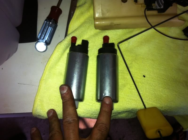

Thought that would solve the problem but it didn't so next time around just put in two bigger pumps...
Twin "Walboro" 340's (Walboro 255's that were modified by a local company)
Fuel pressure's back up to normal and goes up with boost.
