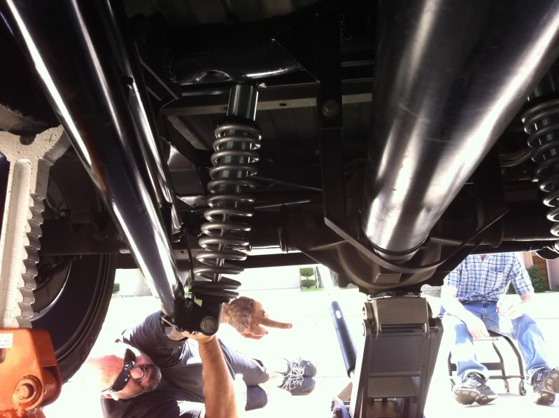

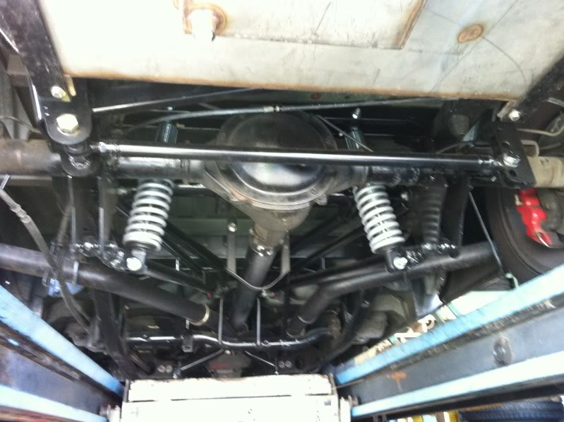

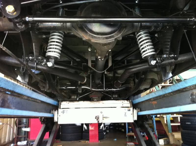

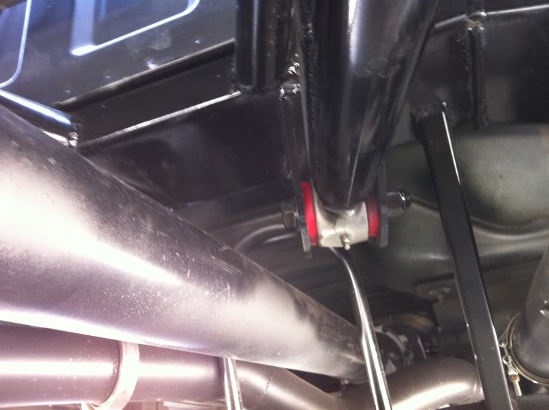

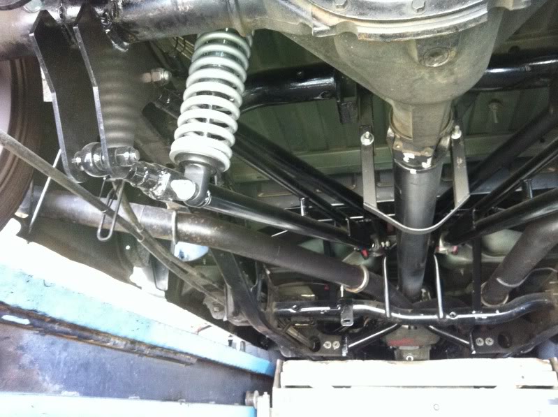

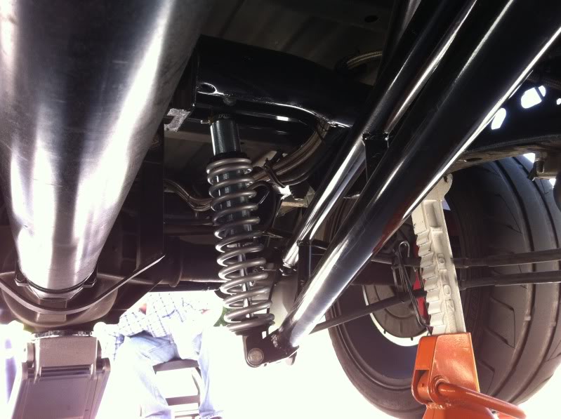

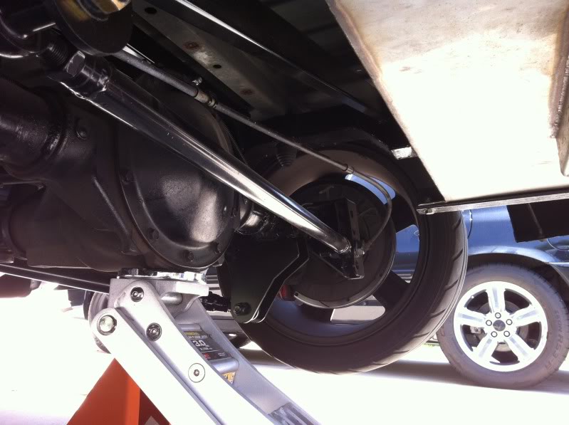

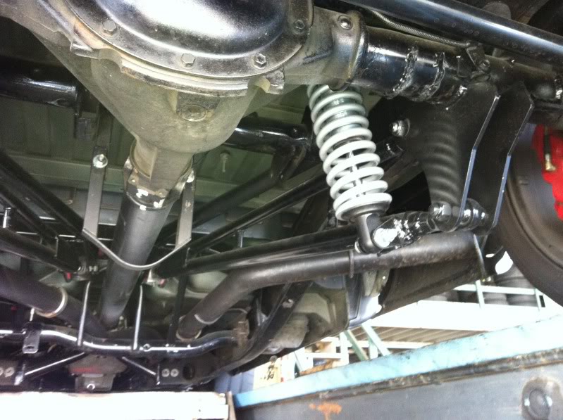

Here's some belated pictures of my suspension and what not. I Haven't been on my computer much so I wasn't able to upload any pics and vids that I've had stored on my iPhone for about a week now.
Design and built by Stoichiometric and the welding work was done by WildeRacing. They know the what's and why's better than I do but all I know is it 30,000 times better than my old set-up.
Best pictures I have of it from far away, consists of two "Truck arms/bars" that triangulate as far forward and up as possible to a crossmemeber that was fabbed up behind the cab. Also a Pan-hard bar that is welded to the drivers side frame rail and the passenger side axle tube. And adjustable Fox Coil-over shocks.

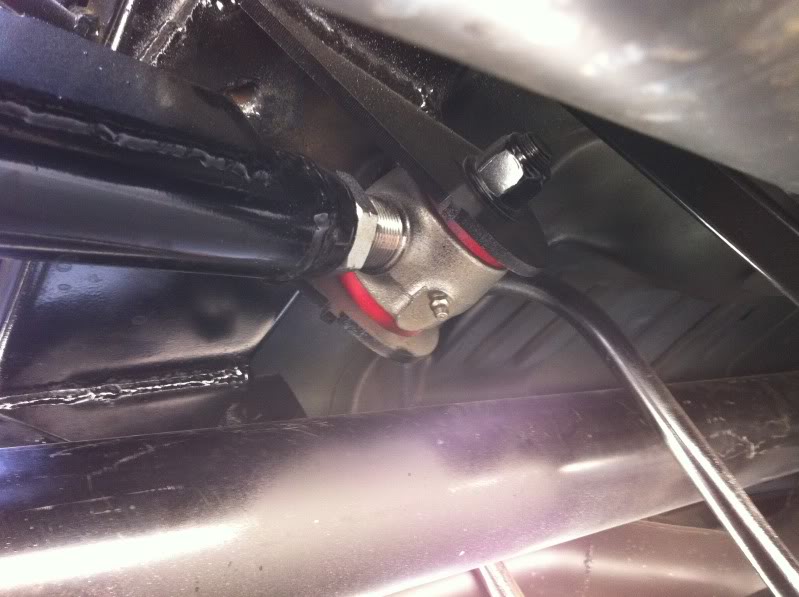

Pan Hard Bar:
Arms/Bars heading back to the Coil overs:
Heading forward:

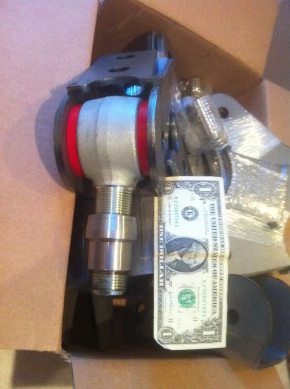

Bigger is better!

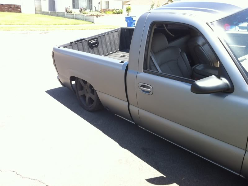

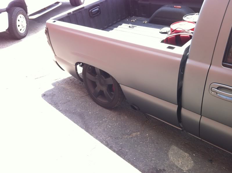

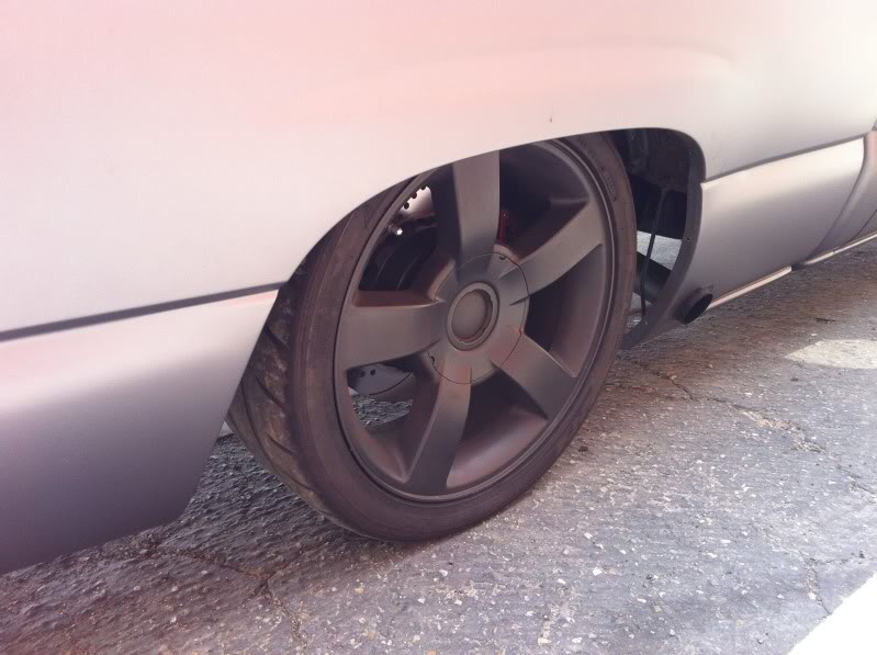

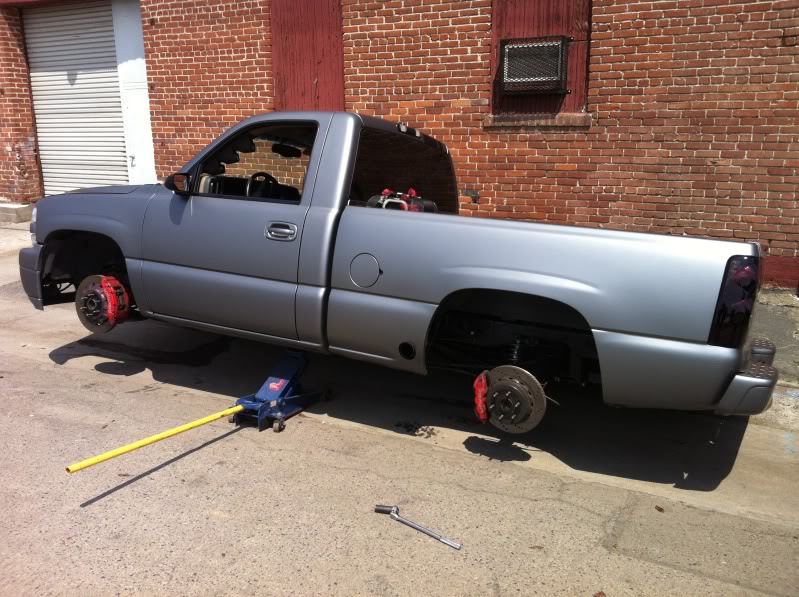

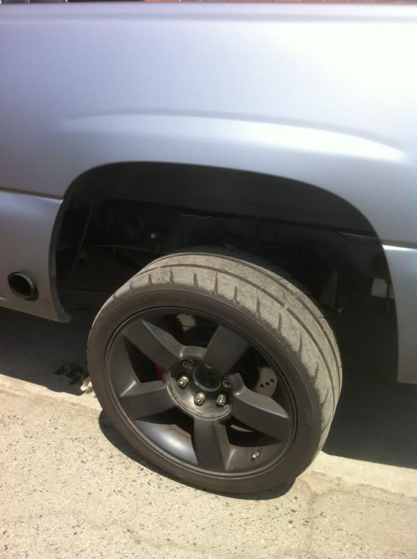

Here's a couple shots of the travel of the rear end, in all these pictures the compressed wheel has another 2-3 inches of travel until it touches the fender:
Size:  74.9 KBName:  IMG_2157.jpg

As far as feel and feedback goes. During the Slalom at the Truckin Throwdown I tried my best to upset the rear end but I never could. I got up to 65mph and the rear end was still very very settled, I wanted to go faster but I couldn't turn the wheel fast enough. Last year during the same event I lost control and spun the rear-end out and almost took out a camera man, that was at 55mph. I'm gonna have to upgrade my steering if I want to test the limits of the rear-end in the slalom. On the road course my problem was understeer under heavy braking, I never was able to swing the back out. Granted I didn't have much power to play with but everytime I'd accelerate out of a turn past the apex the back end would just push me along and never walked itself out. Does a pretty decent job of squatting under hard acceleration but until I put some real slicks back there and go to a prepped track I don't know how well it will do.
When I can get the engine hiccups figured out I really want to push the rear-end to see when it starts to lets go.

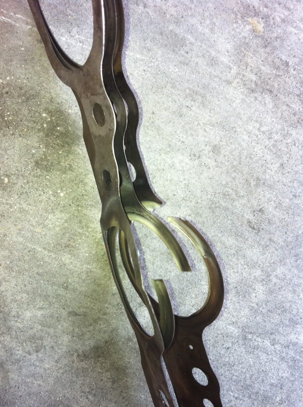

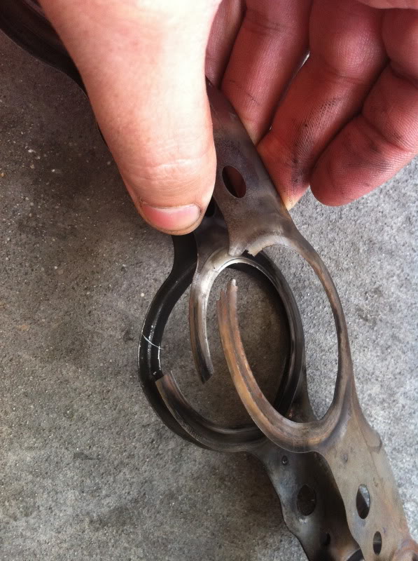

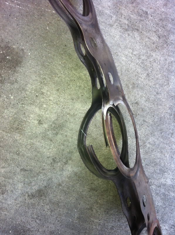

I had a small exhaust leak prior to the mile, and afterwards...it got bigger! Swapped out the exhaust manifold gaskets and I was leaking on 6 of the 8 cylinders. Reason being is that the header flange is smaller than stock, so the exhaust bolts bottom out in the head before tightening down on the manifold. I corrected that last summer by stacking a couple washers between the bolt head and the flange but when I had a shop wrap the exhaust while I was at sea they took the manifolds off and when they put them back on they didn't use any washers or use shorter bolts.
So this is what I ran the mile with!
That was the drivers side, the passenger side wasn't blown out but all 4 cylinders showed signs of leaking. Best part is the turbo spooled alot faster afterwards and that damn exhaust tick was gone!
