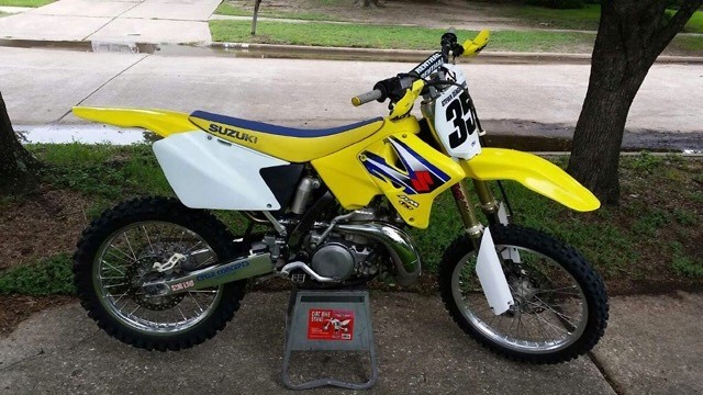

Found a couple pics of the day he bought it. Has come a long way....

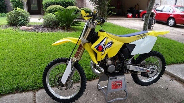

Here are a couple more pics of Version 1.0 that I found also.

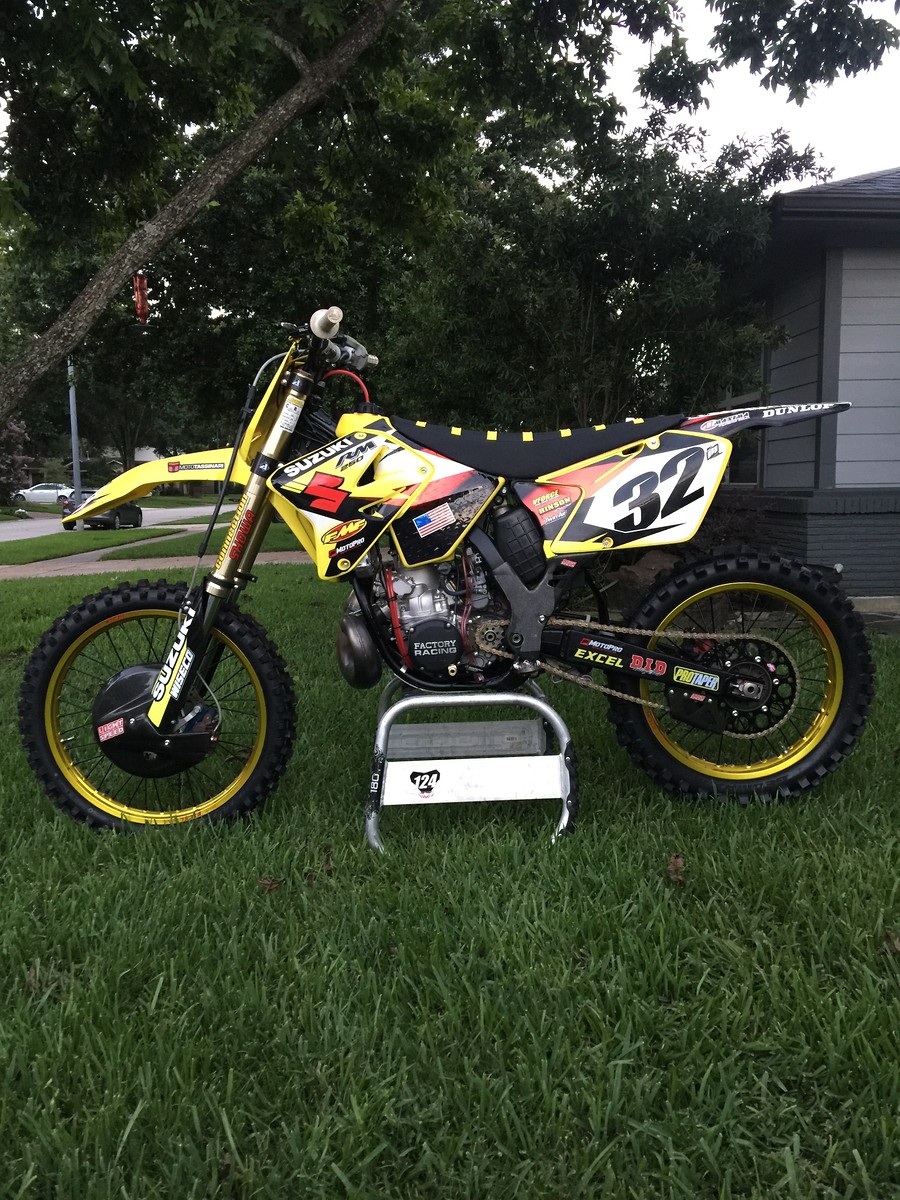

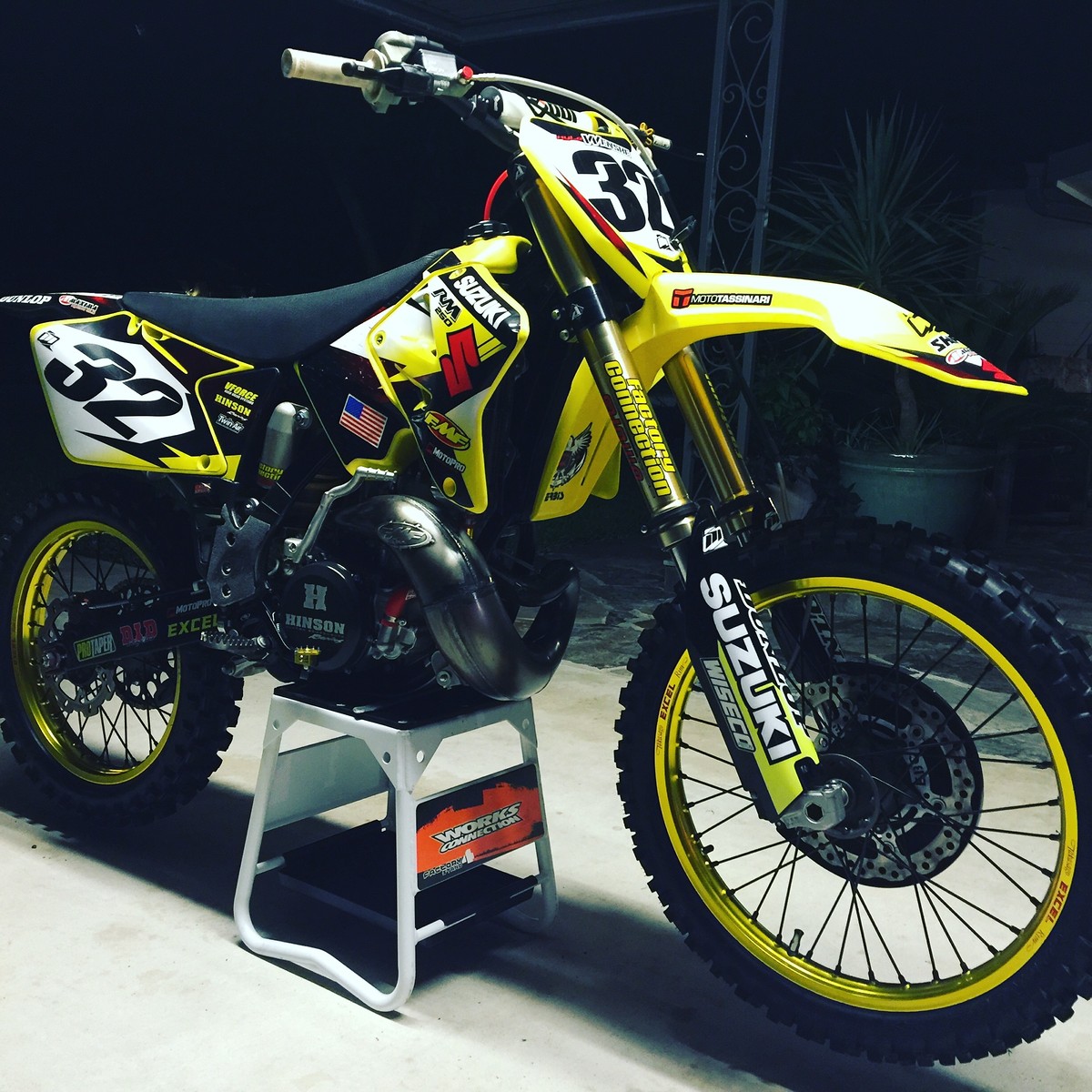

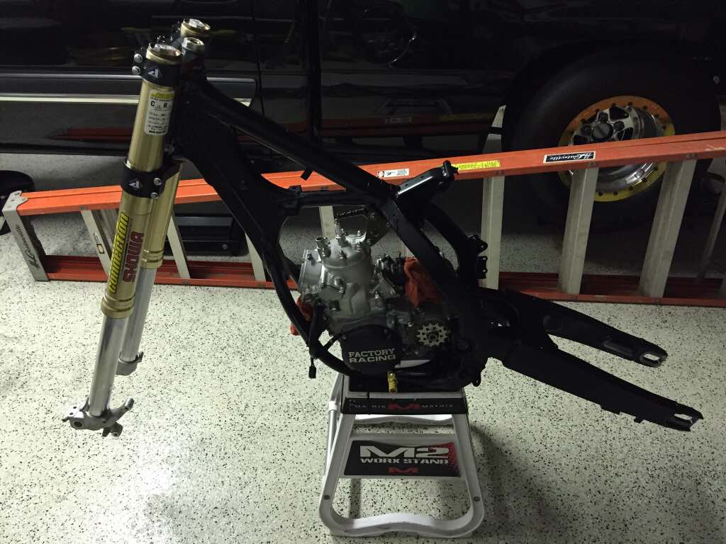

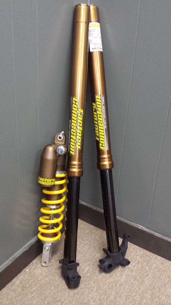

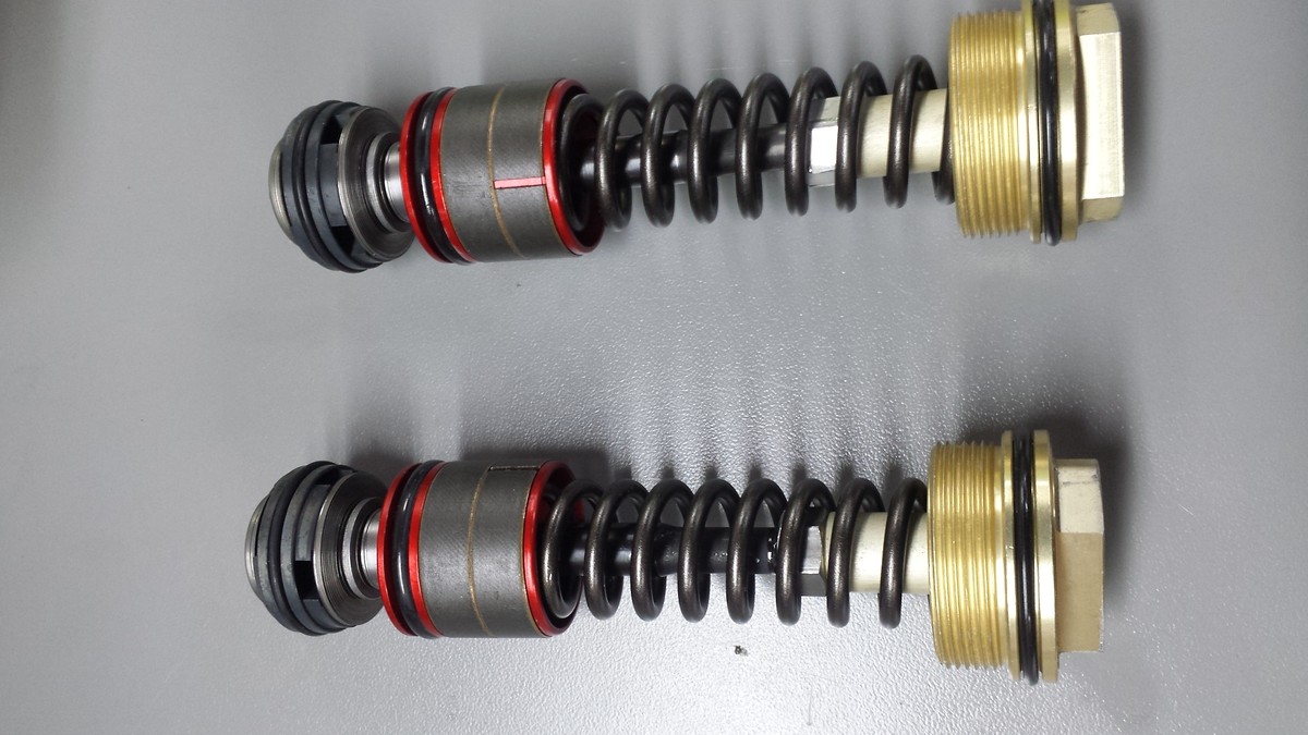

Here are a couple pics of the new Version 2.0 stuff.
The forks have been completely gone through again, and actually got sent to Japan for some crazy proprietary coatings that are only available there. Lots of $$$ in these forks.

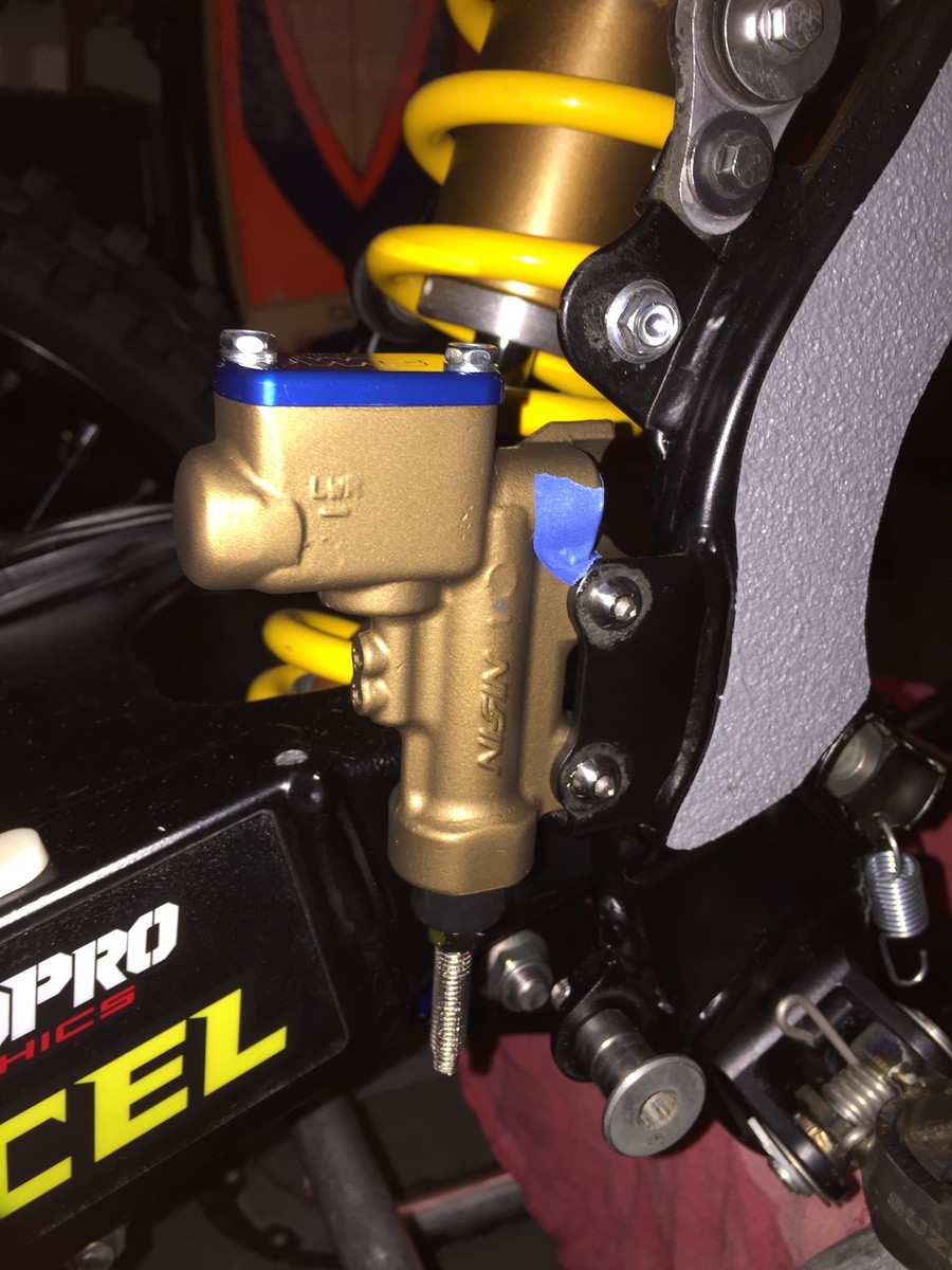

Shitty pic of some custom stuff being done with the rear master cylinder for the brakes. The site glass was removed and welded up so that it could get a hard anodize treatment. Also, I had to do some modifications to a billet clevis as they don't make one that fits. I'll get pics of it soon. Ignore the tape, this was a trial fit.

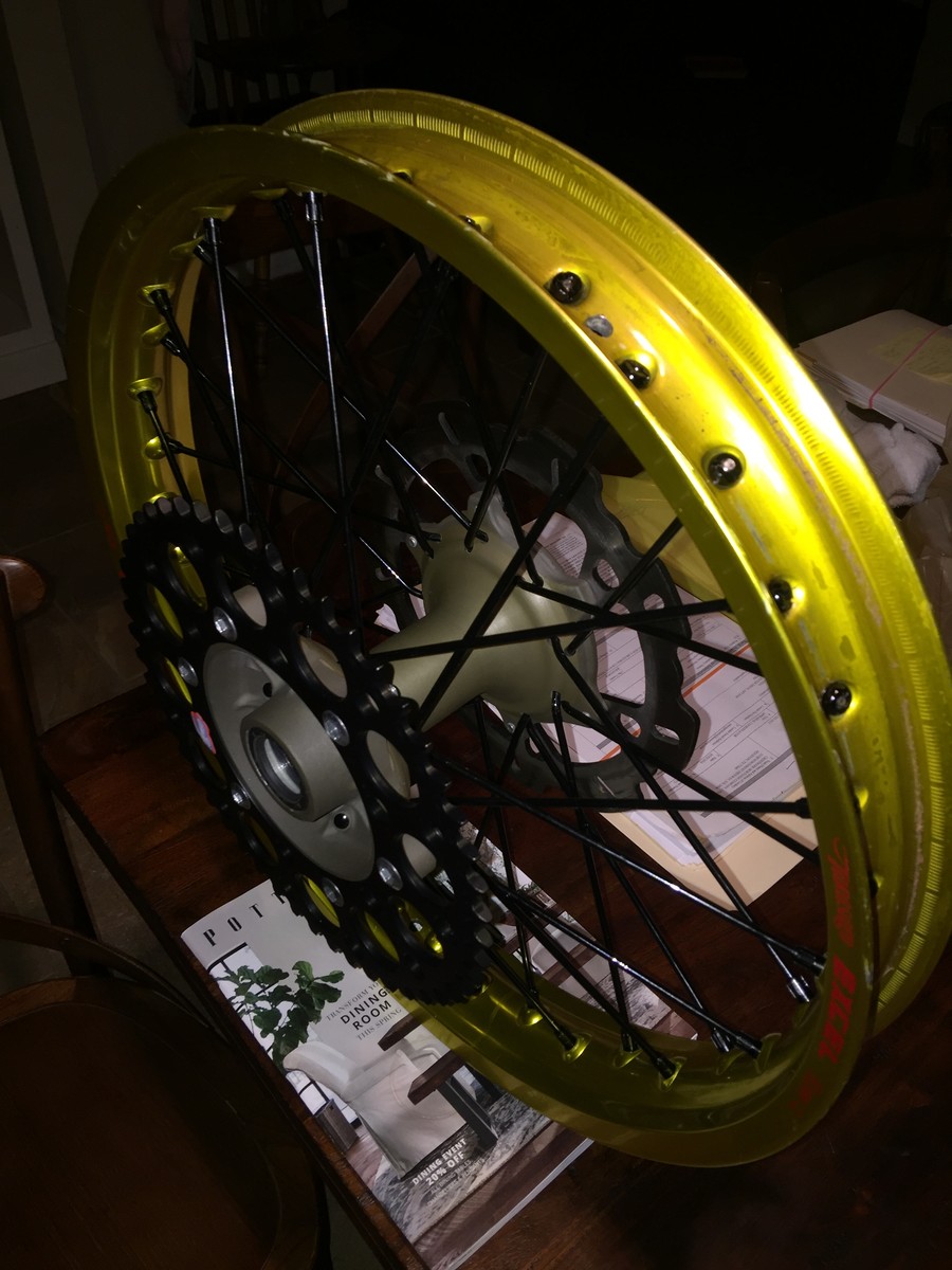

Got the wheels re-laced and trued up

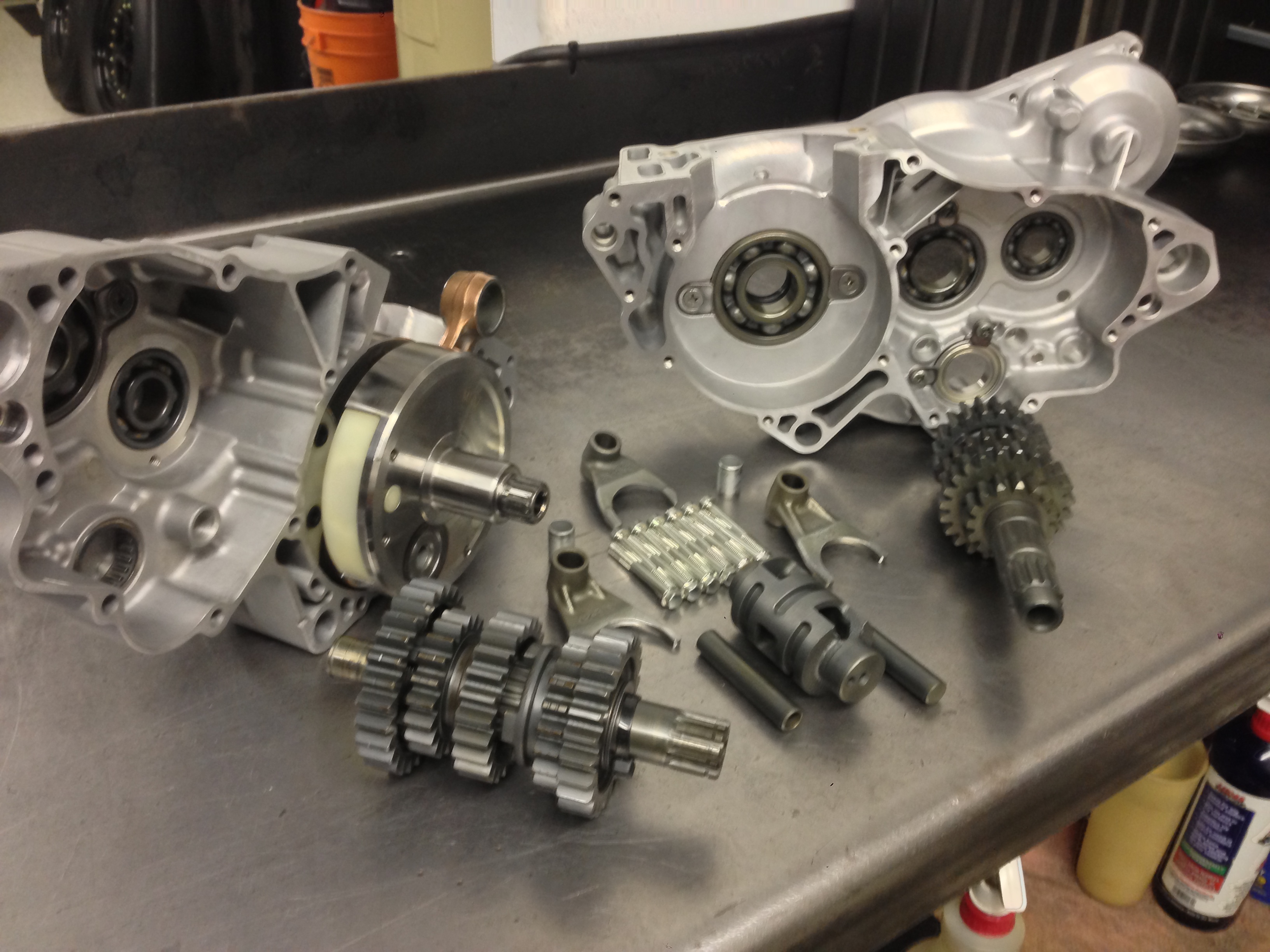

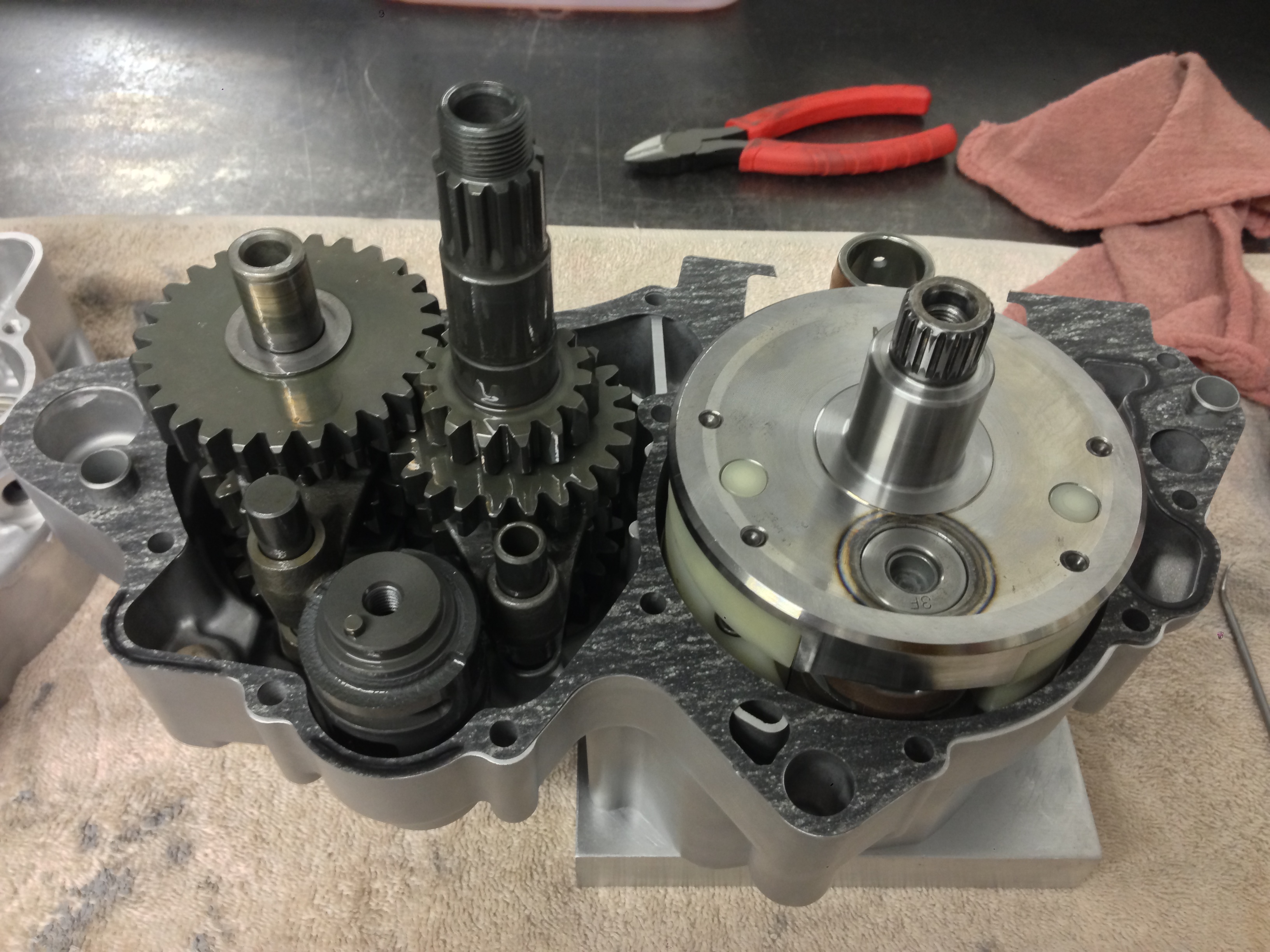

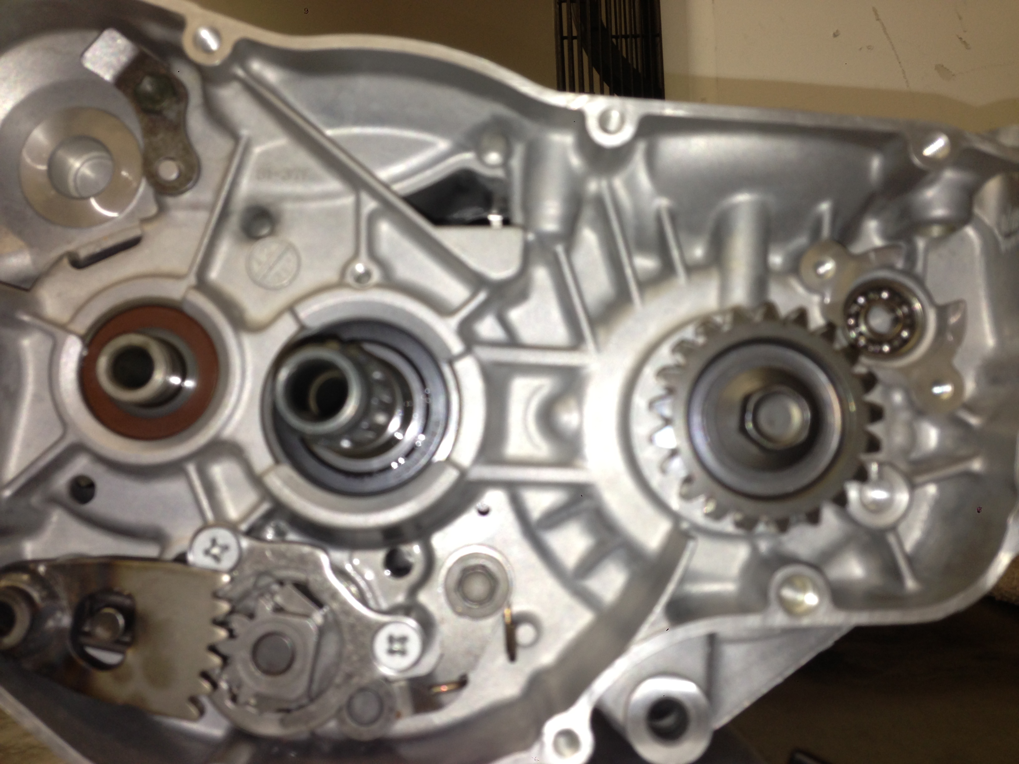

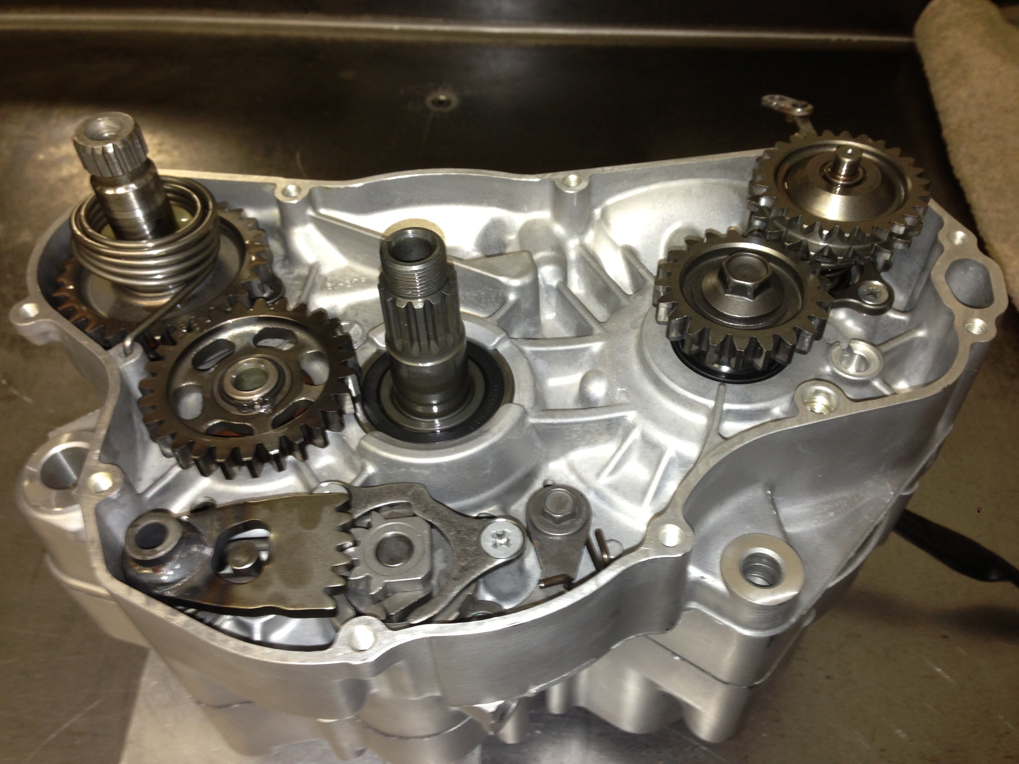

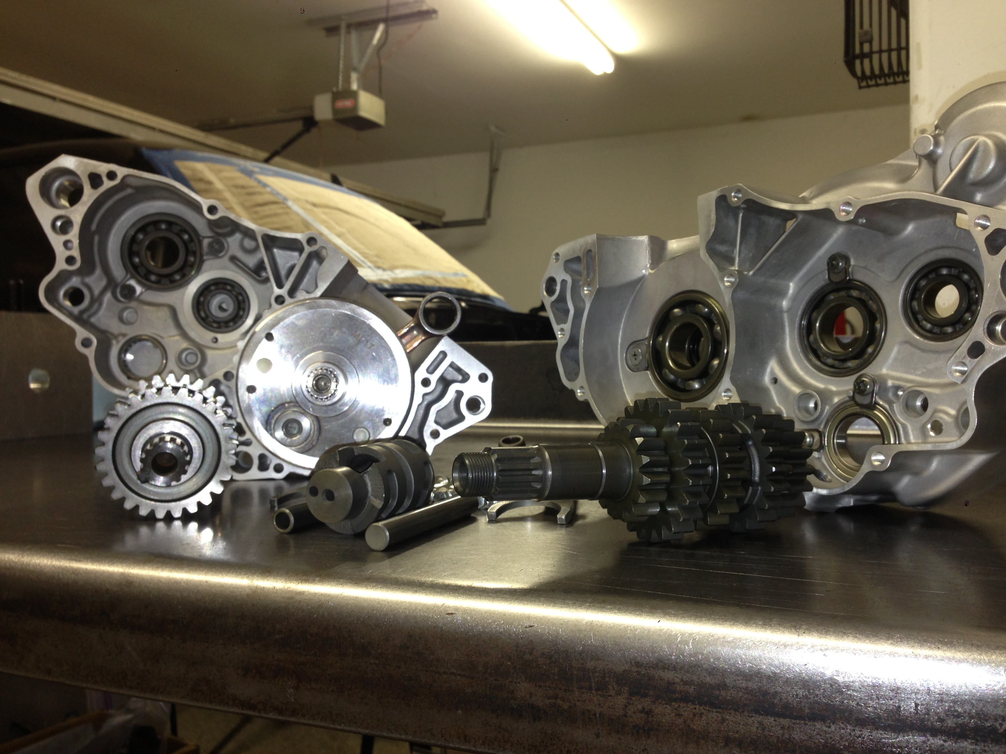

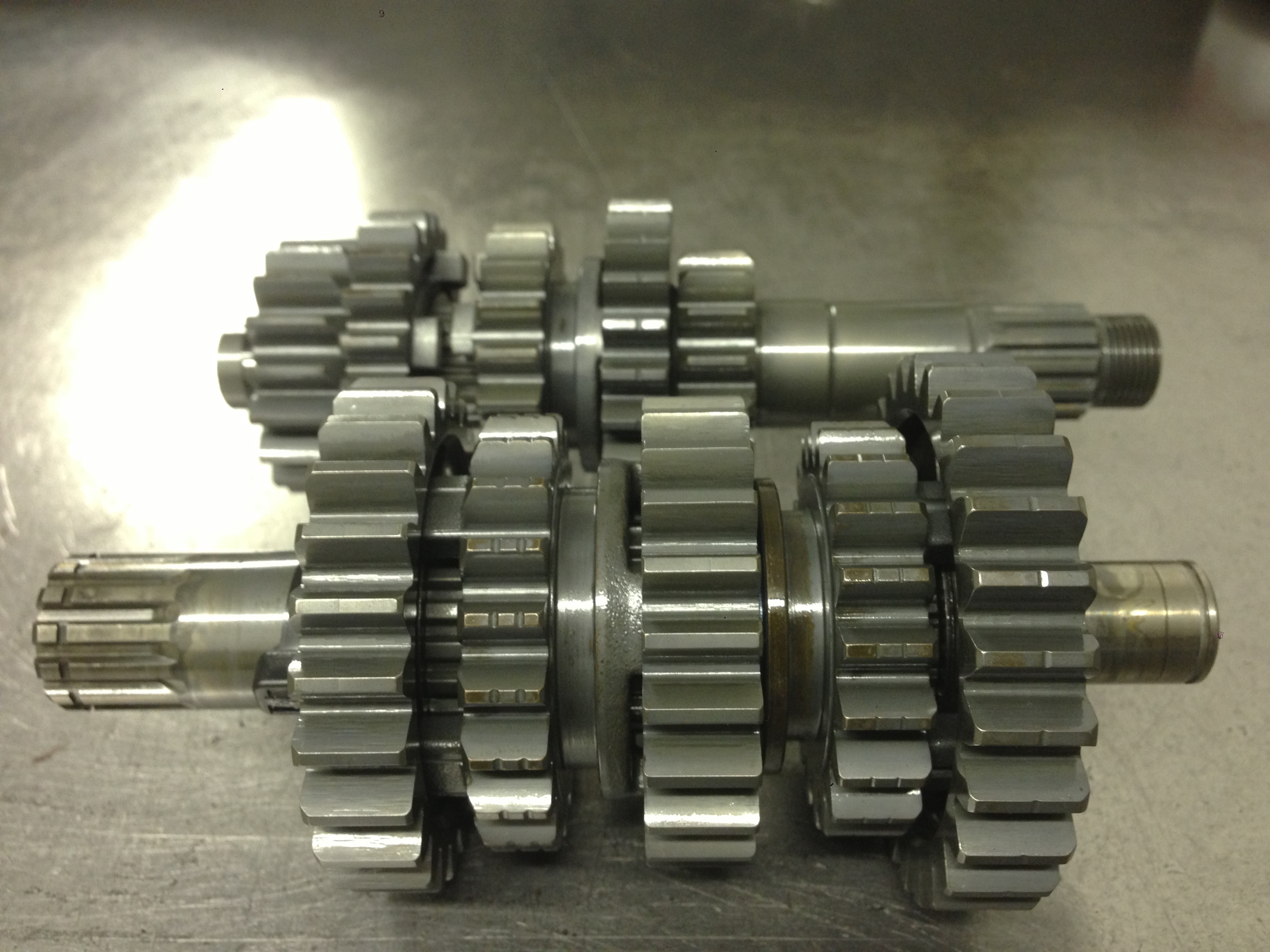

Here are some in progress engine pics.

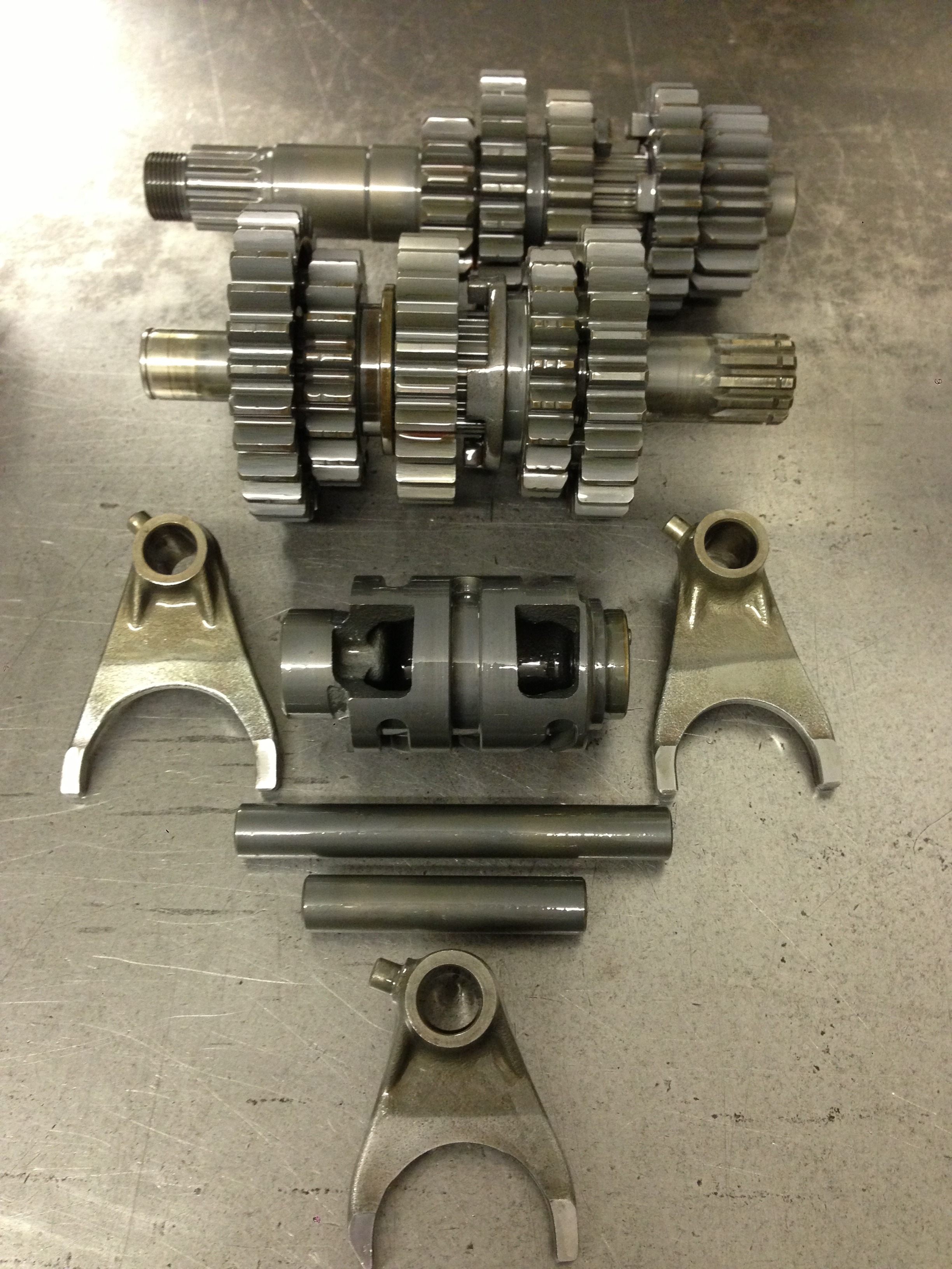

Fully REM polished trans pieces and then Microblue’d

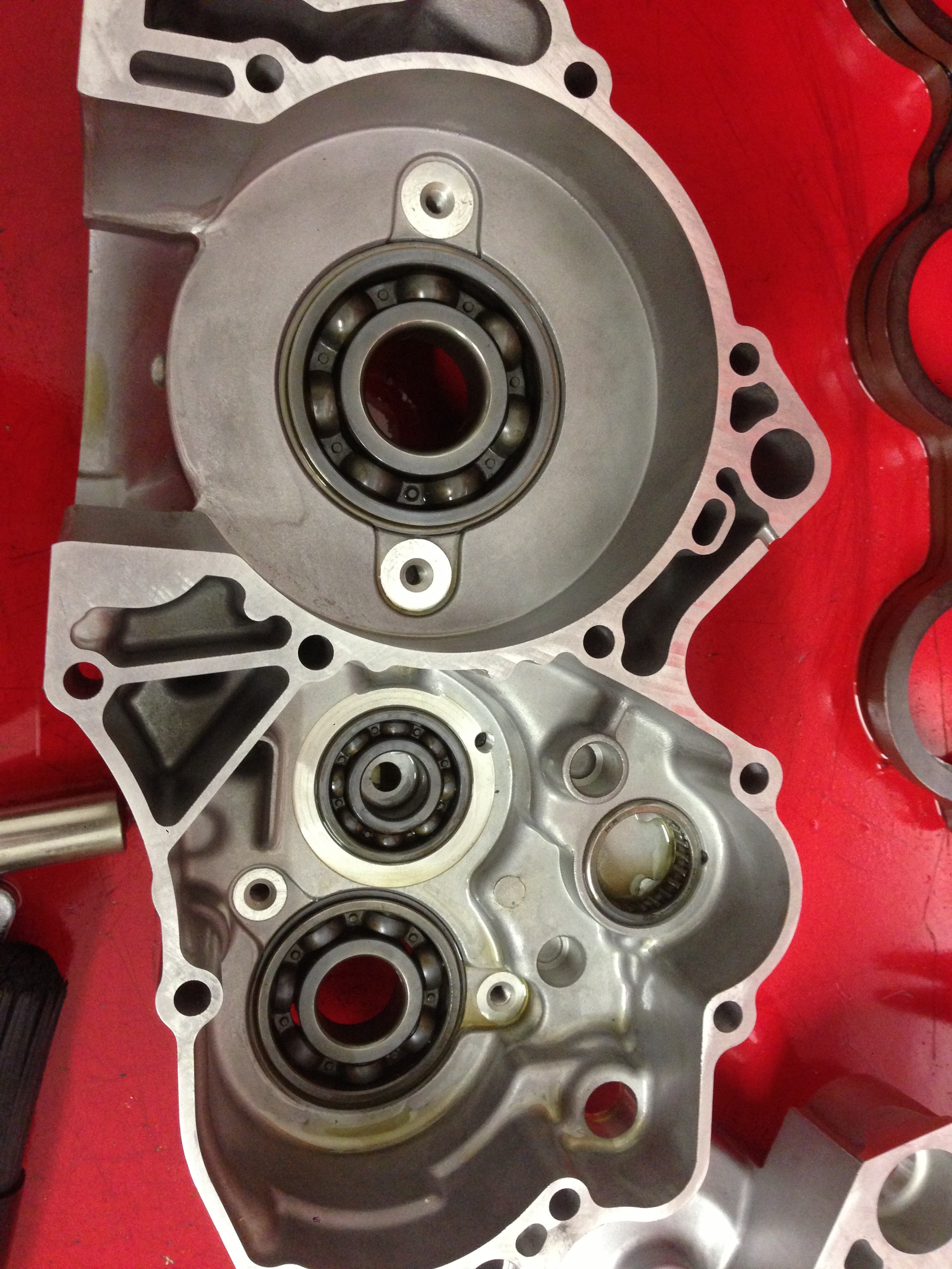

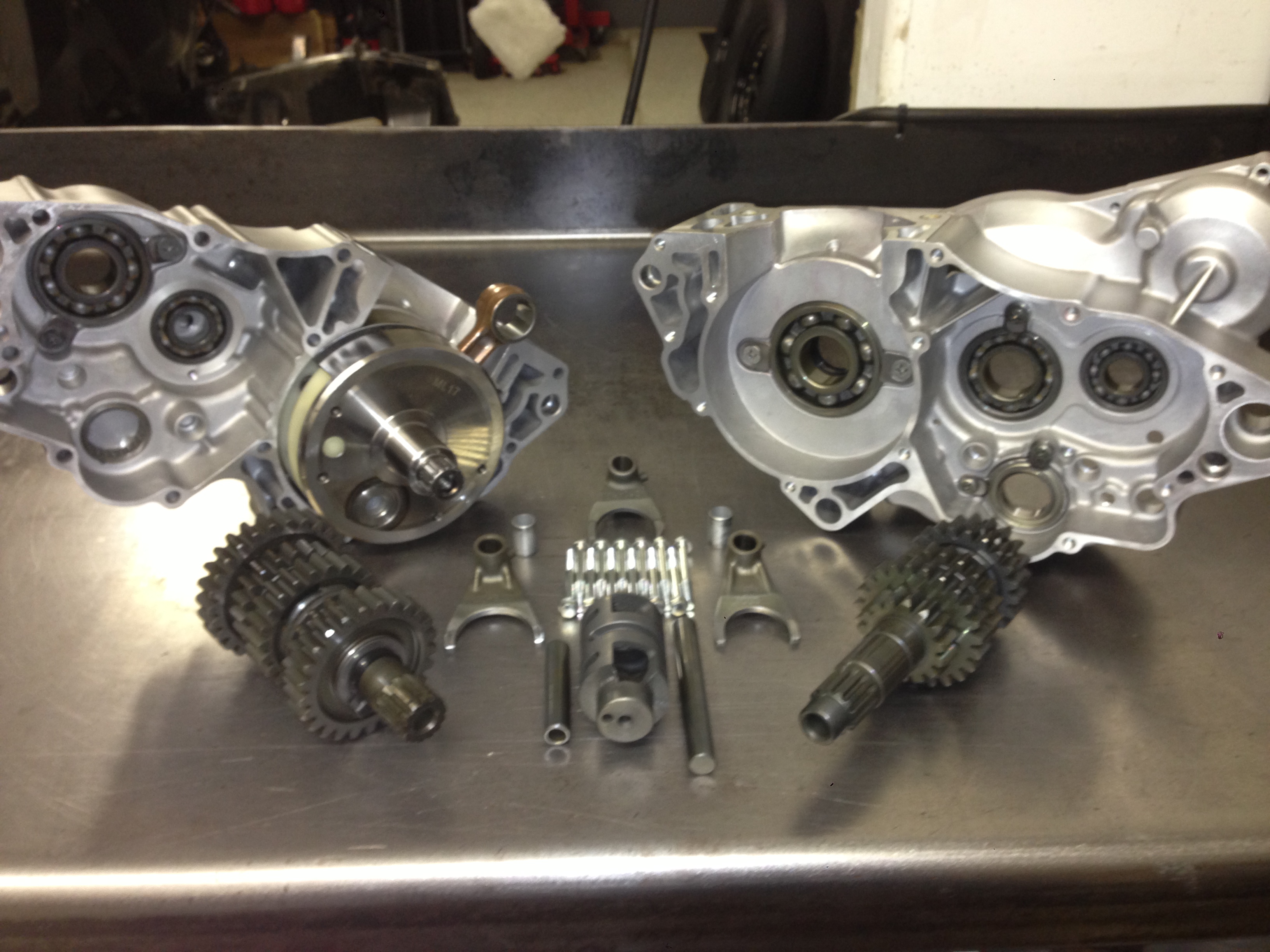

Cases with the new Microblue bearings

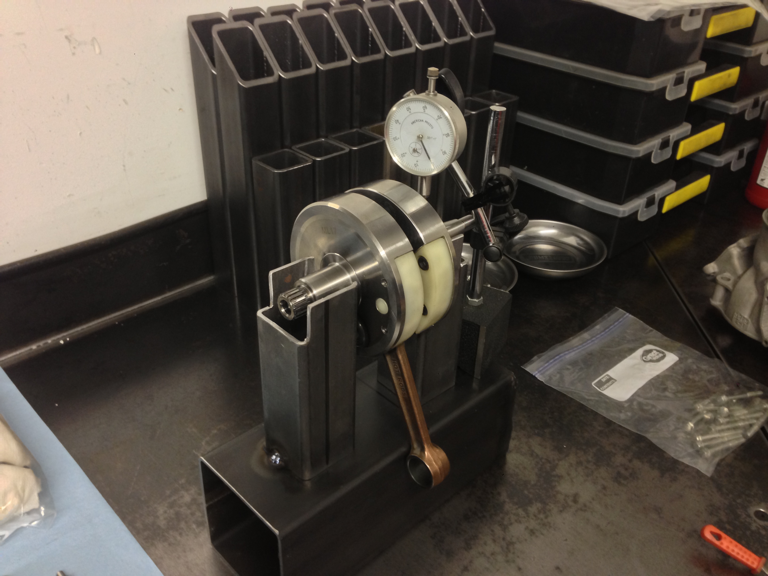

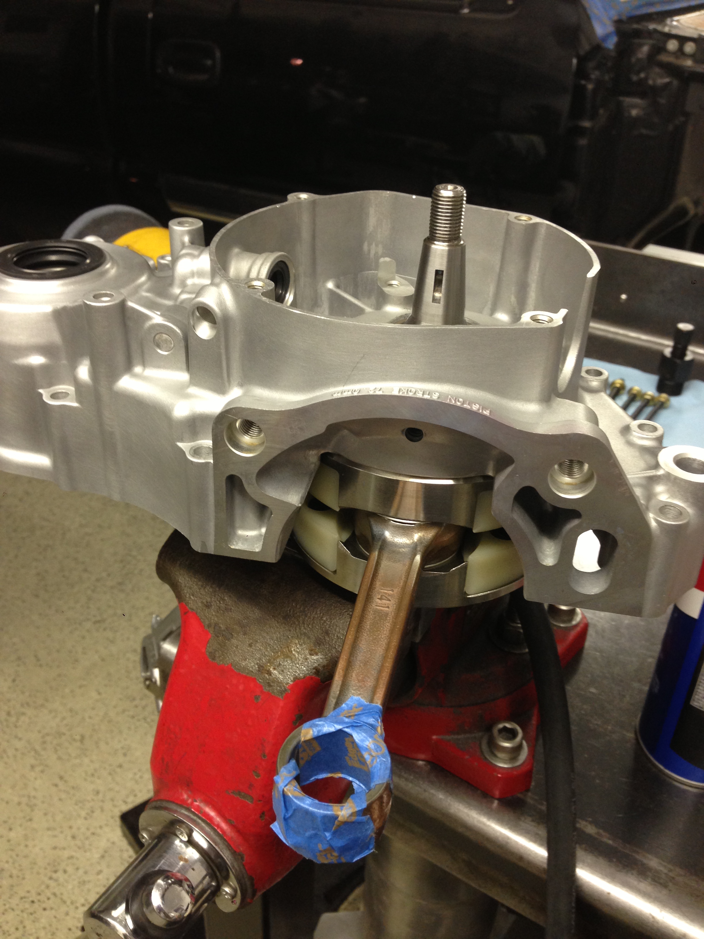

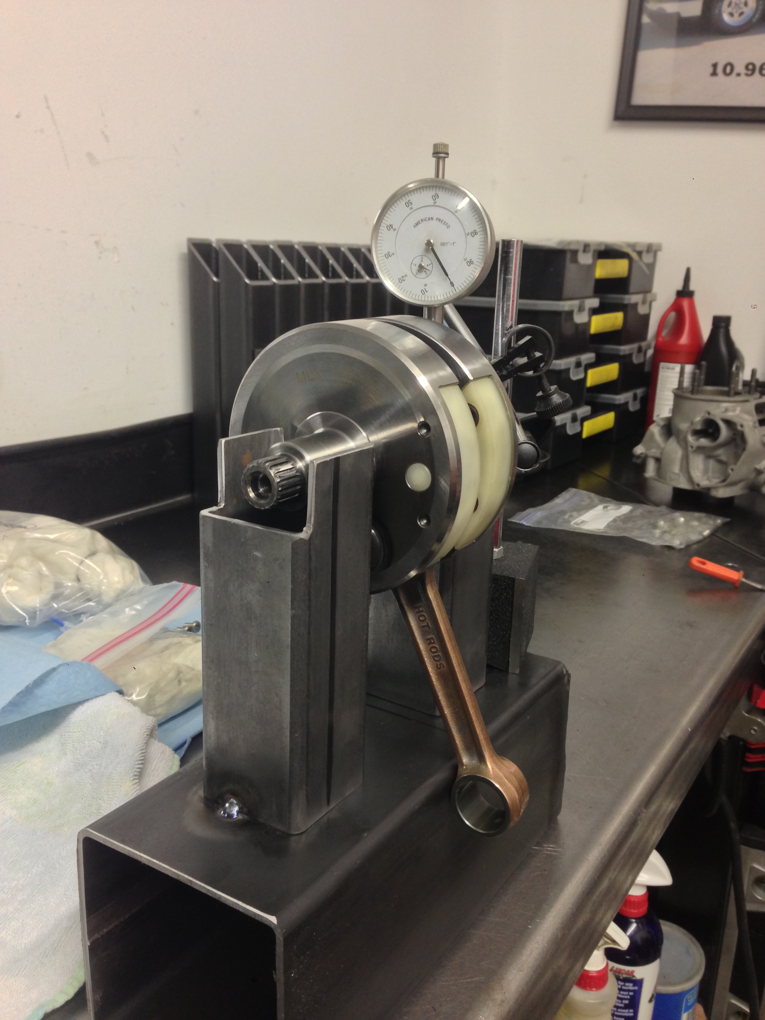

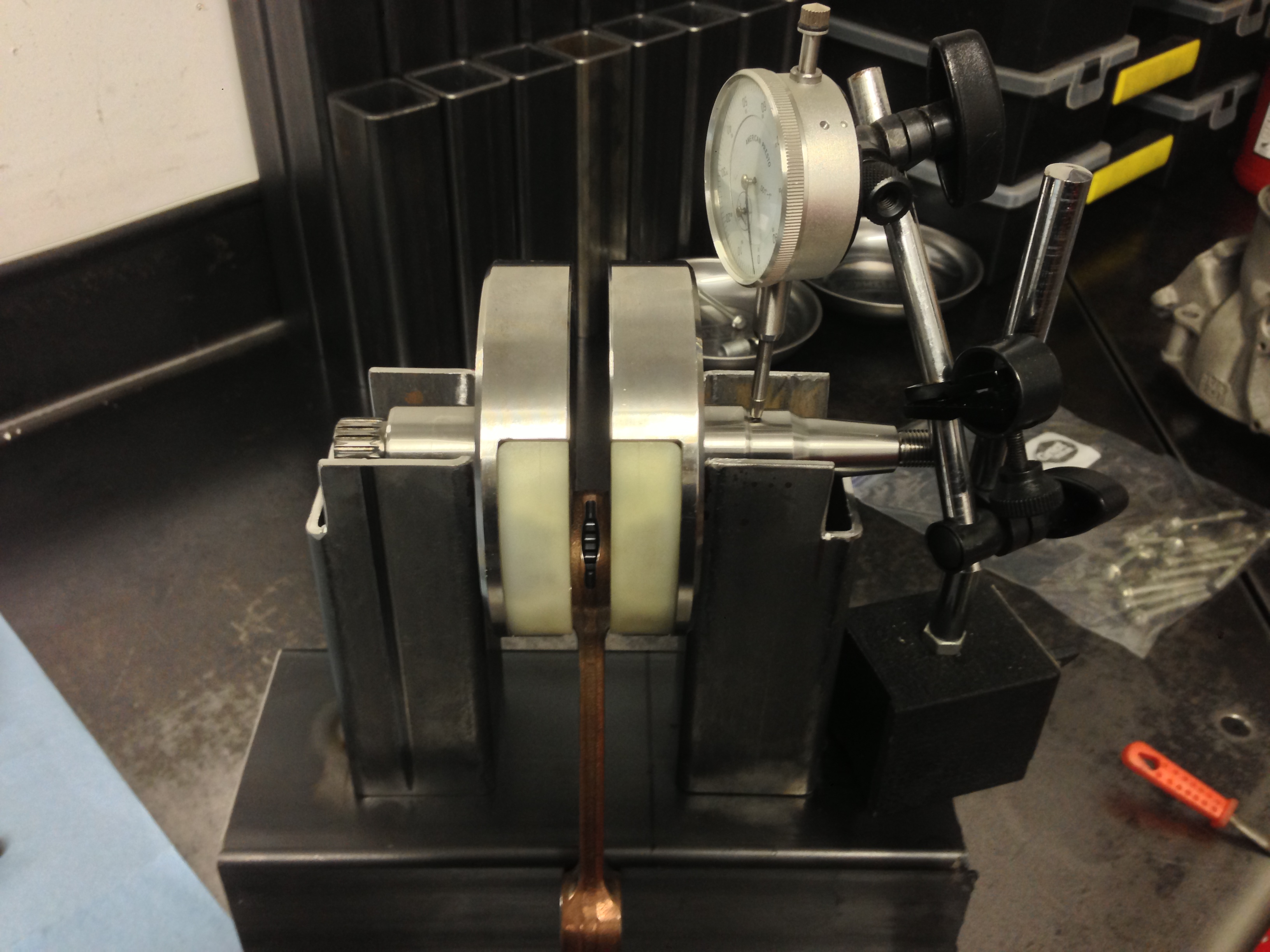

Quick homemade jig to confirm crank true after the balance job

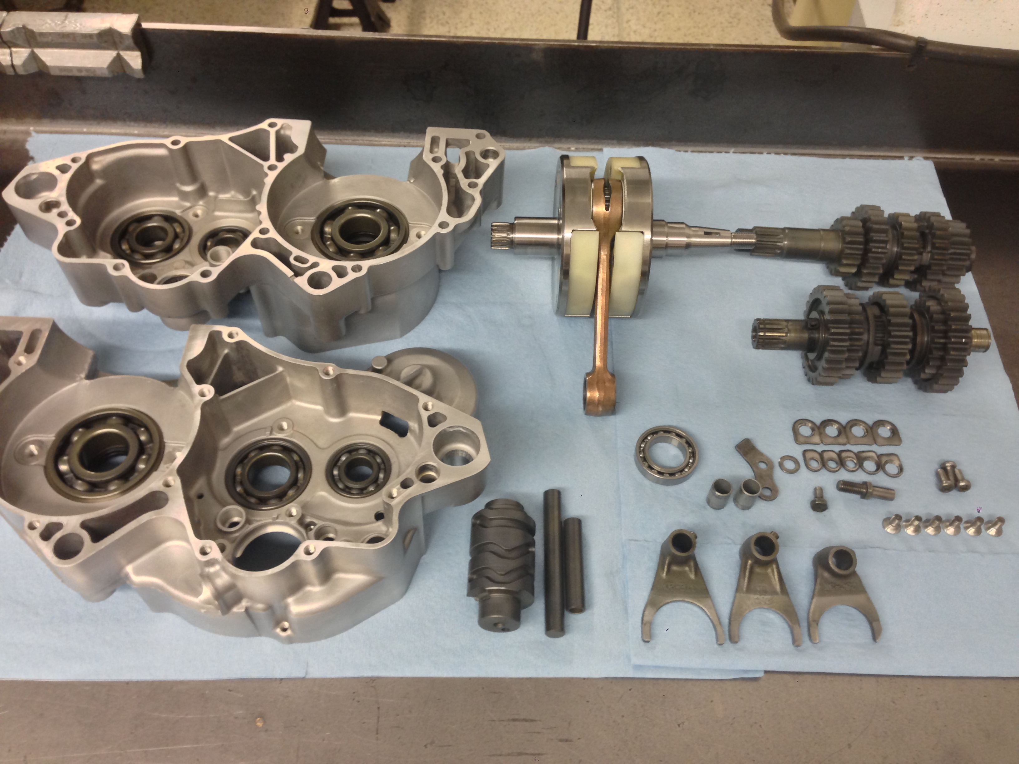

Some of the bottom end pieces cleaned for final assembly laid out

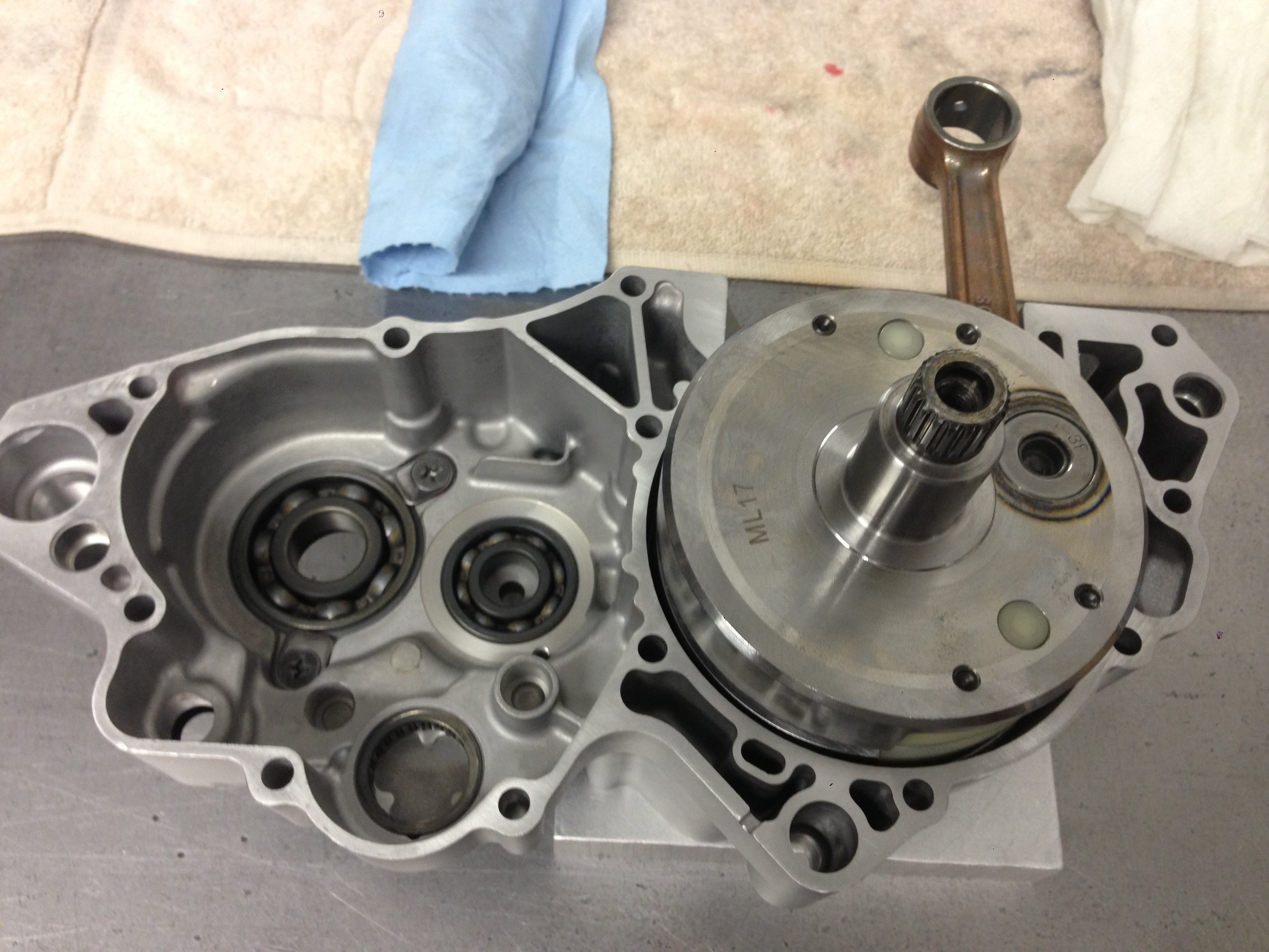

Crankshaft installation

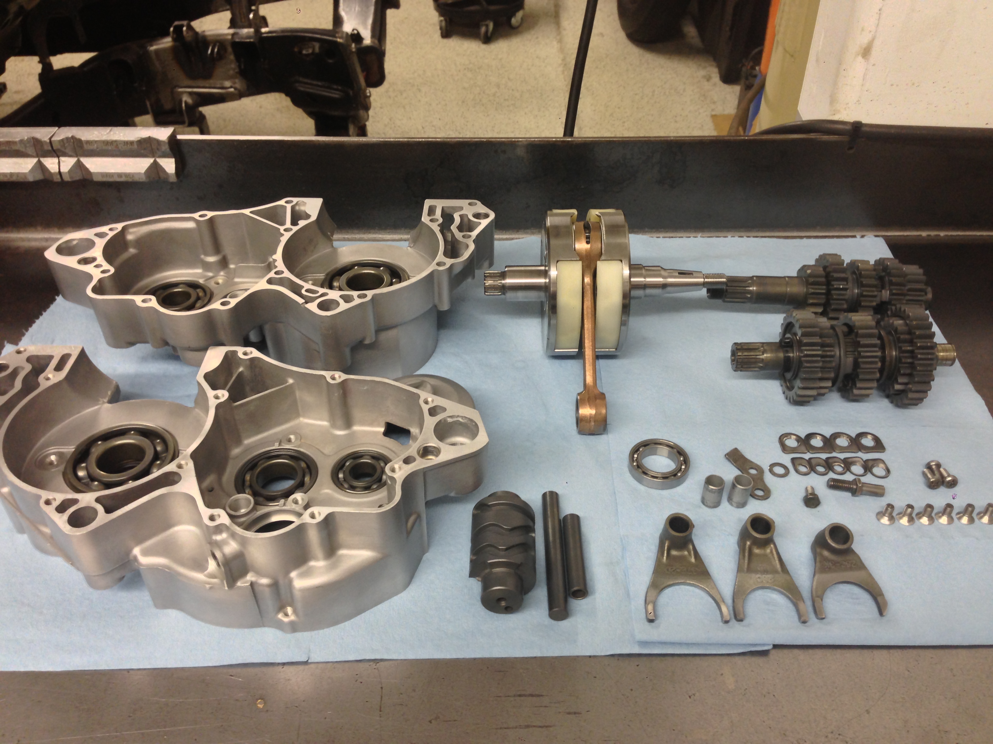

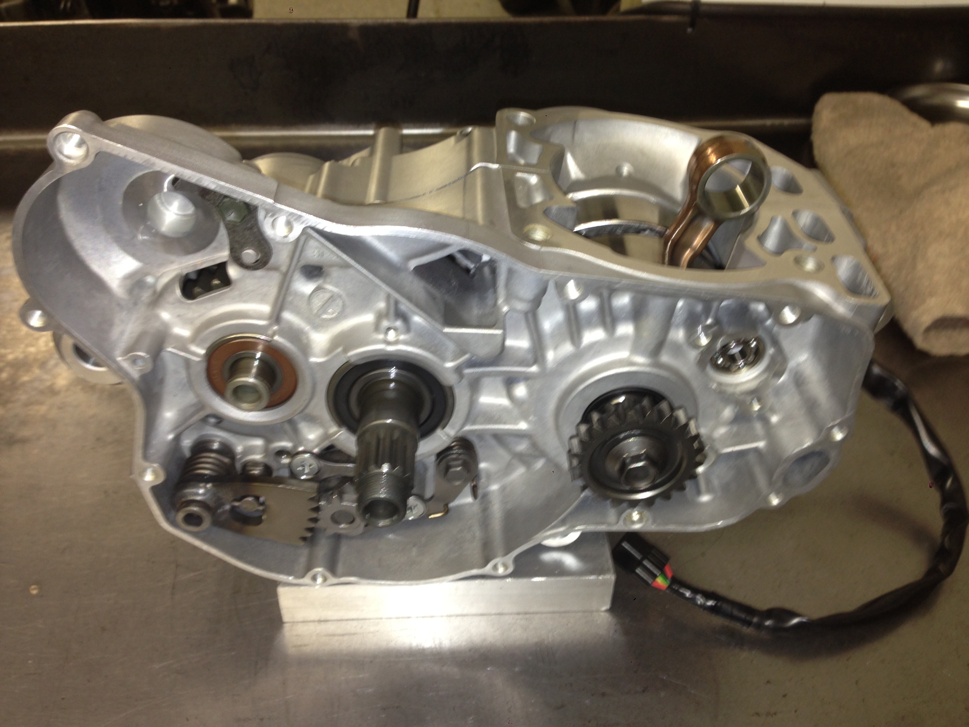

More pics of case halves, crank/rod and trans components ready to slam the cases together

More random ****:

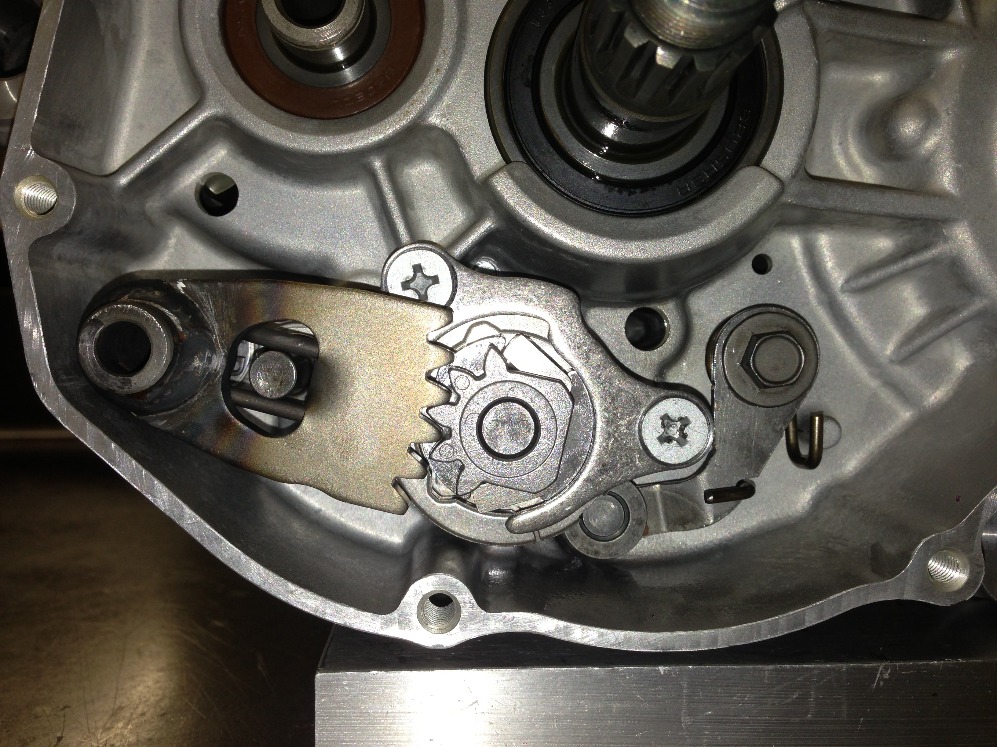

New Shifter pawls

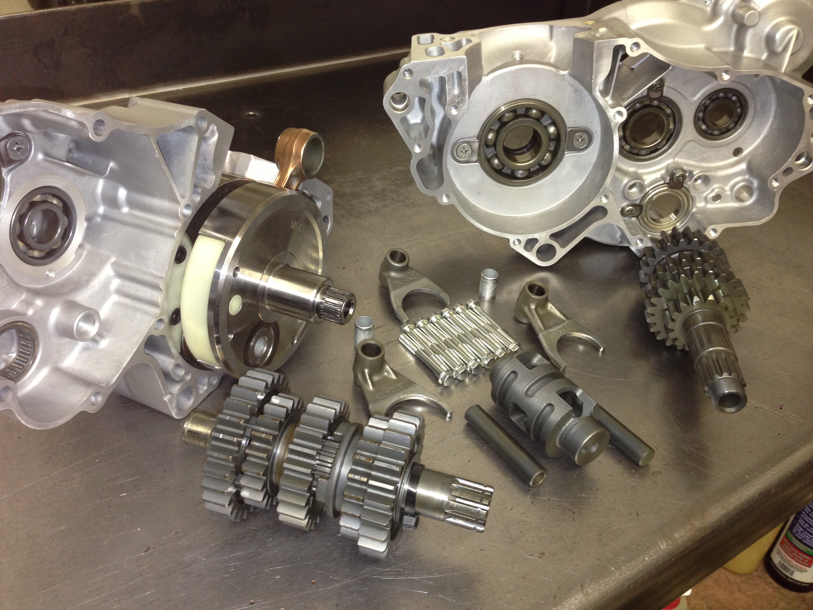

Another random REM/Microblue treated trans pic

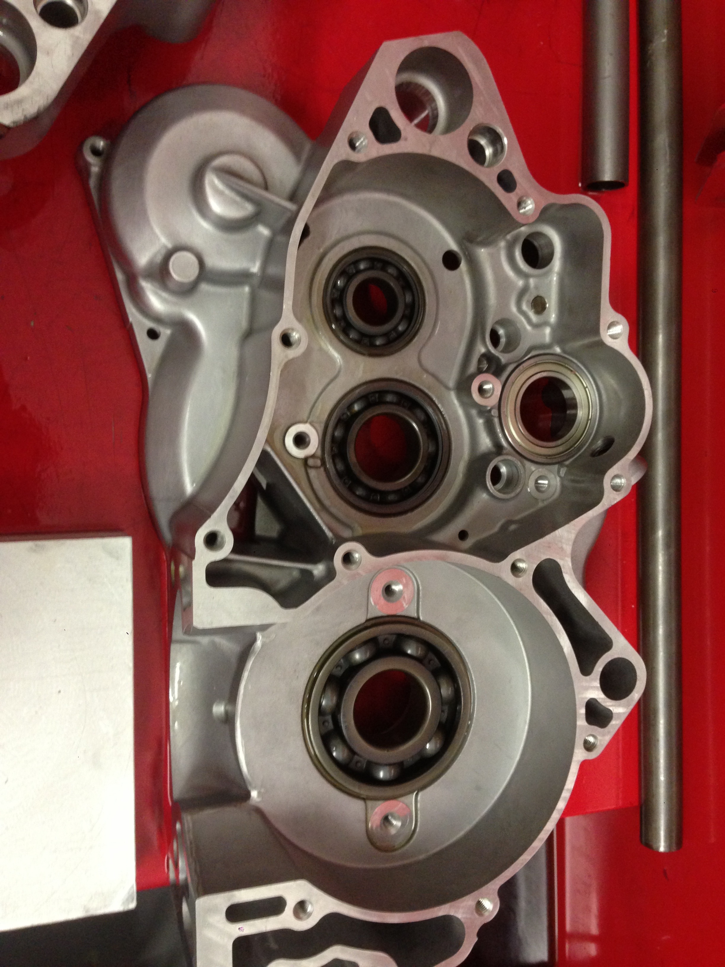

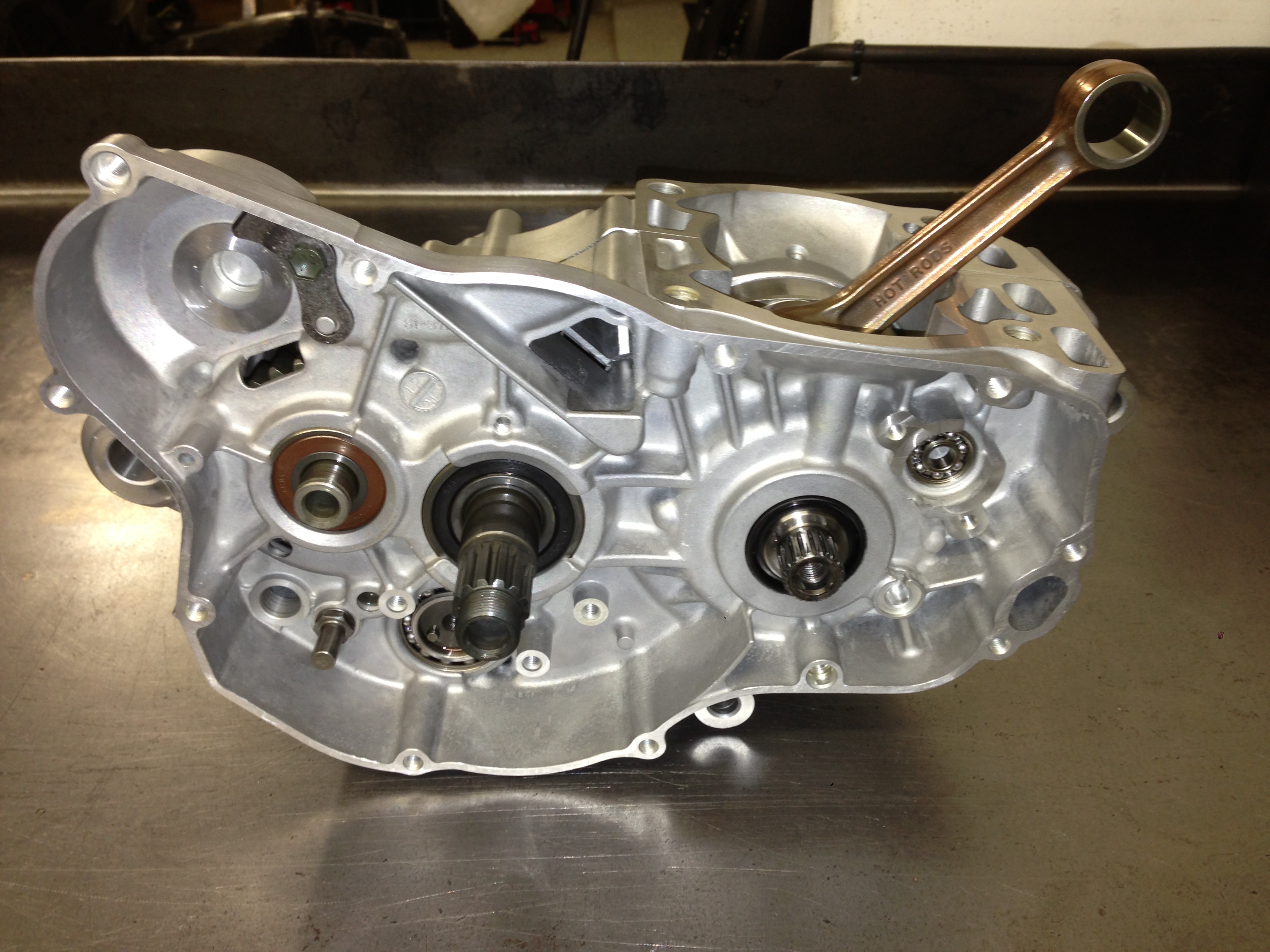

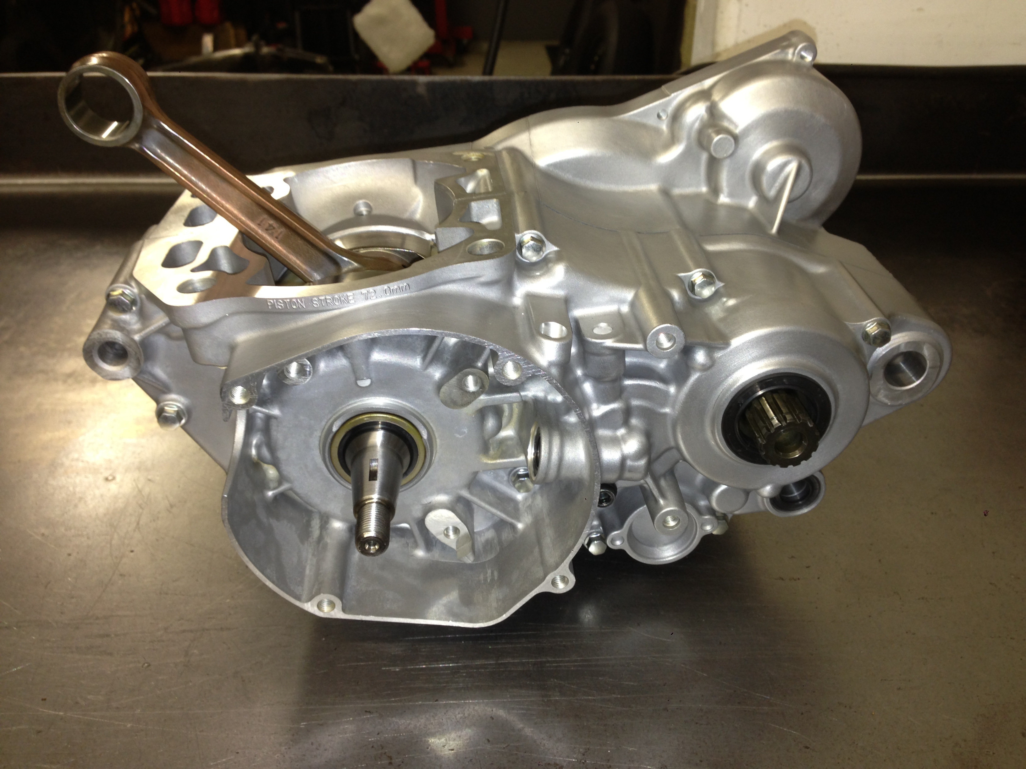

Case halves getting ready to go together

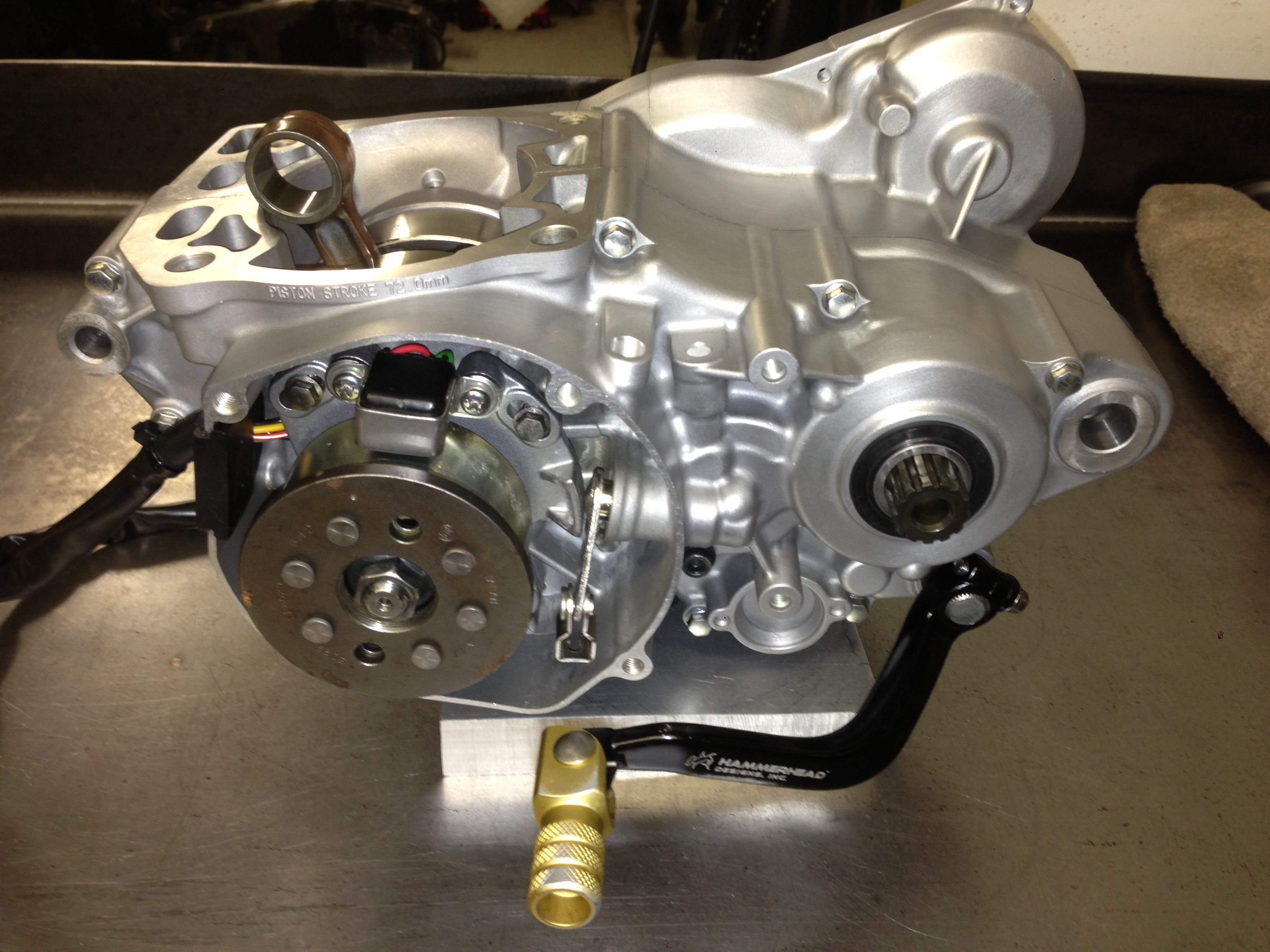

Case halves together, more progress pics

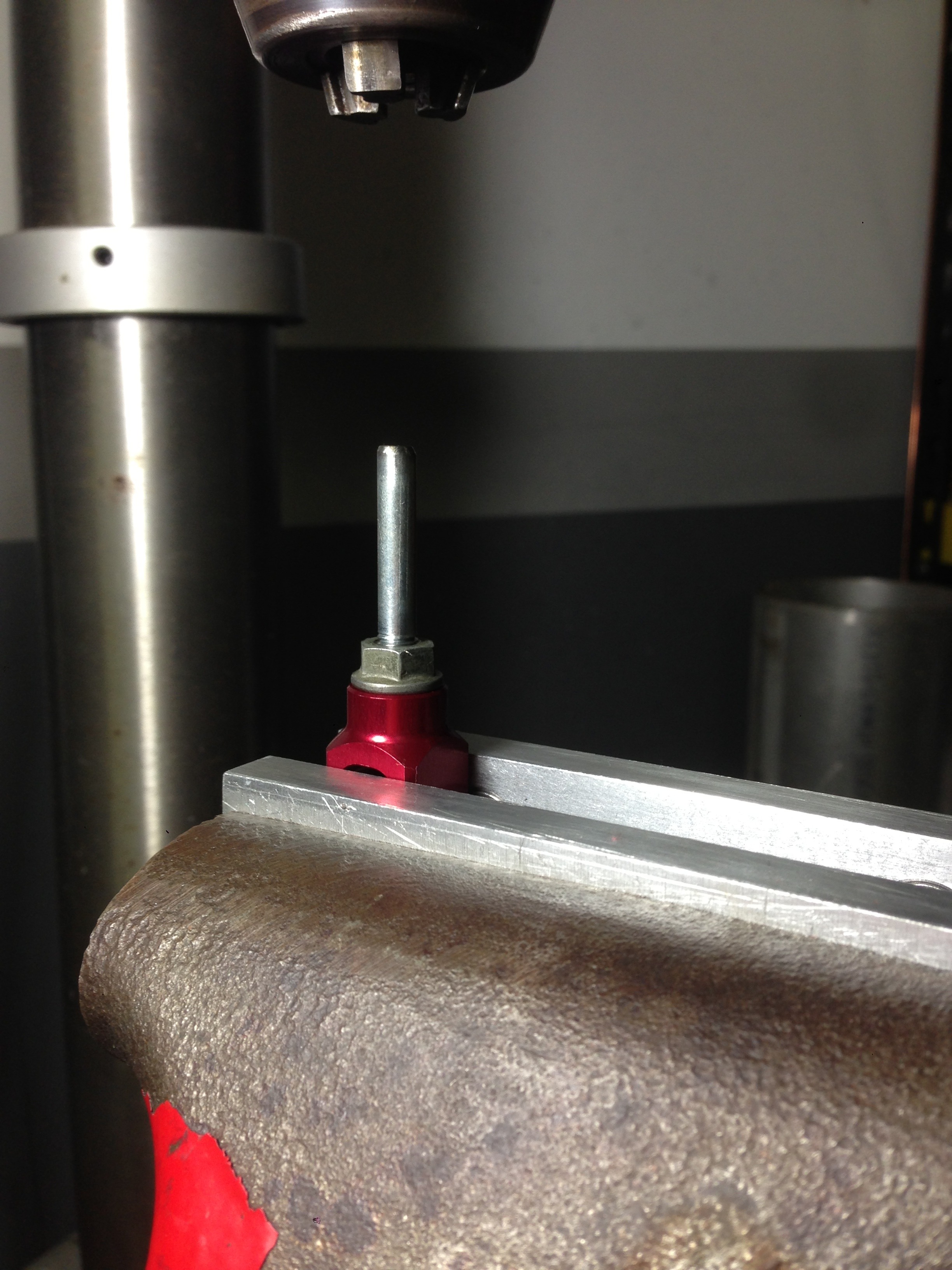

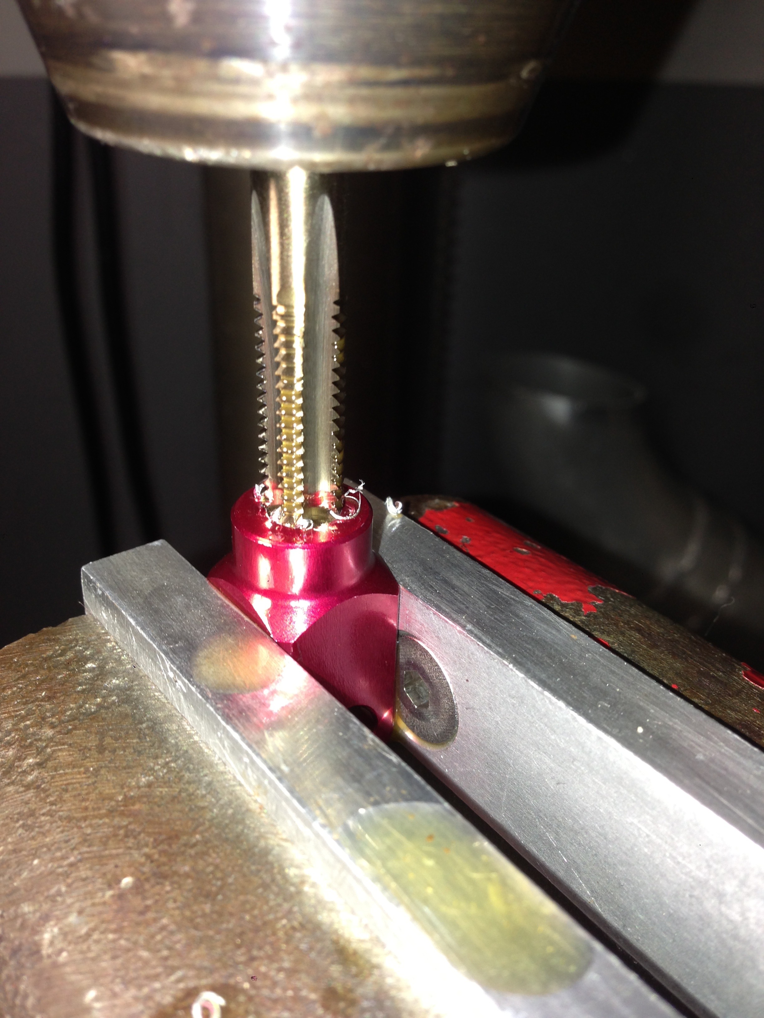

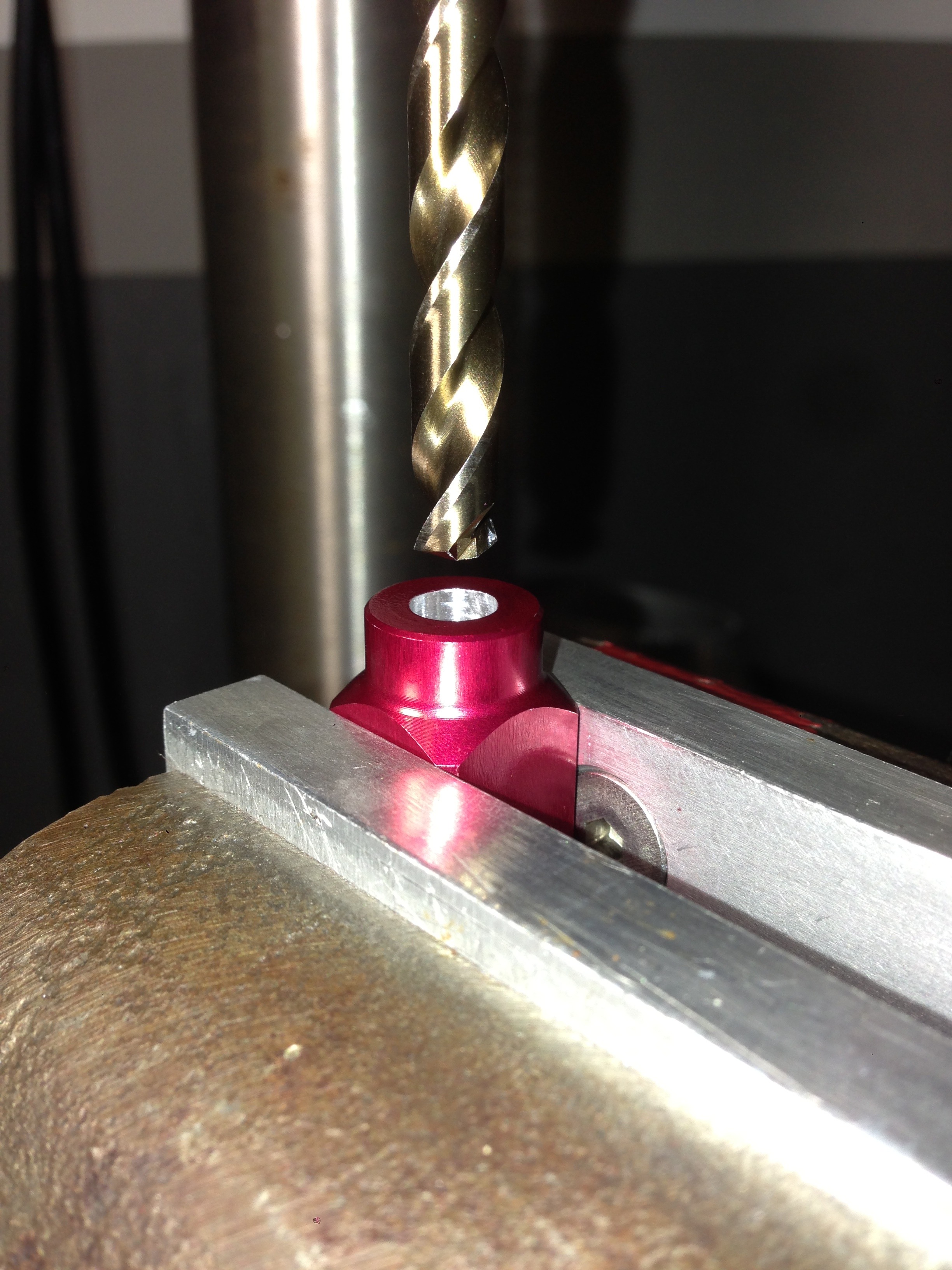

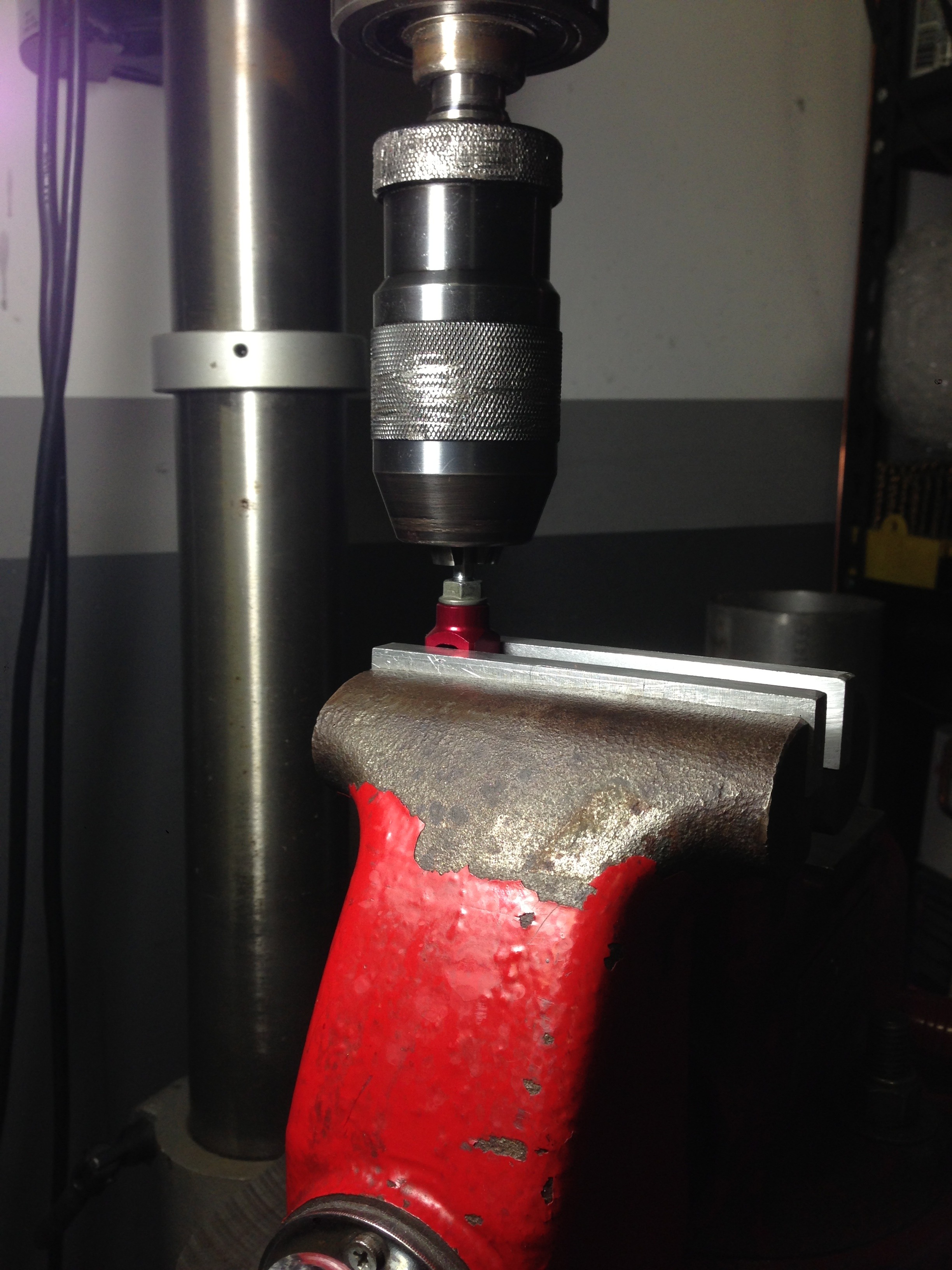

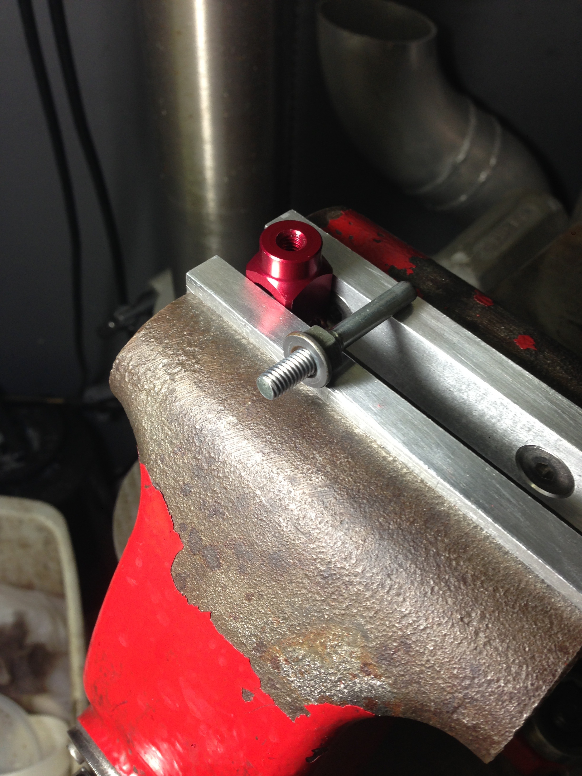

The only billet linkage we could find was for the newer 4 stroke Suzuki’s. Unfortunately, the new bikes use an M6 threaded stud and this master uses an M8 threaded stud. No big deal. Drilled it out and tapped it. If you pay attention to the first few pics, you can see my method to center the clevis in the drill press for a precision job.
