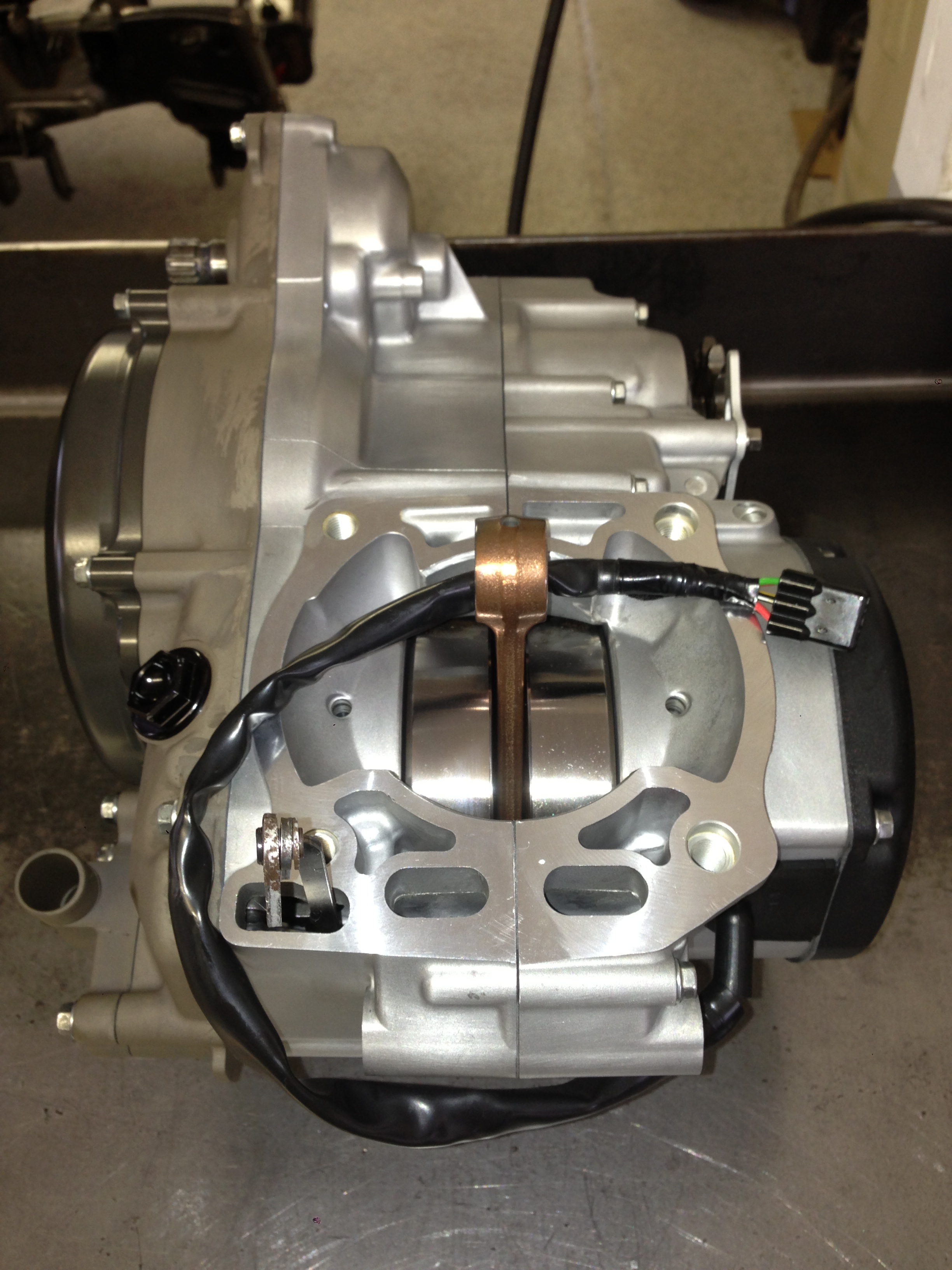

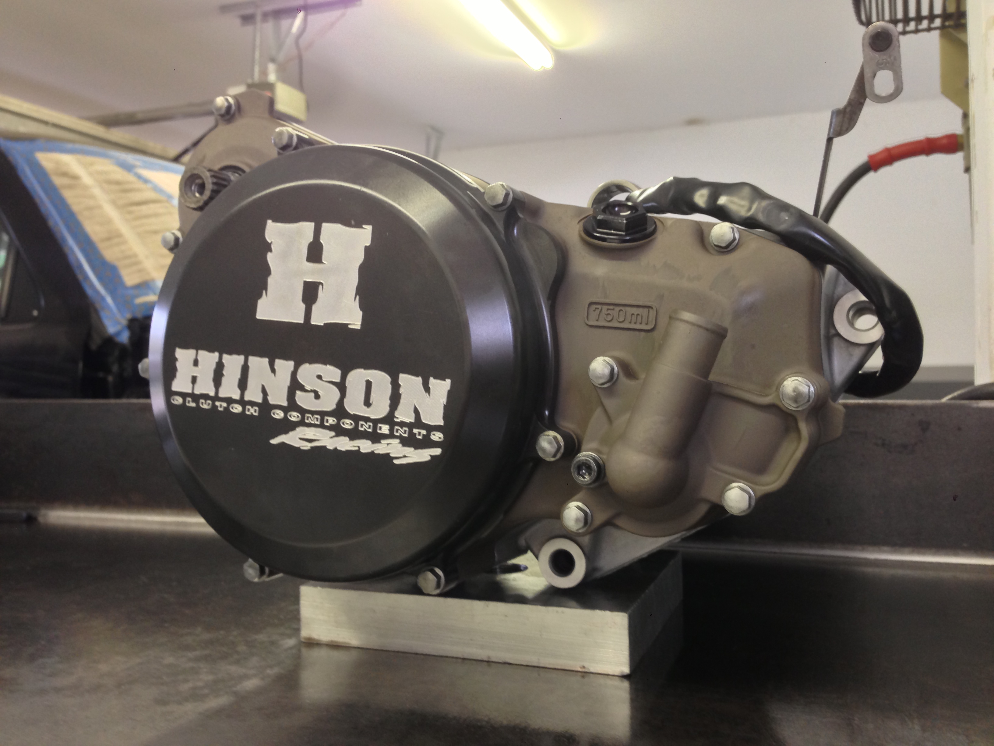

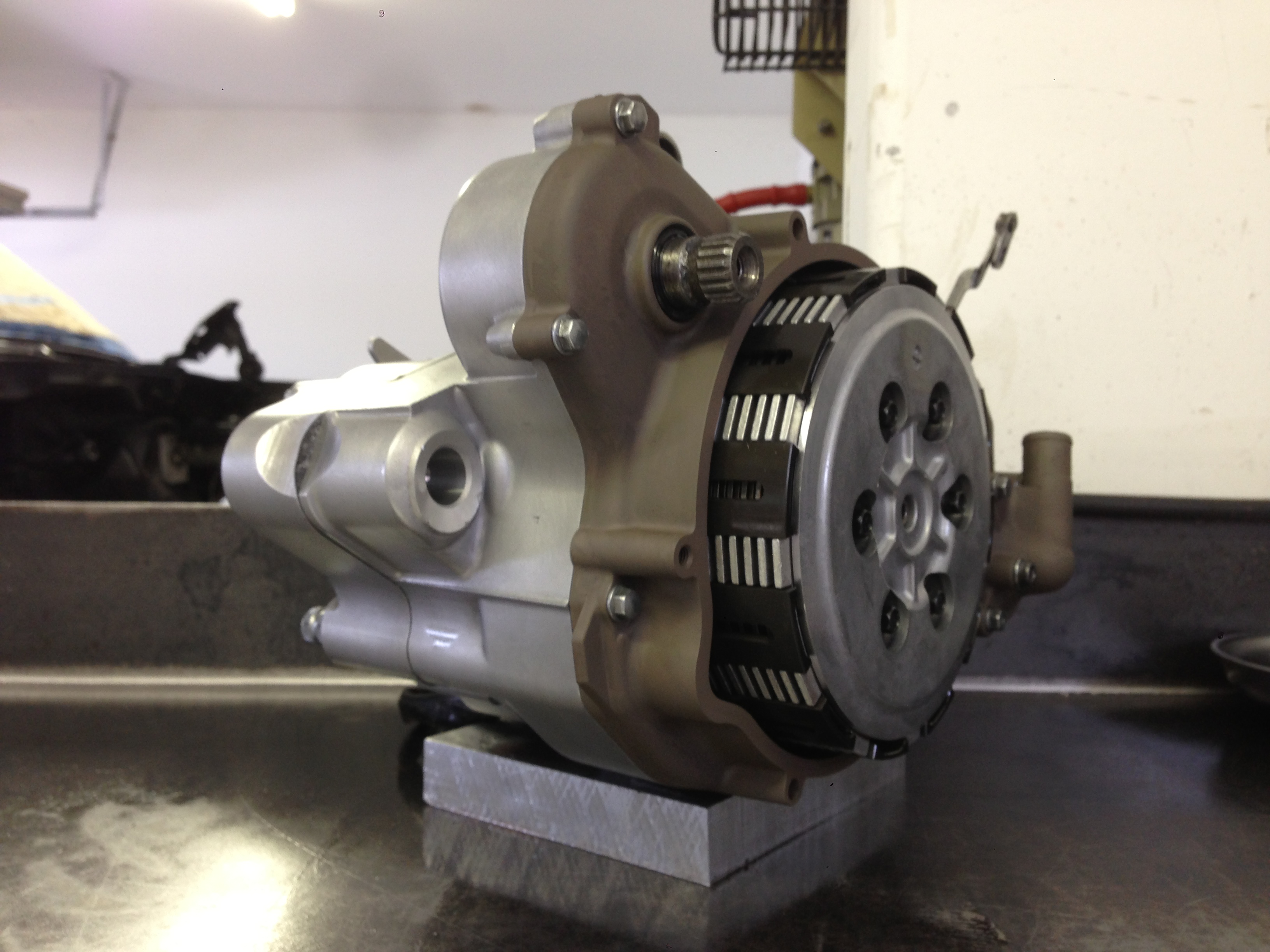

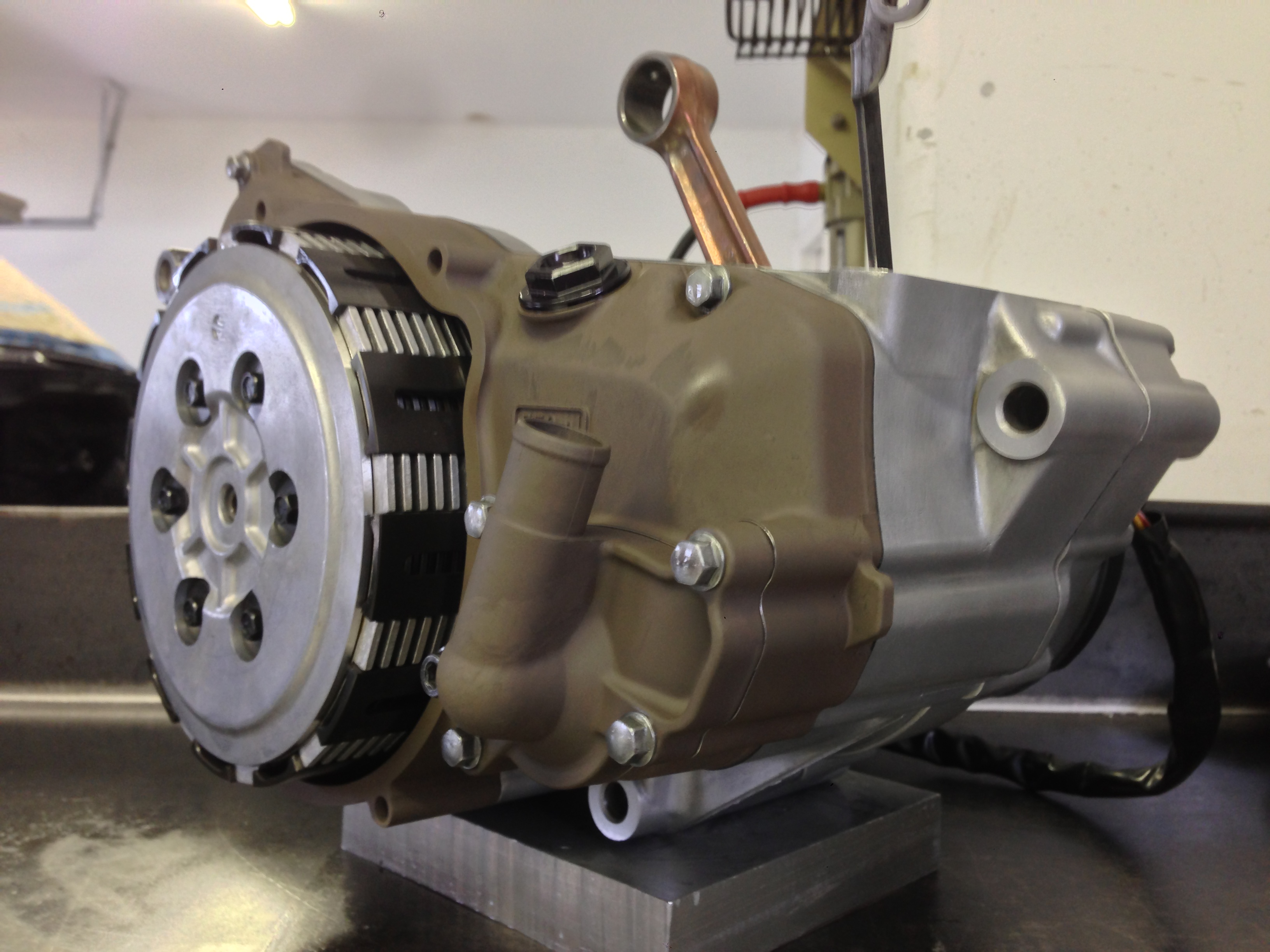

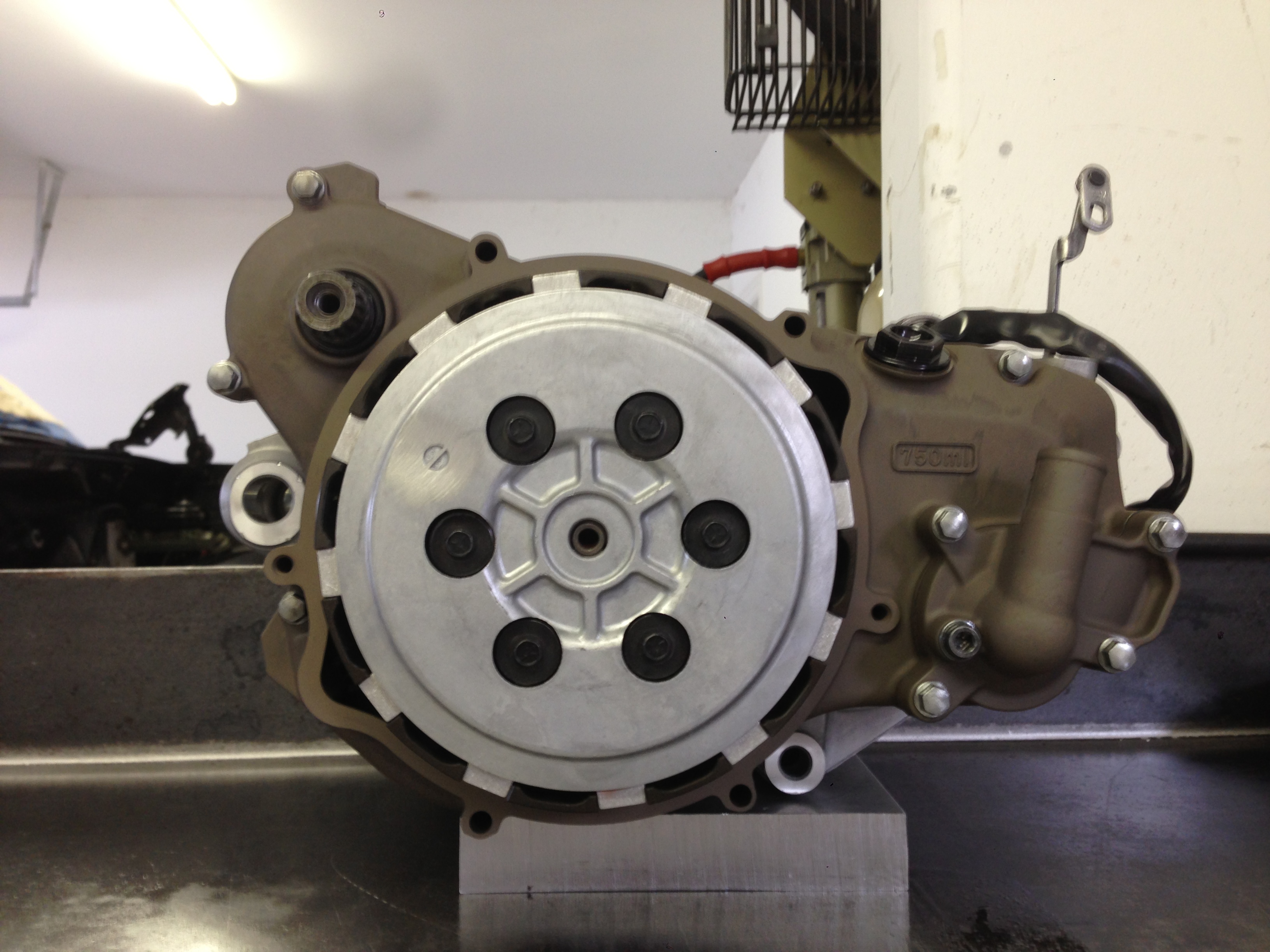

More pics for your enjoyment:
Pretty self-explanatory, let me know if you have any specific questions.
