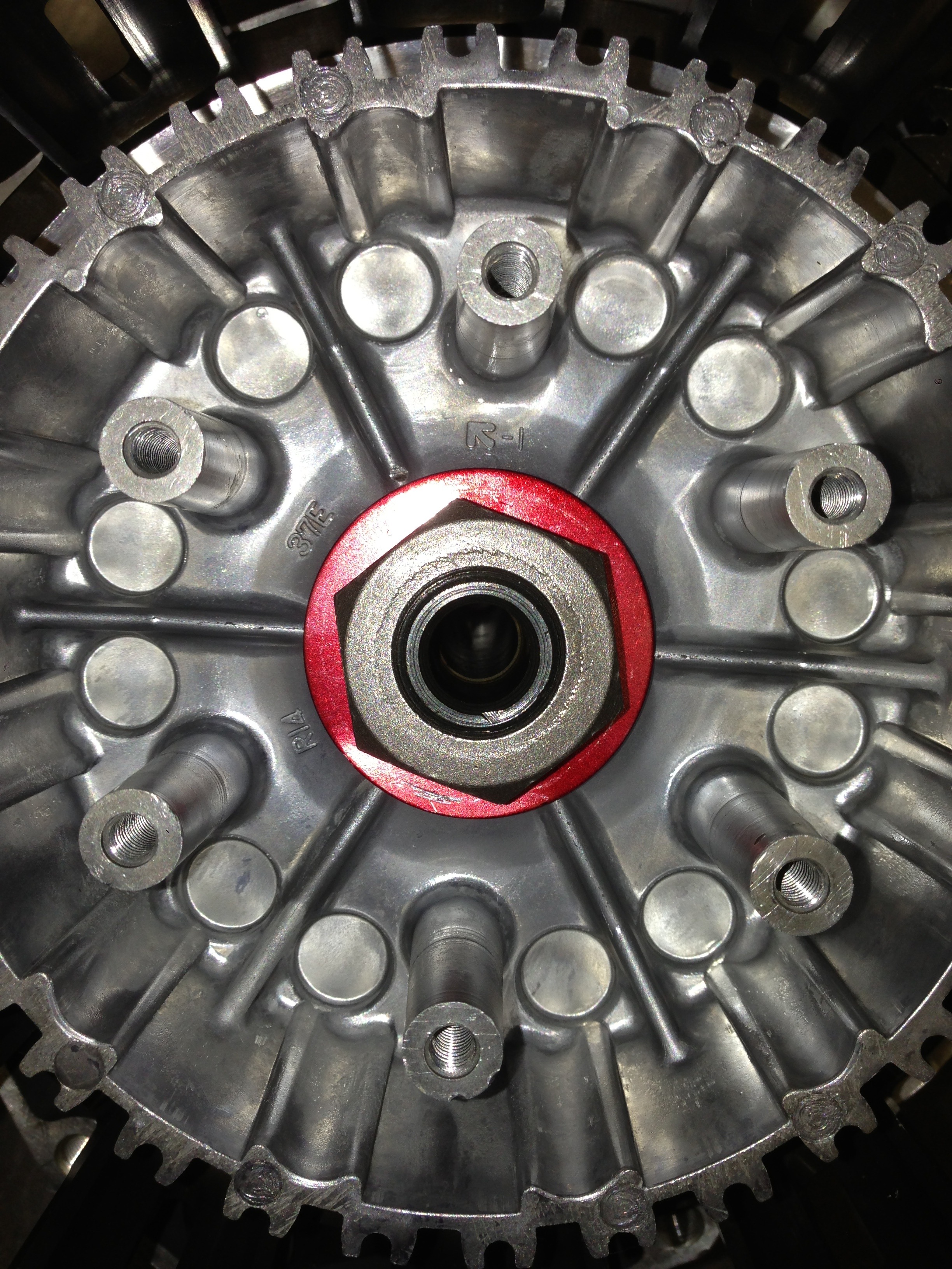

Was dialing in the clutch tonight. 99% of builders don't do this and in all honestly isn't absolutely necessary unless you are trying to trouble shoot a clutch problem. I made a special tool so that I can test the clutch springs. I have some Barnett springs and Factory Suzuki springs so I got curious. Results are as follows:
New Factory Suzuki springs came in at about 40 lbs. at clutch lock up. So with 6 stockers, you'd get about 240 lbs. of clamp load on the clutch pack.
Barnett springs are showing about 46 lbs. at clutch lock up. So with 6 Barnetts, you'd get about 276 lbs. of clamp load on the clutch pack. So the Barnetts provide a nice 15% increase in clamp load, at the cost of a slightly stiffer lever pull.
One thing I did notice was that the stock springs are longer than the Barnetts. So the stockers provide a lower spring rate. I haven't run this by the owner yet, but if you wanted to, you could probably shim the stock springs up to get the 15% extra clamp load, but without the stiffer lever pull due to the decreased rate. Probably isn't a big deal, but I like data........
You could also alternate the springs and use 3 Barnetts and 3 stockers for a total clamp load of 258 lbs. which would provide a slight increase in clamp load by about 7.5%.
We will really have to just wait and see if this thing is going to be hard on clutches to figure out what the best combo is gonna be.

I highly doubt you would make enough power on a stock cylinder that you would overpower a stock clutch and cause slip.
If you want to use the heavier springs but dont want a stiffer clutch, just get an ez pull clutch lever....

It's not that the clutch won't hold the power, but due to the nature of riding style required with a bike like this (basically you keep your right hand buried in the throttle and control power delivery with the clutch) this issue that I would be concerned with is longevity/dependability.

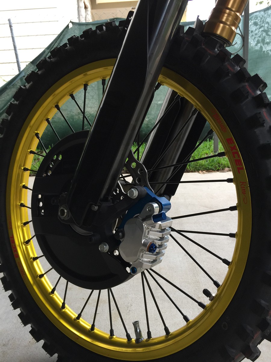

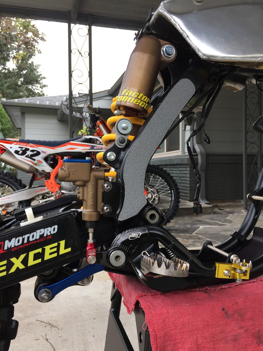

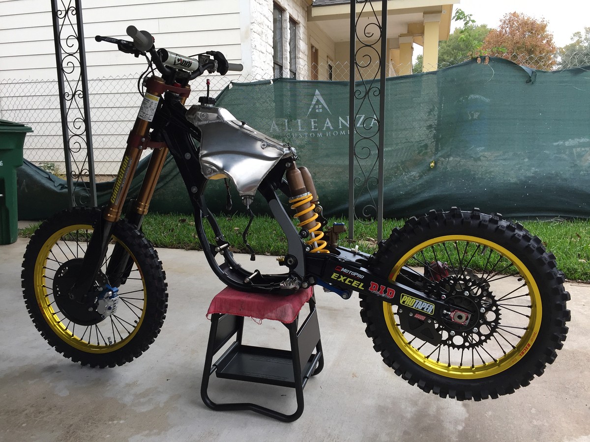

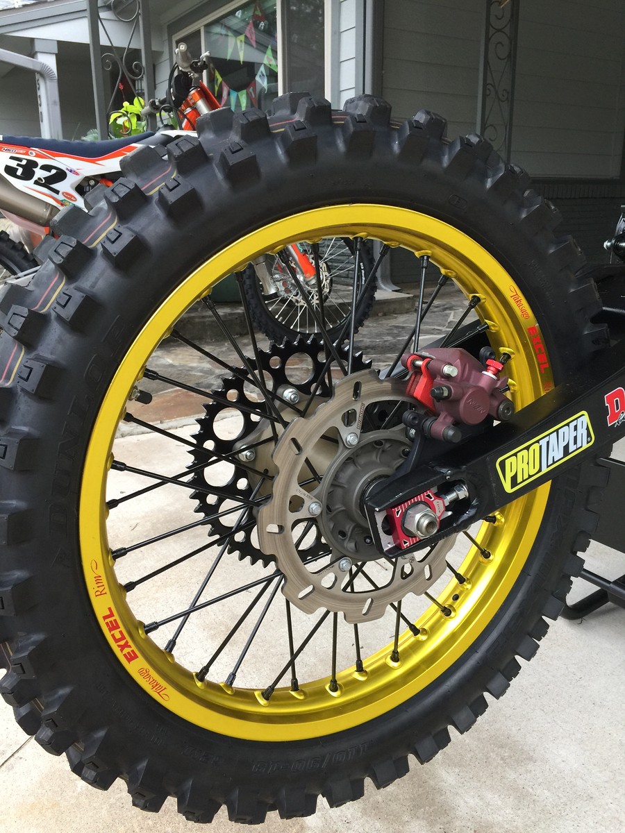

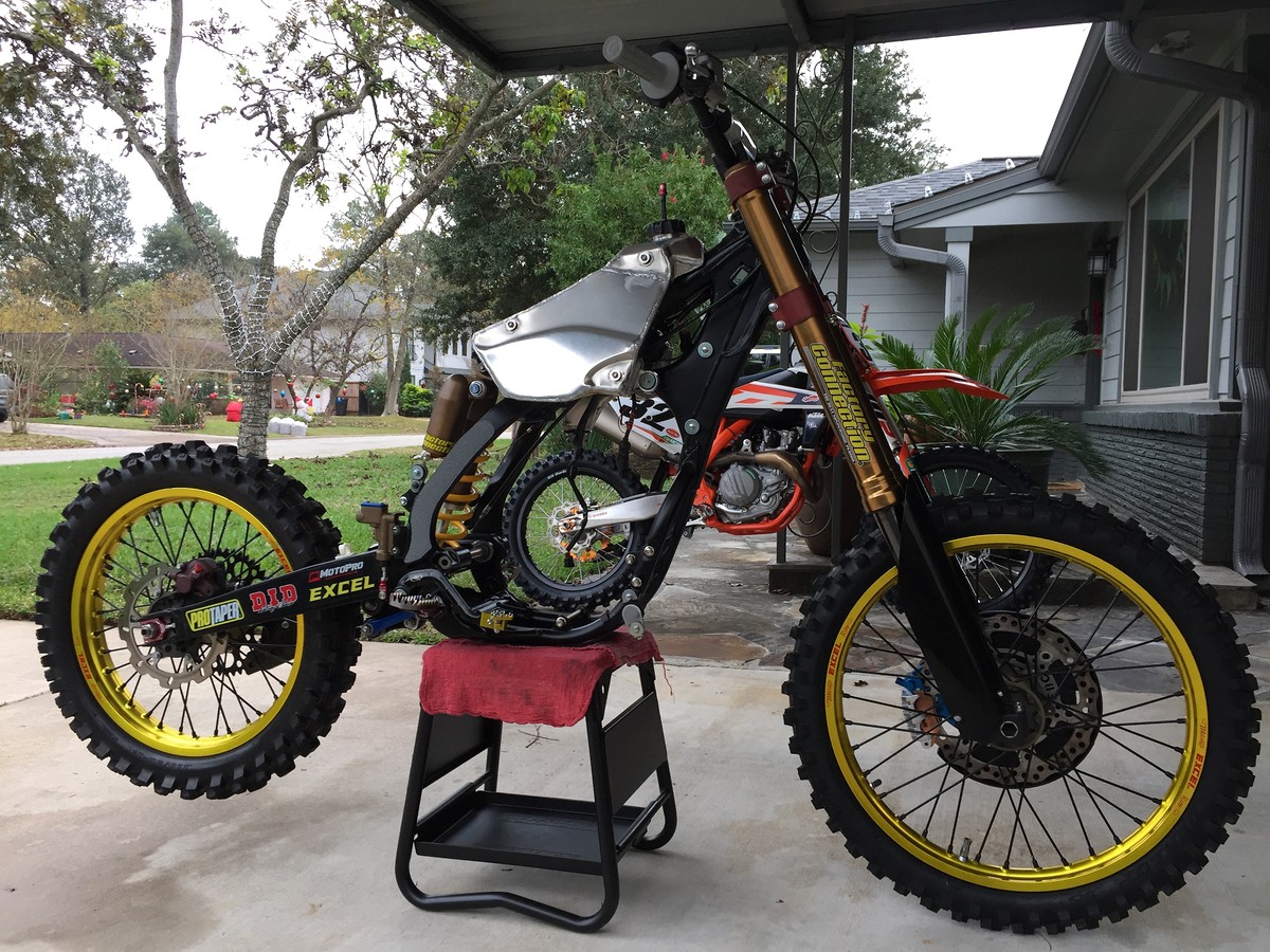

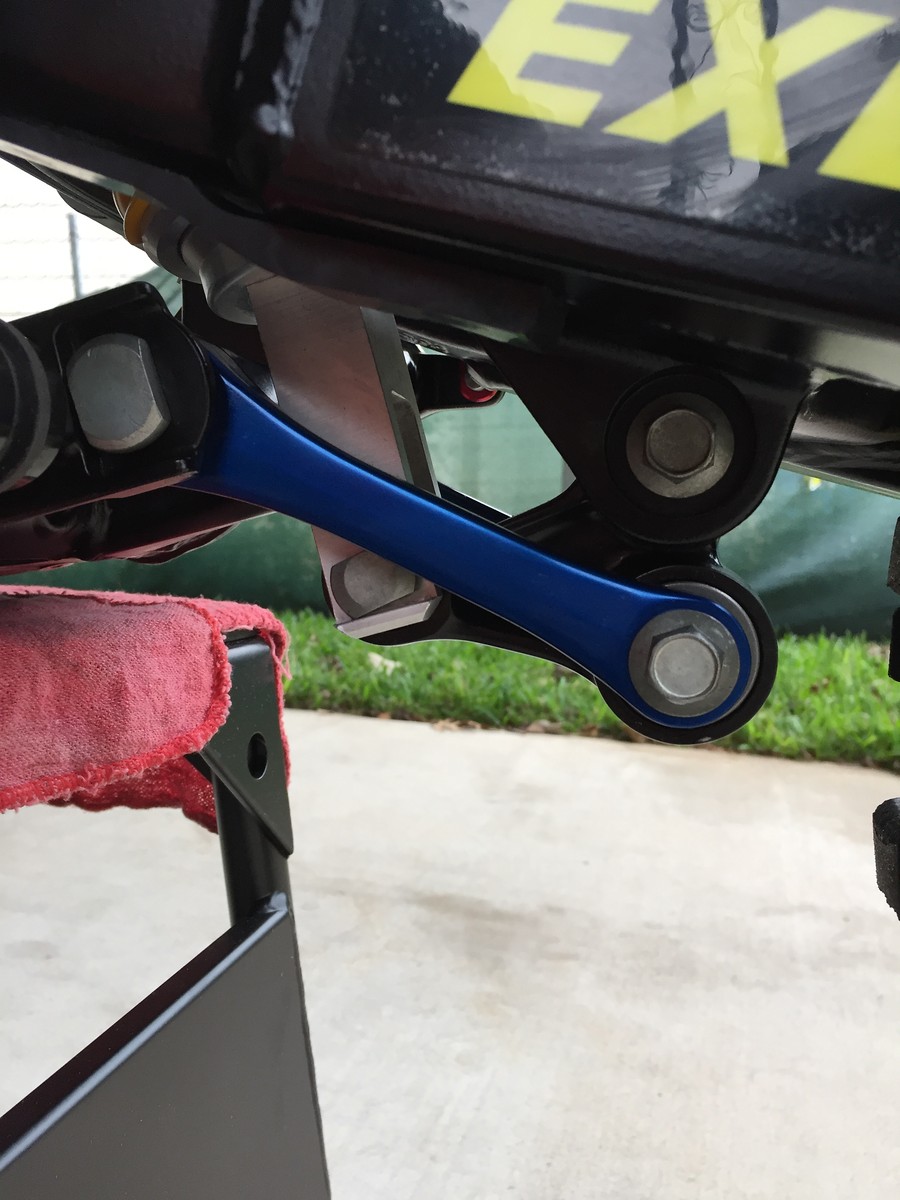

Some in progress bike pics. Things to note:
Aluminum Fuel Tank
Billet Front Caliper
My Own Custom Rear Suspension Linkage
…and just lots of specialized coatings and anodizing

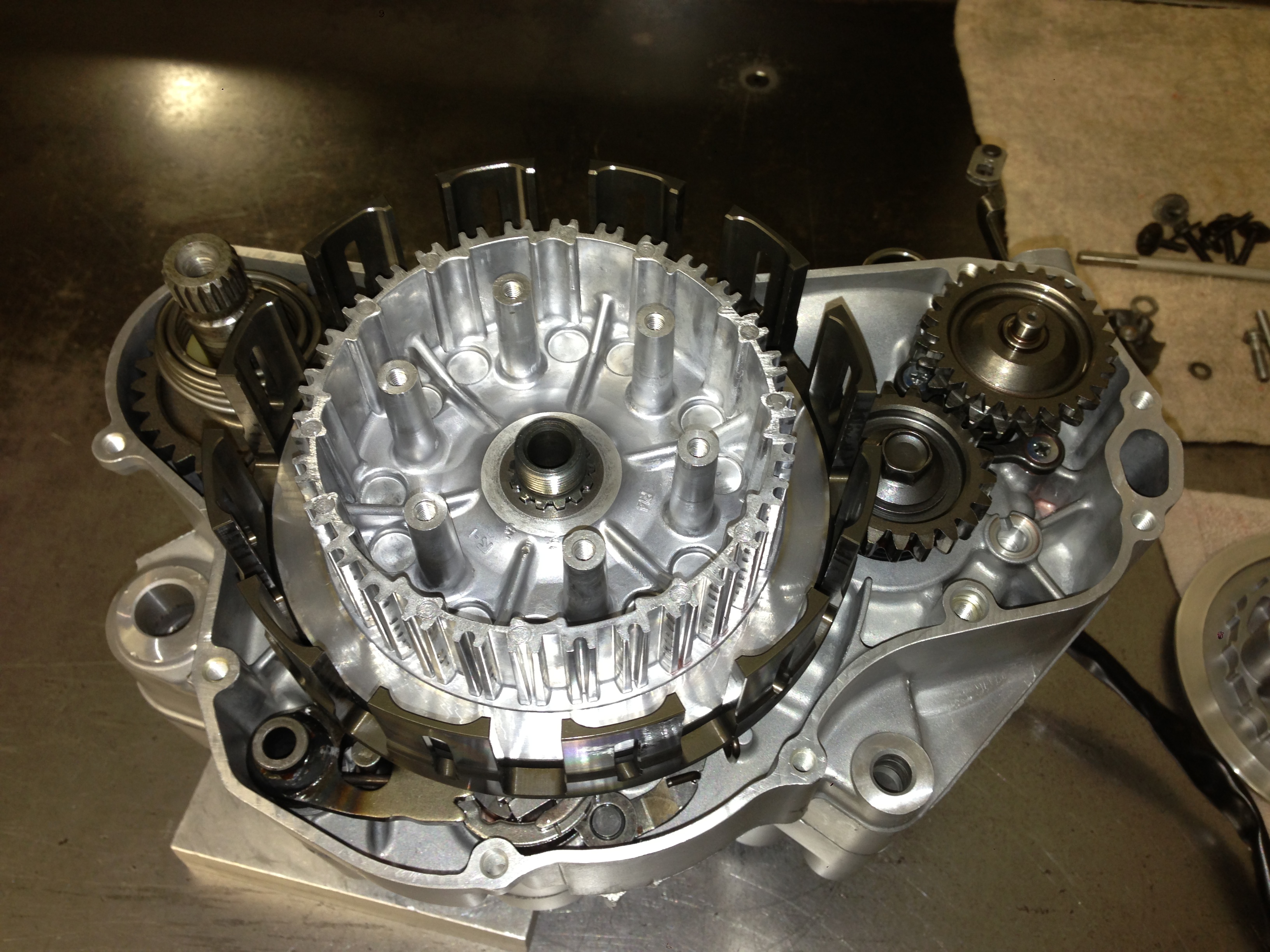

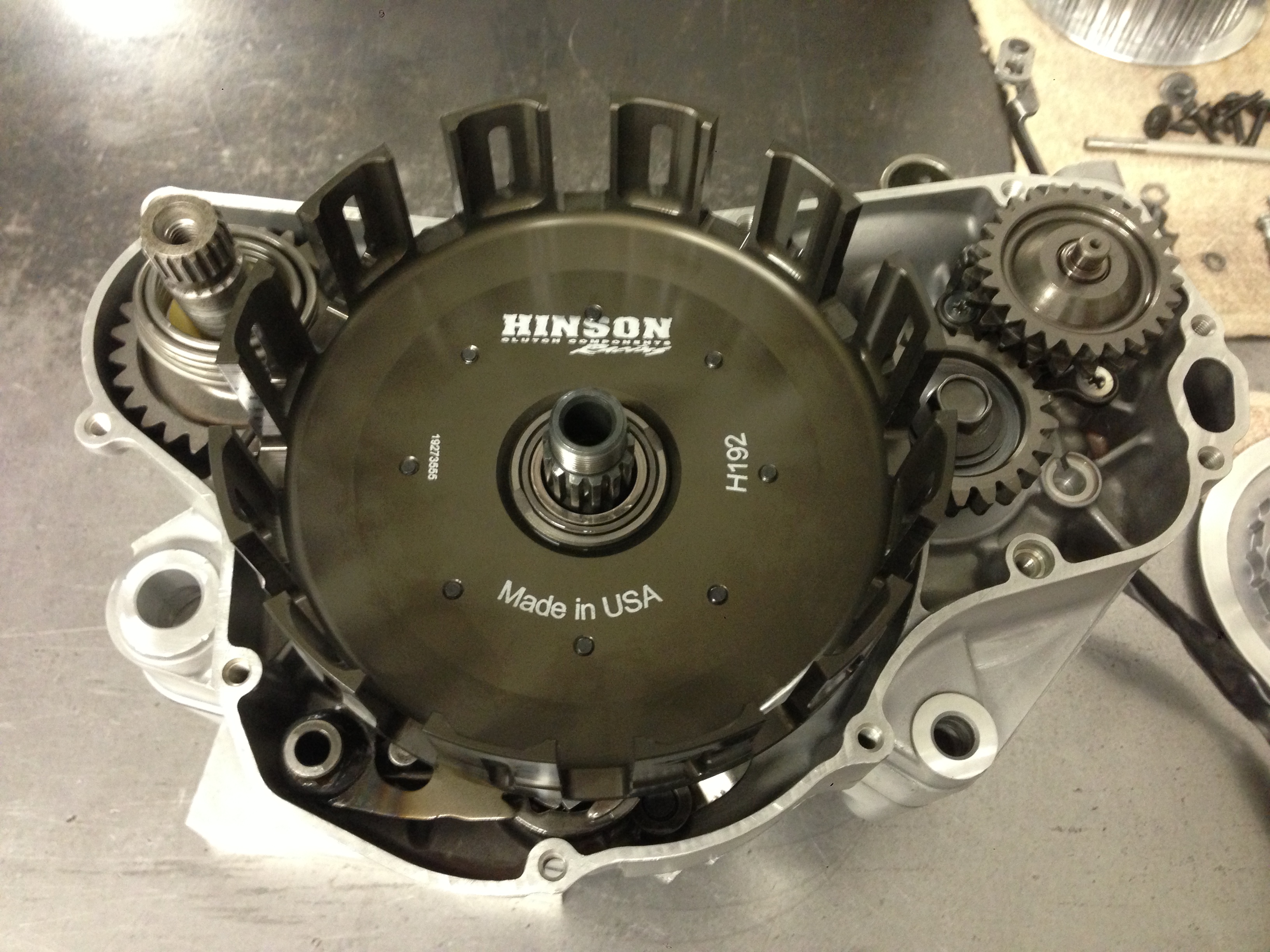

More random engine build pics:
Made in the USA bitch……BOOM!
Secret squirrel **** red stuff
What can I say, the owner likes close ups
