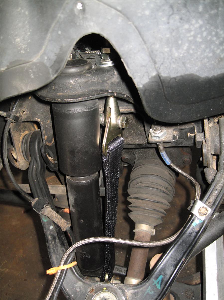

Finished the front end straps

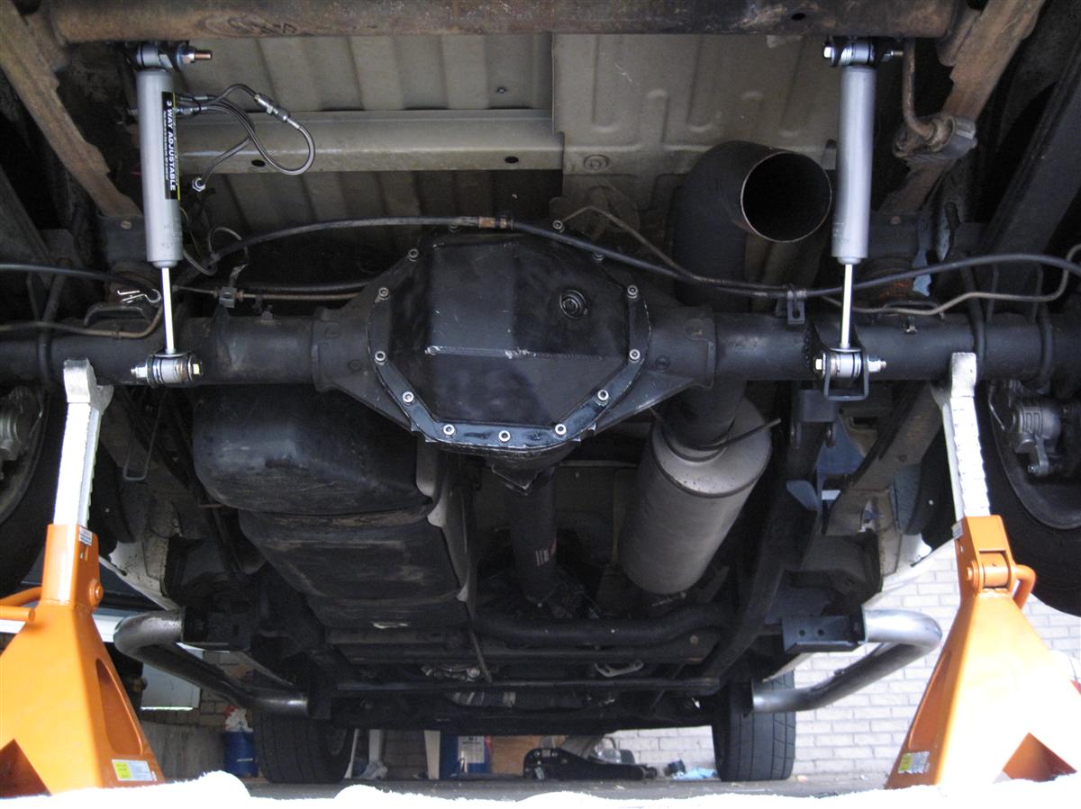

and the rear shocks

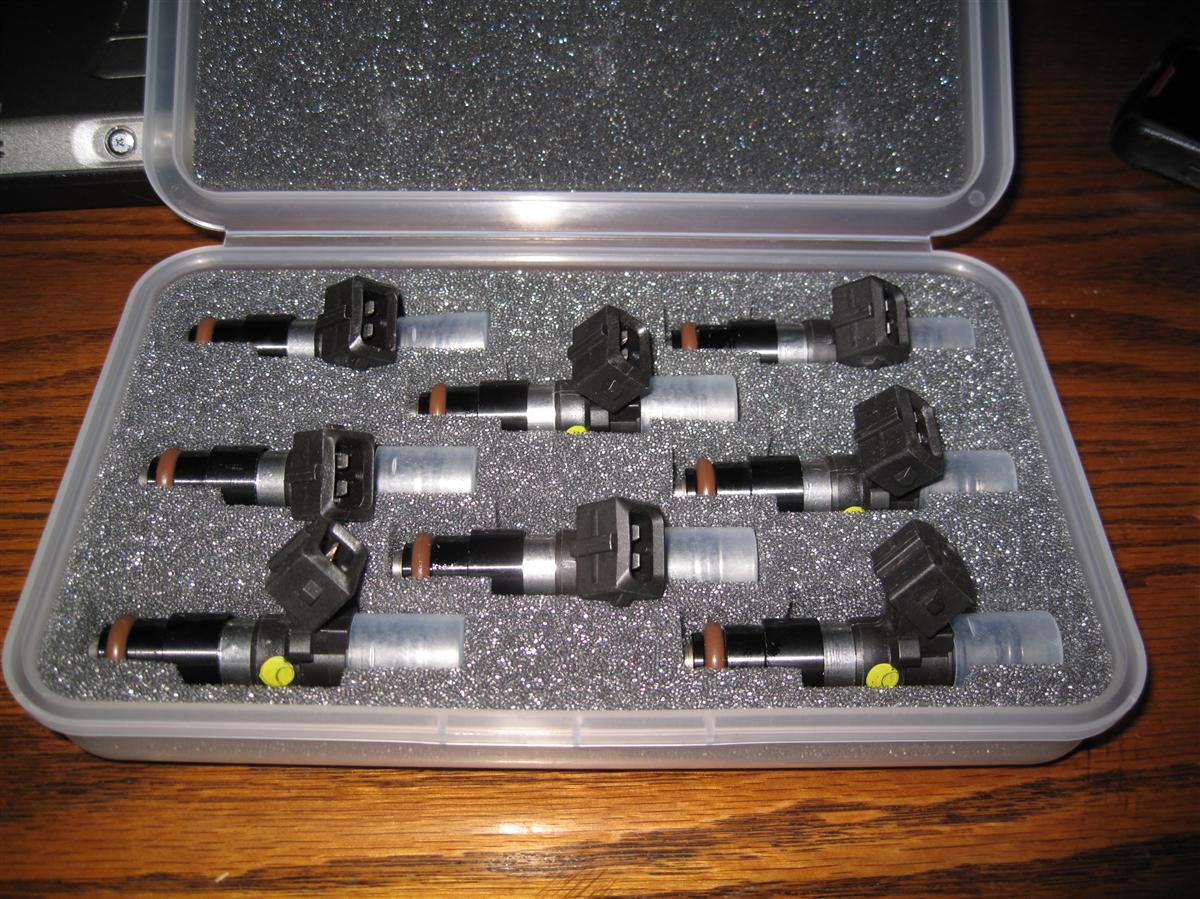

and got these to try out...bosch racing 127s
