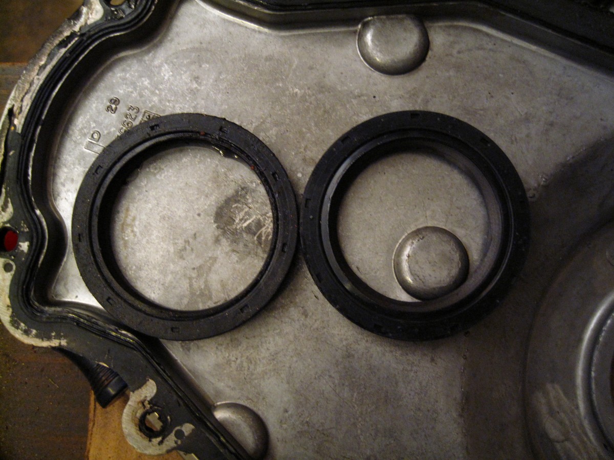

Hopefully I found whats been making the underside of my engine oily...front seal is worn out, notice the right side of it. The one on the right is a new one.

Does that mean you might have a bearing allowing too much movement to that side? No other reason i can think of that would allow once side of a seal to get worn.
That is assuming it was installed straight.

thats interesting.... something hopefully is misaligned, or the pulley incident started it.

Pretty sure the pulley walking off did it a few months ago since I never replaced it after that.

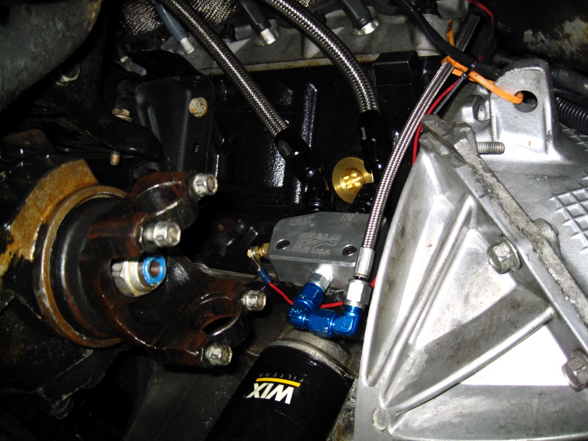

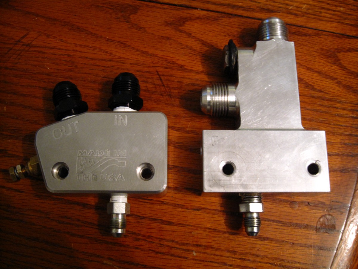

So it turns out replacing the front cover didnt fix my mystery oil leak after all, although I think it helped. The only thing left I could think of is the oil cooler lines....the block im using to go from the engine to the lines has -10 fittings on it, which I had to step down to-8 to use with my cooler. I think one of those joints was leaking so I replaced the entire length with solid -8 line and found a new cooler block on ebay. It wasnt there last year, but I found it for $50 and it came with fittings and ports for the turbo feed and temp sensor. Its also a lot smaller than the old one.

Also my new converter from PTC came today...this thing is a beast! Hope to have it in by this weekend!
