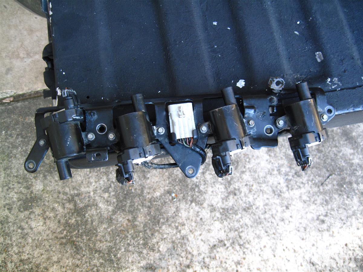

Got this idea from Mitch, and it looks like it will cure my wire melting issues since I already made custom wires about 2' long.
I used some spacers between the coils and bracket as well so the plug can easily fit over the top. It looks like it in the picture, but the wire sleeves are not touching the header.
