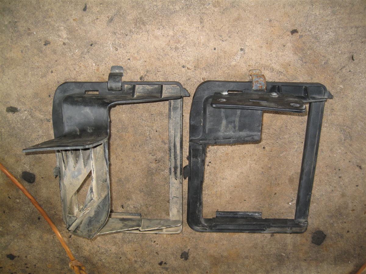

A few pages back I mentioned I had to move the pcm over to fit the bigger charge pipe...well I finally go around to that. I bought a spare holder and cut it up...I figured I need it to move down and forward...
Easiest way is about 10 mninutes with a dremel and I cut the mount piece off and bolted it with nylon lock nuts to the holder assembly.
Works much better here. Im keeping the battery tray empty so I can have a large meth tank made.
