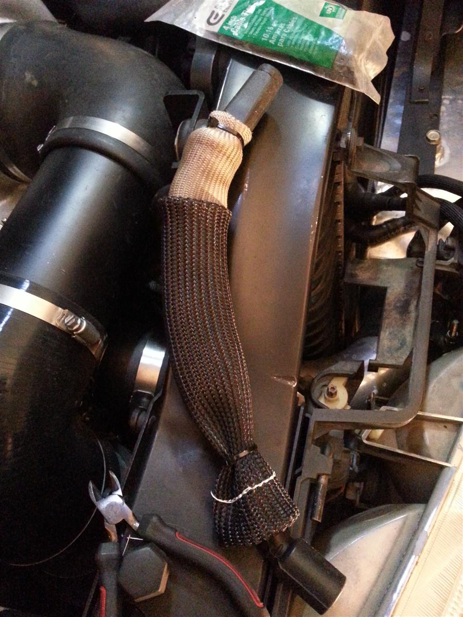

Got some new wires and heat socks since I was having such issues with my older ones melting...
Hopefully with 2 layers of socks and heat wrap on everything close I wont have that problem anymore.

lol turbos eat everything! i had 3 bad plug wires and the socks that were covering them were destroyed as well. looks like this should help out. next is 3 layers haha

Originally Posted by Atomic
I dont remember exactly, but it was only like $3
At one point when I was burning plug wires I came up with double socks, tape, shields wrap and a million other things and it just made them burn faster. This might just be me but I think a small air gap with some kinda cross flow works better than wrapping them in all sorts of wrap and insulation.

The way I have them now they arent actually touching anything. The socks is more for radiant heat than anything. I had to make 3 custom wires for the back driver side to go up and over the manifold instead of through it, and also used 90 degree boost on the coil end. So far it is working great, whereas last time they would burn through in about 5 minutes.
