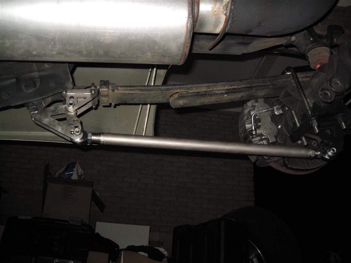

They are the assassin bars, and I had brick modify the rear for me to fit my 14b and larger ubolts. Everything lined up pretty well. Also had to get some bigass ubolt top plates to carry over the theme

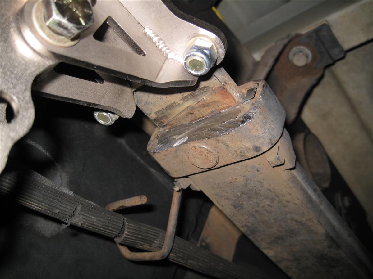

You have to cut the second leaf to install these bars, but you only have to go to that clamp, and dont have to worry about moving it:
