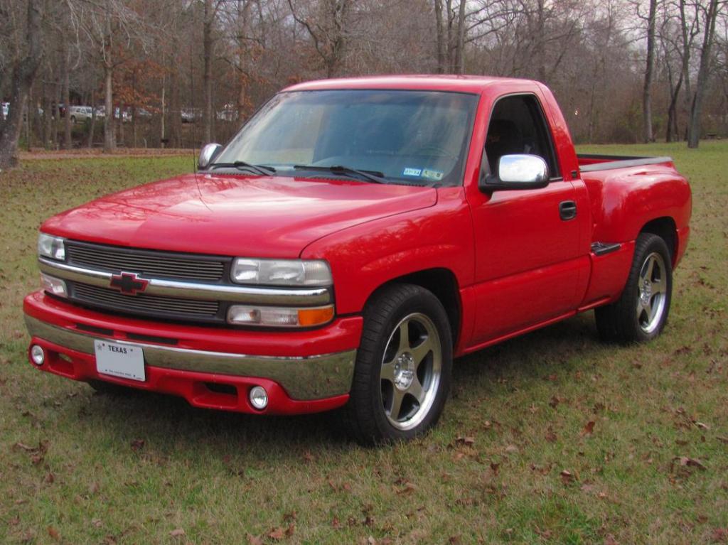

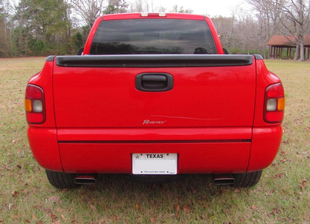

Before I lost it, I used to keep track of my mods and repairs on my phone- Used to. This will NOW mainly be a place I can keep track of the small things I do to my truck outside of routine maintenance. Maybe a On3 kit will make its way here in a conspicuously short time after it's paid off next spring.

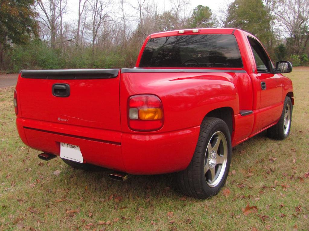

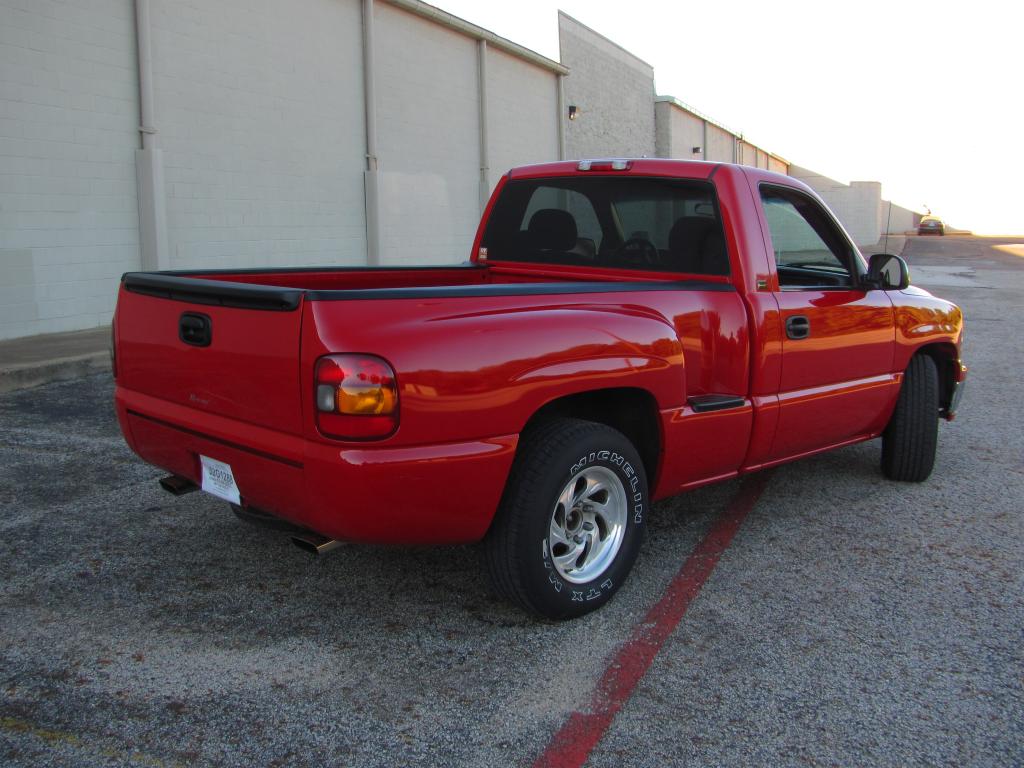

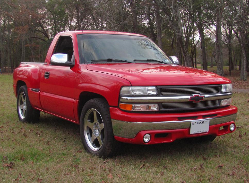

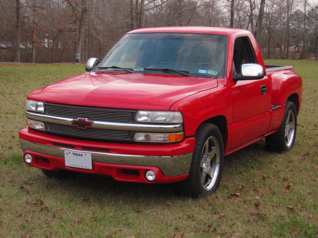

This is how it sat the day I brought it home in August of 2013 @ 119k miles.

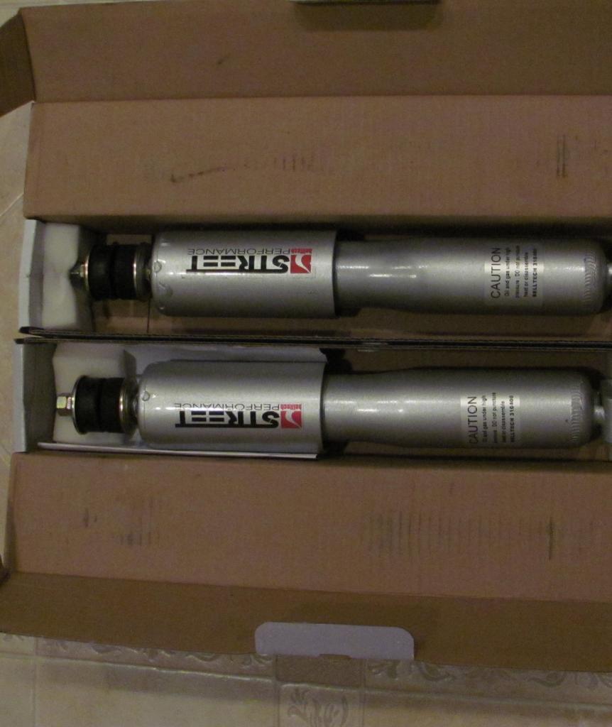

When I bought it, the shocks were completely worn out, so the first thing in order was new shocks. Belltech's Street Performance Shocks were just what I wanted. ~120k miles
On blacktop roads they can be a bit rough but when the corners come, I wouldn't give up the firm ride for anything.

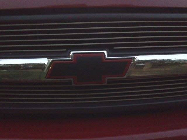

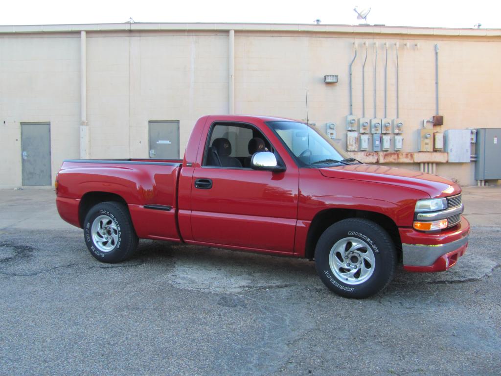

This first project started small: Plastidipped the solid red bowtie

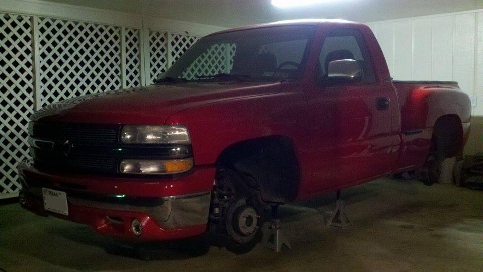

The Next Project was a bit more involved. After seeing 1 truck with decladded wheels on it, I knew I needed them When I was looking at doing this myself, I couldn't find enough pictures to get a clear image what they would look like on my truck. That in mind, lotsa pictures inbound.

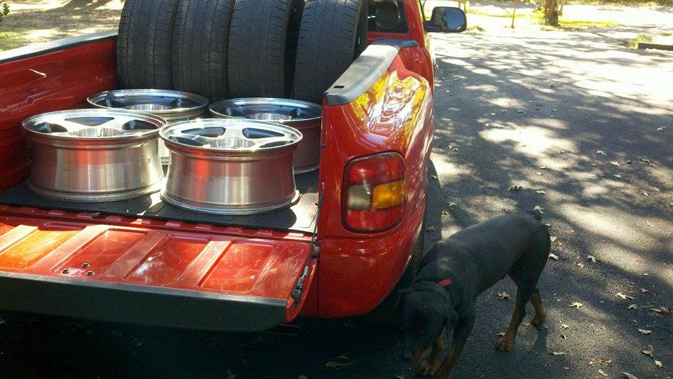

Sat on Craigslist for about 2 months with no results but in the beginning of June just so happened to see a set for sale.. on Facebook of all places. (No comment on FB for sale pages) $600 later and I had four 5 spoke Chevrolet cladded wheels and six tires.
*Disclaimer* There is no reason it should take anyone as long to declad a set of wheels as it took me.
All together, the whole process took between 4-5 months to complete. Between work and school, I had about 1-2 hours to work on them a day or sometimes 1 day a week. Shouldn't take a normal person anywhere near that to do the job. Also, these first photos I pulled from other's decladding projects as I lost my documentation from the first half of my project.

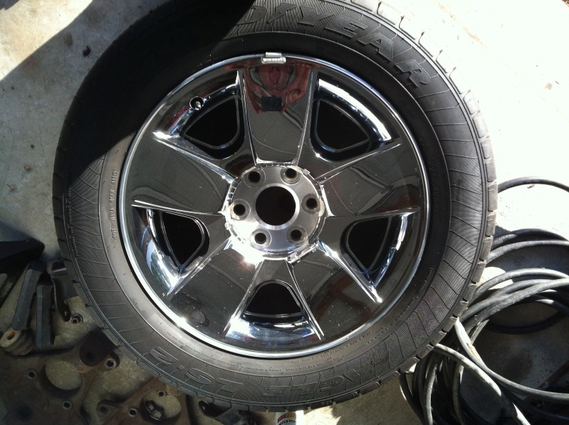

Started with 20 inch wheels identical to these
pop the plastic covers off

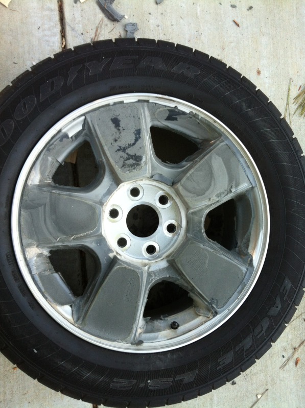

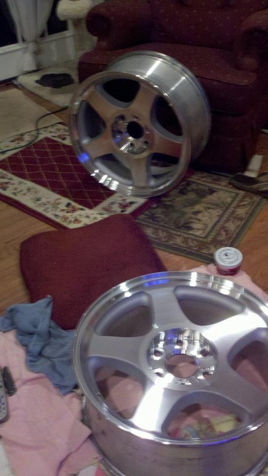

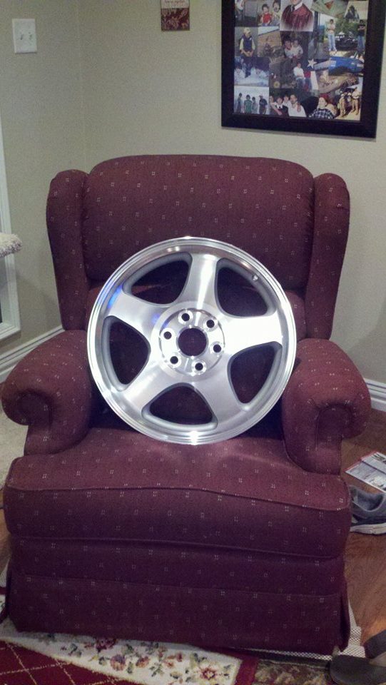

After most all the foam cement is off, you can see a decent lookin wheel was hiding underneath those things!

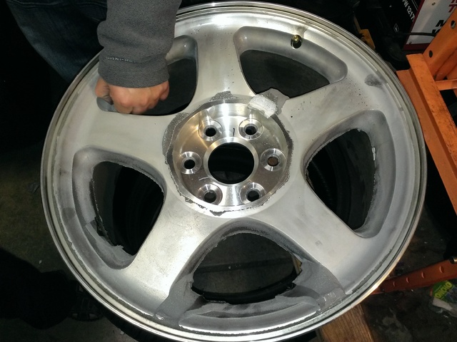

The next step took a very good power washer. The one down at the car wash didnt cut it for me, so we broke out the PW from storage. With the red rip, you can cut 2x4's cleanly- that made getting the rest of the cement off very easy. No sanding necessary.
Whats left on the spokes in the picture above is a adhesive on top of the clearcoat GM sealed the wheels with before the cement. About four cycles of Aircraft Stripper and pressure washing left a beautiful machined surface much like that of the NBS 2500 factory wheels. With no garage, having a loving and supportive family makes it a whole lot easier to work on these things during November & December when they are inside the house.
Some corrosion was present on the wheel- namely from the hammer on wheel weights. This was the only part that required sanding in the whole project and just a little bit of wet sanding went a long ways.
Sorry for the potato quality pictures, they get better at the important parts.

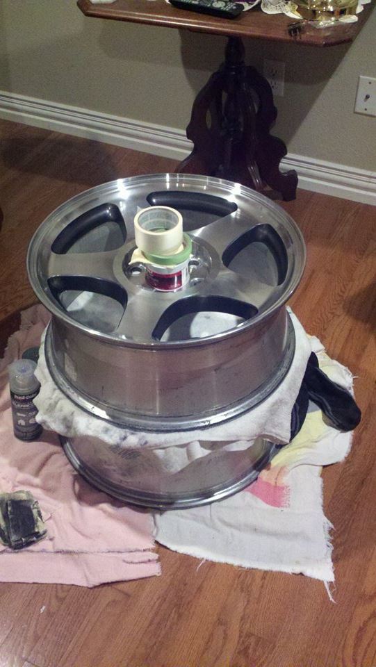

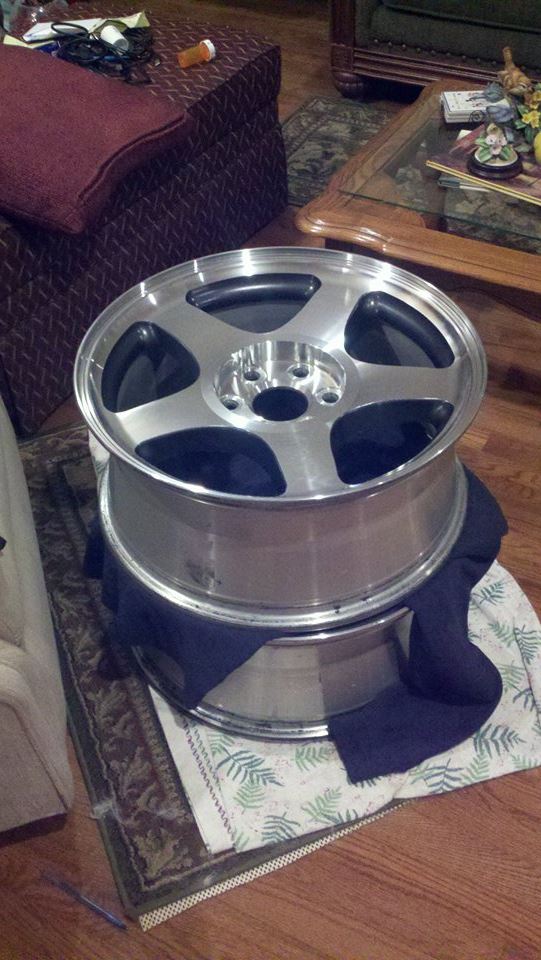

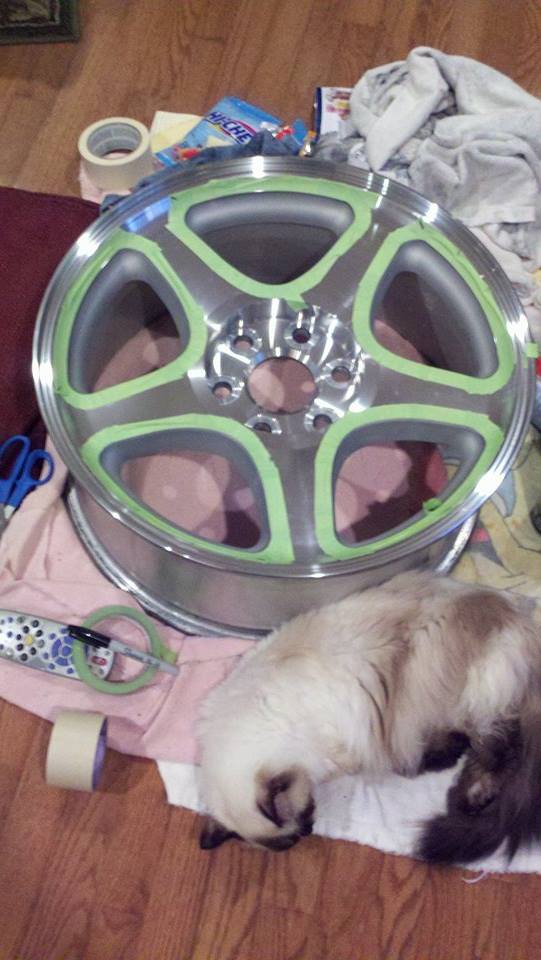

After wet sanding most all of the corrosion away and polishing every machined surface, Started taping off all of the polished surfaces (cat didnt help) for paint.

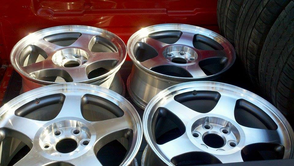

Toyota's BTY1619 Magnetic Gray Metallic went down really well.

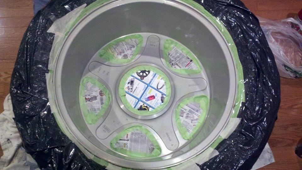

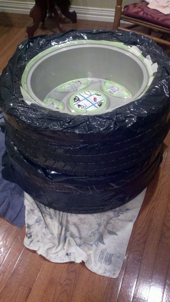

When the tires came back, did similar taping as the front, to avoid overspray.
After 2 coats of primer, 4 coats of Met. Gray, 3 coats of clear on the painted parts, and 3 weeks to cure the paint, I sealed the wheels all the way around with Opticoat.

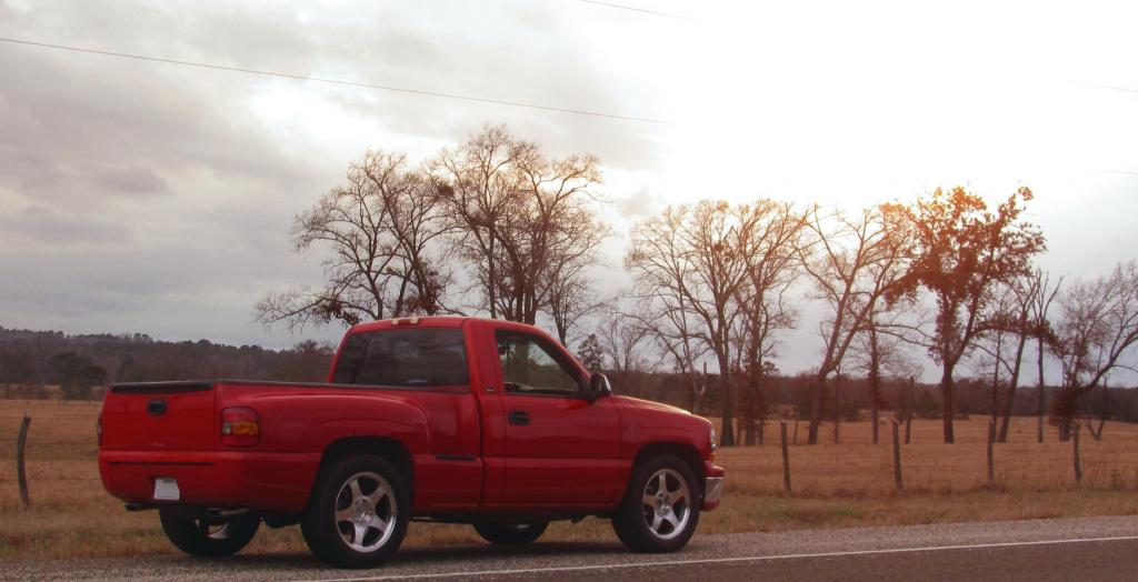

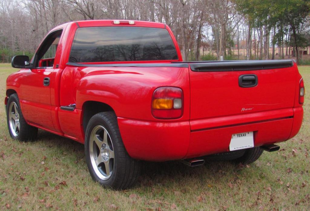

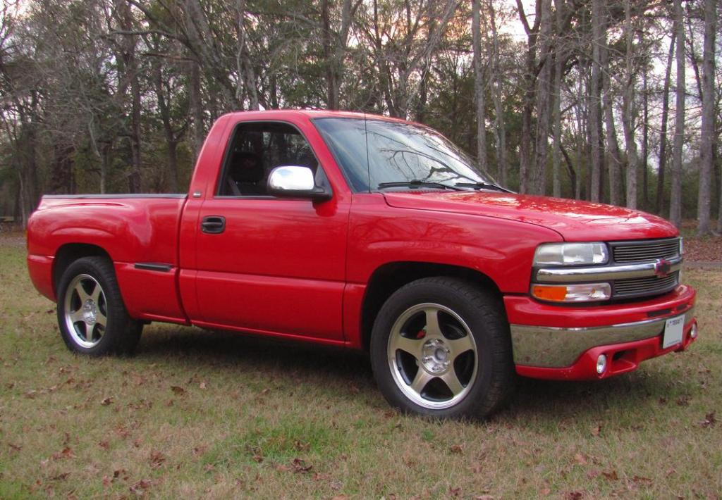

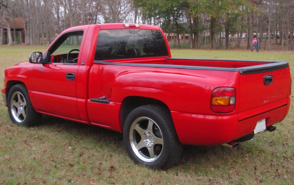

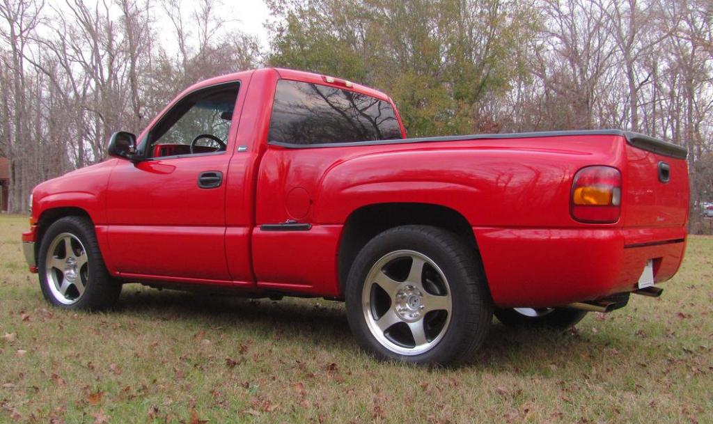

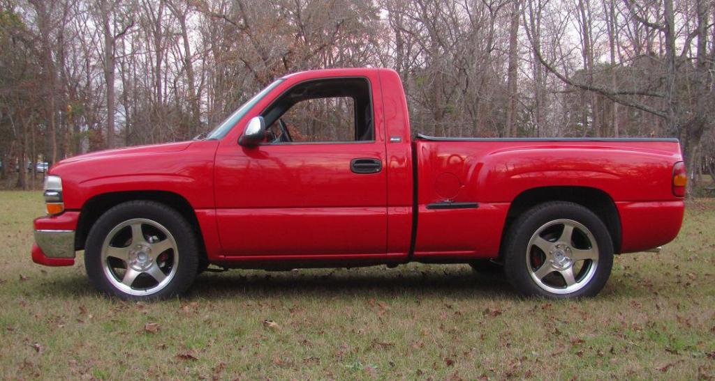

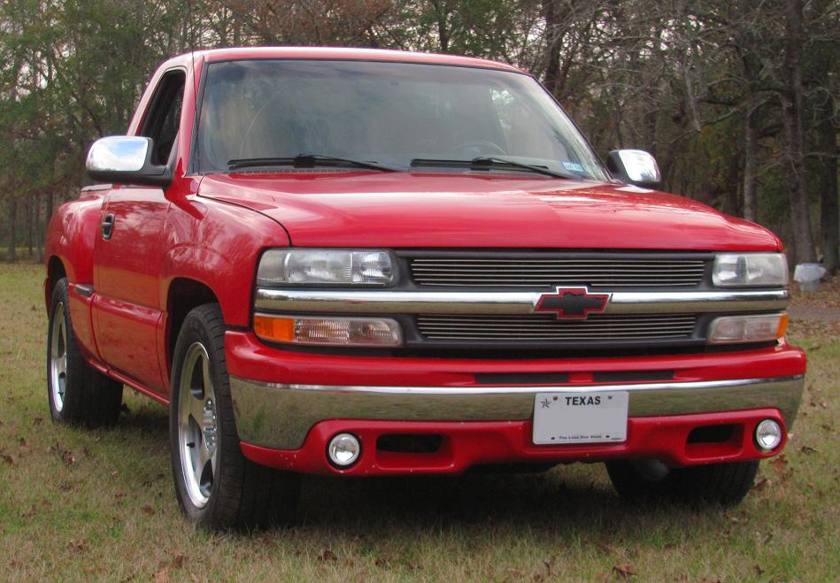

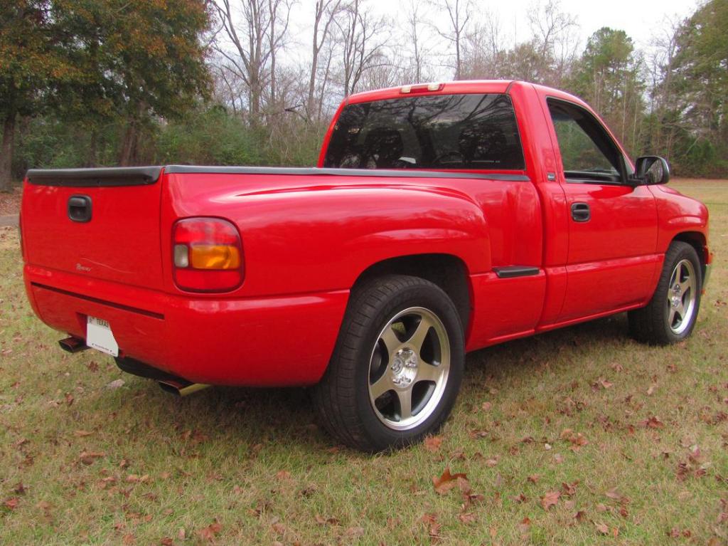

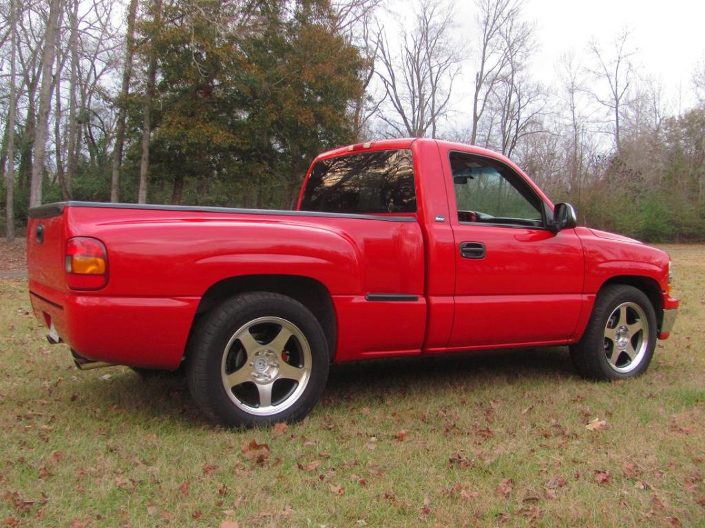

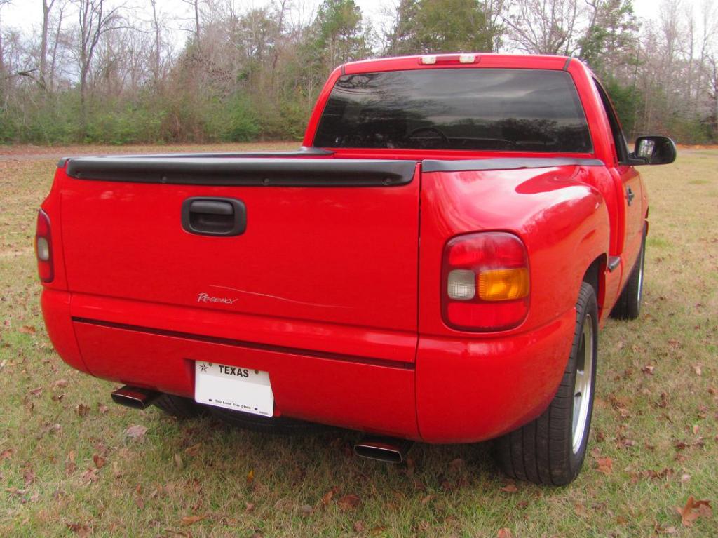

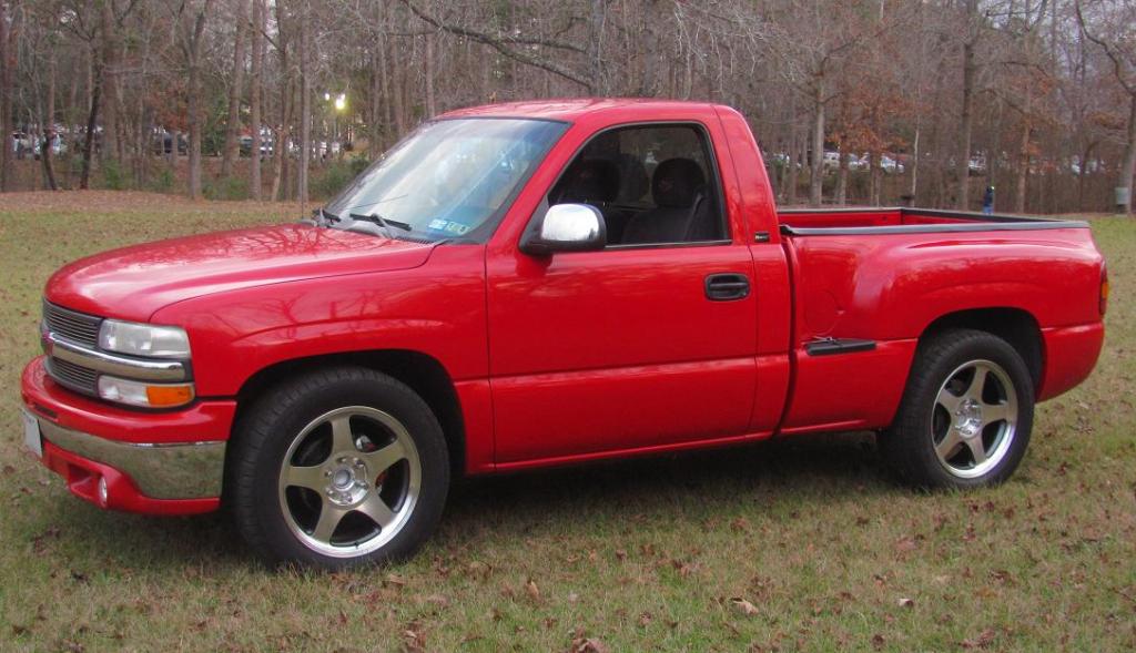

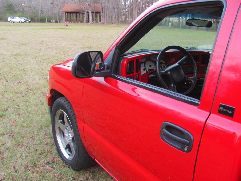

This is it currently- 130k miles
If you were like I were- uncertain how decladded 20 inch Chevy wheels would look on your NBS- now you have no excuse. For reference my truck has a 1/2 drop

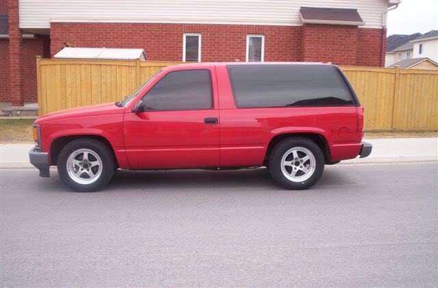

Nice!
FM5's on my old Tahoe
