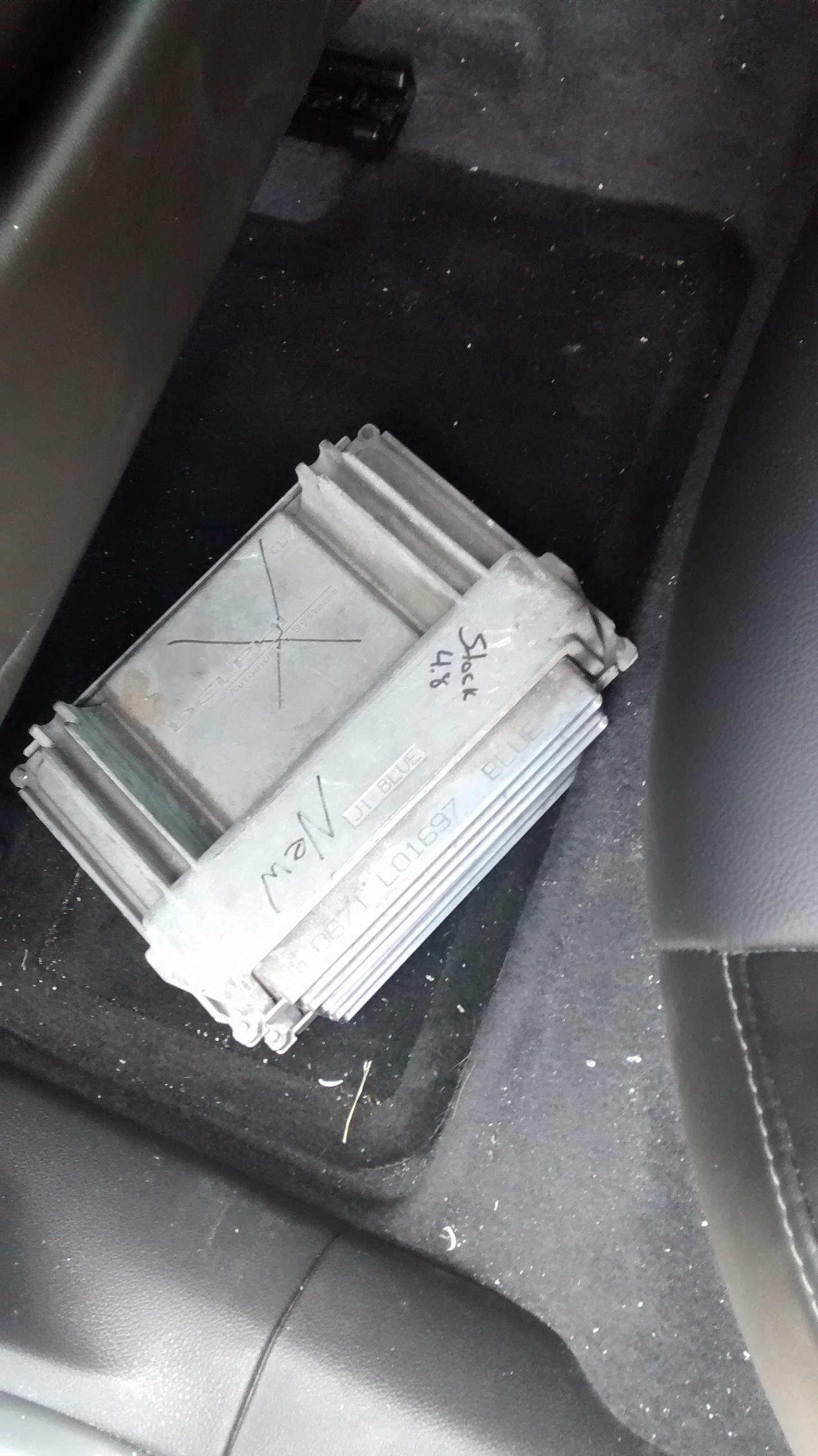

Likes: 109
From: FL
Great success!

It cranks, but won't start and run...
I am open to suggestions.

Do you have fuel,spark and crank signal?

Definitely have fuel. Not sure on the other two. Going to mess with it more today.
