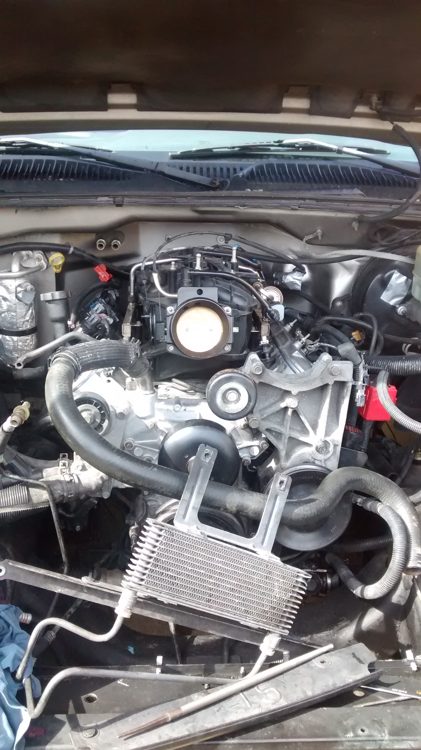

I pretty much have buttoned up everything underneath. I still need to install an extra 02 bung in the pipe that crosses over from the driver's side. (For the wideband sensor) I have noticed one of my transmission lines leaking from where it goes into the fitting on the case. It was cracked around the flare. I cut off about a 10" section of the line. I'll go get an AN fitting and some hose to fix the connection. I installed the engine oil dipstick and coil packs on the passenger side. Still can't figure out my heater hose connections, they were brittle and leaking. I broke them off and picked up a new dorman replacement, no matter with do - it won't slip into the nipple if the heater core. Great...
I stuck my intake manifold on for mock up. Not happy with the TB at all. I am going to buy a Nick Williams 92mm. I have always had good luck with his TBs in the past. I tried to save a few dollars, and it didn't work out.

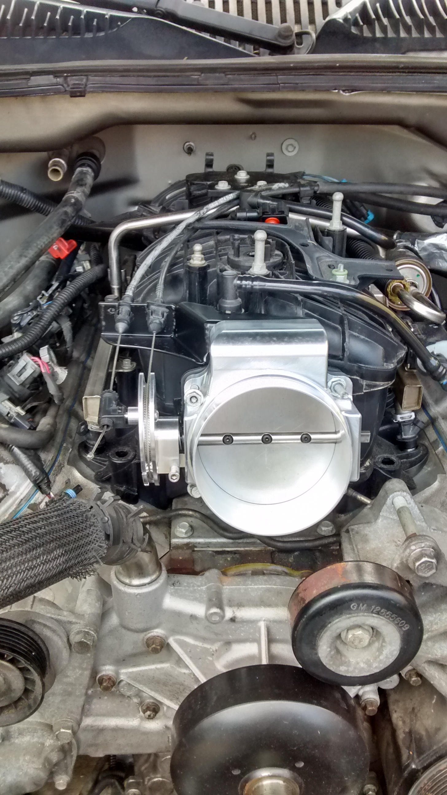

I am liking the Nick Williams TB much better. I was able to make the throttle cable bracket that SDPC sells work. Took a few mods, but it will do.

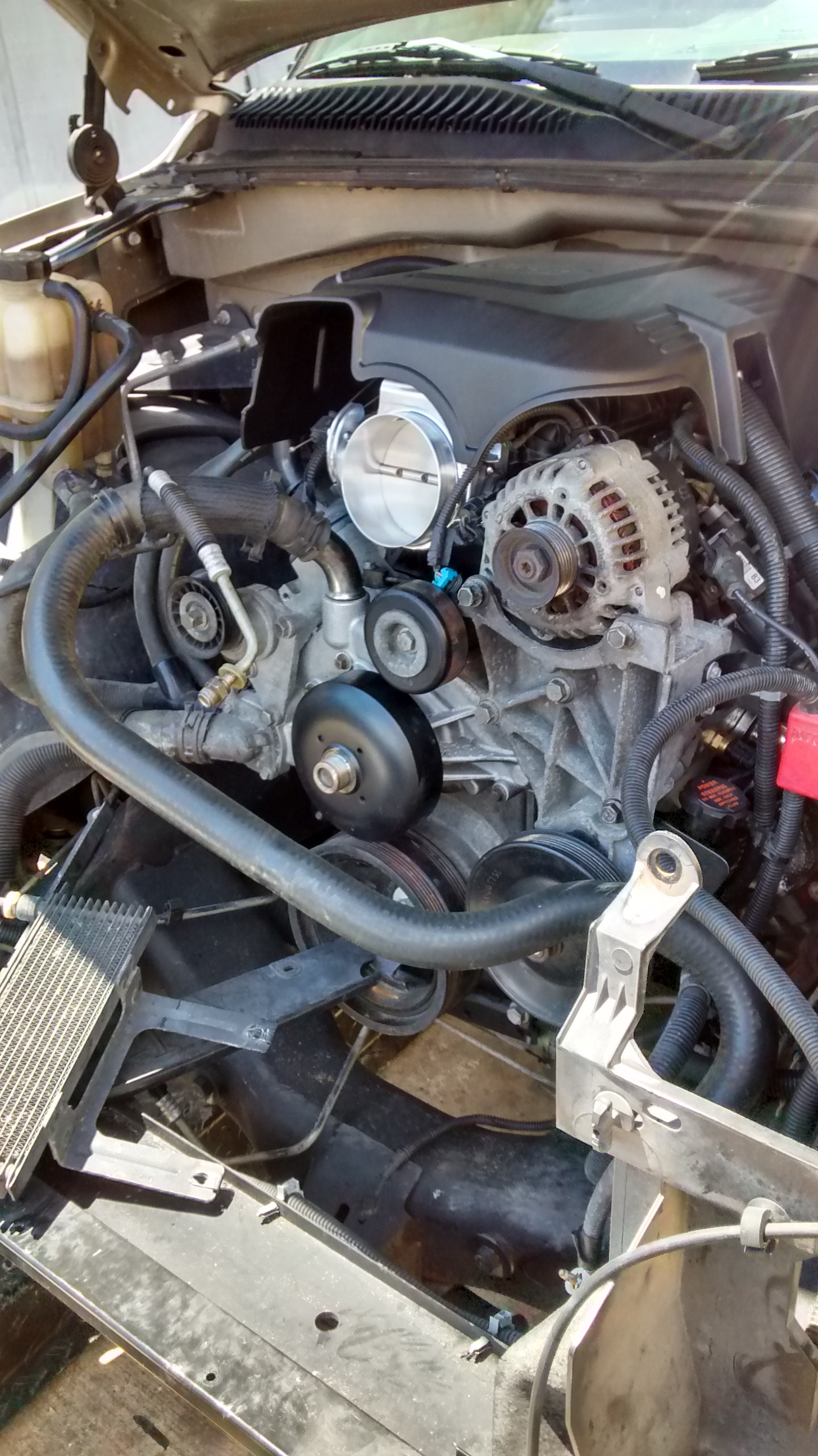

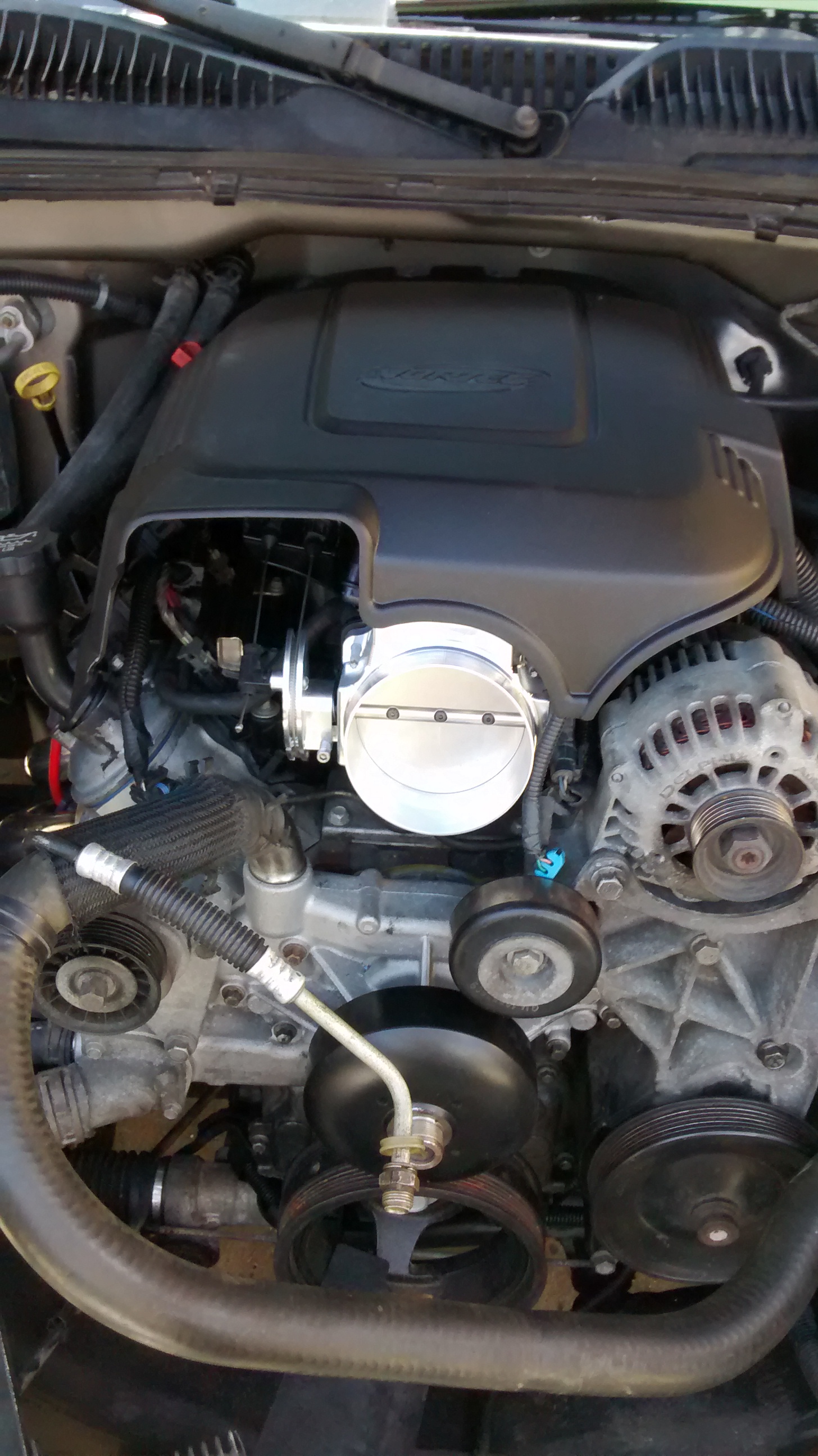

The intake manifold is on for good. I need fasteners for the TB , the factory stuff won't work. I only spent a few hours on it today, the heat is unbearable.
