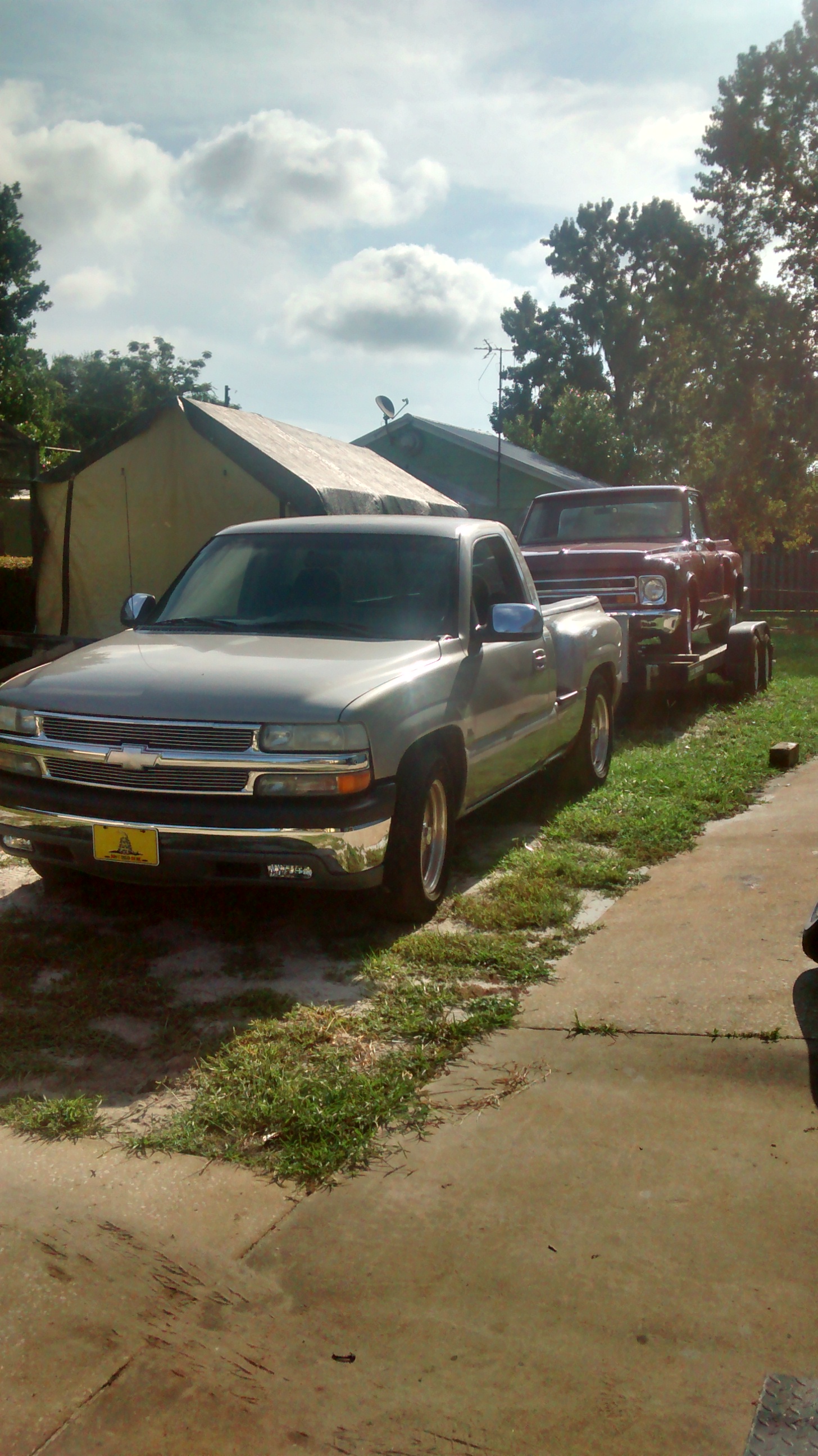

Just got back from filling it up with gas. It has all gears, locks the converter, etc. It just tries to shift 1-2-D, then lick the converter about 15 feet out of the driveway. If I manually shift it, it's much better.
I am already putting it to work, going to move my dad's C10 so we can get it on the lift and finish it.

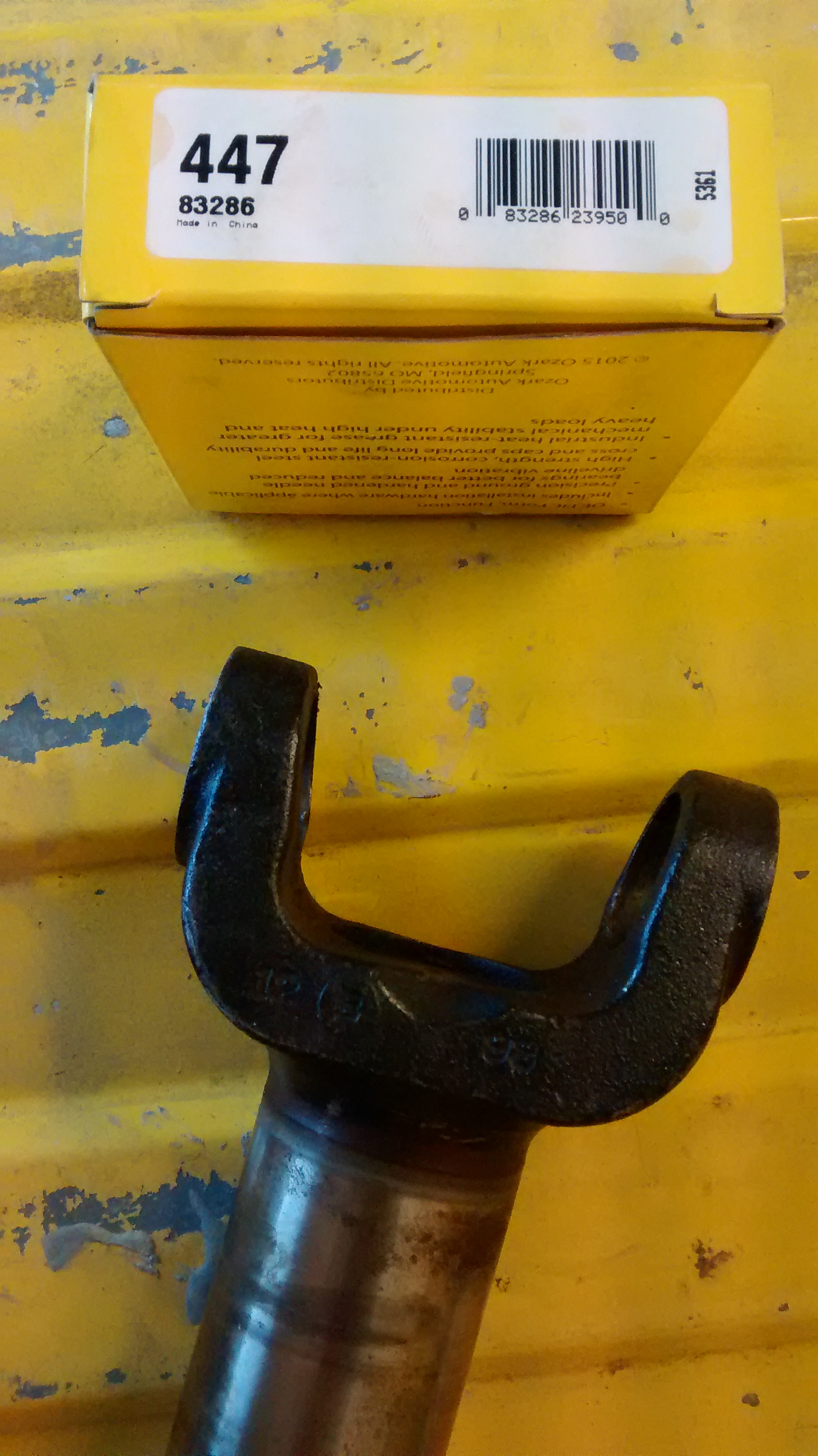

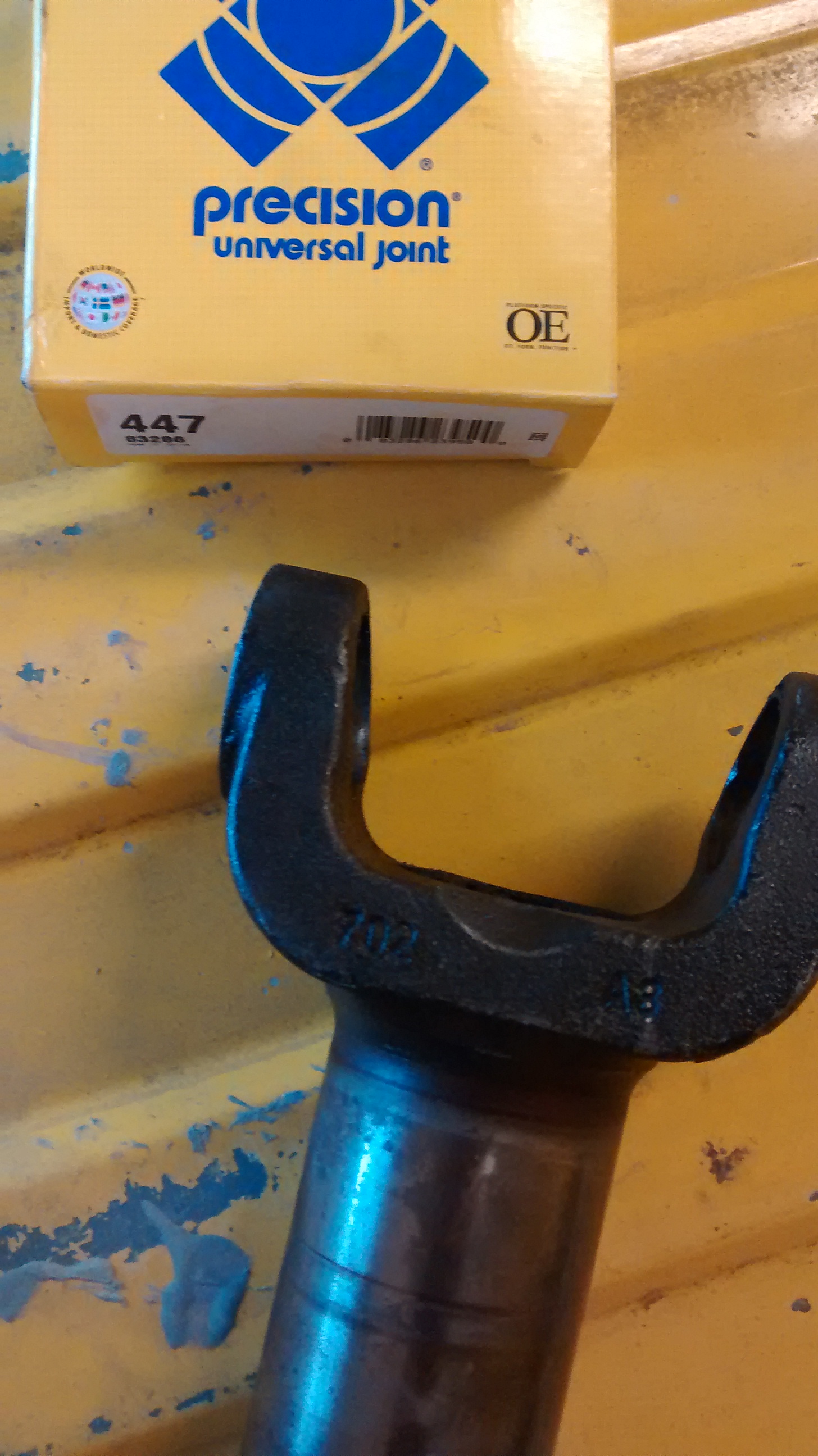

The truck is back together after the chassis dyno mishap with the driveshaft. I am going to post pictures of the yoke and universal joint that used in hopes that it helps someone else in the future. The yoke in my truck got destroyed, I happened to have a spare out of a 99' 3500 van with a 4L80E.
Attached Thumbnails RCSB LQ4/80E swap... Take two-img_20160929_140325849.jpg   RCSB LQ4/80E swap... Take two-img_20160929_140315519.jpg

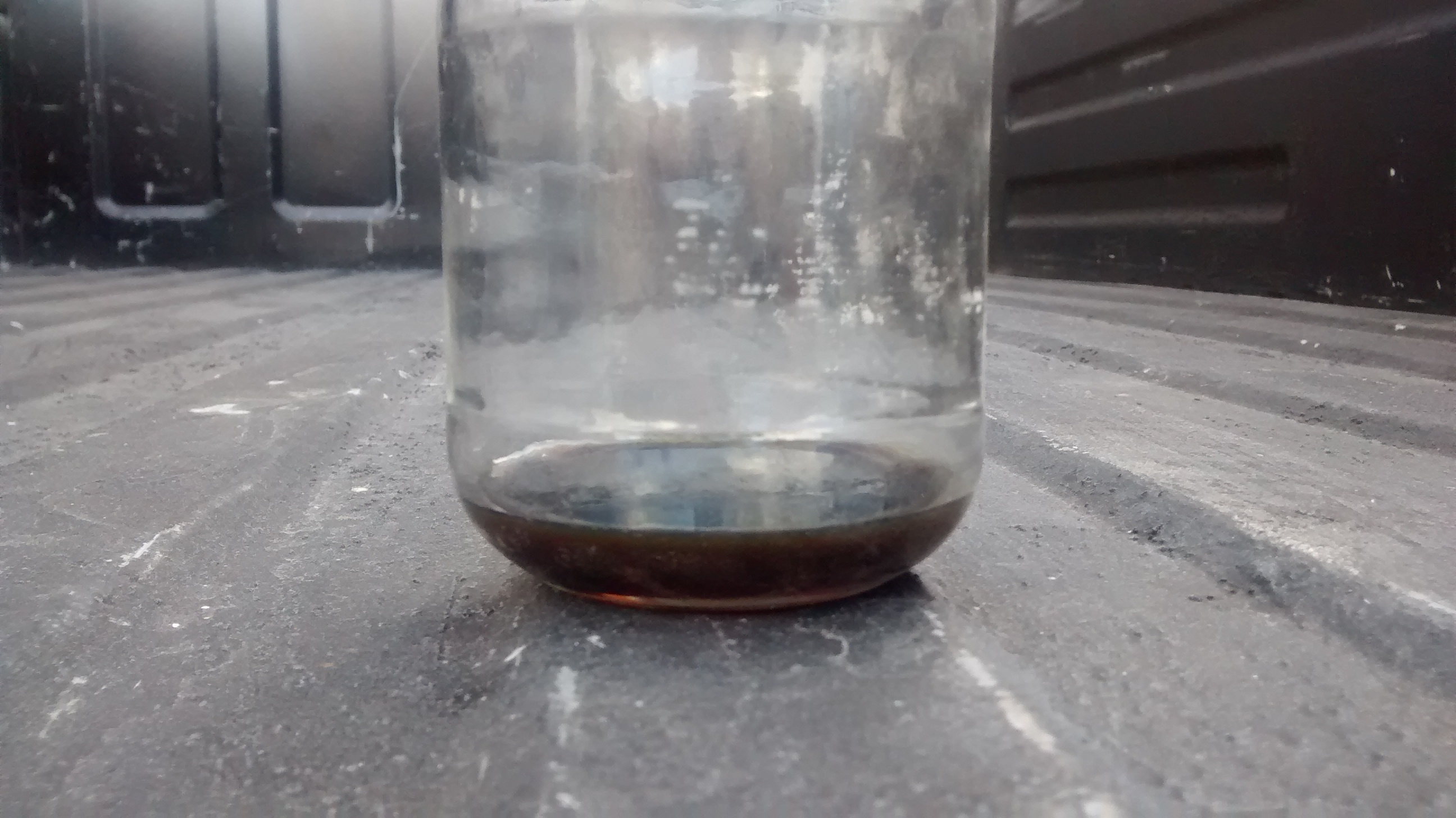

The truck is currently tuned for 87 octane... any thoughts on if it's worth having it tuned for 93 or E85? I am on a base tune currently. It runs and drives OK, but really needs a final tune to get it 100%.
Also, I attached a picture of what came out of the catch can after 1K miles.
