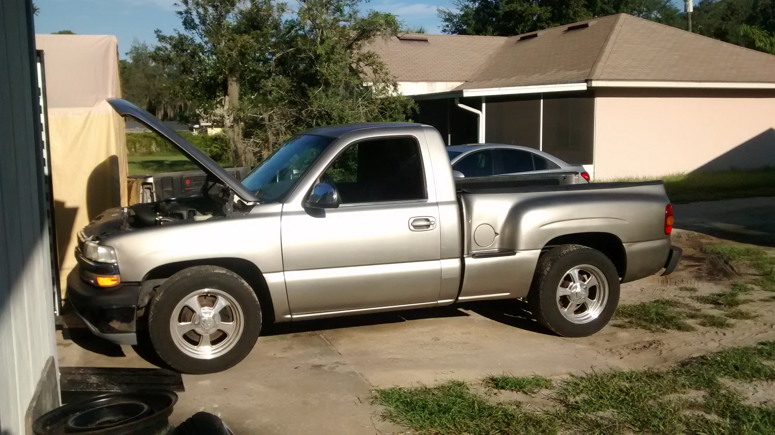

Old Sep 24, 2016 | 08:12 AM
  #90
10 Second Club
iTrader: (18)
Joined: Mar 2002
Posts: 2,191
Likes: 109
From: FL
Off the lift under it's own power, finally. Hope the transmission is OK, not liking how it's shifting. No SES lights, etc. More than likely needs more fine tuning and to be driven more.
