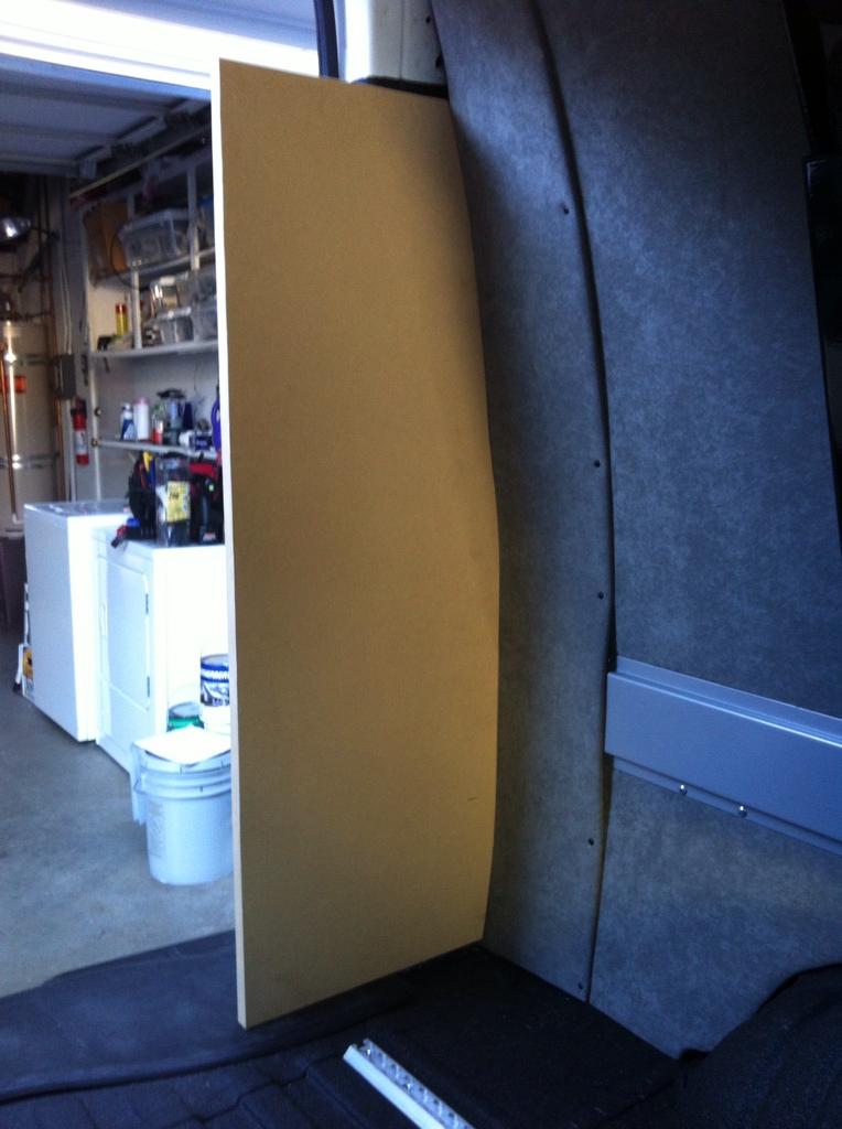

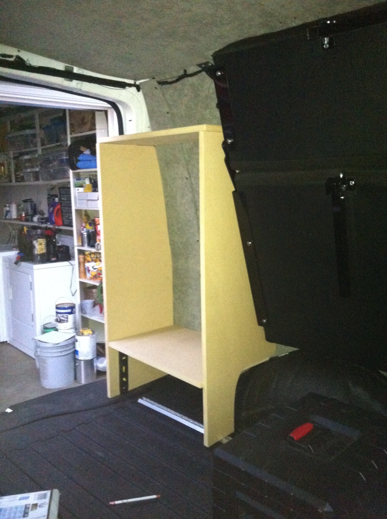

So I started the cabinet today and like I mentioned earlier, I picked up a sheet of 4x8' 3/4" MDF at home depot. Cost $30 so it wasn't too bad, not sure how much an equivalent sheet of Drywood would of been but this wasn't too bad on the wallet.
I think it reached triple digits today in LA

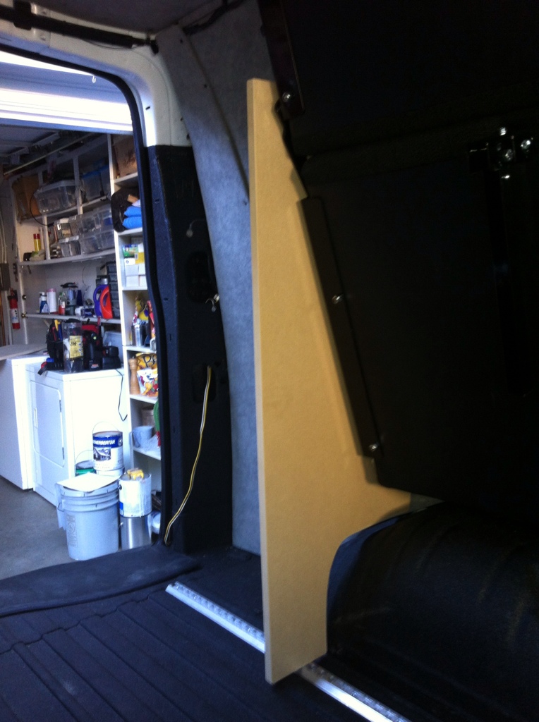

Here's the first upright, I'm from the school of measure once and cut 7 times!

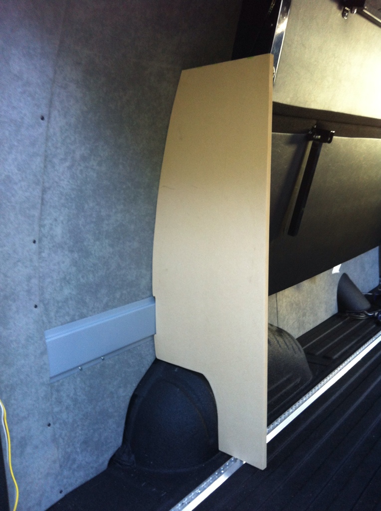

Followed by the second upright that's just behind the bed...

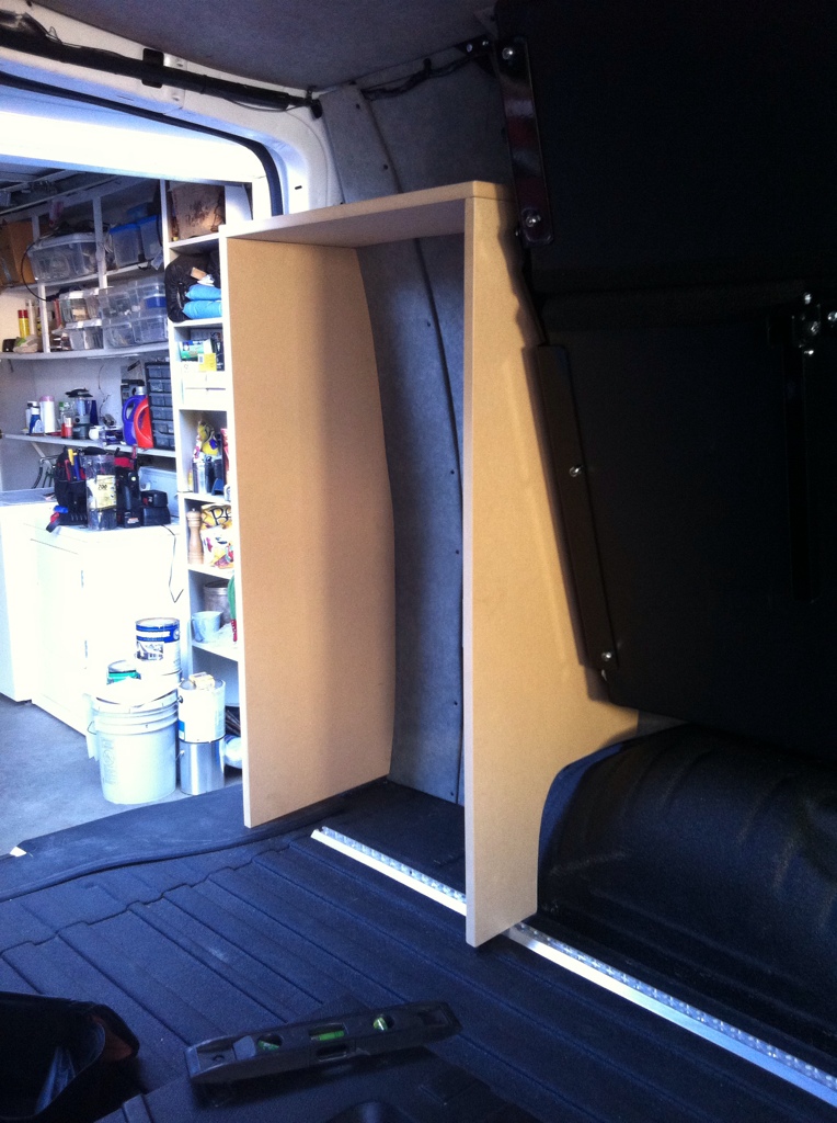

I got a little sloppy with the wheel well arch!

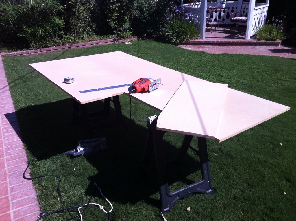

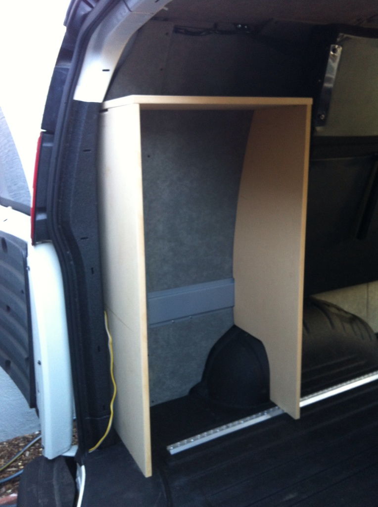

Made a top shelf, which took alot of time because of the contours but after quite a bit if sanding I think I got it just right...

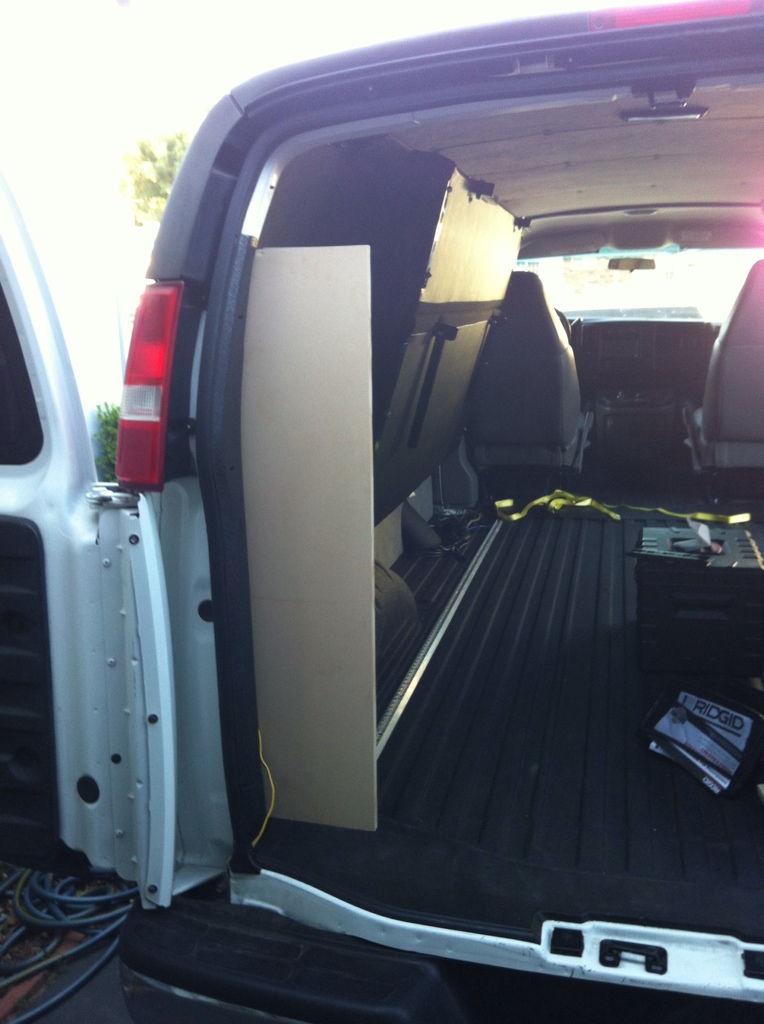

And followed by the bottom shelf:

I still have two shelves to build before I can cover it in something, not sure if I'm doing carpet, suede or something else. I just think it would be a waste to leave the MDF exposed when the rest of the walls are covered in suede. After it's all done I'm gonna bolt up a steel basket up top so I can store extra oil, fluids, straps or whatever.
I bought some "Loctight power grab heavy duty" today at the advice of a guy at Home Depot but am gonna return it and instead get some Liquid nail at the advice of a friend. So I figure with Liquid nail, and some wood screws it should hold the cabinet together real well.

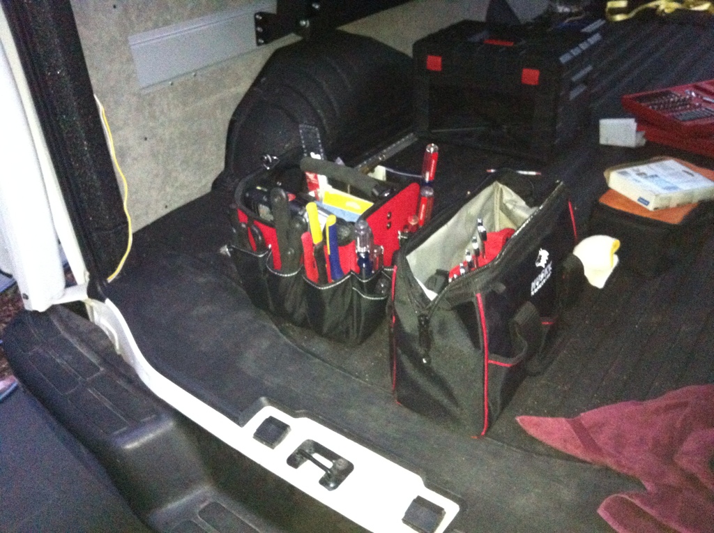

I also bought some tool bags to hold all the misc tools and make it easier to store it. Ended up getting a basket and a gearbag.
