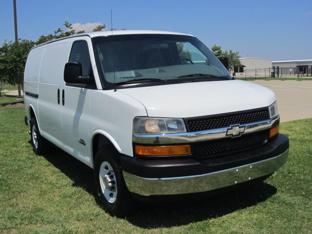

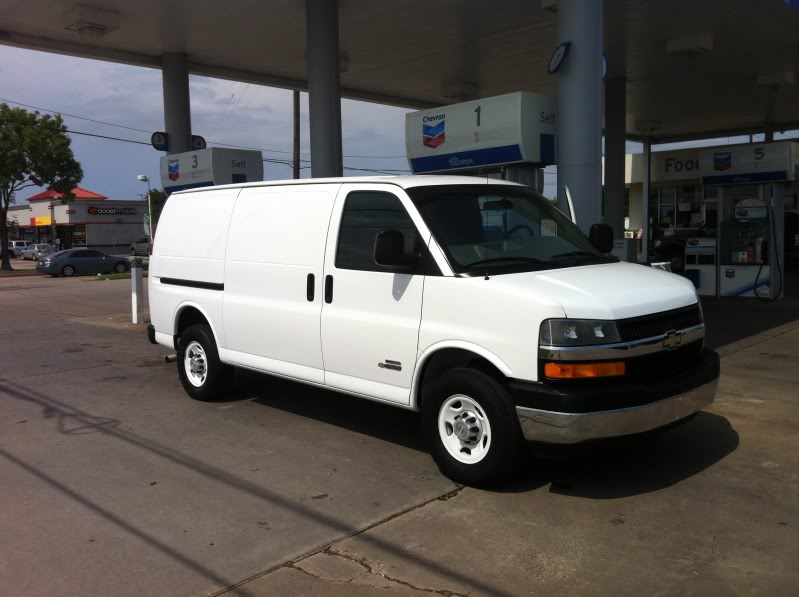

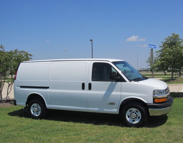

Here's what it looked like when I bought it...had to fly to Houston to get it. Diesel vans are not that common really so had to go out of town to get one. Its a 2006 Chevy Express 2500 Duramax Diesel. Was an ex Anheiser-Busch company van. Was assigned to one employee since it was bought so all in all it was really well taken care of.

First fill up! Averaging 18.5mph completely stock

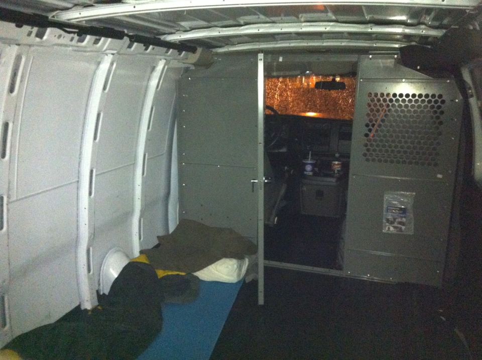

I slept in the van on the drive back home...wasn't too bad but definitly plan on doing something about that in the near future...
Inside was stripped down and cleaned by the Used car lot, wasn't too pleased with that since they posted pictures of it as being fully paneled inside. Got him to knock some of the price down but still wasn't too thrilled about it.

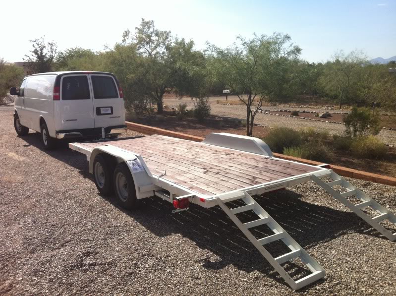

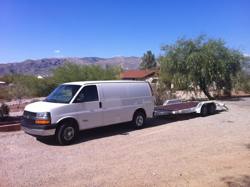

Installed a class V tow hitch on it and bought myself a car hauler. She towed really well when I finally got to trailer load situated correctly. Averaged 14.5mpg's while towing +/- 10,000lbs.

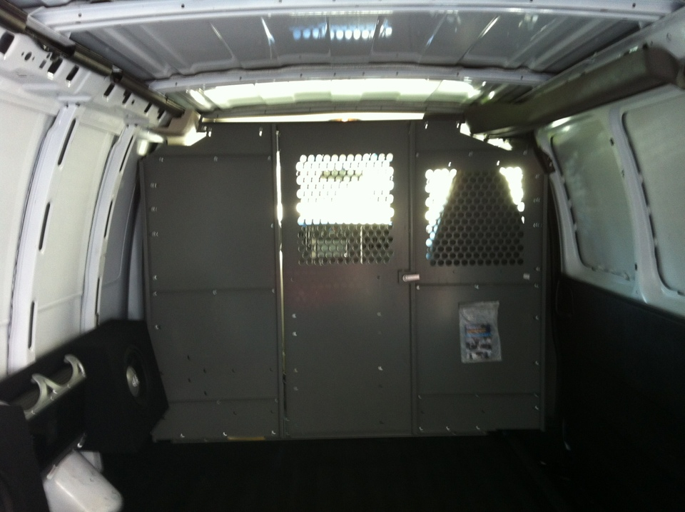

Followed that by ripping out the stupid cage.

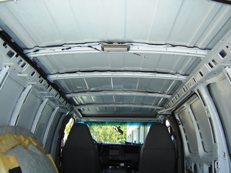

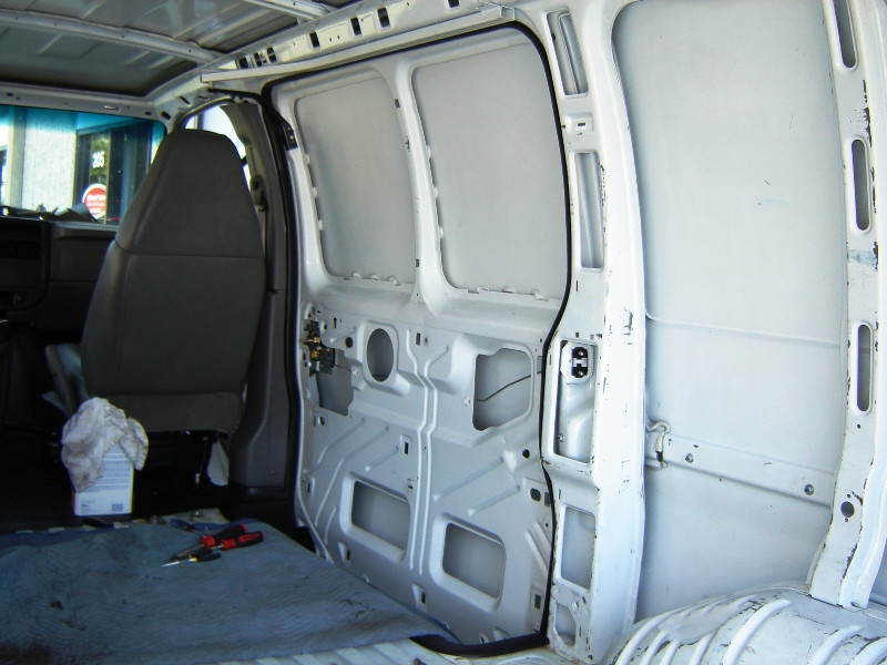

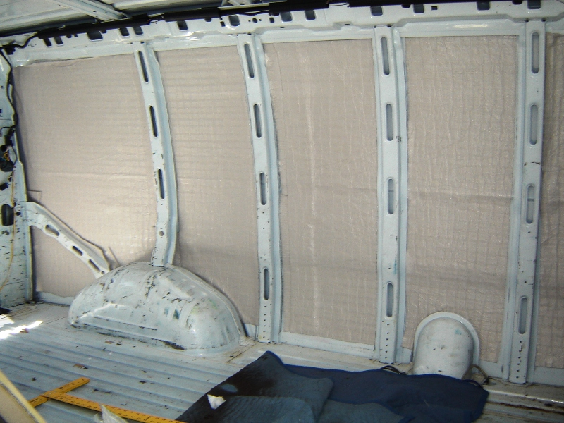

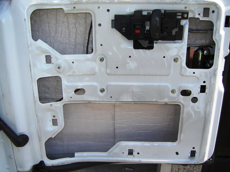

Decided on Radiant Technology Double Sided Reflective Insulation - Rated R19 at 75 degrees inside. Should help keep the van at even temperature during hot days and not act as such a Heat absorbing Tin Can during the day and a freezer at night.

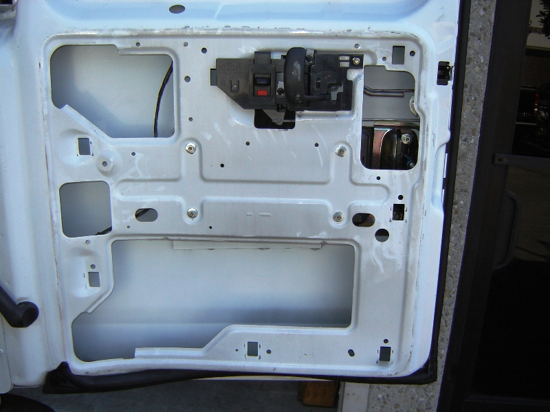

Ripped out the headliner and the door panels and wiped down all the interior walls...
Also ripped out the crappy POS rubber mat that was on the floor, underneath it was 6 years of spilled beer and nasty rotted out insulation!
Here's with the Insulation installed...

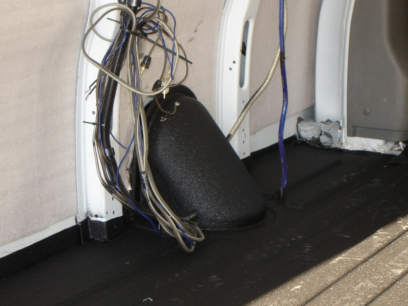

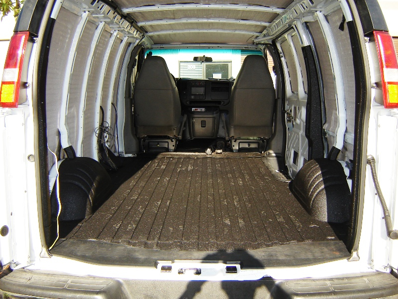

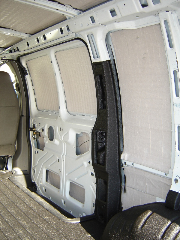

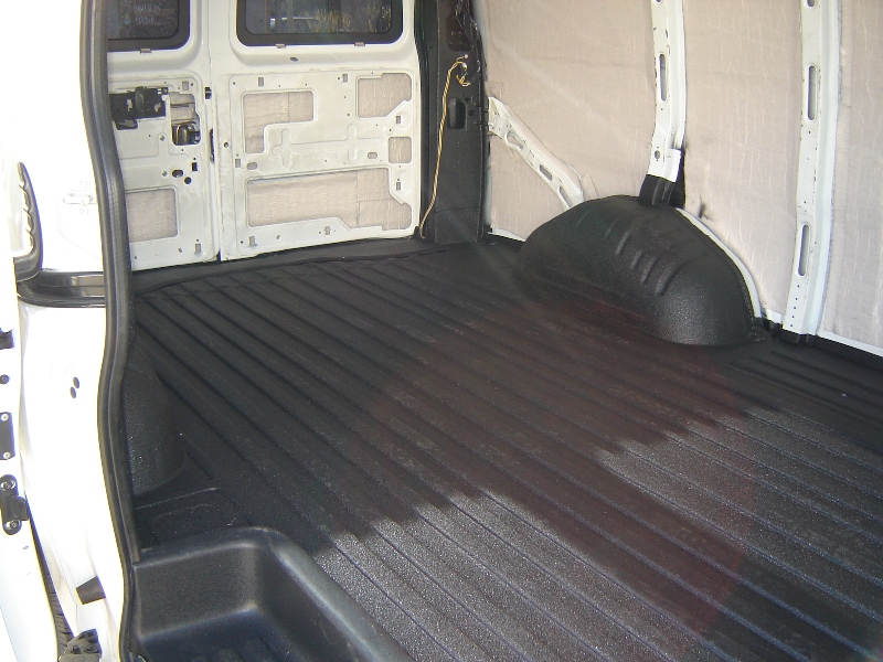

Next up was to do the floors, had a bunch of different ideas but settled on Rhino-lining it... was more expensive than I thought it would be but I think it came out great! Notice that I had them go up the walls an inch so it fills all the cracks between the floor and the van walls. This way I can hose down the interior and the van has a bath-tub effect and that water can drain out.

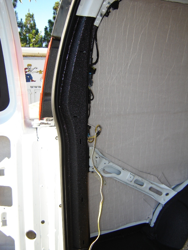

Had them do the uprights as well so that they won't get too dinged up when I load gear and bikes in and out of it. The ones that are coated are the support ones, all the other ones I've learned are only there to keep the van sides from flexing in and out while the van is at speed, so essentially I cannot use them as tie-down supports or what not.

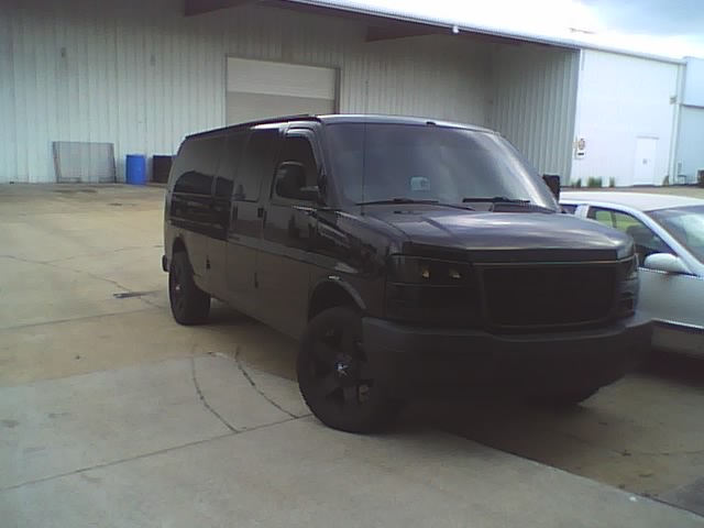

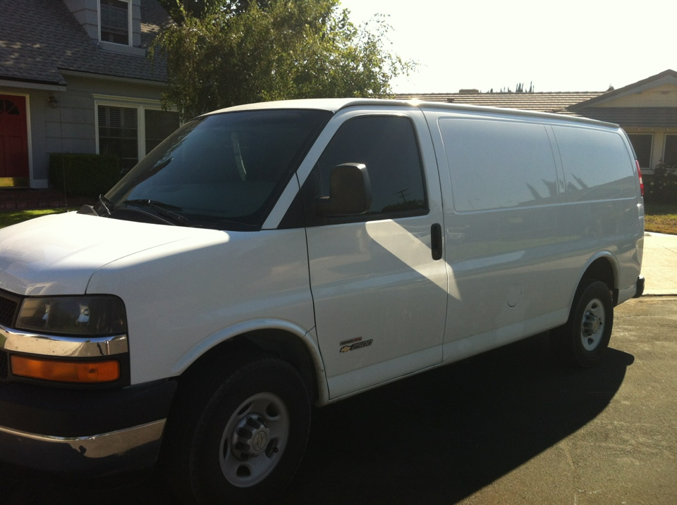

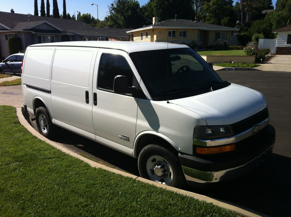

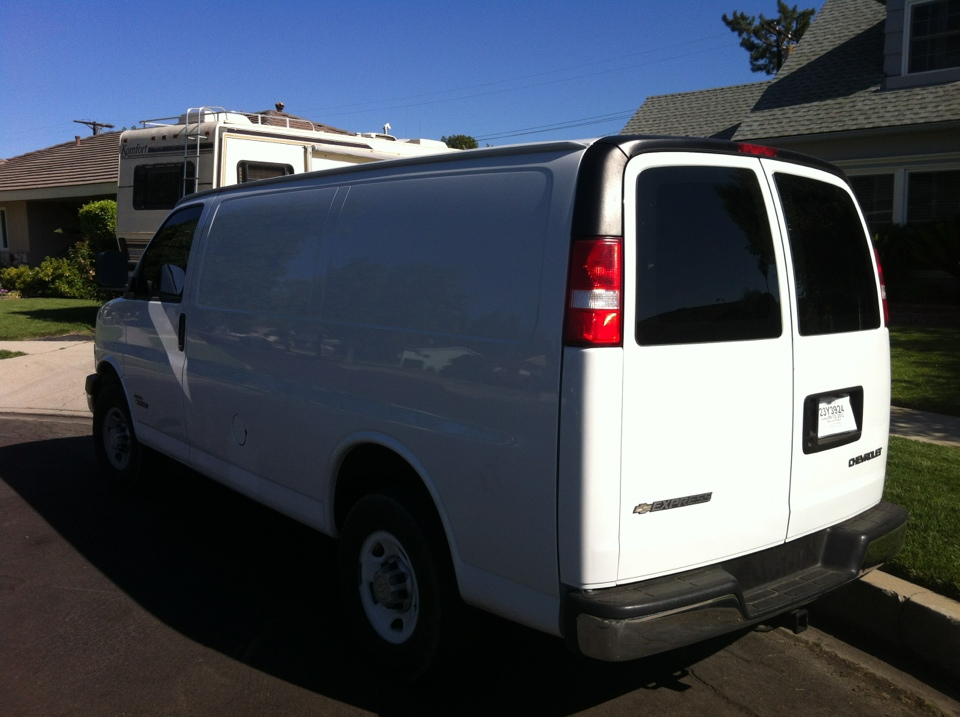

Also got the windows on the Van tinted, I've tinted about 10-11 vehicles so far and it always blows my mind how much cooler the inside of a vehicle is once you get dark tint! Score!!

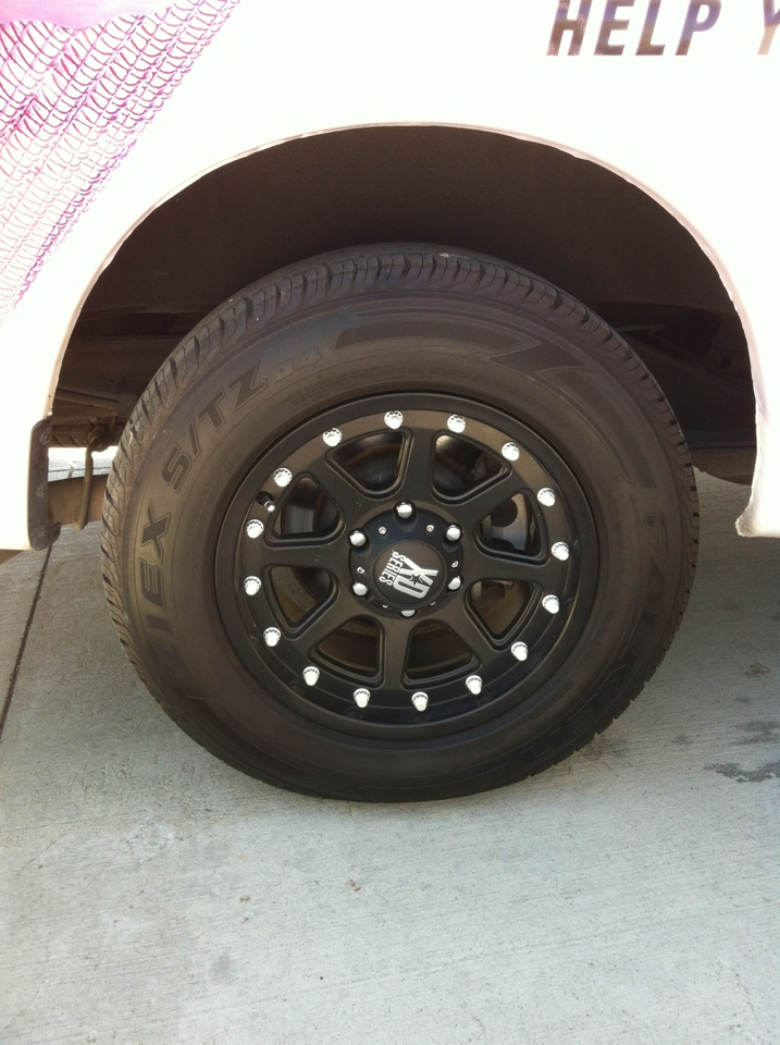

-Saw these wheels on a van the other day so maybe get something similar...

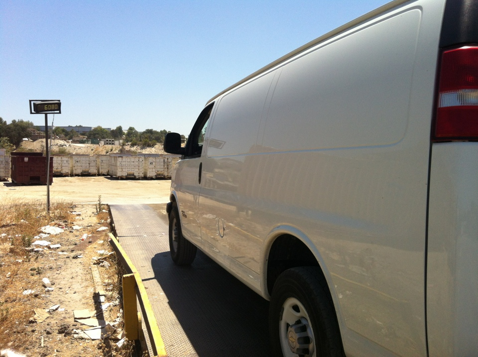

I weighed this fat bitch and came up with 6080 fully stripped!
