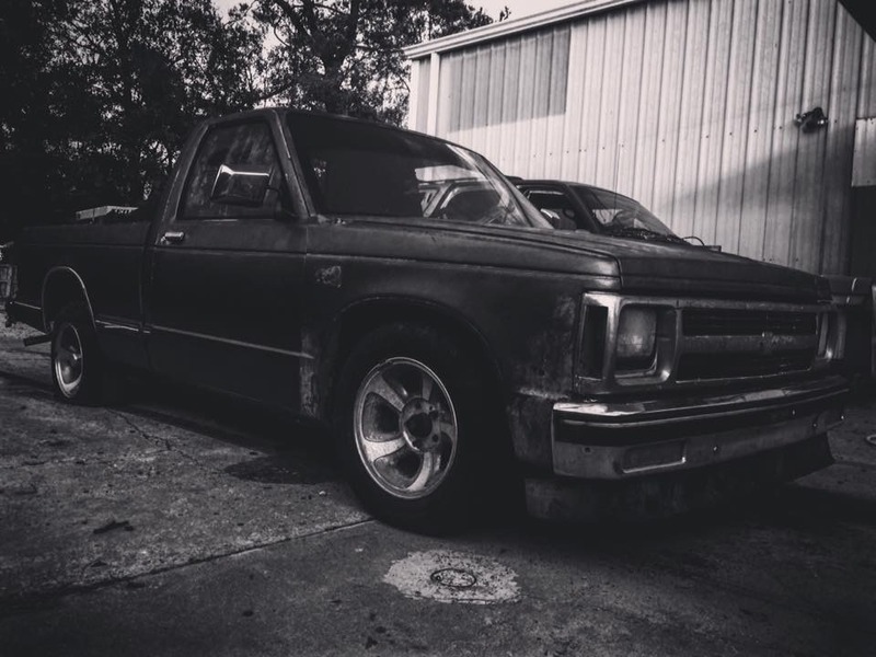

Just started my newest project. A small tire "streetable" ls powered s10. Plan is swap my old 5.3 from my 01 silverado into it backed with a powerglide. direct port nitrous. 10 pt cage and alluminum dash. stock style suspention with a 28x10.5 slick under it.
The motor already has a 220/220 .581/.581 112lsa cam, comp valve springs and pushrods. 42lb injectors and rest is stock. i have a set of 799 heads i may mill and have ported to swap on and also a tbss 90mm intake. or may just leave it alone and go to a holley mid rise down the road.
the build will be slow as i work 28 days and only home for 14. i am stacking up parts slowly and then should come together quickly. i have already pulled the old 350/350 combo out and stripped the firewall and dash out. i plan on making it light as possible so i will be cutting the engine crossmember and putting tube in place, as well as maybe the front frame horns. tubular arms, fiberglass fenders and hood and maybe building own core support.

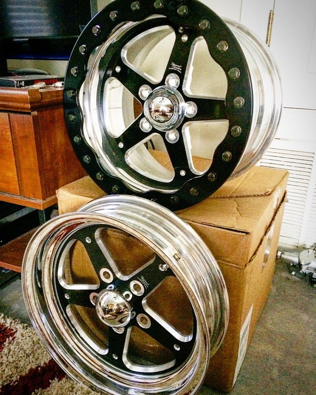

Wheels/tires:
Dark Stars
15x10 rear with hoosier 28x10.5 slick
15x3.75 front with hoosier 27x4.5

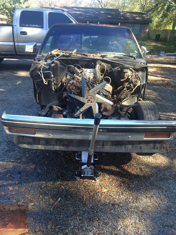

pulling the 350 out

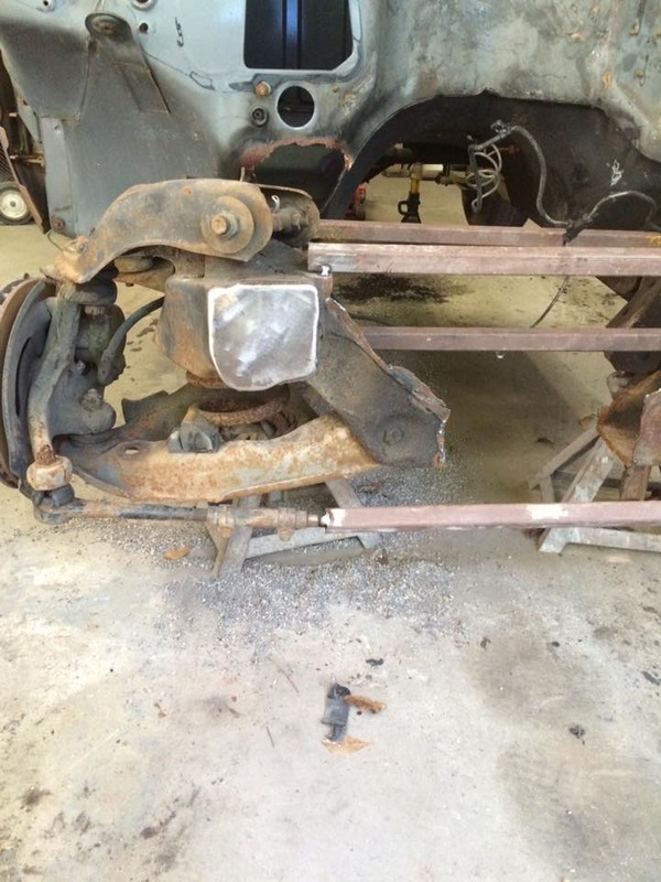

goin to its resting place for the build

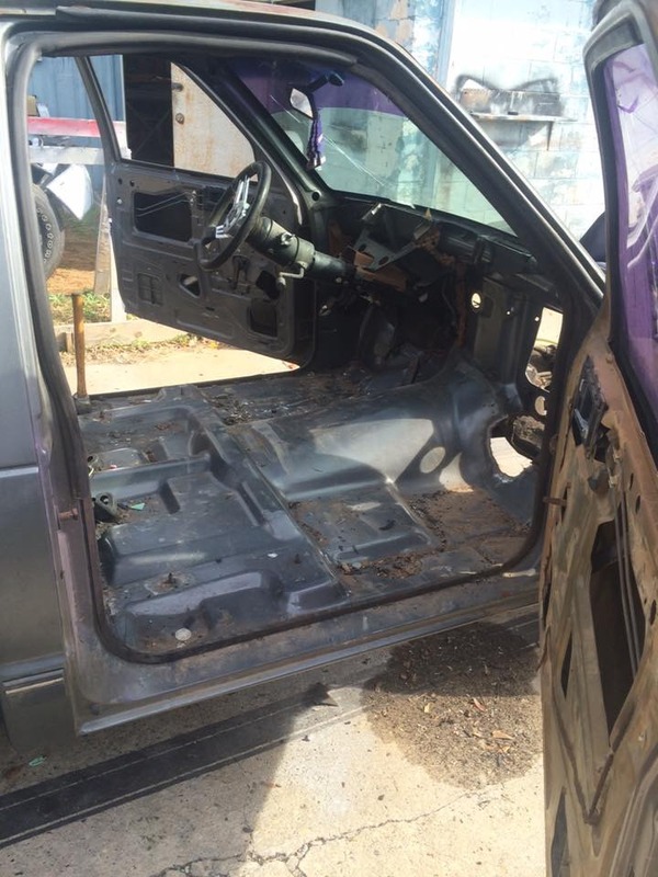

this **** gota go!
thats better

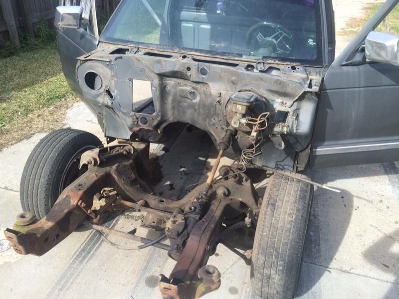

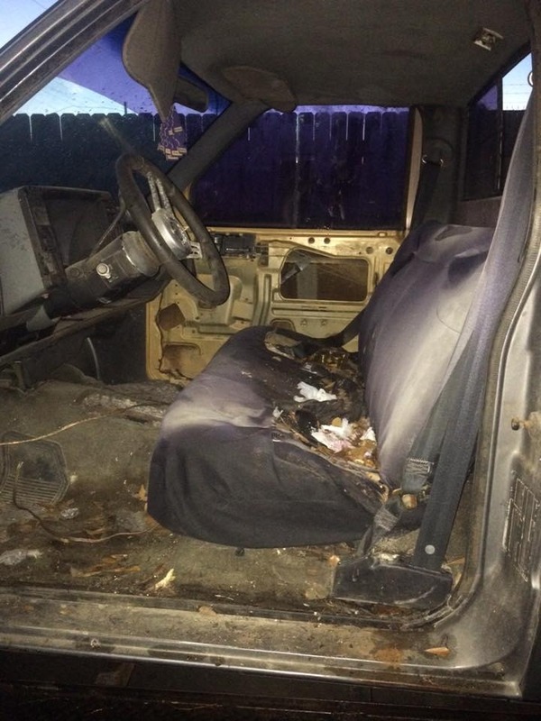

firewall cleaned off

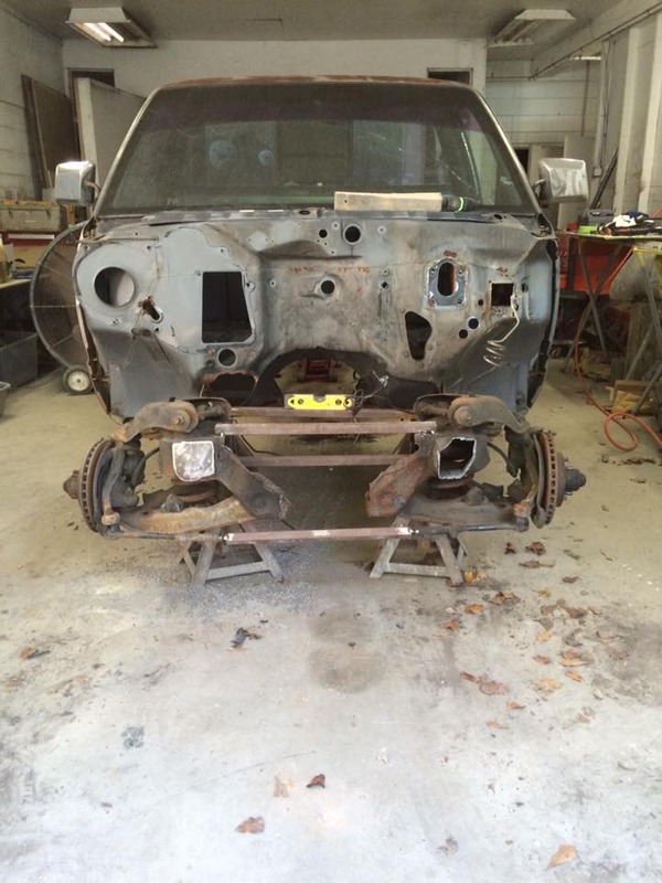

hung the front cap back on for now

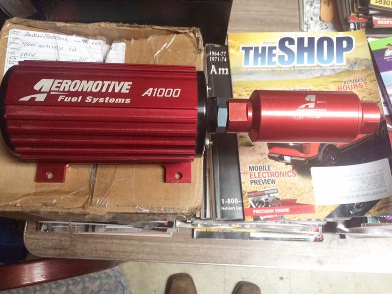

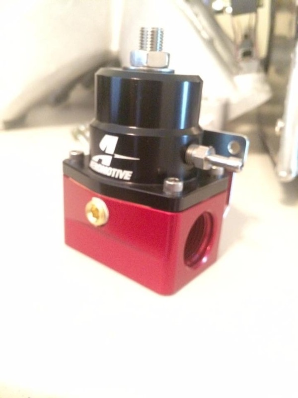

Aeromotive A1000 pump i got for a killer deal

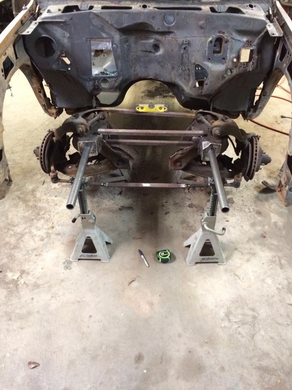

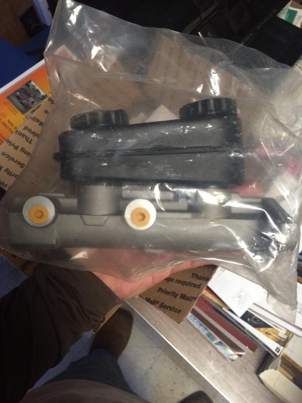

wilwood manual master

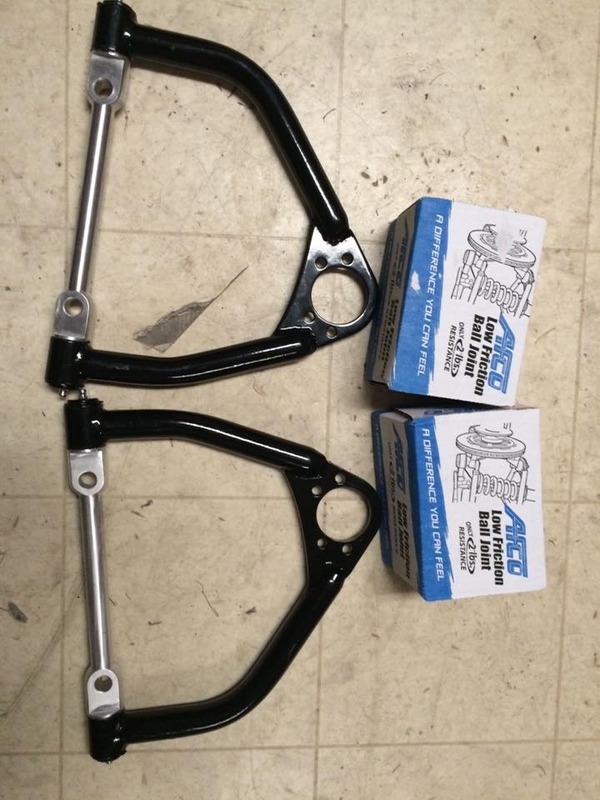

speedway tubular uppers

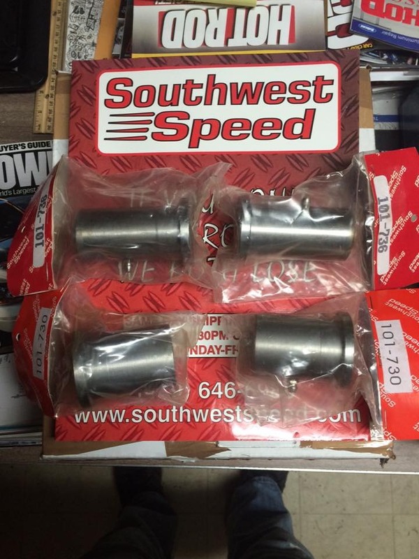

solid lower bushings

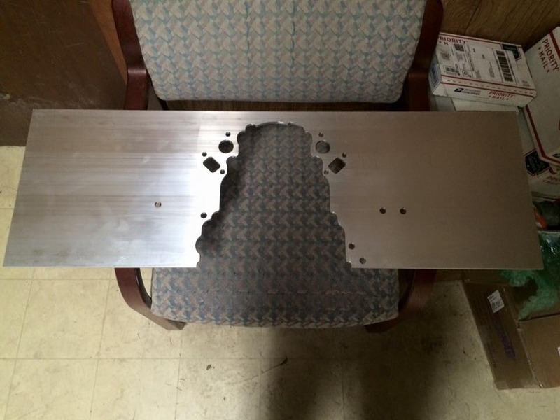

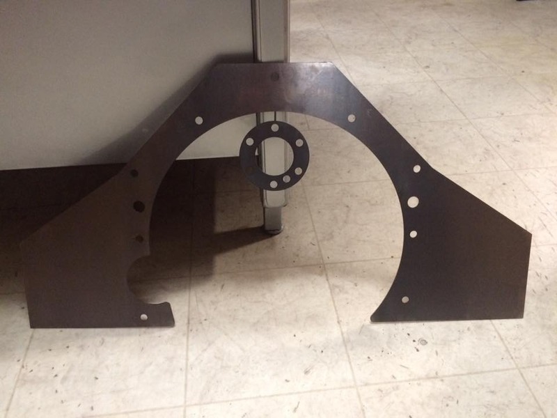

ict billet motor plate

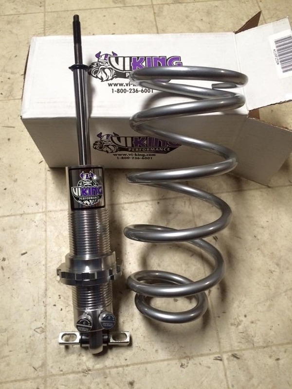

Size:  117.0 KBViking coil overs

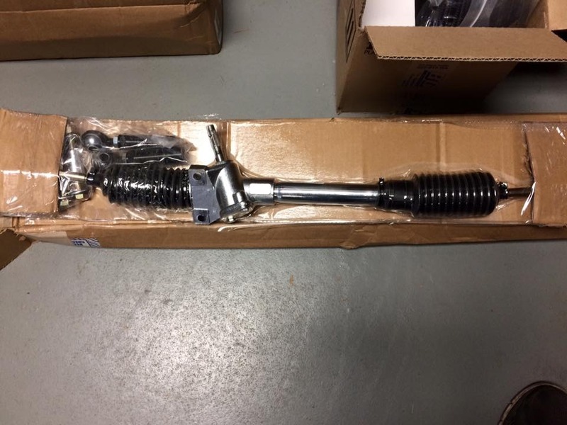

TRZ rack an pinion

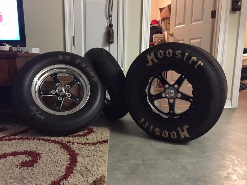

Hoosier 28x10s with only 1 burnout

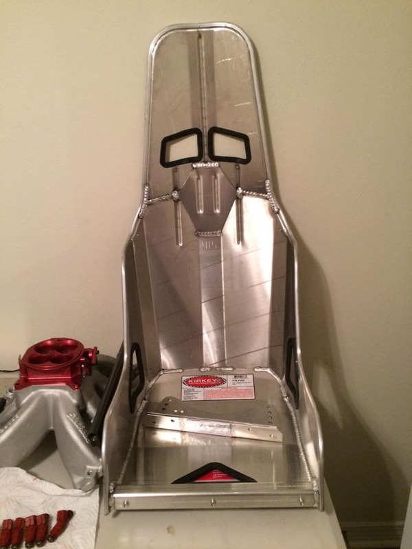

Kirkey pro street drag seat

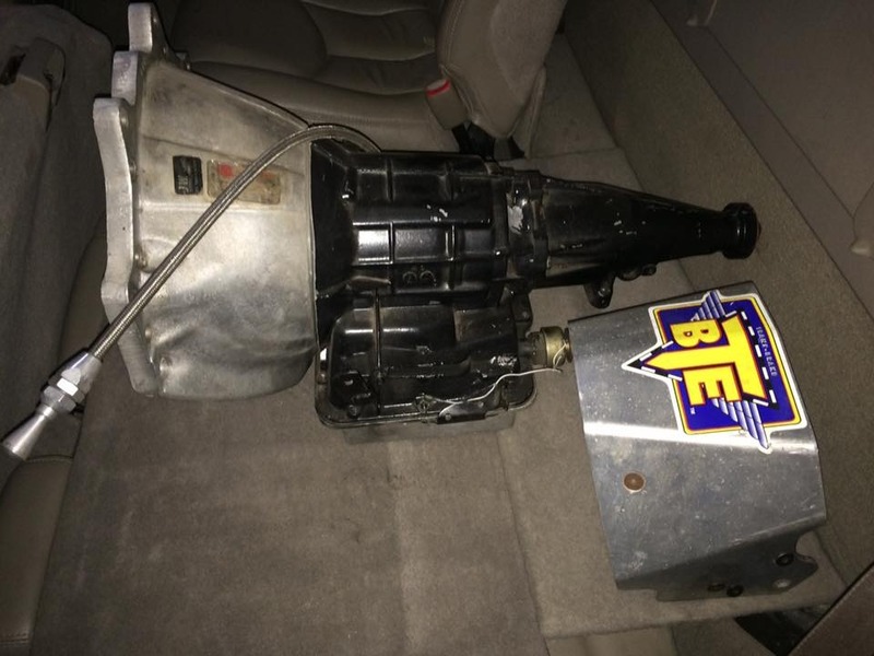

Glide fresh built with 1.80 straight gearset, turbo input, dual ring servo, t brake, deep pan, jw ultra bell, etc
cleaning out a spot in the shop an will be tearing into it. Ordering my cage kit an gona chop the front frame off and begin to fab that up...if anyone has pics of how theirs is setup that would be awsome. i picked up some 1 5/8ths DOM but thinking maybe stepping down to 1 1/2 stuff. Also got a mid plate on the way.

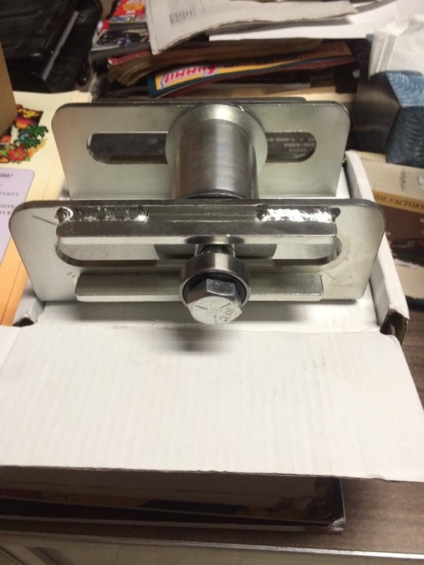

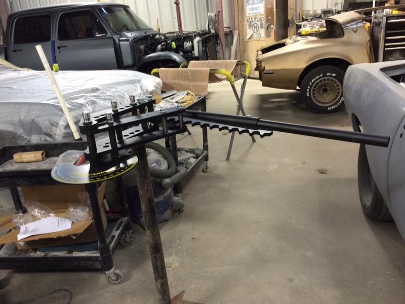

Got a few more parts in.... Also ordered a JD2 Model 3 bender and 1.5 180 degree die. 8ft stalk of 1.5 dom .095 wall, 8 ft of 1.5 .120 wall, 12x36 .125 sheet steel, and 4ft of 2x3 .125 wall rectangle tube. plan on using the .120 wall stuff for the new frame rails, the .095 stuff ill use for crossmembers and to mount my rack to. the 2x3 ill use for outriggers to tie my cage to frame.
anyways heres what i got in...soon some progress will be made besides stacking parts lol

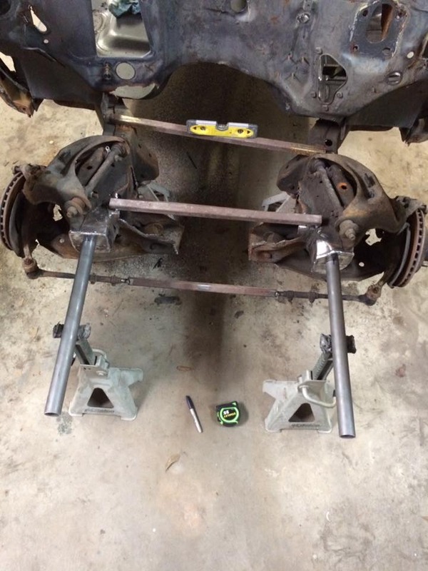

just a quick look at where i plan on cutting to shorten it

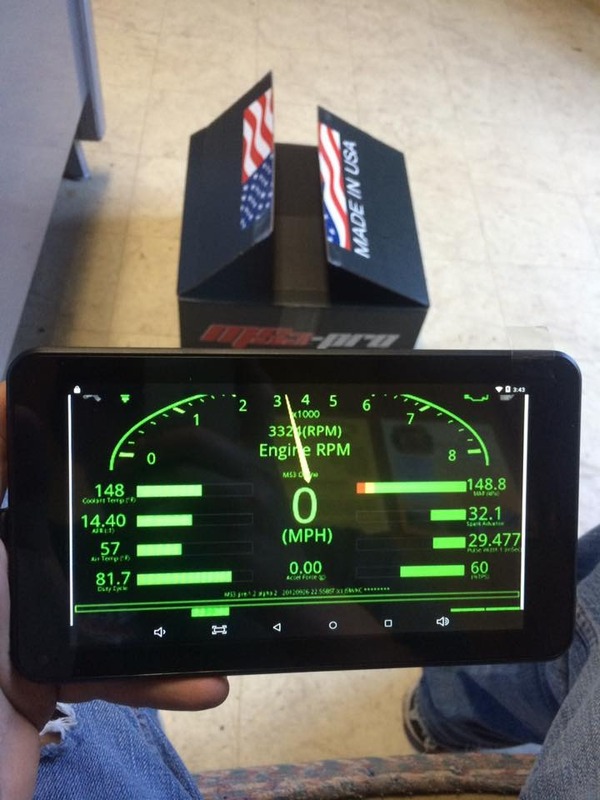

And got my Megasquirt MS3 Pro in along with a 7'' tablet to use for gauges and datalogging

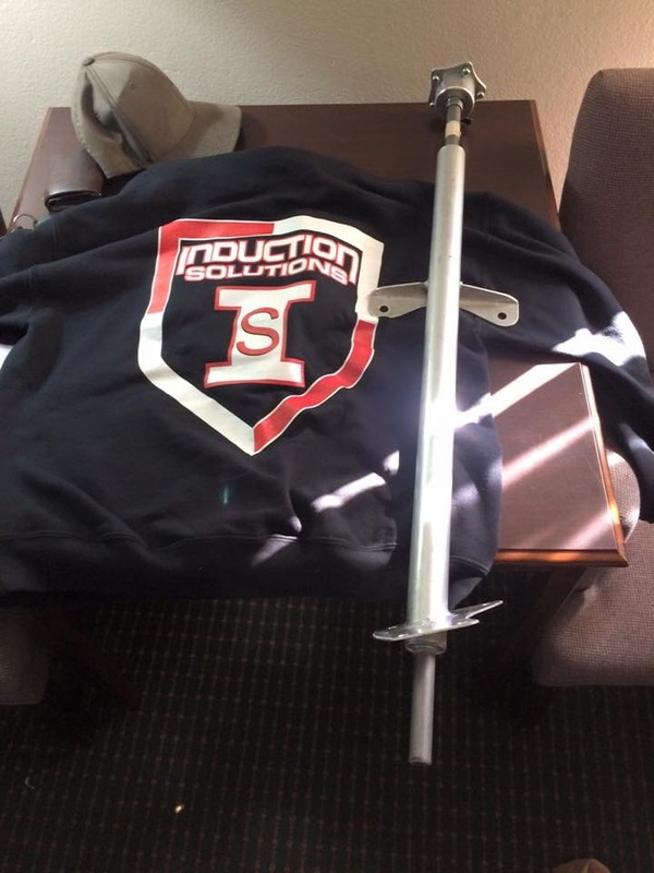

oh also got a few more parts gathered up.....the assasian bars and perches, tci outlaw shifter, headgaskets,lifters, head bolts, an leaf sliders.

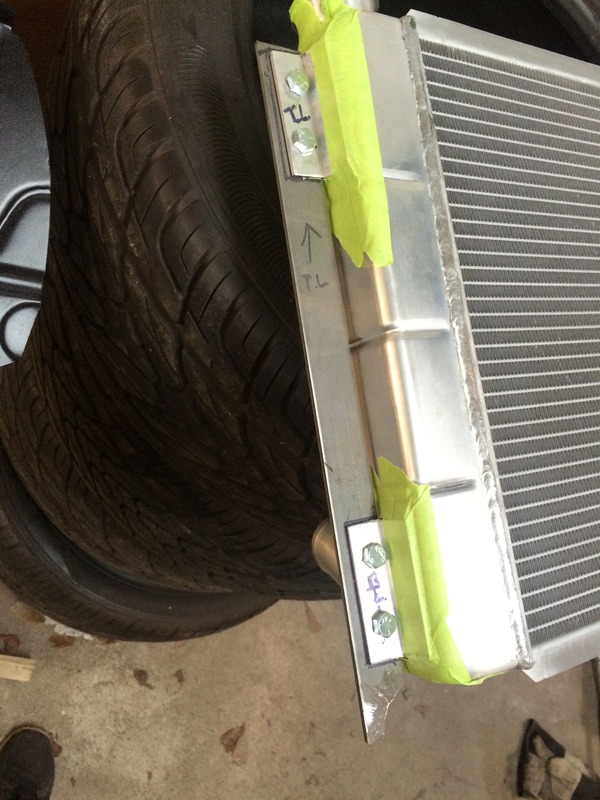

small little progress pics, been really busy so i only work on it one night a week it seems.

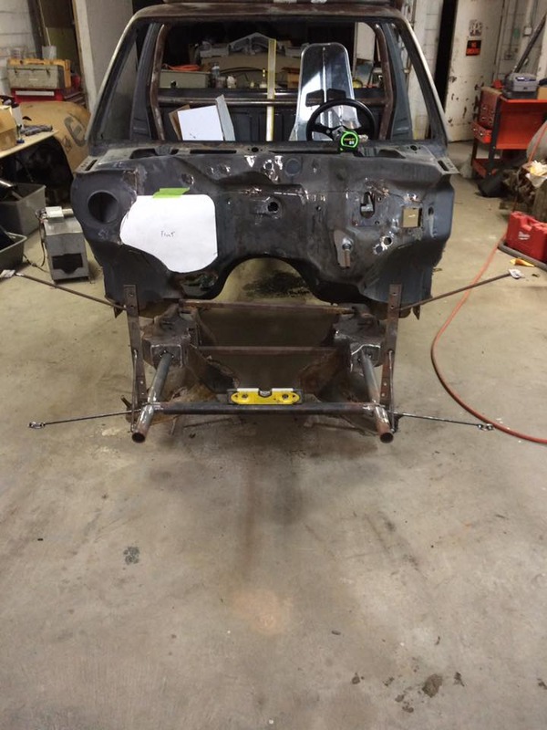

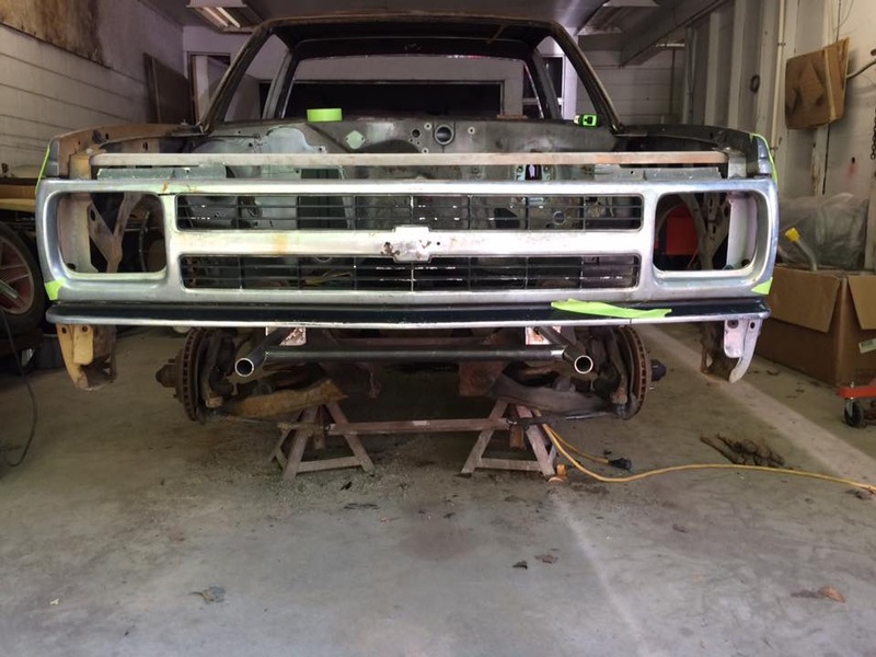

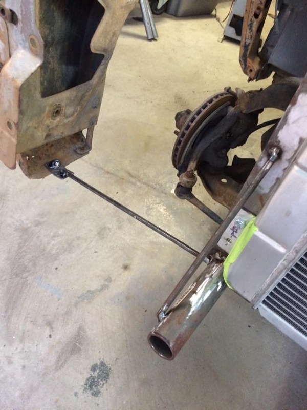

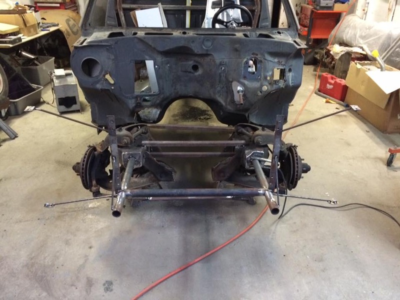

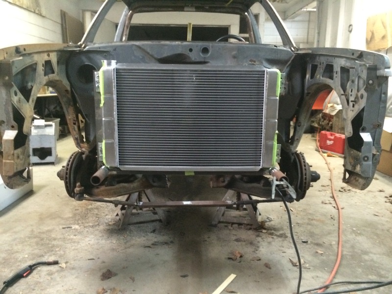

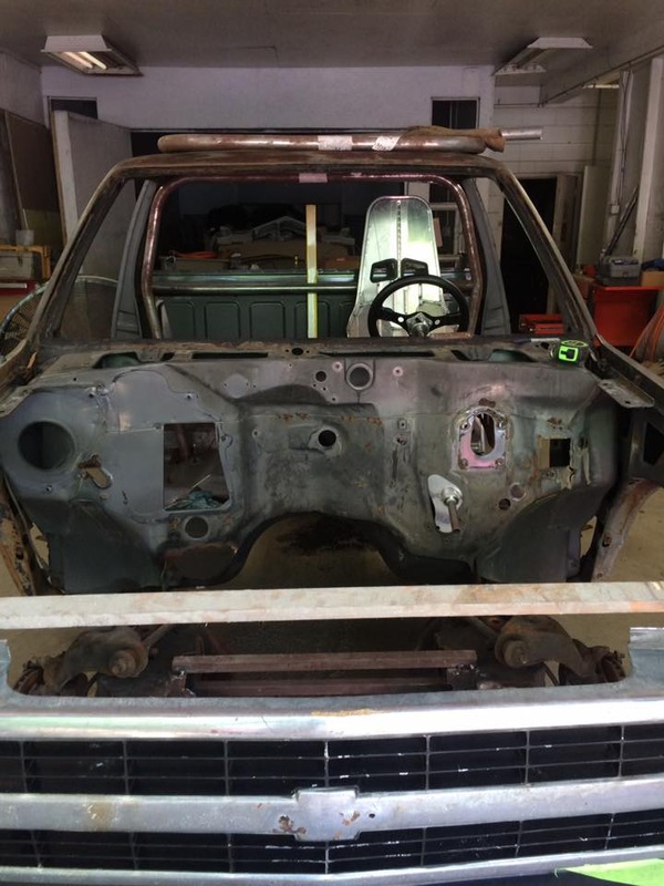

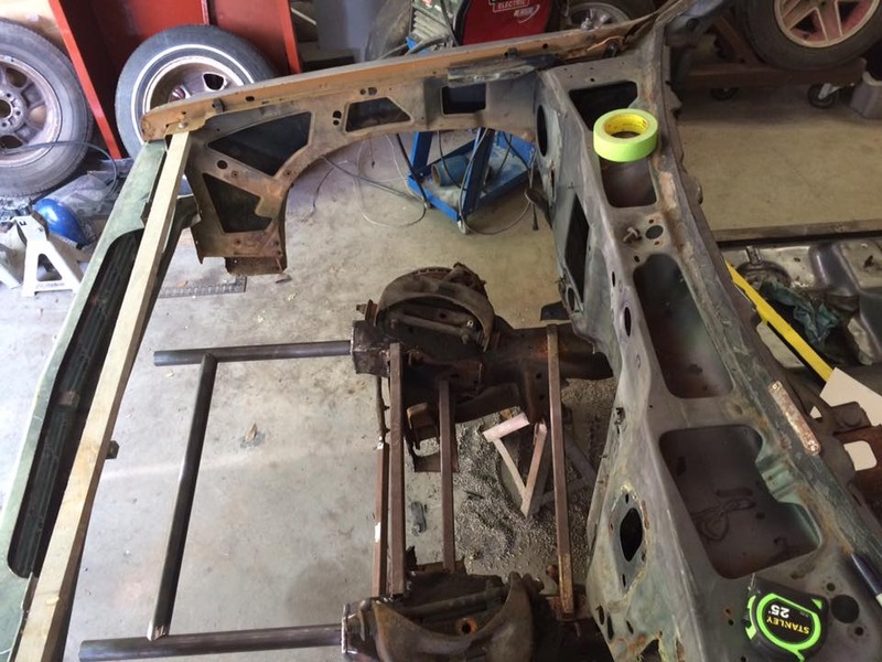

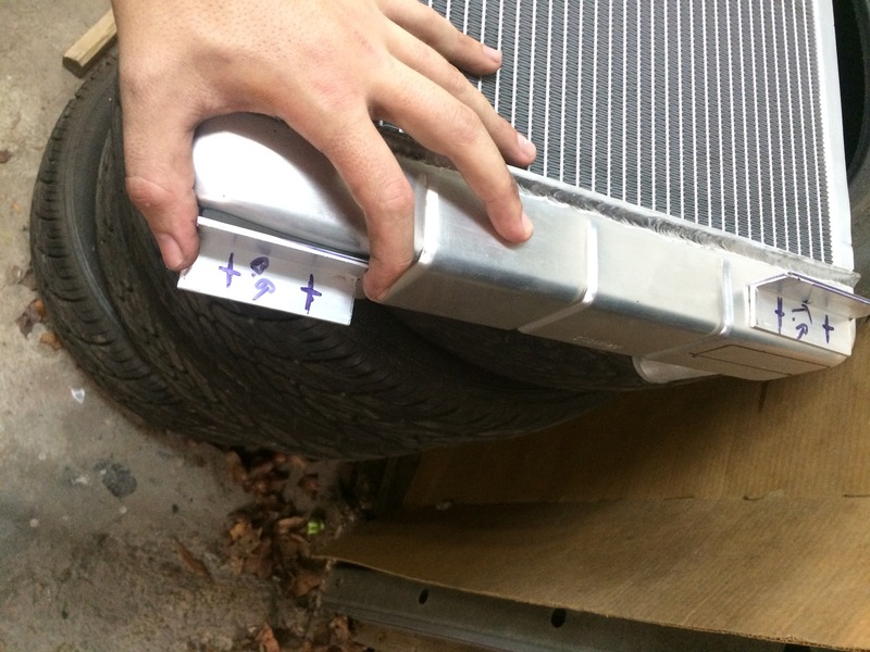

Slowly making some progress, designing it as i go but so far its coming together kinda how i pictured it. Next ill be adding the grill mounts, headlight buckets, more bracing to hold overflow tank and maybe the stand alone fuel cell. Also started welding holes up on the firewall.

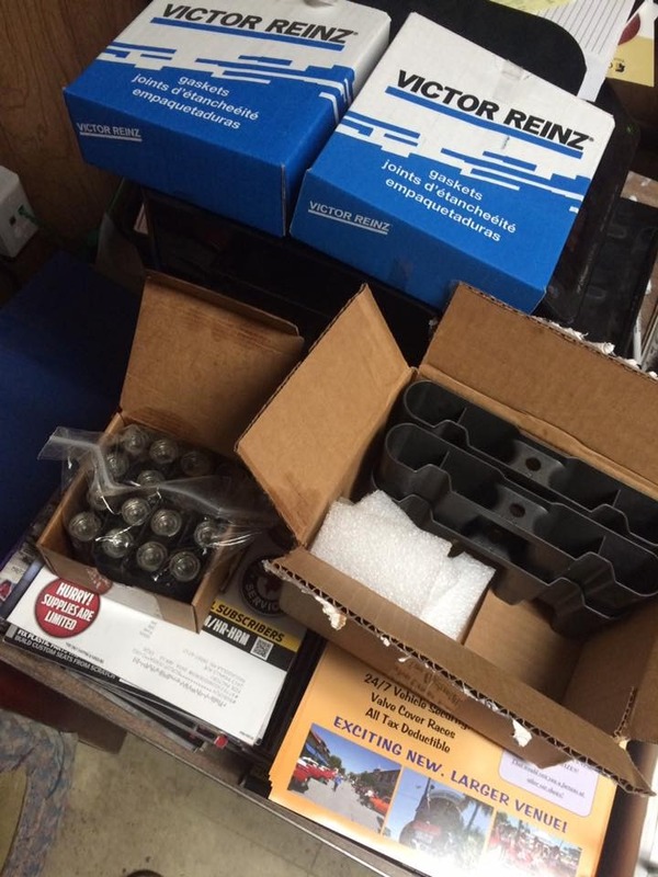

got my birthday present to my self in yesterday, ordered on april 14th....well worth the wait!

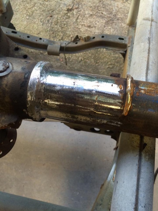

got the fronts mounted up when i had some free time at the shop, next ill get the 28x10 hoosiers monted up

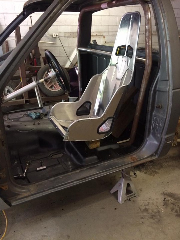

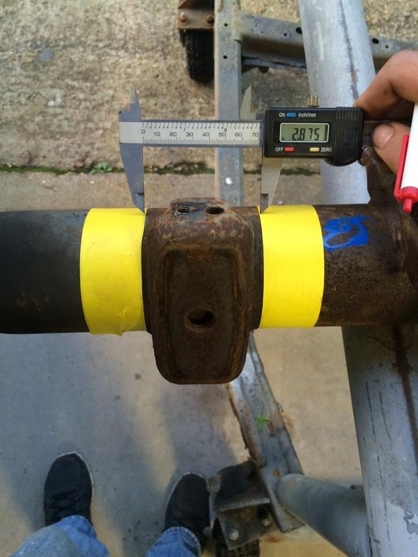

Its been blistering hot and ive taken a break on the fab work for a little while.....but today i decided i had to do something!!
gona take em with me to work in the morning an spin em on the balancer, prolly get back to some fab work this week if it somewhat cools off...high 80s mid 90s at 5:30 is killer in the shop!
