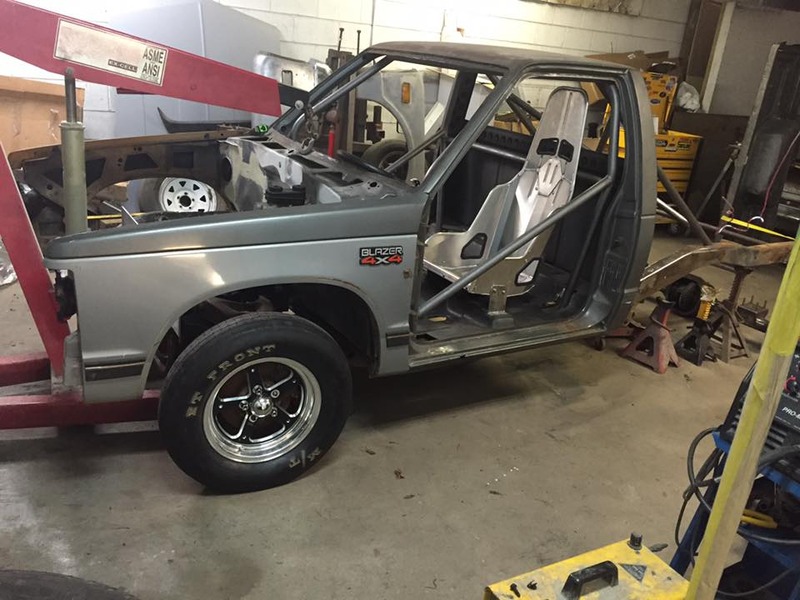

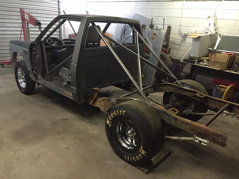

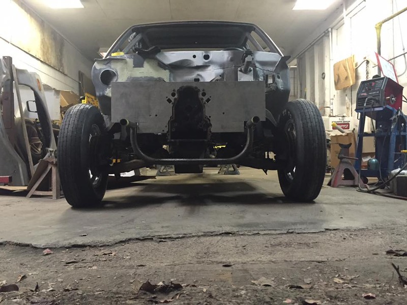

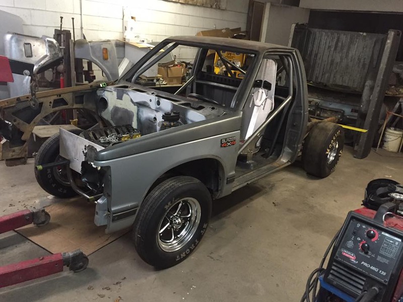

got the front end in roller status, still needs to come down a few inches

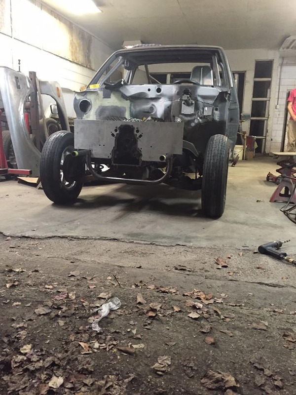

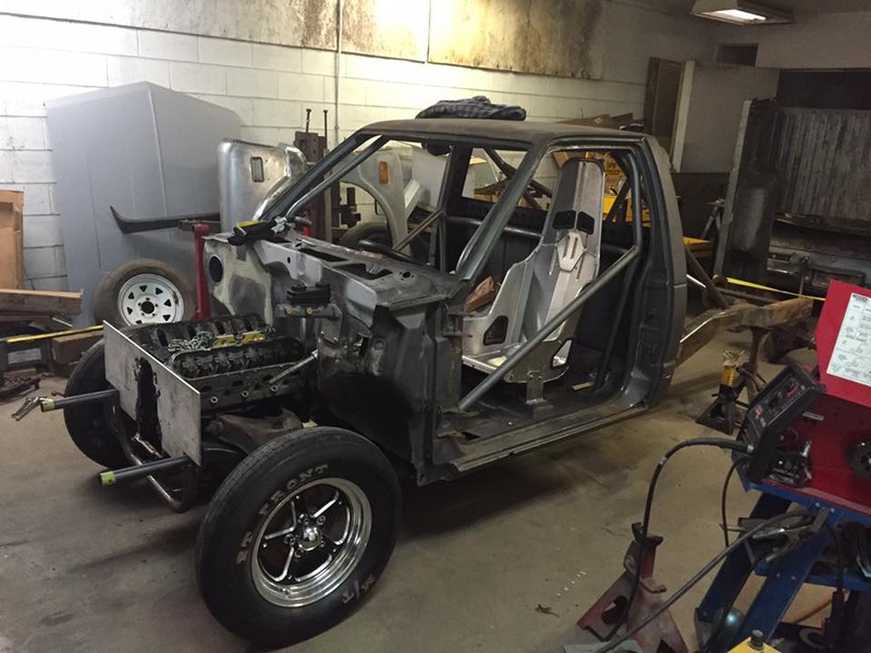

How much weight do you think you removed from the frt? S10 guys skin the frt fenders and get them as light or lighter than glass fenders. Something else to consider for the featherweight.
Old Nov 20, 2016 | 10:54 AM
  #28
Black'Rado's Avatar
Joined: Jun 2009
Posts: 1,037
From: pascagoula, mississippi
As far as the front goes....ive probably dropped over 80 pounds.
cut 18-20'' of frame rail off, ditching the stock steering box and linkage, ditched the core support, cut out the complete engine cradle and foward control arm mounts, the tubular k member might weigh 25 pounds, the rack an pinion setup another 18ish, then the new tube rails and rad support with headlight buckets and all around 20-25.
the fenders will be skinned, glass ones are around 4 pounds a piece, stock skinned ones are about 5-7 depend on if aftermarket or oem. im going to also skin the bedsides and cut out a lot of the door guts.
will have lexan all way around, glass hood, heads up composite glass dash, glass bumper.
