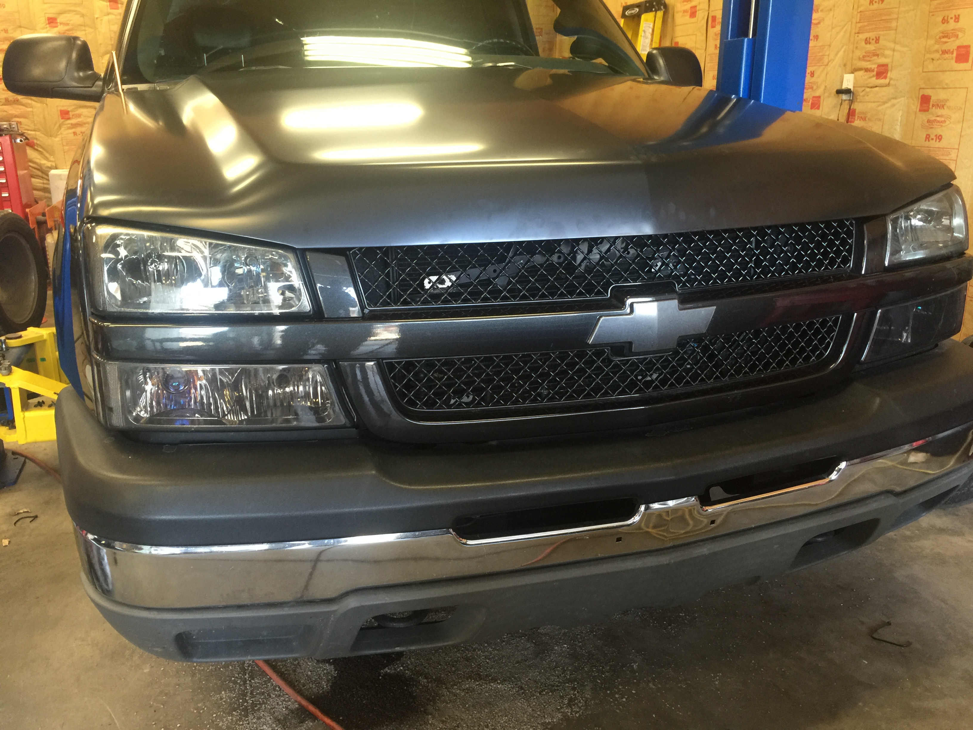

It fit with the new hood. I ordered a a/w intercooler kit from frozenboost.com I'm going to run the type 12 2000hp intercooler Bosch pump, heat exchanger a ice box. My turbo smart blow off valve showed up I bought the 50mm race port. I also purchased a leash boost controller and a bump box for my Trans brake. Couple more hours of work then i could probly start it up.. Probly be a couple weeks before it will be done enough T to drive

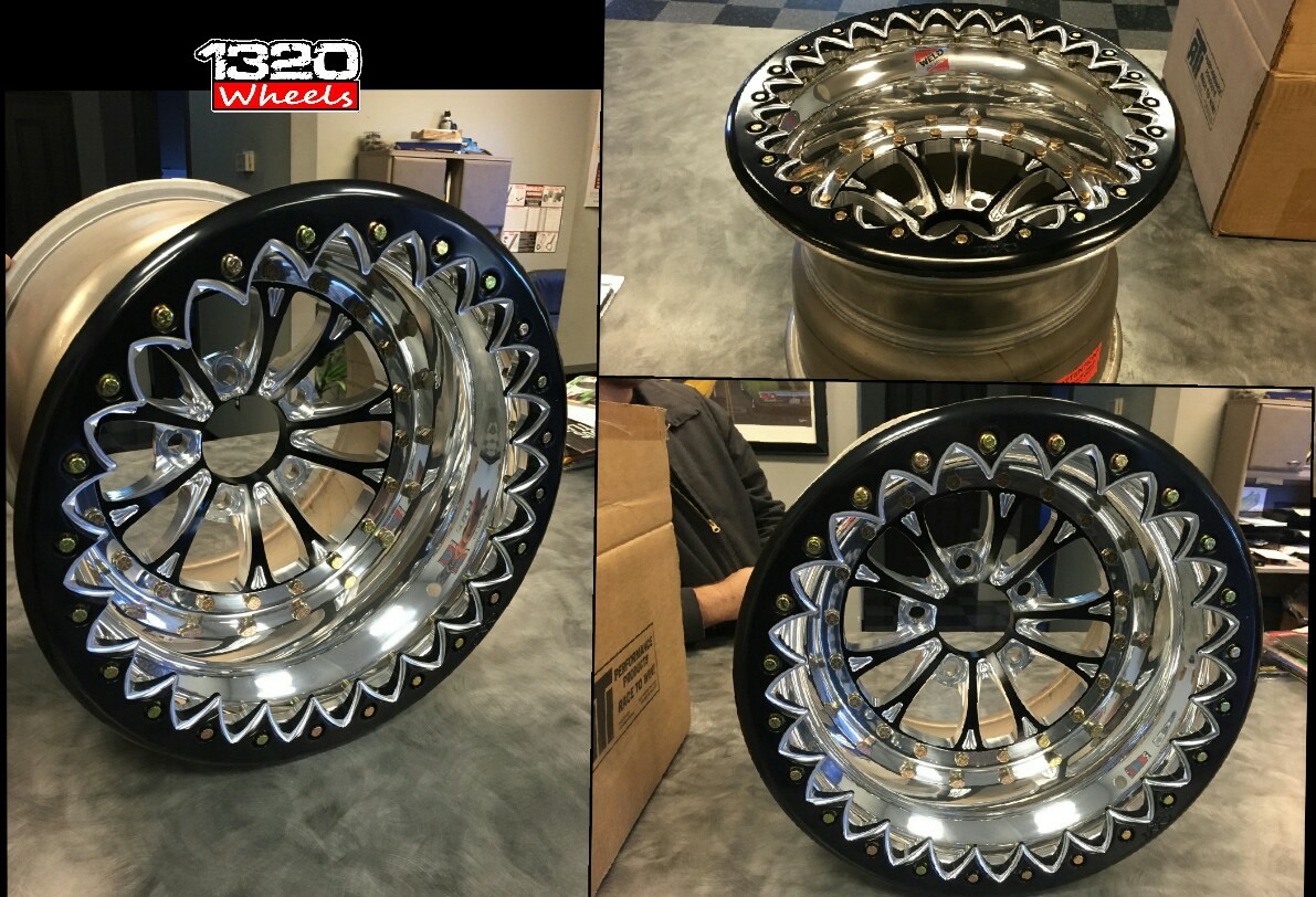

I also just bought my wheels for the rear, I just went with the weld Vitesse 15x12 with a 4.5"bs with a 4.75pattern. With champion bead locks.

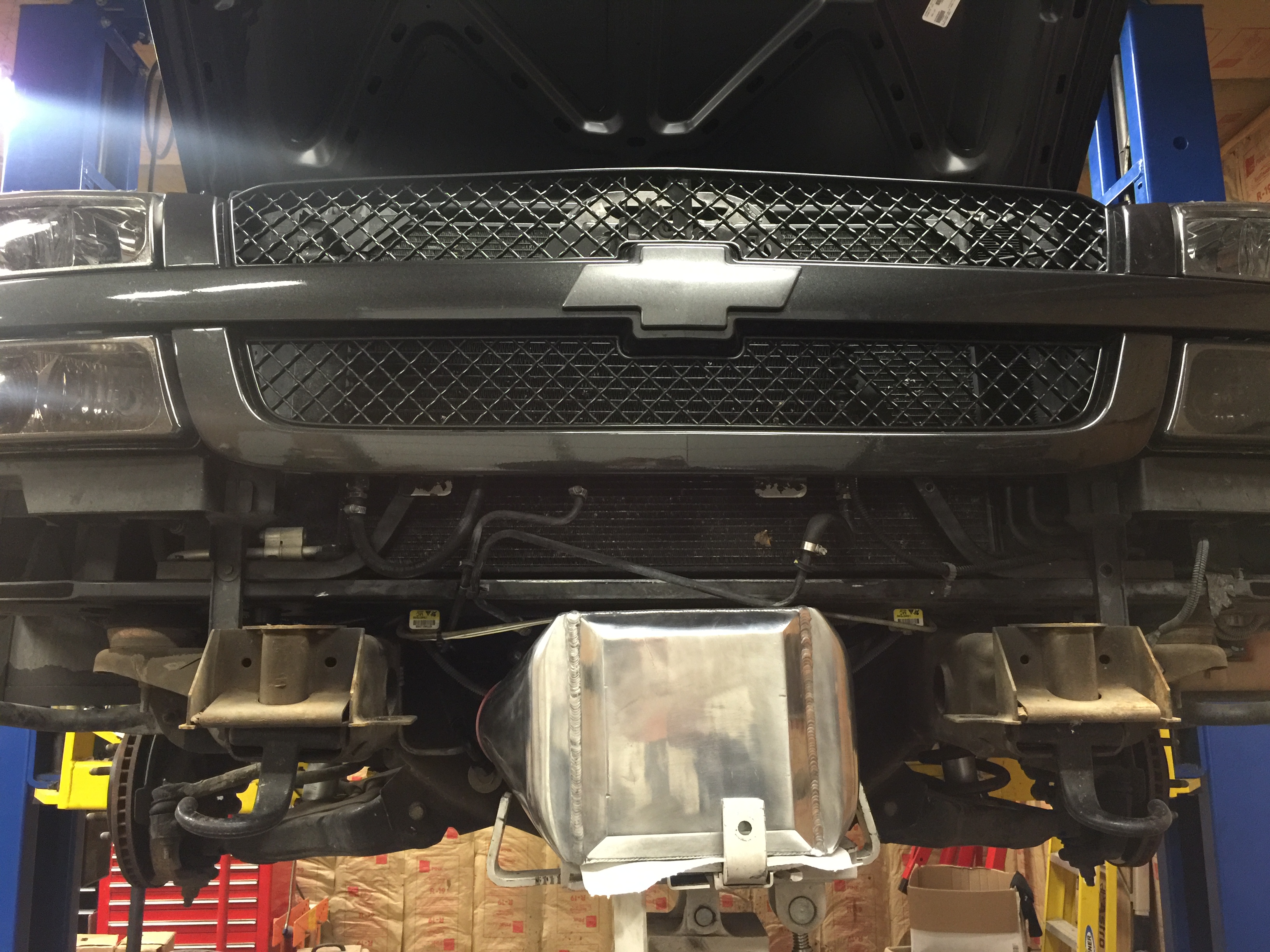

Intercooler showed up.. "2000 hp" rated a/w from frozenboost.com thing is huge! And weighs 35+lbs I hate to put it on the nose but really don't wanna run a bunch of piping. All over
Old Mar 16, 2016 | 12:34 PM
  #297
Atomic's Avatar
I have a gauge for that
Posts: 16,282
Likes: 438
Will it fit in the factory battery or air filter locations (the corners)?

Nope it's huge I'm thinking Ima mount it where the gas tank is

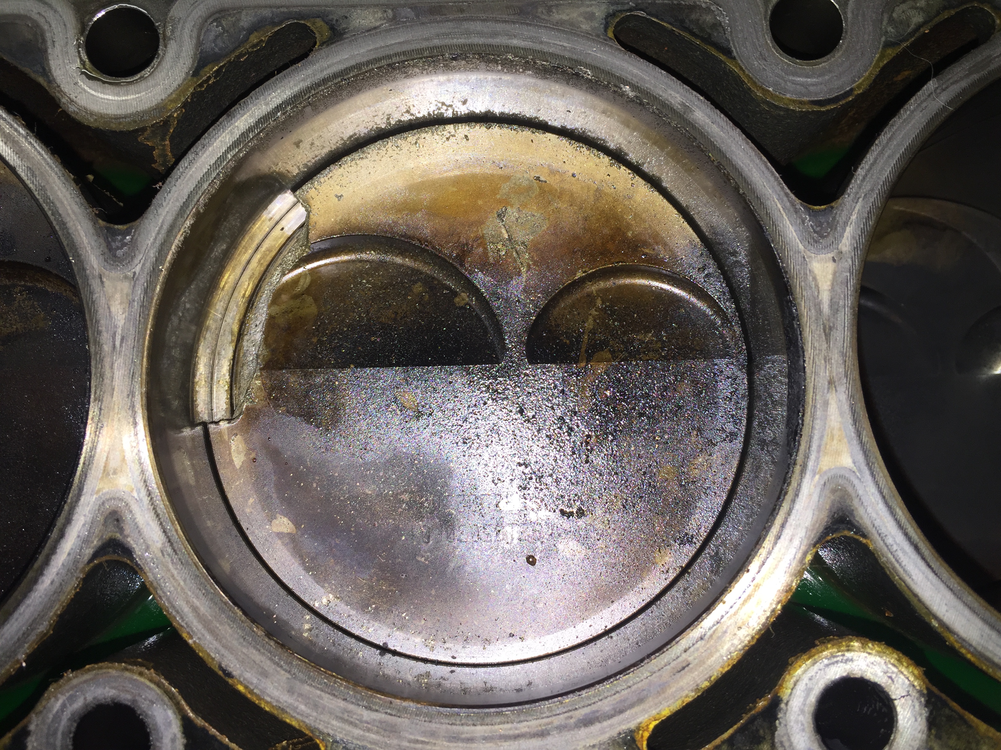

Random thing I figured out what happened to the 408. So Ima have the head checked/ repaired if needed. Head Dosent have any pitting just had a miss when cold and I suspect one of the valve was hit and is slightly bent.

Ptv was checked??
