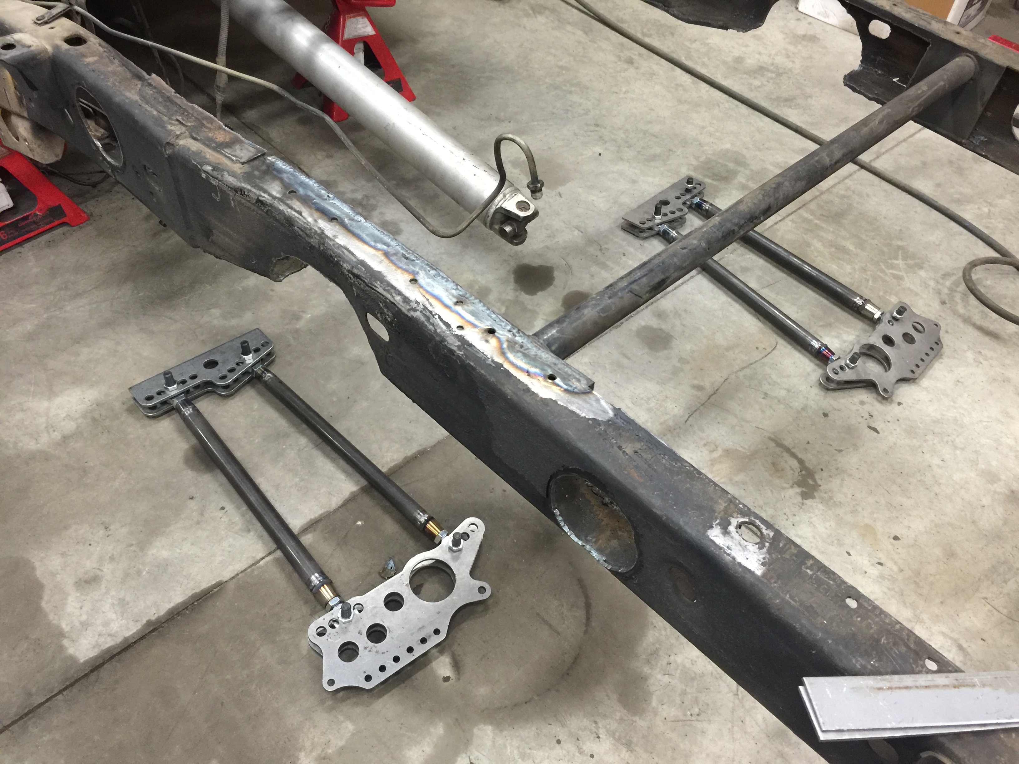

Did some more cutting and took the old shitty c notches out, and removed the old shock crossmember parts. I'm going to box and brace the frame in where the 4link ties back in. Add a crossmember or two back in it's pretty flimsy at the moment.

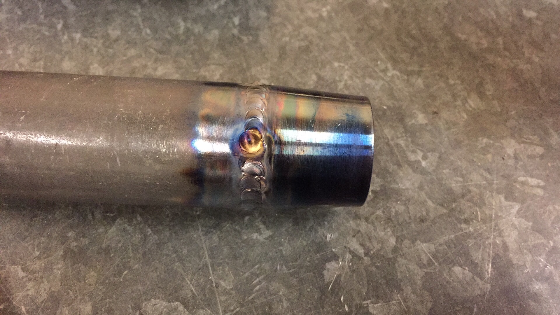

I started welding the bars up for the 4 link, this is my first time working with Chromoly. This is a comp engineering magnum 4 link kit, a magnum diagonal bar, also got a drive shaft hoop that will be used for the front mounting point for the 4 link, then upper and lower coil over mounts.
Doesn't look bad. I'd add a rosette weld to those rod ends next time. Too late for that now.

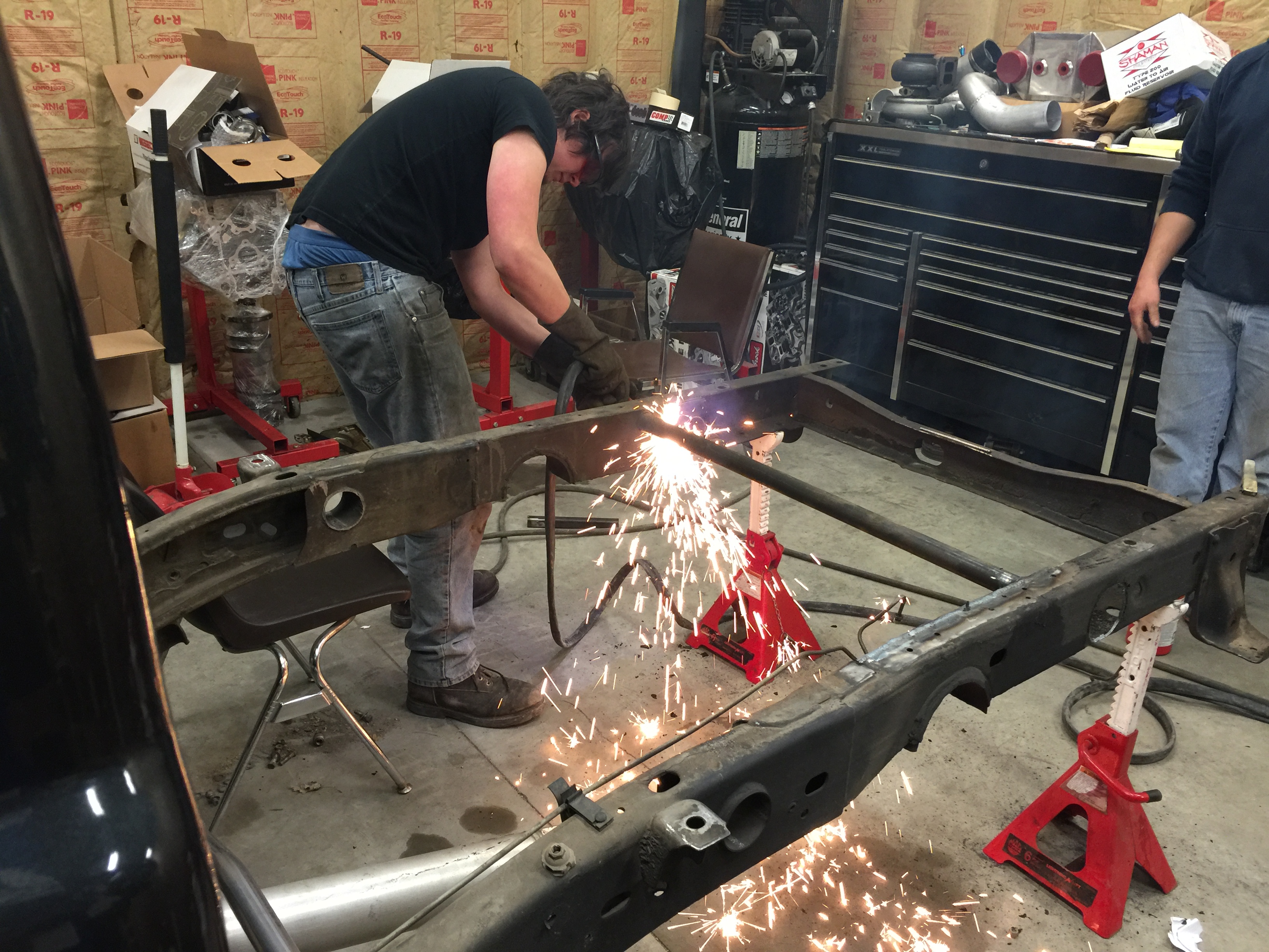

I still can, just want to see where we are here and figure out where everything is gonna sit. I still intend to box the frame in some. And the front mounts will be mounted to the frame.
