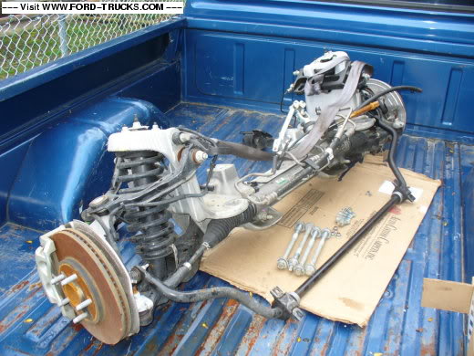

well i found my suspension today

Is that a mustang II?
Not a huge fan of the Chevy motor in the ford but the ls motors are kick ***! Truck should tear up some asphalt.

the suspension is from a 03+ crown victoria...that suspension fits any ford truck 65-96..bolts right on with 8 bolts.and a little bracket on the trailing arm.
will have rack and pinion steering,a 5"drop, disc brakes...
and yea a LS motor in a ford...its way cheaper than trying to put a 5.4 or a 4.6cobra motor...ill rather have the ease of wiring a 6.0, the ease of tuning with flaco, the relieablitiy a ls motor has,and the ability to make a bunch of power with not that much money
