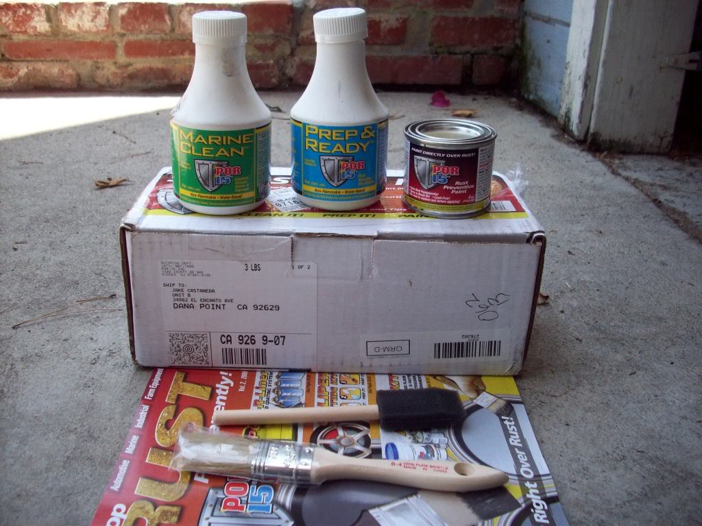

this is the 'starter kit' that por-15 has. it worked out pretty good since the can was just the right amount for the rear end.

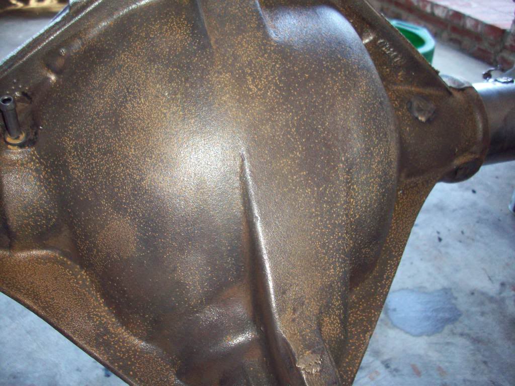

this is how potent their 'marine clean' is. this was only about 10 min after applying it.

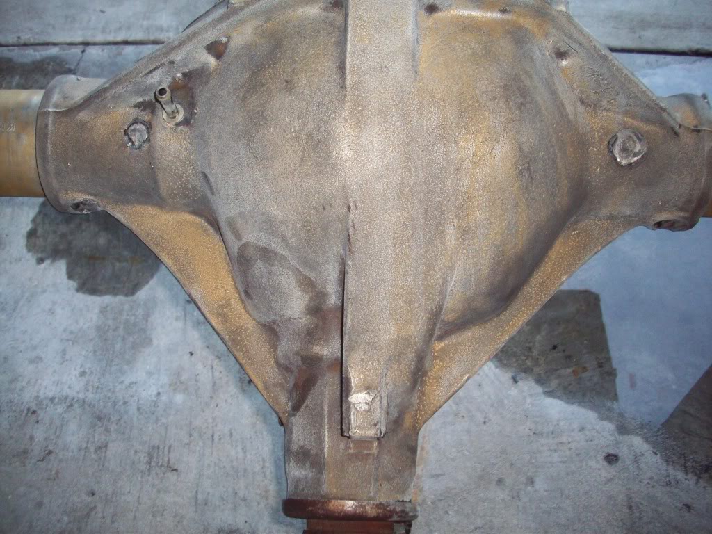

after applying their 'metal ready' product to it.

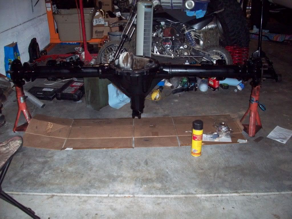

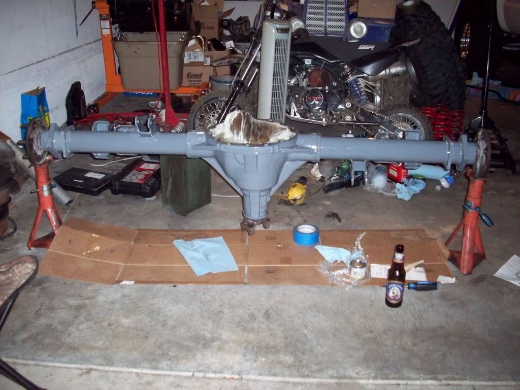

after 2 coats of por-15
after 2 coats of top coat

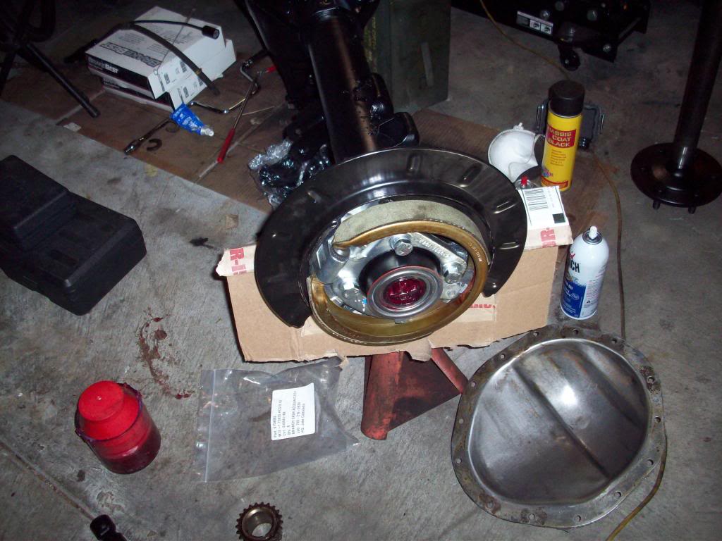

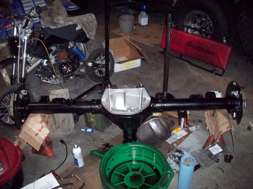

new bearings, seals, and backing plates on
ta cover just sitting in place

I like the way the POR-15 sets in the pics. I ended up doing 6 coats with VHT chassis black paint and so far its holding up well. If your by yourself a tranny jack works decent for installation/removal.

6 coats seems like a lot. i think i kind of jumped the gun on the amount of time the por-15 dried before i put the top coat on. also while removing an axle i nicked a brake bracket and took both coats of top coat off. maybe i'll add a couple more coats.

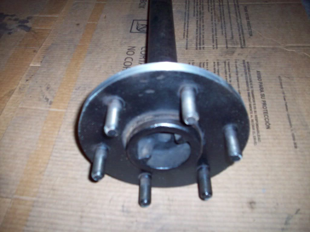

Axle flanges shaved down with a lathe.

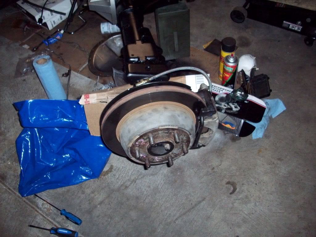

Brakes set up and ready

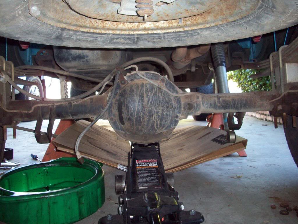

The 10 bolt coming out
I didn't have a free hand to take pics during the swap but it went as smooth as it could. I still need to cut the u-bolts.

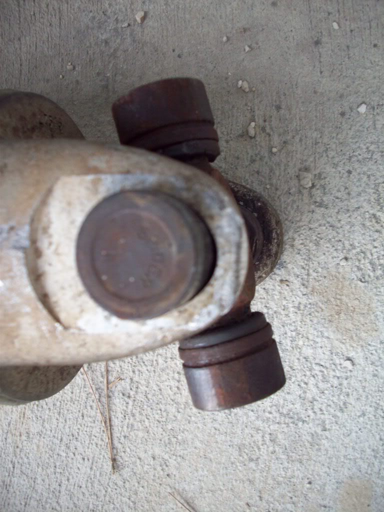

I ended up damaging the aluminum yoke trying to press the old u-joint out to swap the 1350 conversion joint in. My driveline guy said they couldn't weld a new yoke on the aluminum so i had to get a steel driveshaft made.
Everything's been working great so far. I have a very slight vibration at about 75mph, not sure what it is right now. Speedometer is off a little due to the lower ratio, but I like having more low end. I still need to either swap the master cylinder or add a proportioning valve to be able to use the rear discs at their full potential. POR-15 is holding up pretty well, however the topcoat has scratched in a few places.
